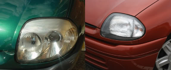

Now we've had the bumper strips re-sprayed, we think the car looks a little bland from the front. An easy mod in the meantime would be to change the headlights. Whats the difference between our ones and the ones on the green Clio (aside the obvious visual difference-see pic at bottom of thread)? I know that they were used on the 'Sport' models, but also lower spec ones as i've seen loads round here with them too.
If i were to find a set of these lights, would they be a direct replacement for the standard ones or do they need additional wiring? I would think that they are just direct replacements surely? Just a pod for side lights and a pod for main beam & indicator. I don't want to get a set and then not be able to use them because the wirings different!

Aah, they're called 'Dual Optics' are they? Thats what i want-but nobody seems to know if they're a direct swap. I don't want to get some and not be able to fit them. I don't want to cut/solder any wires really, just trying to find out if they're a in/out job, and whether i have to remove the bumper or not to do so!

they are not a str8 fit but dont take a lot the bulbs in your headlights now use 1 bulb for dipped and high beam in the dual optics they use 1 for each so have to change the wiring to work on to the two bulbs but i do think you can buy a wiriing kit from hella
i have got angle eyes on my which are same as dual optics use to bulbs and i got a wiring kit which come with them so aint really hard mate i still mite be going with some dual optics as my angles ring have packed in so unless can fix will go for these over another set

Basically there are three wires to each main headlight bulb, on the one you have now. You need to modify/split one of them to make it so that there is four wires. Then add a fuse. Looks fairly simple, i'm yet to try it.
