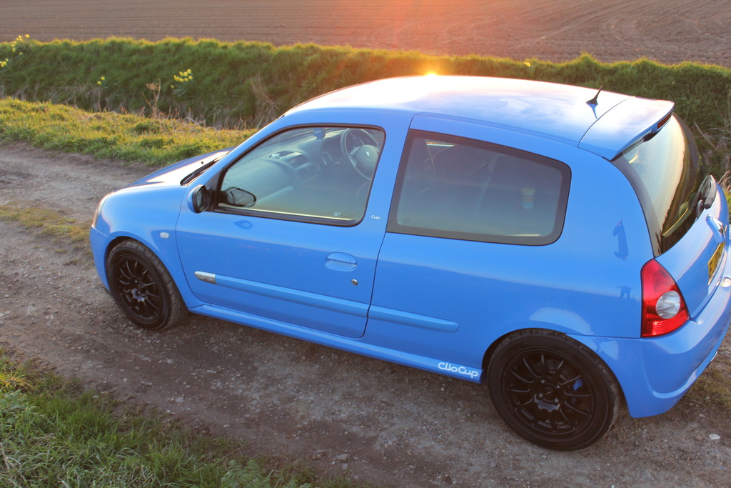

I'd personally look for a set of 15" wheels, F1's or Team Dy. 1.2's. - Rubber is considerably cheaper. I've not long ago managed to pick up some R888s for £67 per corner. Speaking to a friend of mine, that's cheaper than he can get them being sponsored by Toyo.
They're usually around the £100 mark per corner, and about £125-130 for 16", So there's a good save - I personally like the feel/nimbleness of 15's over 16 as well. This is mine with 15's on.
