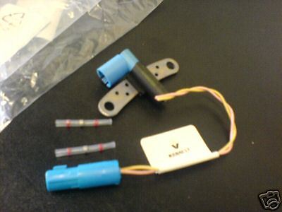

If the car only struggles starting after long periods of being unattended (overnight) its because the TDC sensor isnt correctly telling the engine the position of the crank so it fails to start up. This is a common fault and Renault have released a revised part with modified wiring loom to address it. Looking at £50 for the part.

thats a pic of a revised one on ebay, original ones are black not blue
edit, here's another pic
