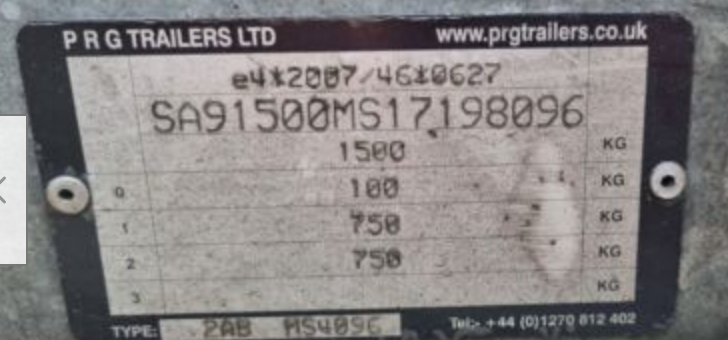

there’s a guy in this thread that explains it well;
  Clio 172 ph2
Thats the plate from the PRG Mini Sport I'm looking at that has the tyre rack.
Had another look through the PRG website and cant see anything specifying max nose weight? Guess I could call them in the morning.
