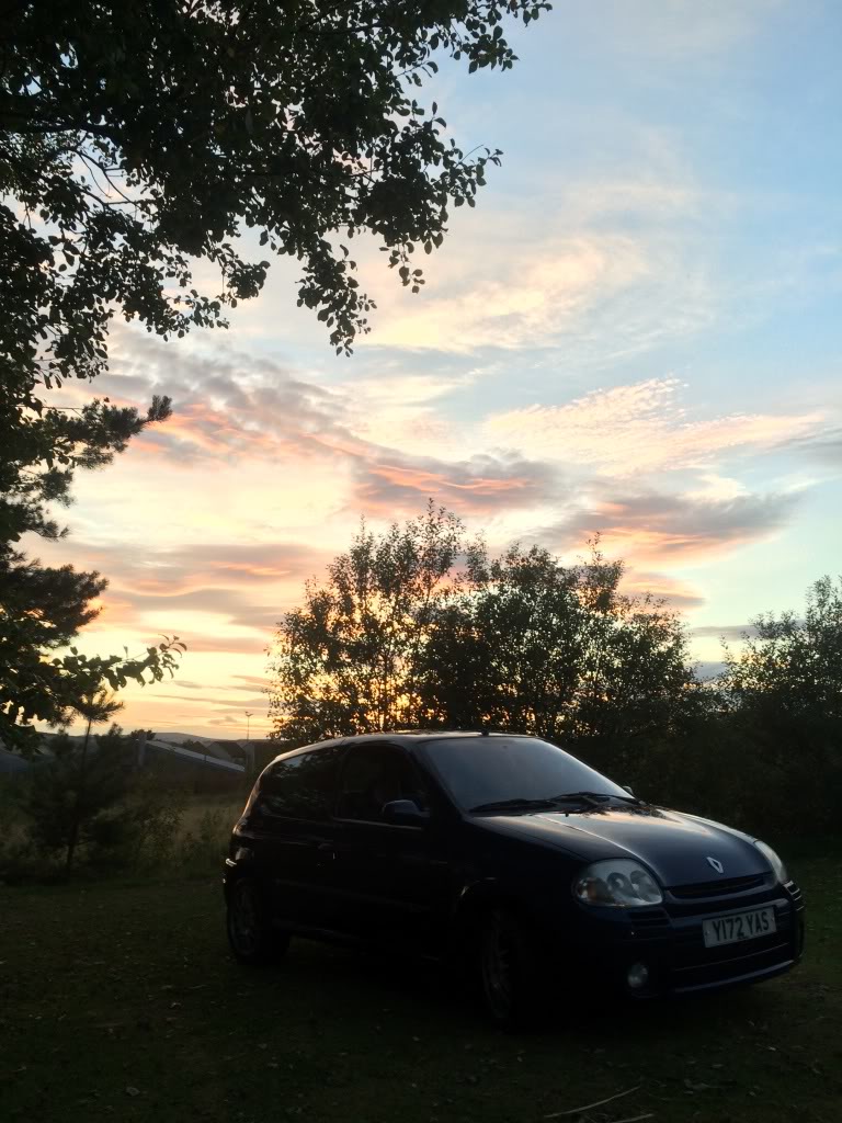

this was it after it's first wash

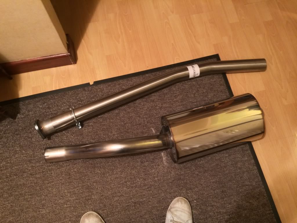

the problems didn't stop there, on the road to work one morning last week the back box fell clean off the car so had to buy an exhaust ( good excuse to buy one any way) so ordered a Ktec supersport stealth system

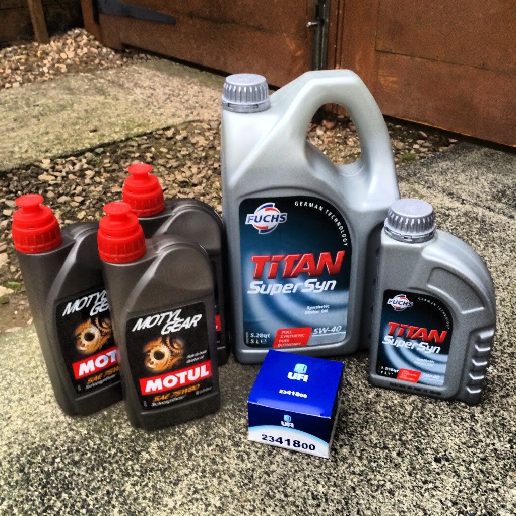

Had also ordered engien and gearbox oil just so I know what's inside it so this came in the post same day as the exhaust
car sounds a lot healthier with this in it now so that's always a plus. Decided to take it to a mechanic friend of mine just to give it a once over to see if there was anything that needed done, the problems continue haha it needed a new front left track rod end front right wheel bearing and a rear left bearing! So the track rod end was done last night and the rest will be done next week

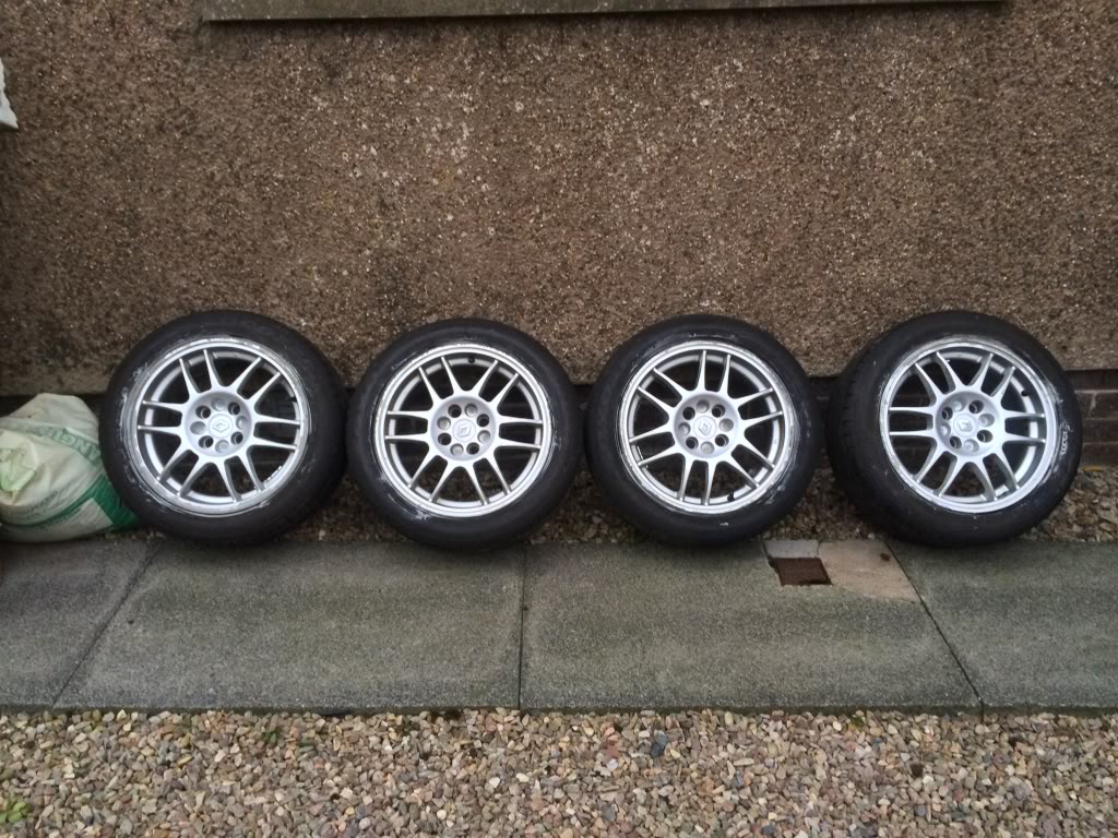

also so got as set of original F1 oz wheels with the car
Fitted these with toyo t1rs

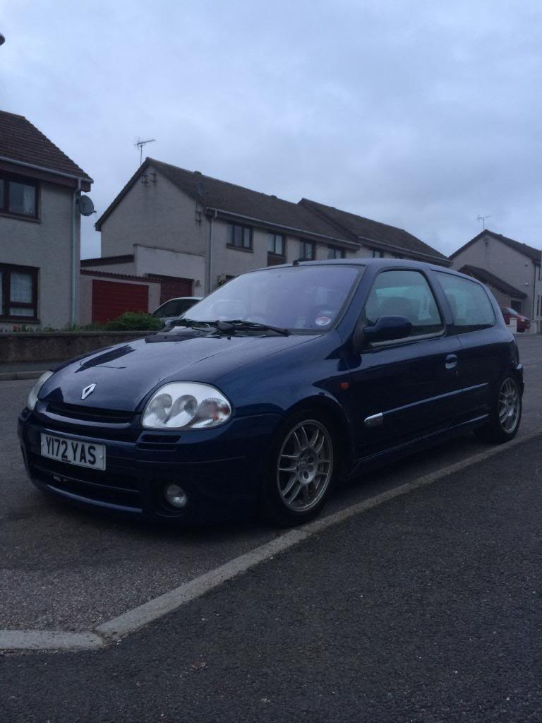

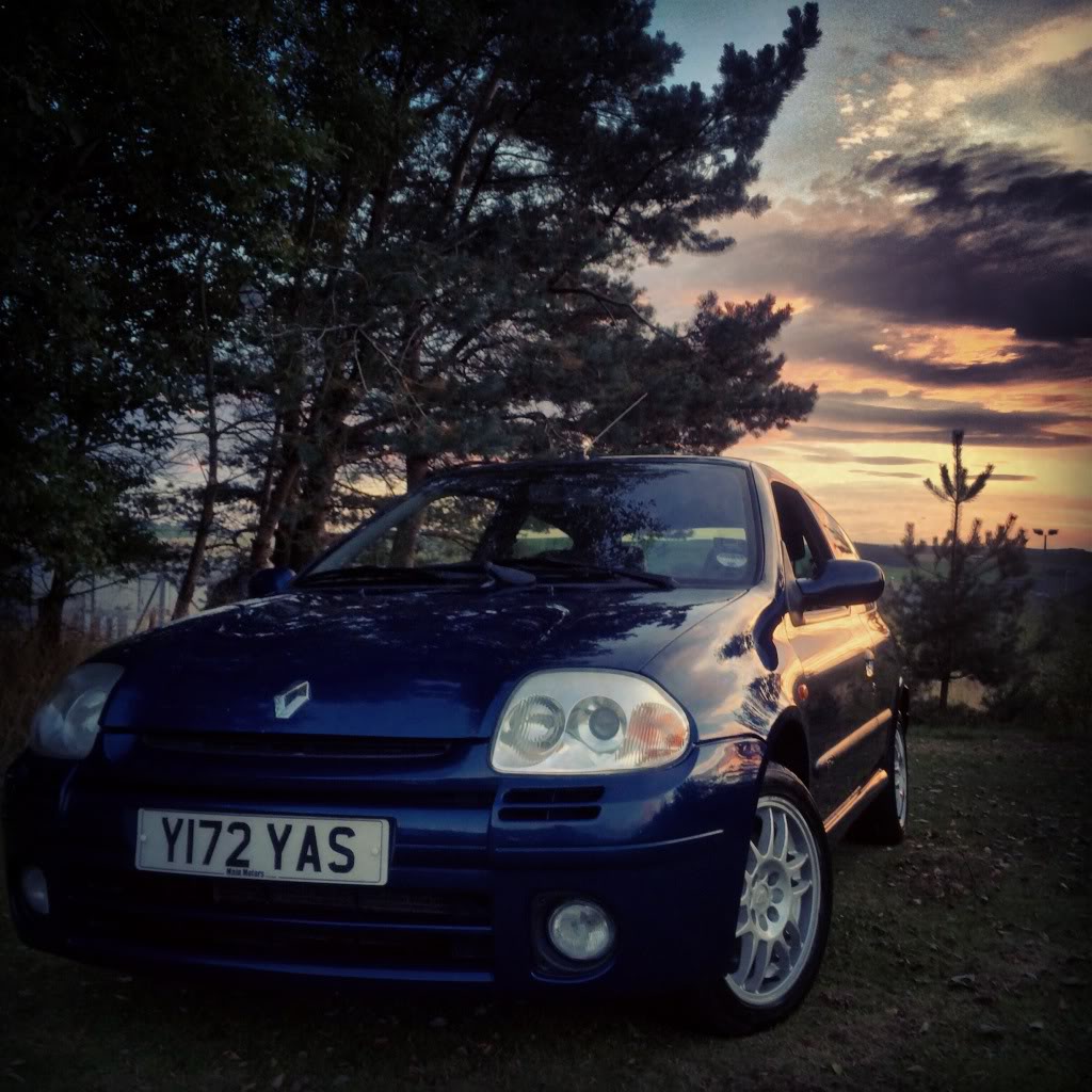

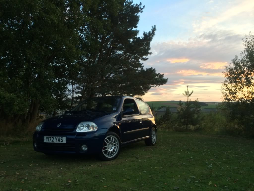

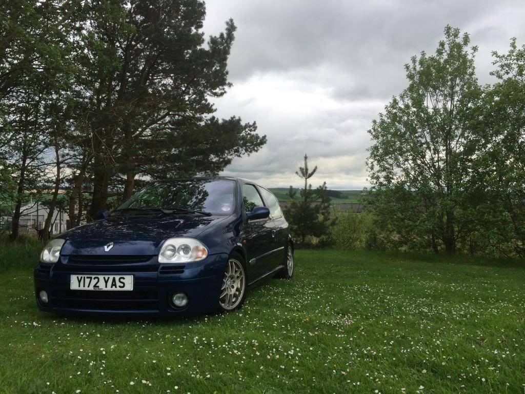

at the weekend had time to give it a really good detail so here's some photos hope you like them

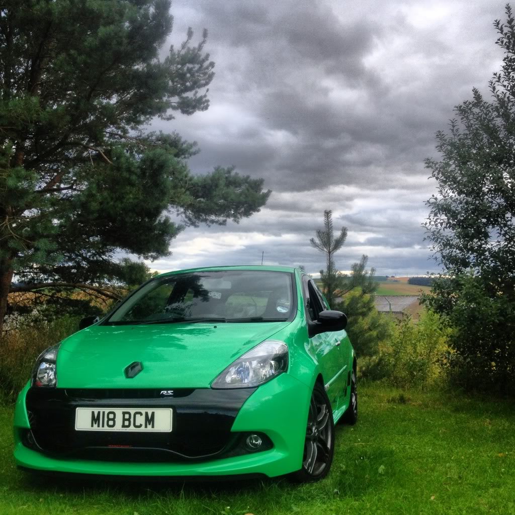

i'm in 197.net most of the time but for those that dont know i have an AG 200FF with toyo R1Rs, sprintbooster gen2, 64mm TB, matched inlets, secondary de-cad, de-silenced, clio ph2 V6 airbox, ktec renflash with crackle map and H&R springs. RR is 191BHP with percentage loss its 197 before it was remapped
most recent photo i have of it :)

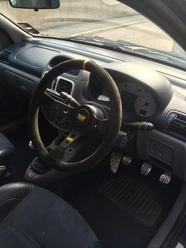

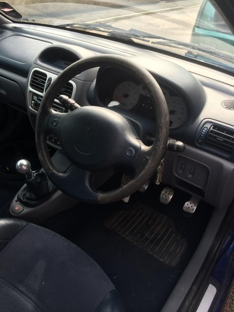

Firstly it had it's mot a few weeks ago and confirmed what I already knew really the shocked were buggered so I was on the hunt for a set. But first I had to sort out the crappy looking wheel, usual Renault the leather started to melt off and looked terrible so I bough a momo boss and an omp wheel from a friend of mine and the wheel was practically new! Looks 100% times better now IMO
Old
new

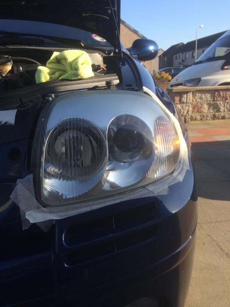

I then re-restored my head lights as I still wasn't happy with them, so I found all the stuff you would get in the 3M kit and bough it all from my local car shop for a grand total of £3.50 and got to work. No before pictures as I forgot but you all know what a cloudy eroded headlight looks like
looks much better in the flesh and I can really see the deference great success
and any one that is interested I used 600, 800, 1200 and 3000 grit wet and dry and used the 600 and 800 dry and then wet for the other two then polished it with Meg's plastx and ultimate compound on a DA polisher

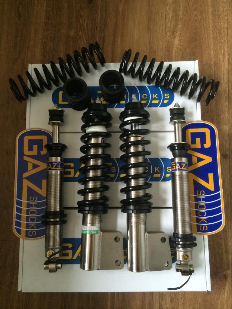

i was just away to buy a set of Ktec coilovers when I seen a guy post in the for sale section on CS advertising GAZ GHA coilovers for £475 and these were well over what I wanted to pay but I knew these were a bargain and had to have them. And it saves me buying again once it's a more dedicated track car. So after a few emails I bought a set with 325 springs at the front and 225 at the rear. Really solid set up but not harsh and crash that you can't drive it normally on the road
This is what I reserved only five days after placing my order
as soon as I opens the box I knew I'd done the right thing. Built quality was brilliant and both shocks are real weight items

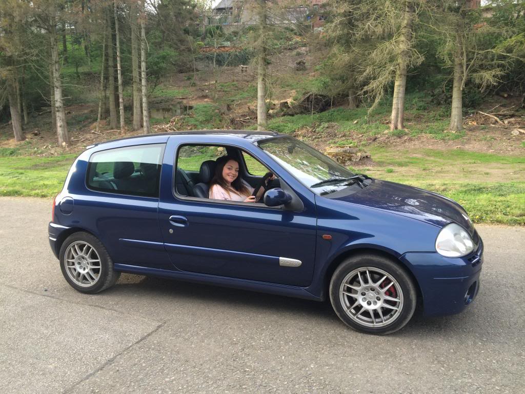

here's a photo before modelled by the missus. Just to get an idea of how it sat before
and then after !❤️
All in all couldn't be happier the way it handles and has turned out it's just on rails now and on par with the 200 now

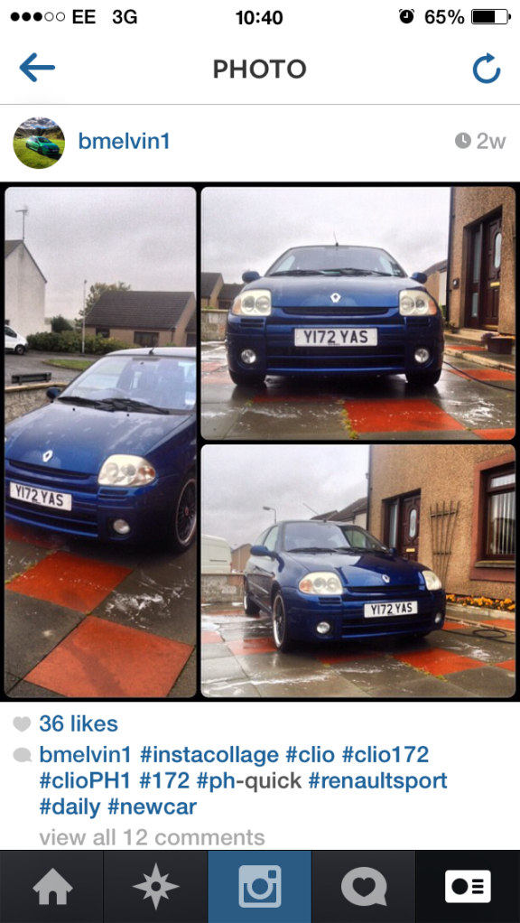

Both cars look great dude, swear I've seen the ph1 on instagram a few times.
