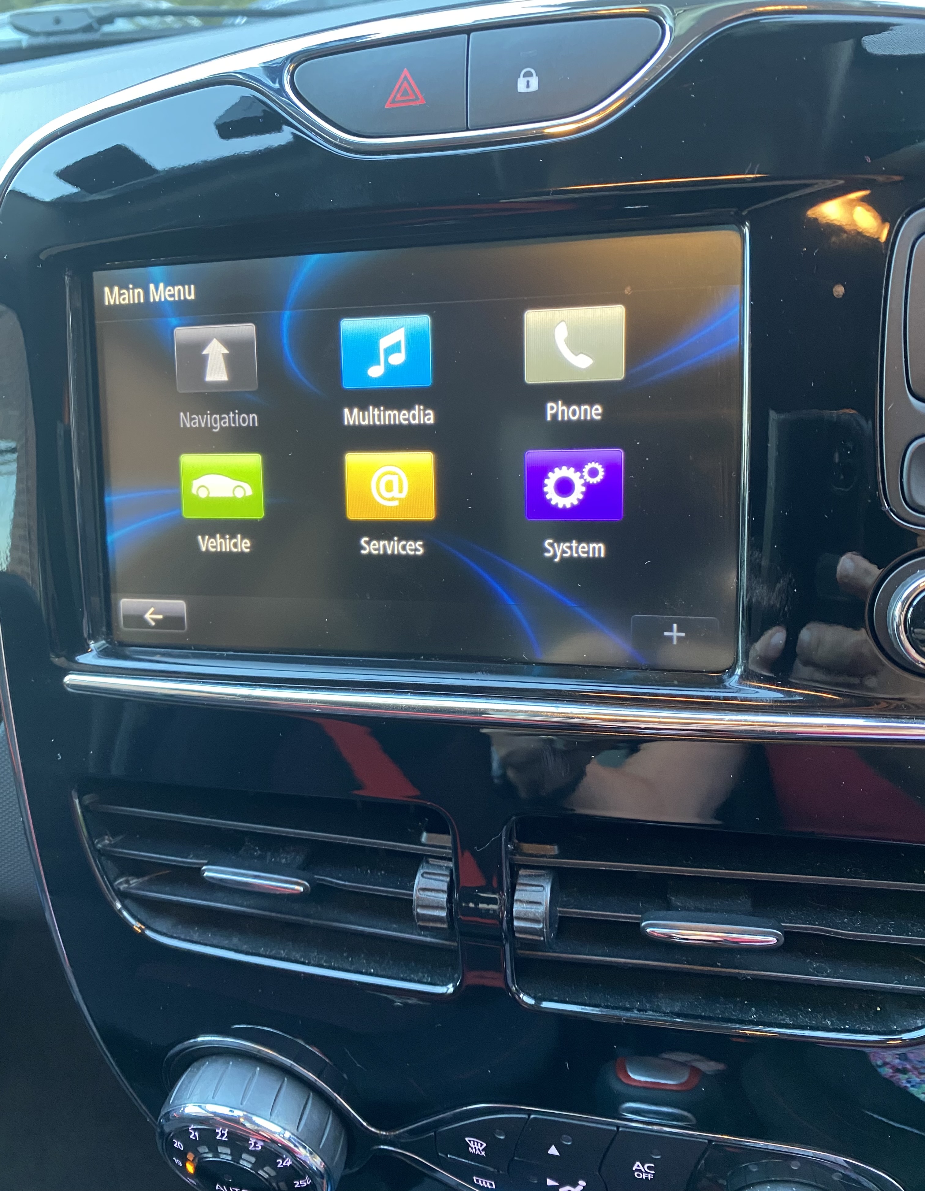

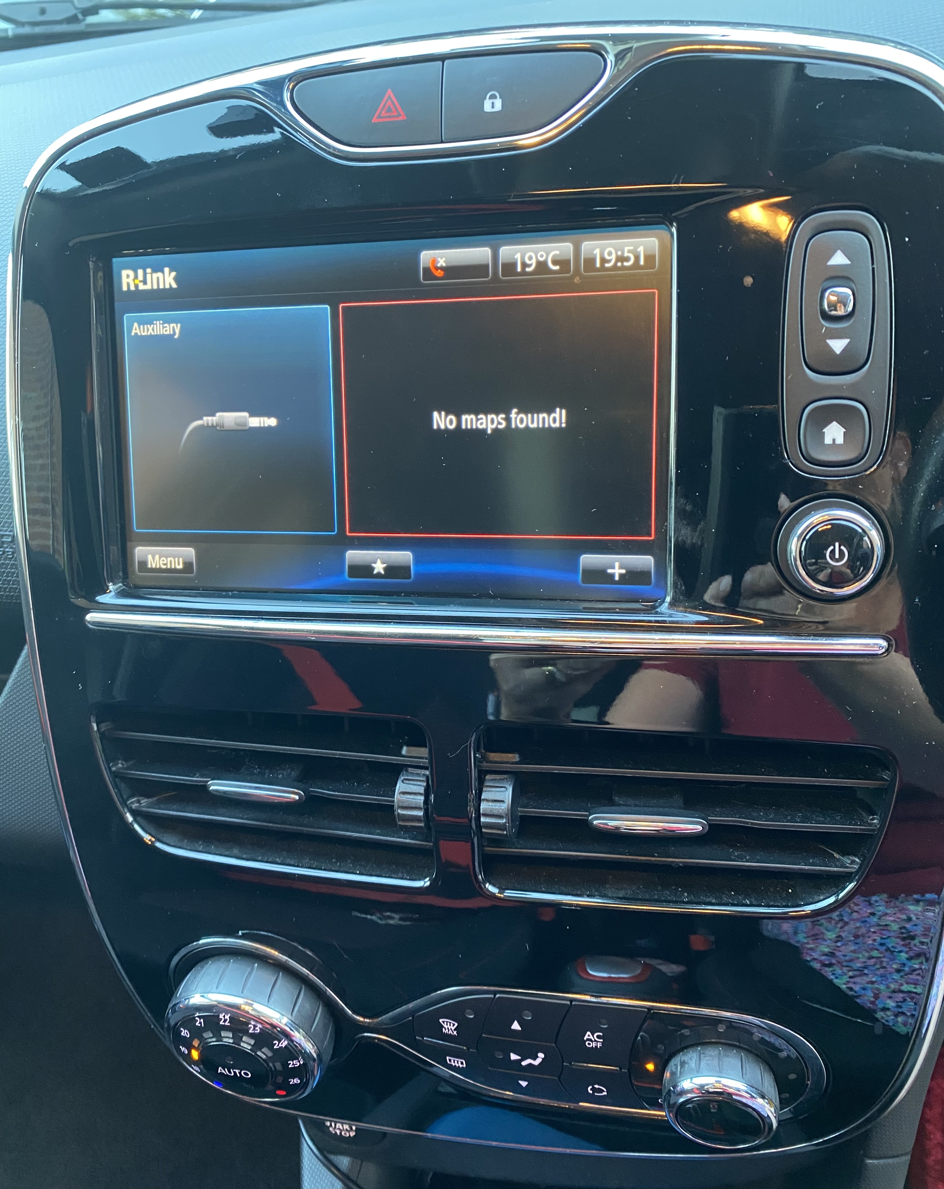

No phone linked yet as did a factory reset just earlier. There is an SD card in but nothing seen?

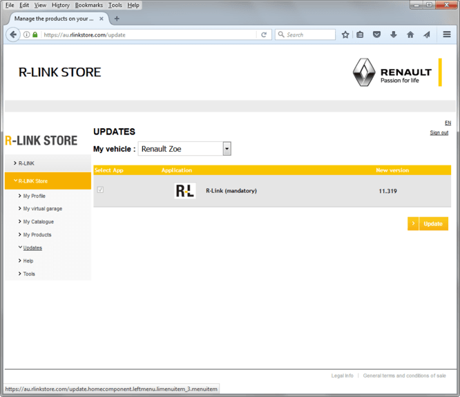

perform an update using Rlink Toolbox, I had this issue and that solved it
Wolvessmith70
  Renault Clio RS
Hi Martin, thanks, downloaded toolbox, went to updates.. no map updates? Only agreements. Map side empty? There is a red bar across top of screen stating I am ‘no longer able to subscribe to a connected product. My vehicle is not eligible for connectivity.’ Is this the main problem? It’s driving me crackers! Have it booked in to Renault in a month but in mean time trying to resolve without spending a fortune!
Martin_172
If you have a good as card don't worry about map updates, it's system updates your looking for
