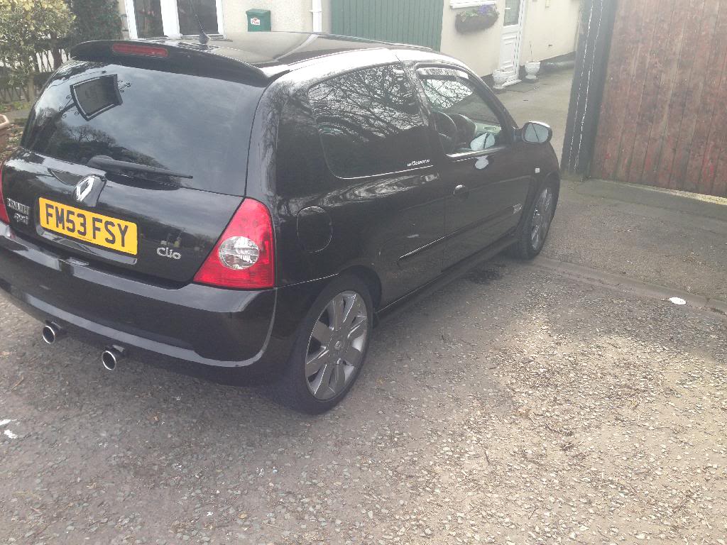

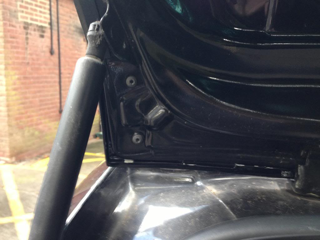

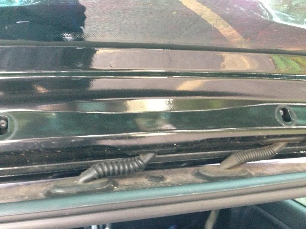

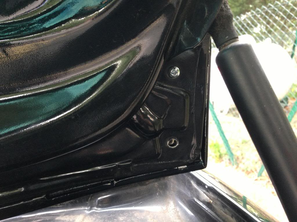

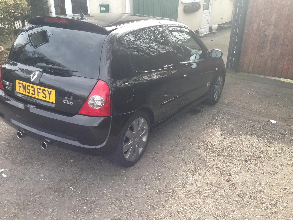

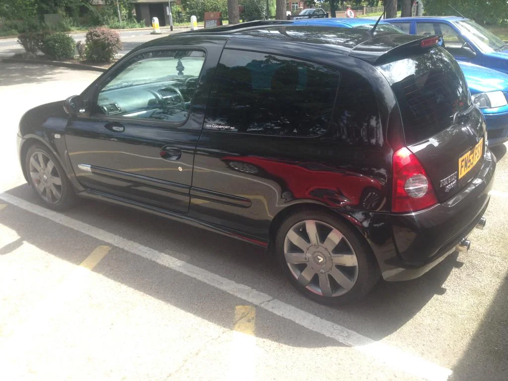

anyway, the spoiler will sit a little funny when the clips aren't properly in, i lined mine up as best as i could, then had my mate hold the spoiler into the bootlid and (if this makes sense) held it up, to stop it falling into the gap between the roof and boot. So up and in, the put in the two centre screws first, That should pull the spoiler a little more evenly towards to boot - just make sure they are going into the holes!!!
Then, I got my friend to hold the drivers side in next, I put the two screws in there, then the two on the passenger side. with him hold it up and into place. It sits maybe 2mm higher on the drivers side, but with a lot of pushing and shoping, it wouldn't go down and i was happy enough anyway.
There isn't much space to tuck the washer pipe and plugs away, so i suggest you just cut them off and join them together, then either cut or get creative with the washer pipe. for me - the biggest issue with it, was it getting wrapped near where the centre screws go into the mount bits!
