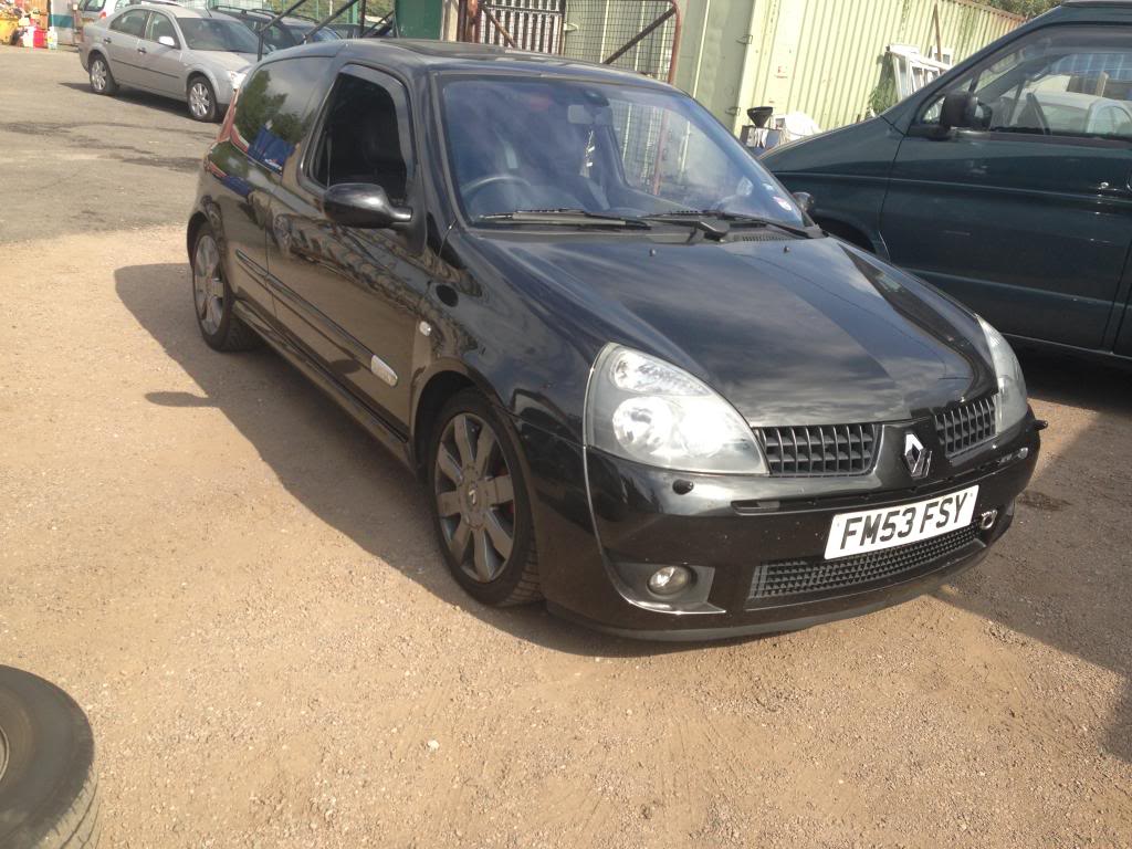

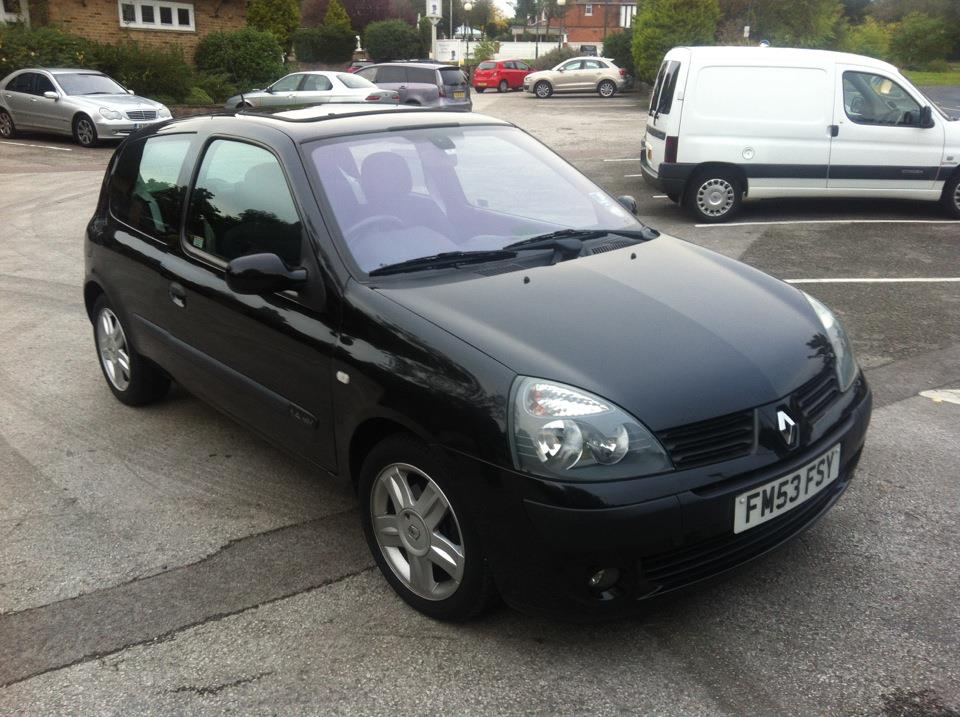

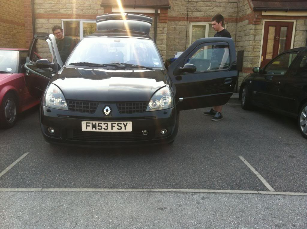

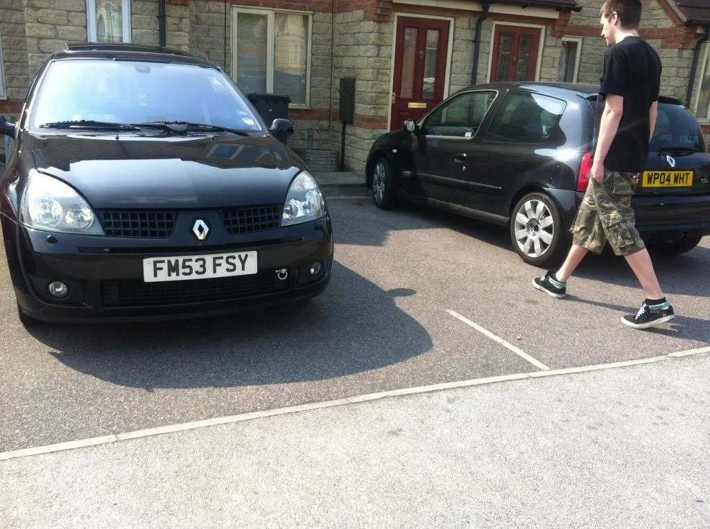

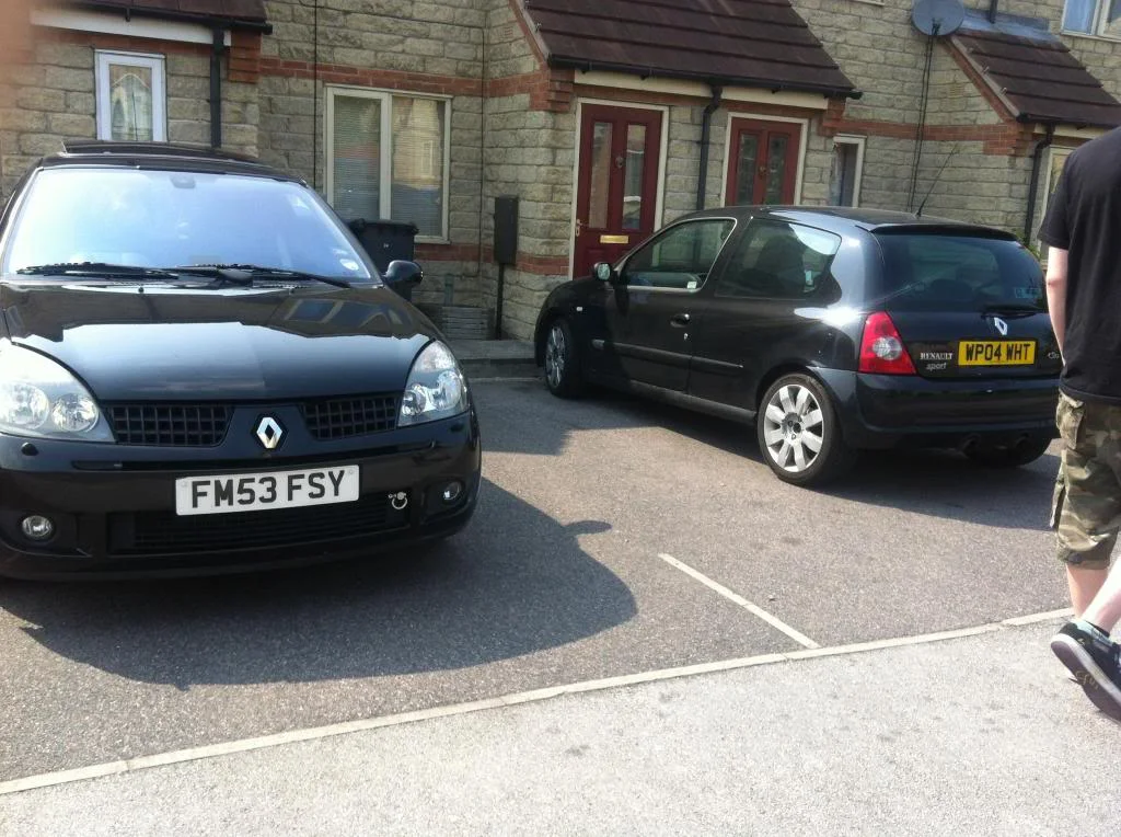

Anyway found the place, Red MR2 on the Drive and the coveted BG 182 (you lot probably don't know that I took a few stalkerish photos.. but I did lmao)
Heres the two in comparison, apparently mine being the cleaner of the two (; with my mate also in the shot:

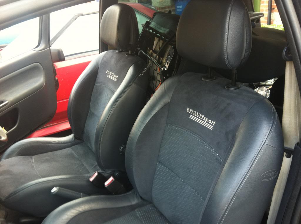

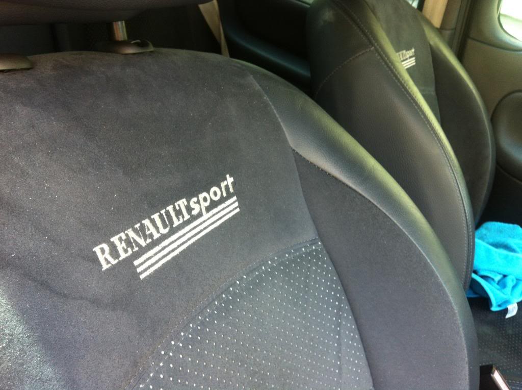

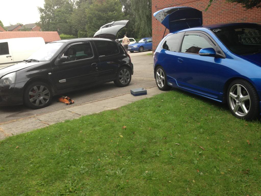

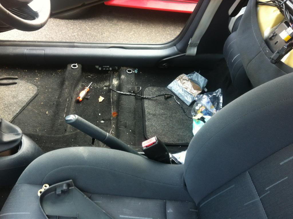

I'd Say it took a good 3 hours to install the front 2 seats. Had a good laugh though doing it, including getting called a "Faggot" by a local 9 year old at one point hahaha.
and heres the legend himself in action! Unfortunately for him anyway..
Just realized how amazing the reflection in the car is ha

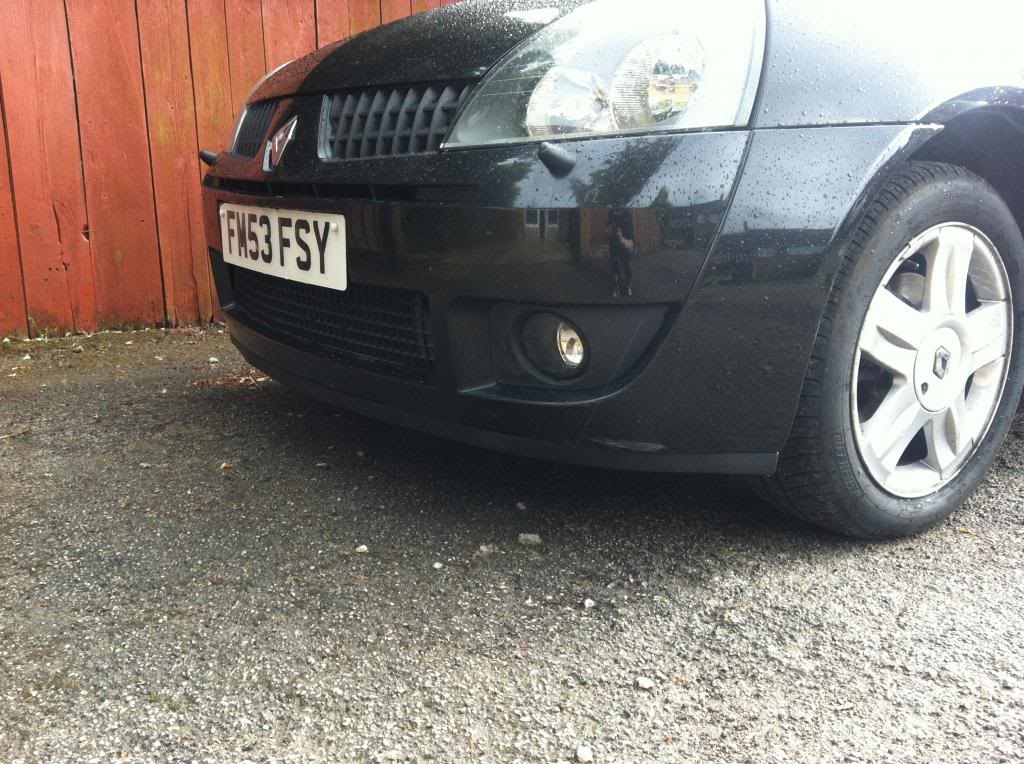

Desperately needing spacers for the front wheels!
Another random shot:
One seat out..
you can just make out what my original seats like were by the passenger seat:

and then 3 hours, load of laughs, swearing, being called by small children, seeing too many cats including a sewer cat.. we, well they got the seats in!
Absolute credit goes to you two, full on legends and great lads. Loosened the back bolts for me too so I can go pester my bro to install the rear seats!
Feeling part of the CS community now meeting a couple of you, great people!
Hats off any many thanks to you again!

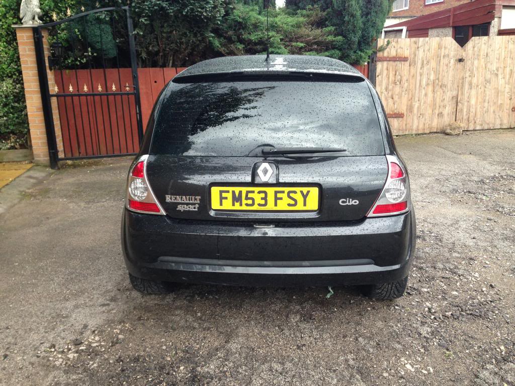

Looks good.
I believe the sports are 30mm overall wider track, so 15 each side, However you could convert to sport front end, (wishbones, hubs, brakes, arb, shocks), will give you the extra track, ideal for adding spacers onto to get the wheels sitting perfect, plus bigger brakes and thicker ARB. Can be done quite cheaply.

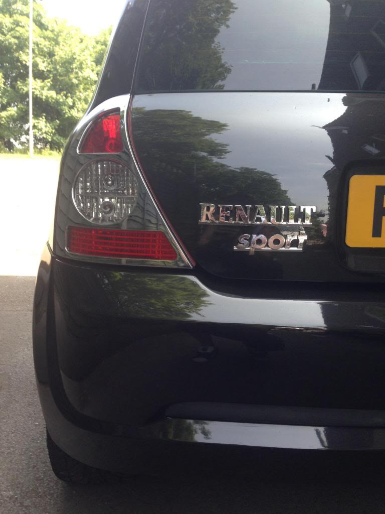

Nice one Joe - cars looking good (tho have to agree with others RE: rear lights!:quiet:) trust you found your way back out the sticks & home alright! Christ knows how you've kept a black car that shiney though, mine just gets driven & stays loppy! :o

Coming along really well, I like it. :)

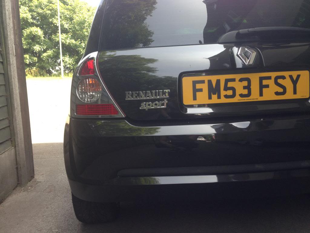

As most people have said... The rear lights, go for normal or maybe geta tint spray and "smoke" them but don't fully black them out as IMO it would be too black at the back then.

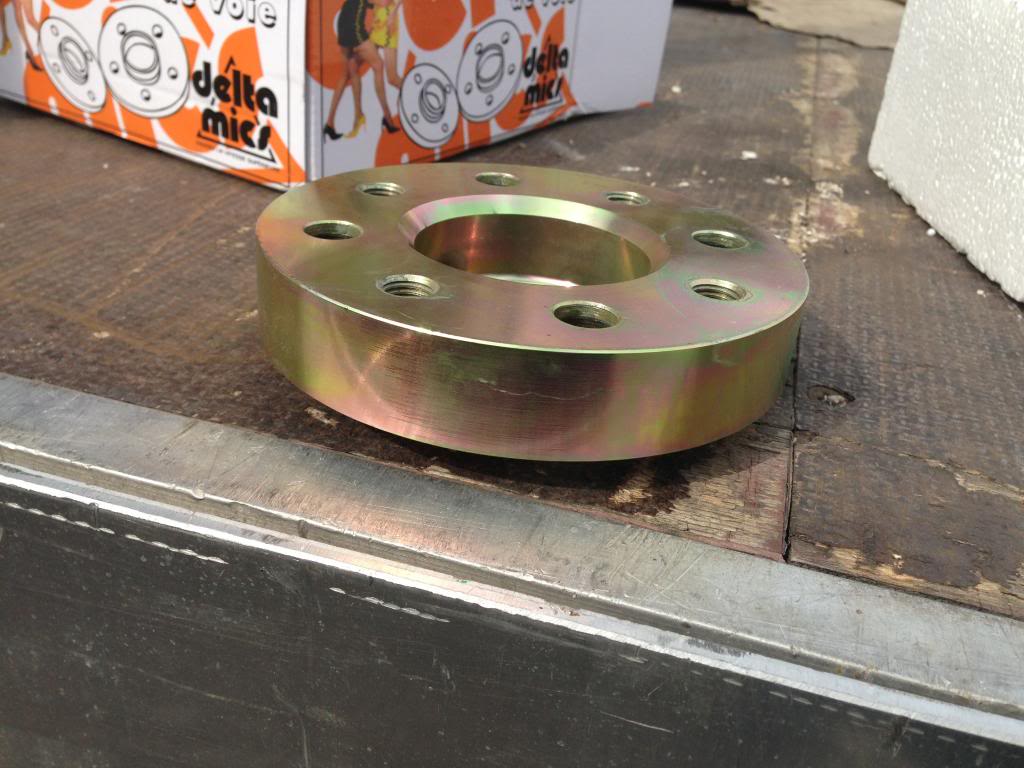

15mm spacers for the front then?
Its on my next "to do list" only just got paid so im gonna have to wait another 4 weeks but its defo the next mod that's happening.
This is what im looking at, could someone just double check this for me and make sure that I should get the 15mm or the 19mm spacers: http://www.k-tecracing.com/show_product.asp?id=4591&appid=4

Whats with the hate on my back lights haha! I still really like them at the moment. think of it this way, if you never saw a clio properly.. didn't know the difference between sports etc etc then came across this back end.. me personally id be impressed with it! to be honest out of everyone whos seen them, even my non car minded mates think they don't look good. Think its just me and my dad who have a fan club for 'em.

No hate on your back lights from me, just not my cup of tea - the important thing is that you like/are happy with them! Each unto their own, the world would be boring if we were all the same & its better that you've gone (and stuck) with your own direction on it :) best to see your brothers mate on the airbag connectors sooner rather than later...sorry - ran out of patience! :$

Those Ktec spacers are for your car & would help finish it, though couldnt advise on the depth needed - it would again be down to preference/any rubbing issues - to be fair to them, I have always found their mail order really helpful - give them a ring if you need the figures above confirming :) Sport front end is not bad advice tho - you're essentially making a 182 as you can afford it :)

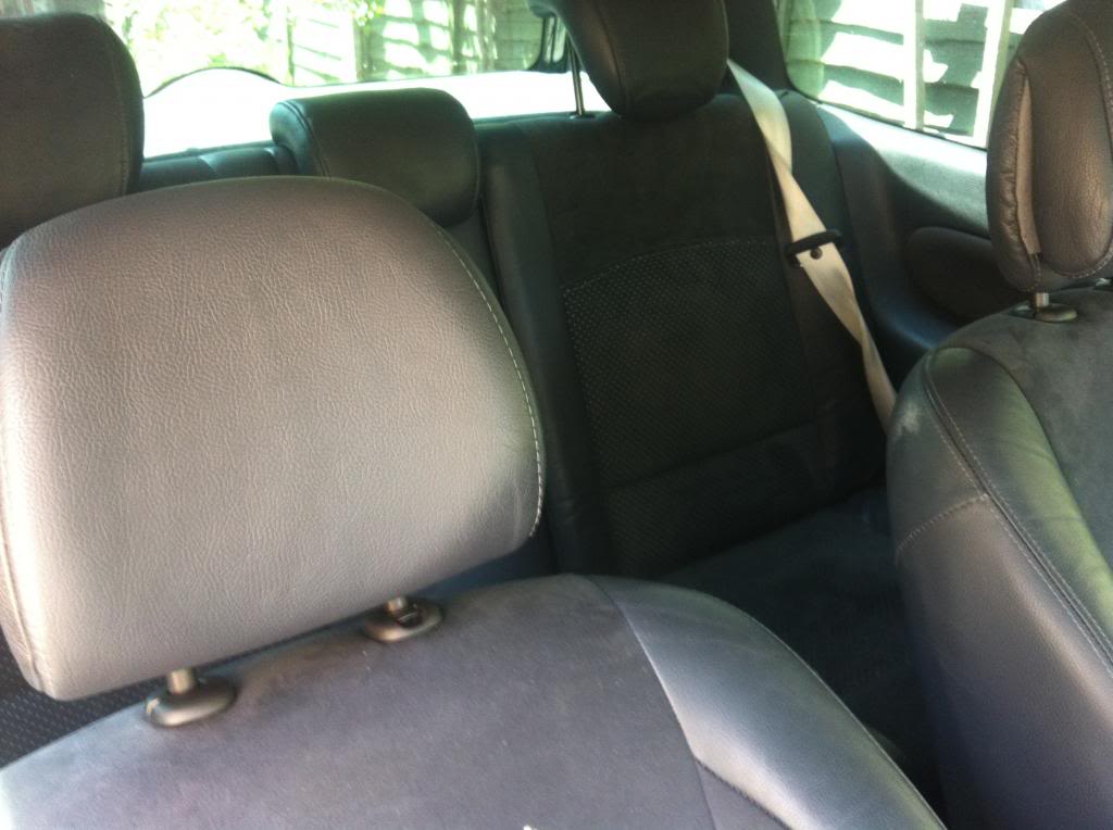

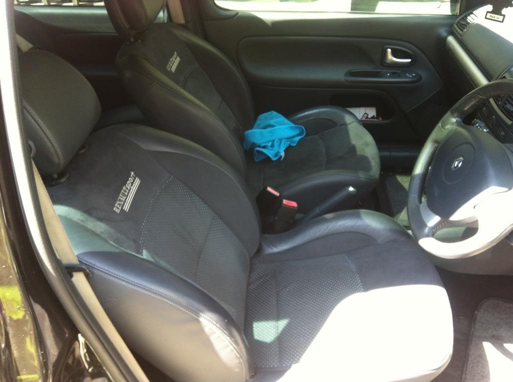

Tiny update:

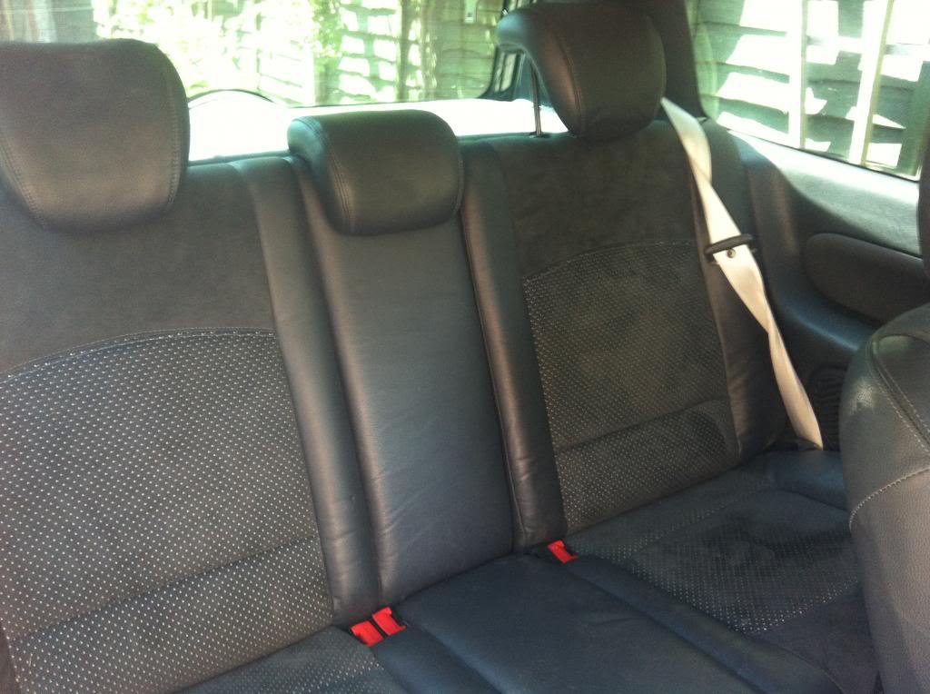

Car interior is now pretty much complete!
Full 182 Front and rear seats.
Got the back seats out.. after some hard sweating work.. actually pretty annoying! but in the end we got there. I actually helped on this one and put some sweat into it!
Heres the finishing product!

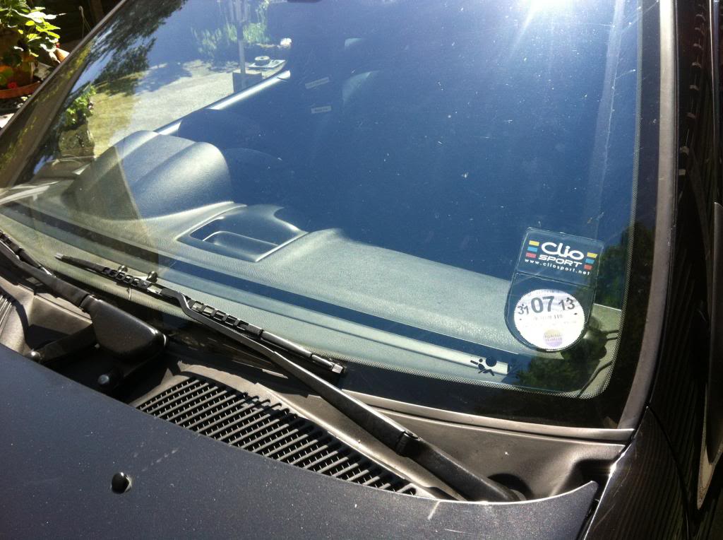

Also the Welcome Pack finally came! Rocking the tax disc holder.
Not rocking the rear window sticker as.. well my tints are too black.

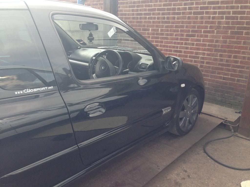

Planning on getting 2 smaller www.cliosport.net white outside stickers, one either side of my 2 rear windows, or get custom made ones thisisnotacliosport.net.

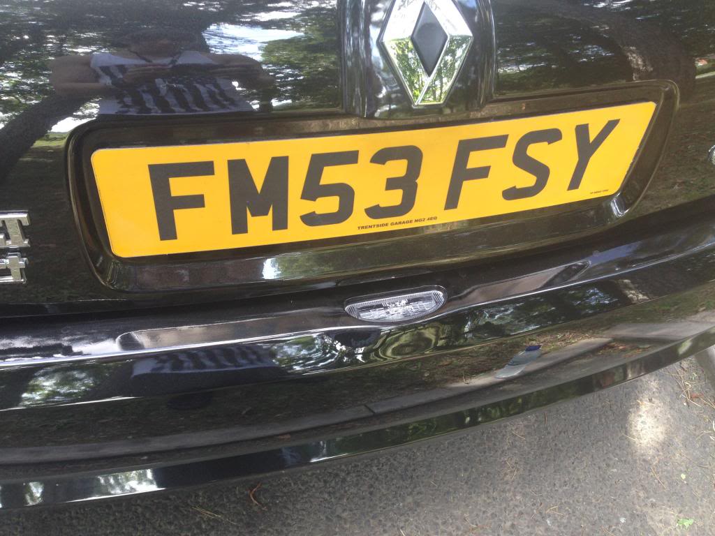

As for the bodywork...
Rear bumper is a straight swap, undo bolts, stick new one on.. sorted. our standard Rear Arch liners are about 1cm smaller (172 rear bumper is slightly wider) but ive left the rear arch liners as the 1cm gap is hardly noticeable.. at all. I only notice it because its my car haha.

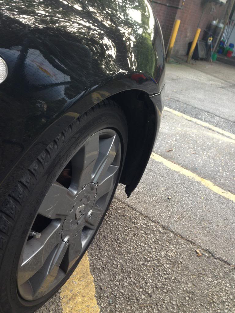

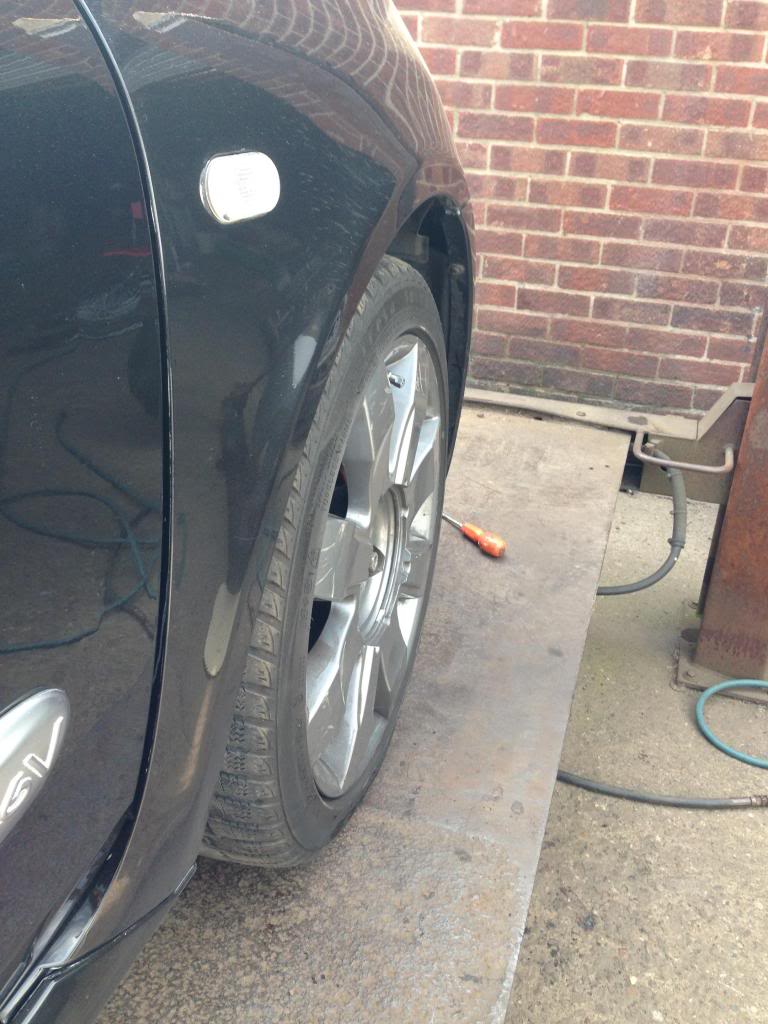

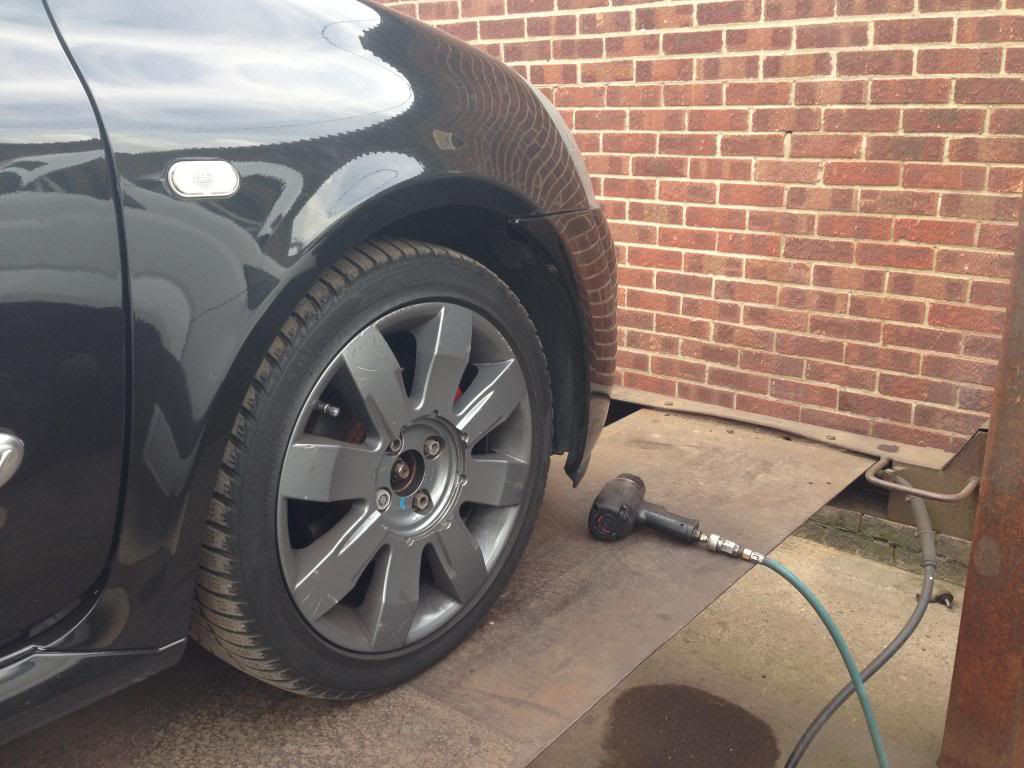

Will it not look odd adding spacers onto the front wheels and not the rear?
Cheers mate appreciate it..
Ive already thought this. ill have to show you what I mean about the sunken in gap on it.
The front 2 are sunken in quite abit as you could probably see by one of the previous photos.
The rear however are about only sunken in about 3cm. That is hardly anything, it looks fine. But to me I don't know whether to be picky and space that out.
Ill upload the spacer photos next month when I get onto it. only doing the front 2 for the moment.

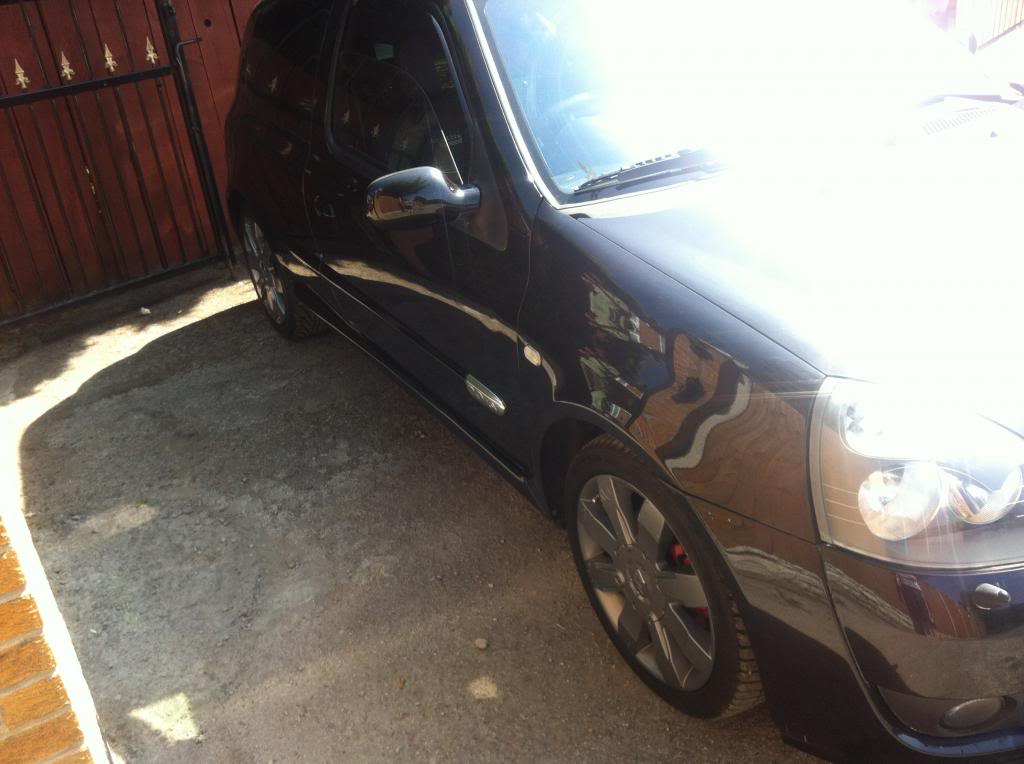

It was my birthday on Thursday (jul 11th) what better way to celebrate it than finally getting my skirts fitted haha.

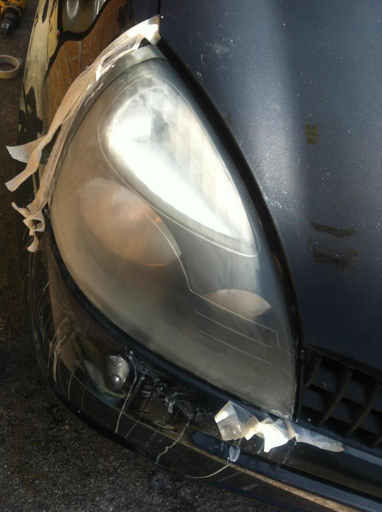

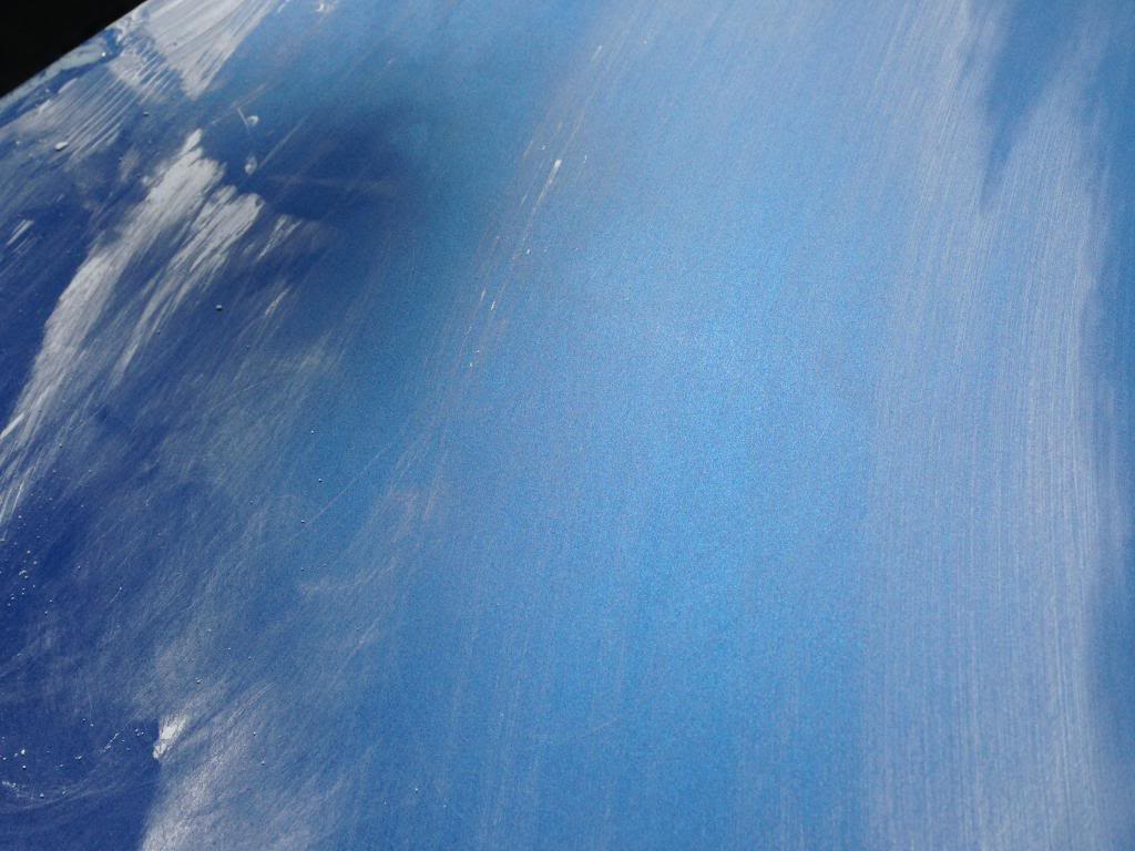

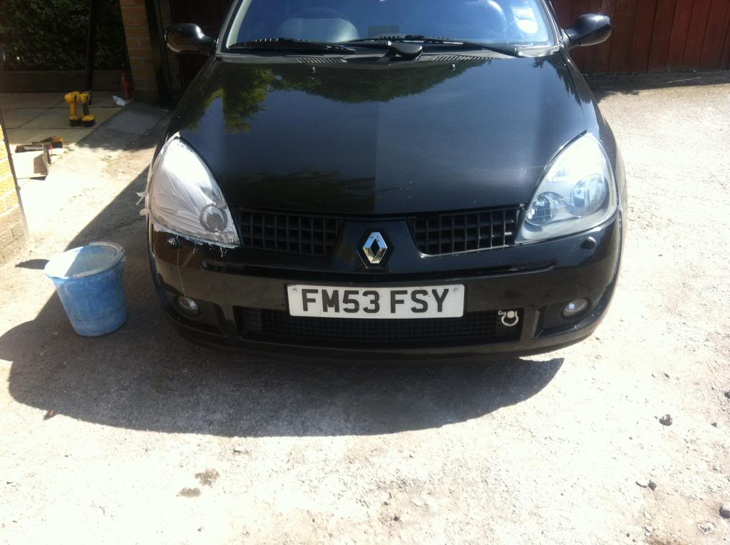

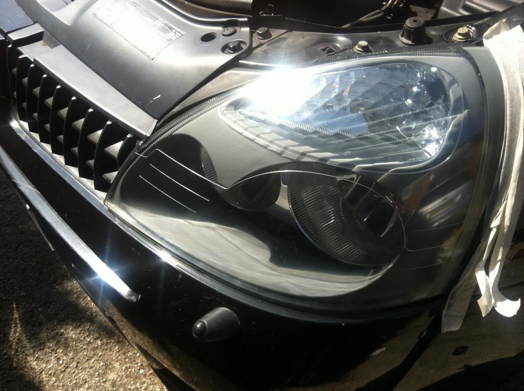

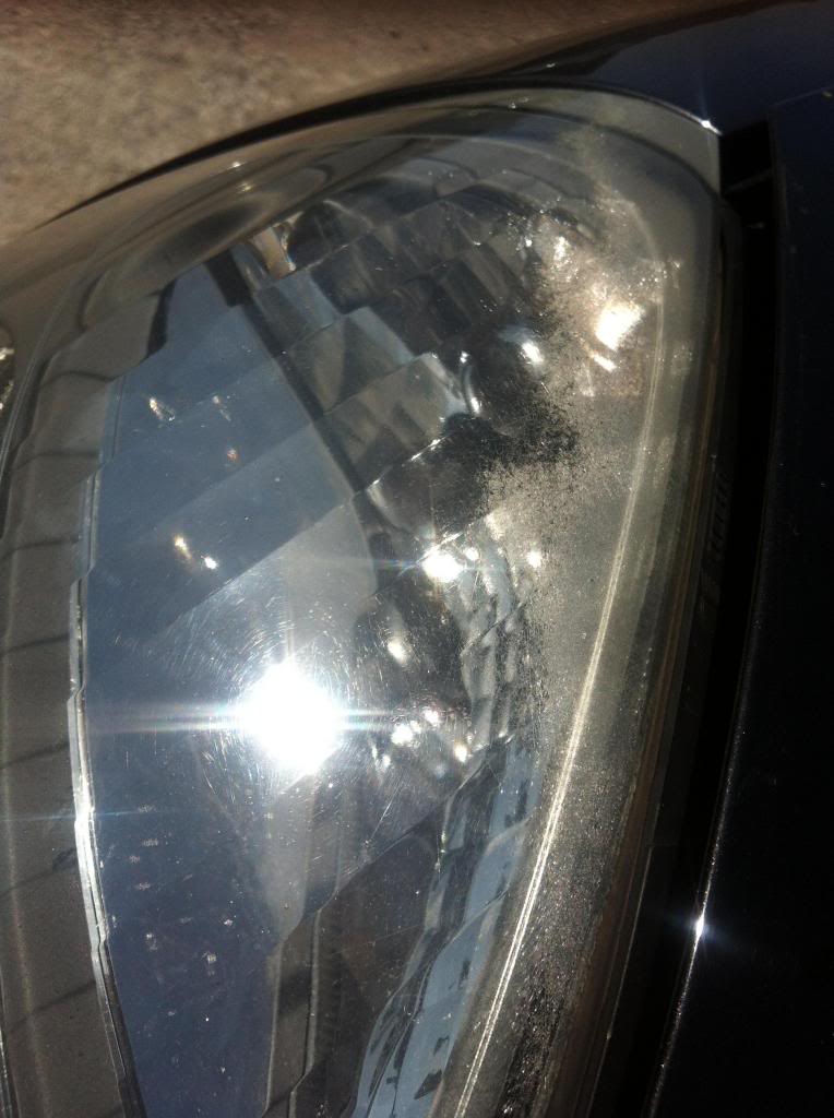

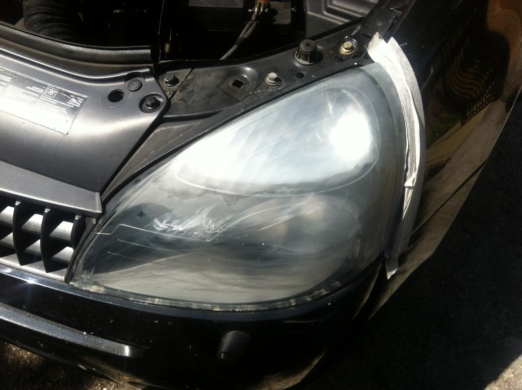

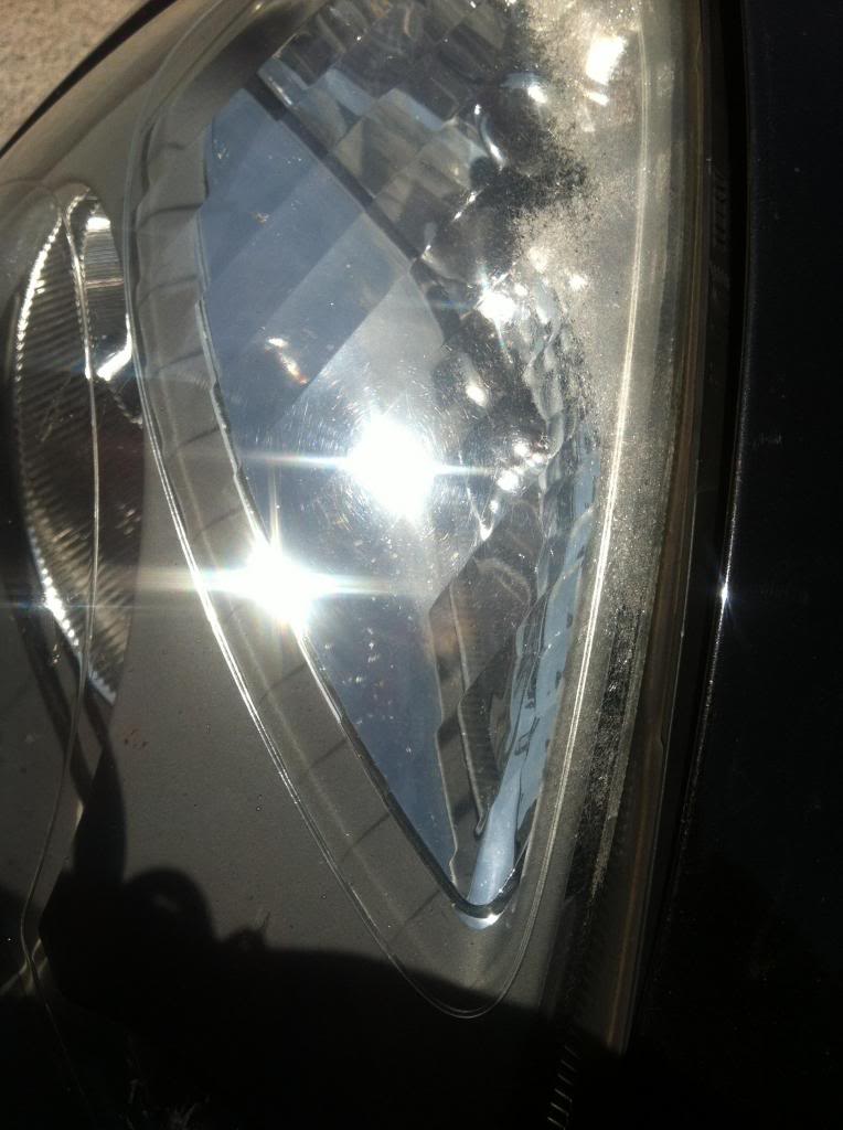

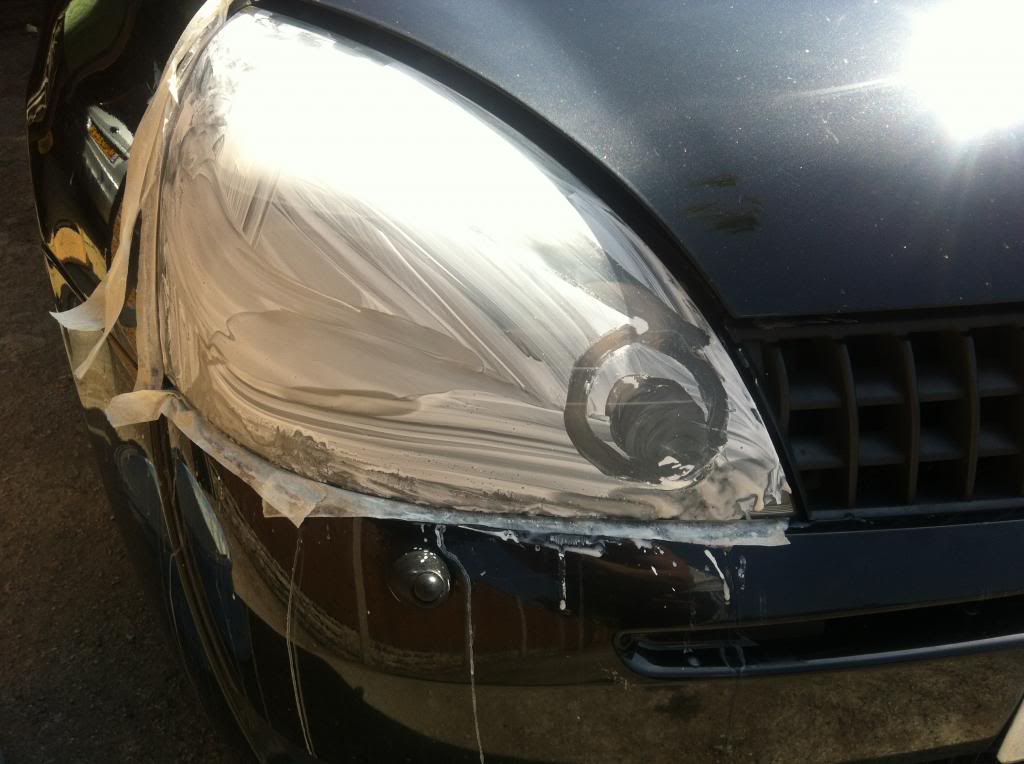

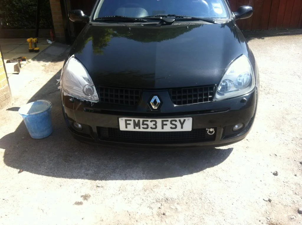

Also sorted out my hazing headlights and got some clear indicator bulbs for my front end!
Heres some before shots of my Hazing:
And heres some during shots:
Realised when I sanded down (only used 1200 I think, or something even lighter) I was actually taking a layer off the lights, so I couldn't just sand the hazing part, I had to do the WHOLE light -_-
and heres the finished product:
Also the clear indicters have made a huge difference.. to me.
Yeahhh these photos suck ha. Have to get some better ones soon

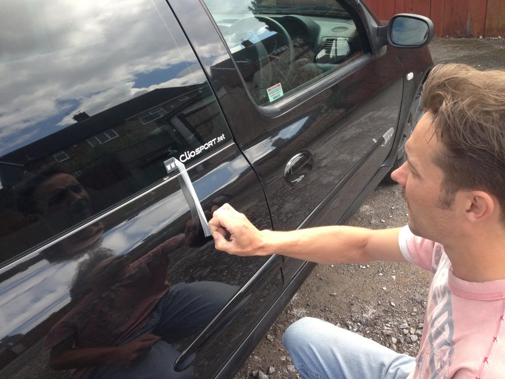

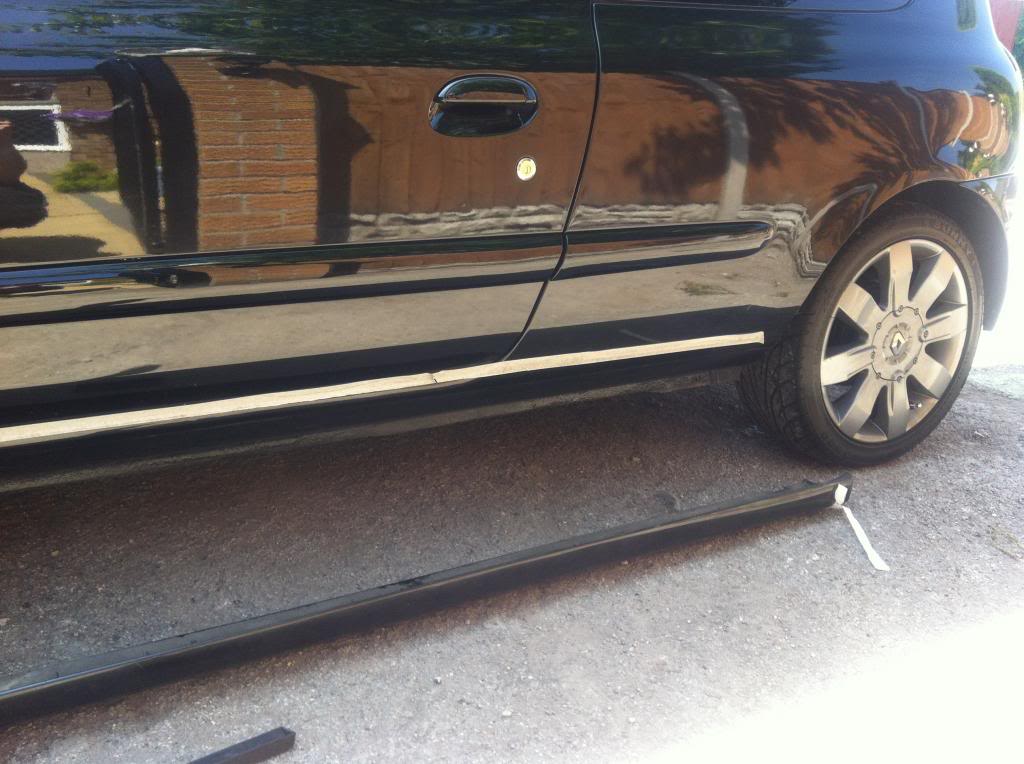

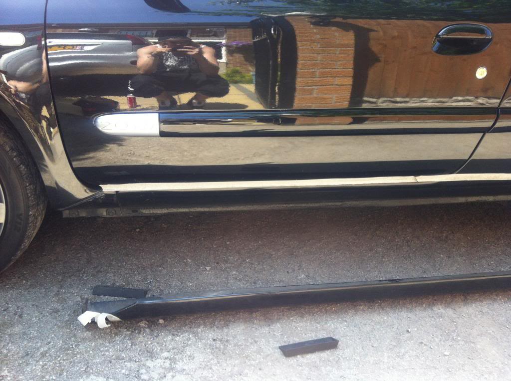

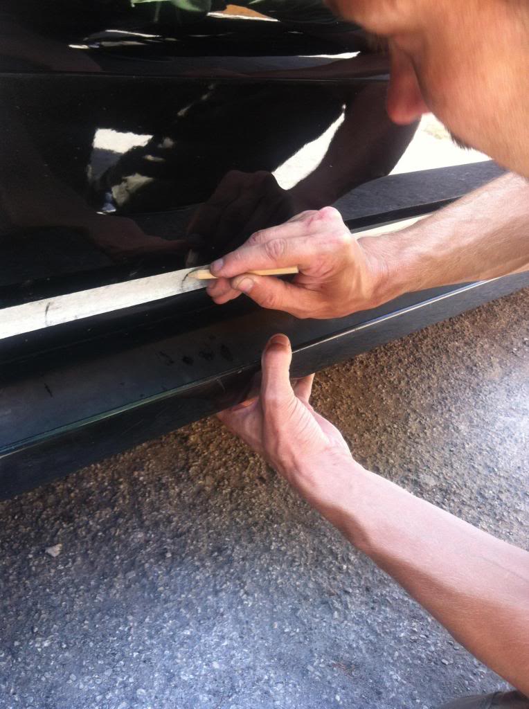

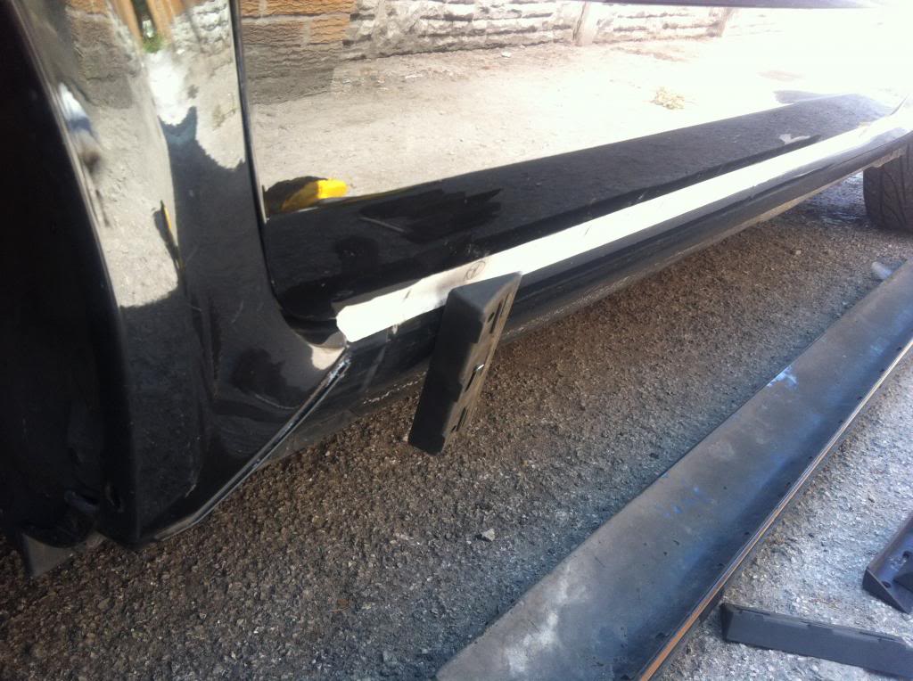

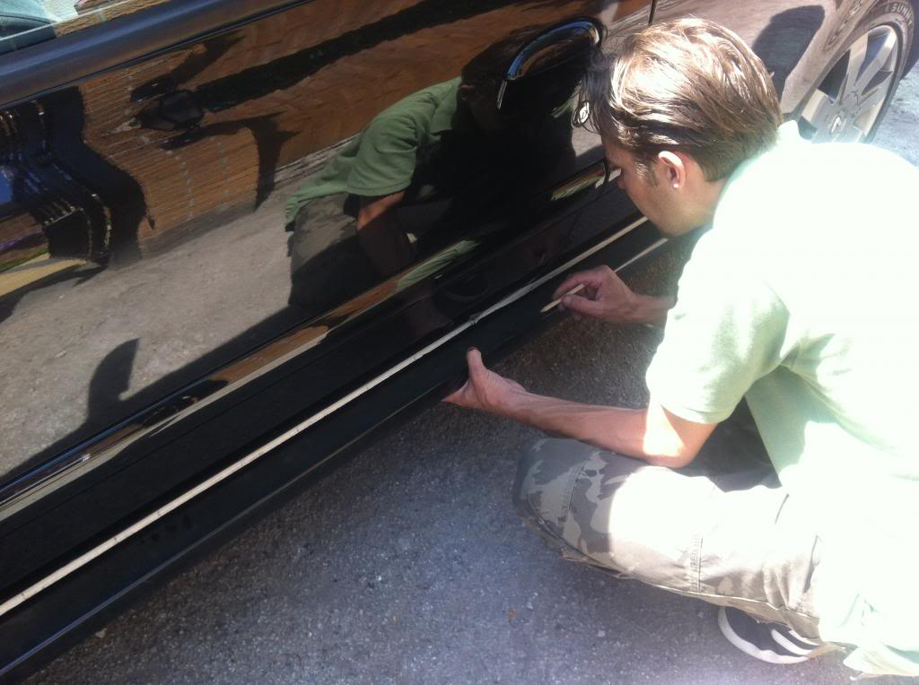

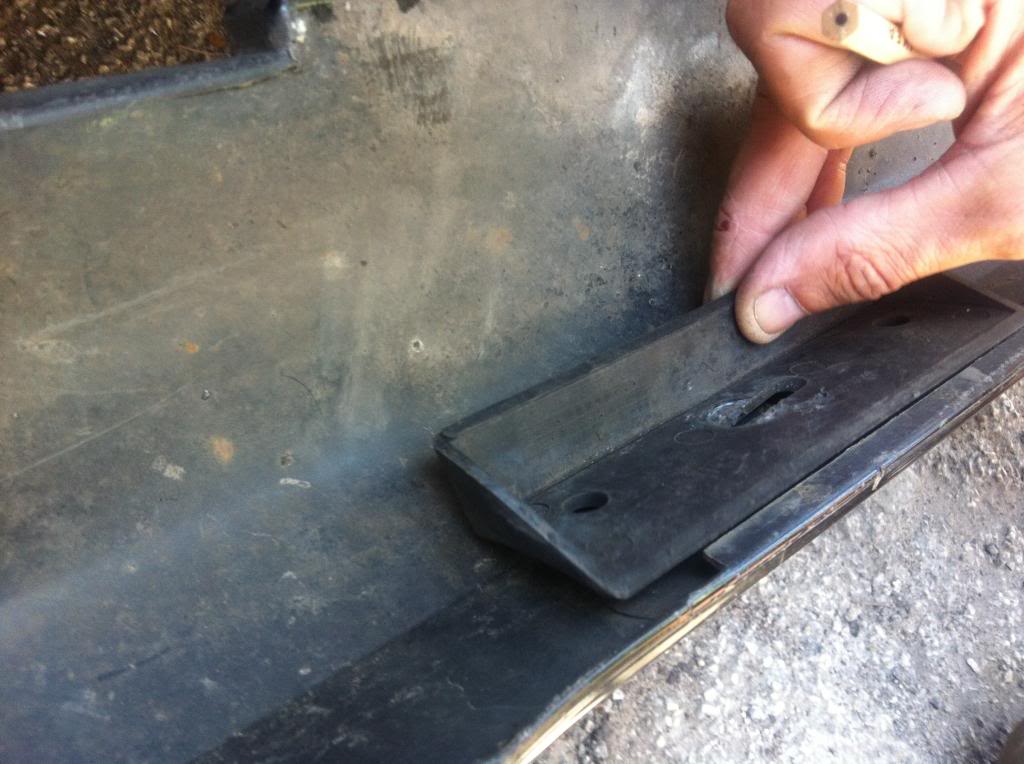

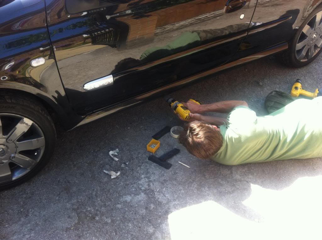

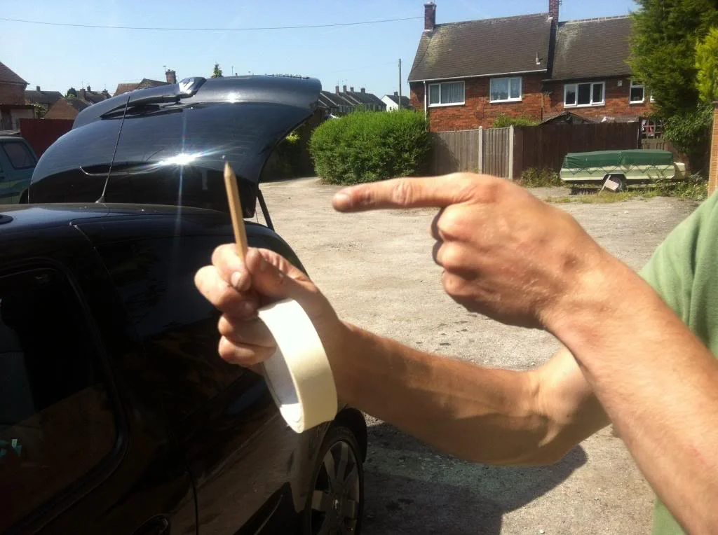

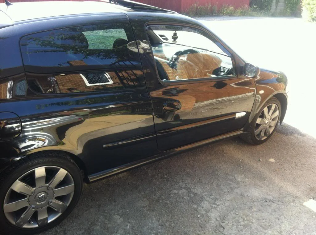

But onto the Sideskirts!

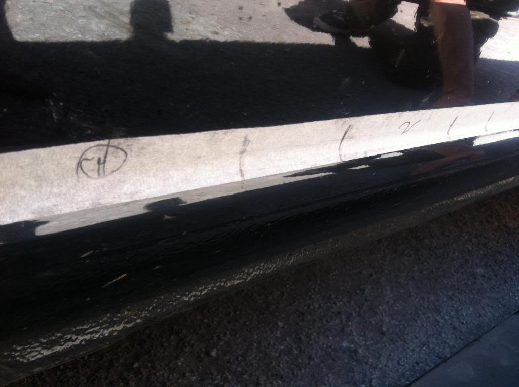

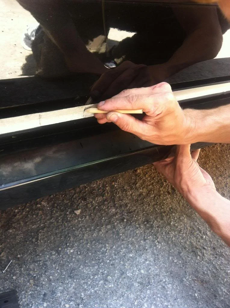

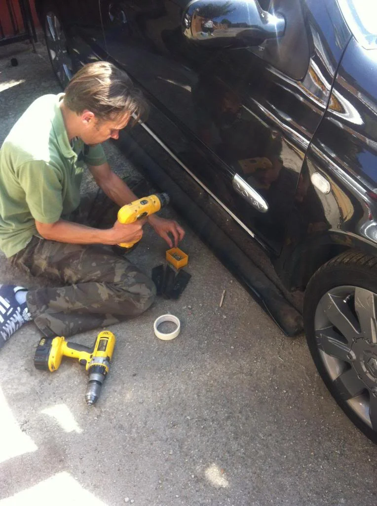

As we could barely find bob all on how to fit these to a non sport we decided to take photos in a kind of step by step tutorial for anyone else out there who like us, were unsure on how to actually fit these to a non sport. This is our way of doing it. this is a 2 man job by the way.
(if this little guide is worthy of being put in the "How To" section then someone say and ill do it, otherwise its staying here haha)
Things Youll need:
Sideskirts
Sideskirt clips (we had all 16 but used 14)
Pencil
Masking Tape
Screws
Drill
So!

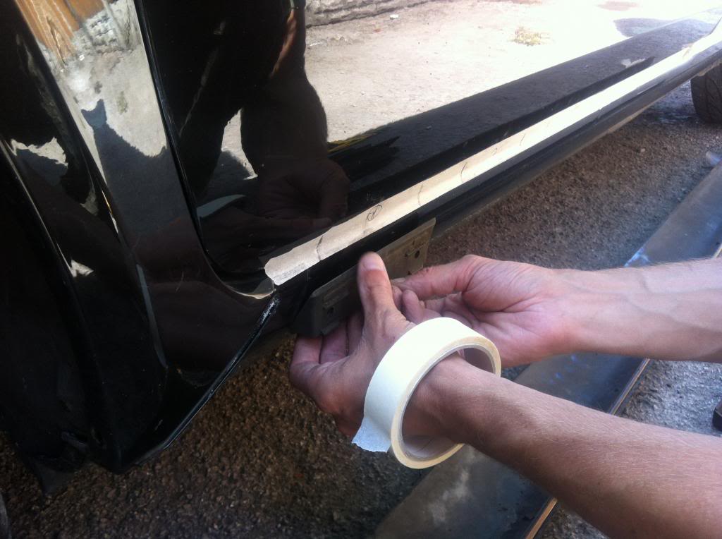

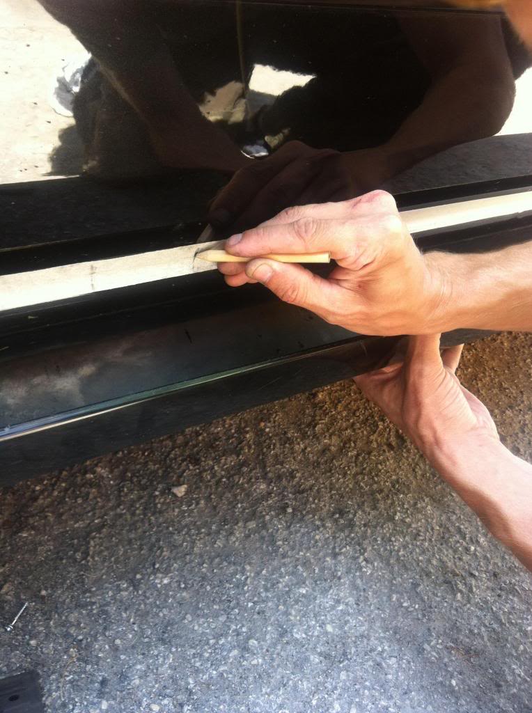

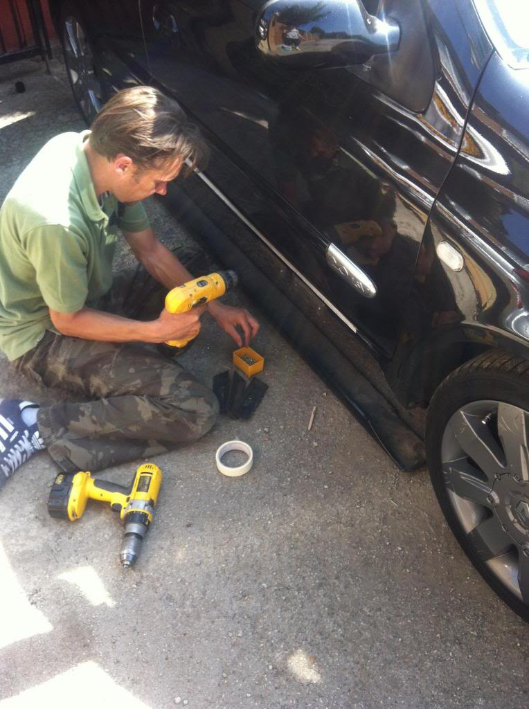

Step 1:
Hold skirts into place where theyre going to go exactly, then get someone to masking tape directly above as close to perfect as you can get above where theyre going to sit:
Step 2:
acquire a pencil:
Step 3:
With the clips, hold them in place where theyre going to sit:
Step 4:
With the clips being held in place, hold the skirt as close as you can back to the cars sill and with the pencil mark either end of where the clip is, then mark a number in the middle so you don't forget where the clip is:
Step 5:

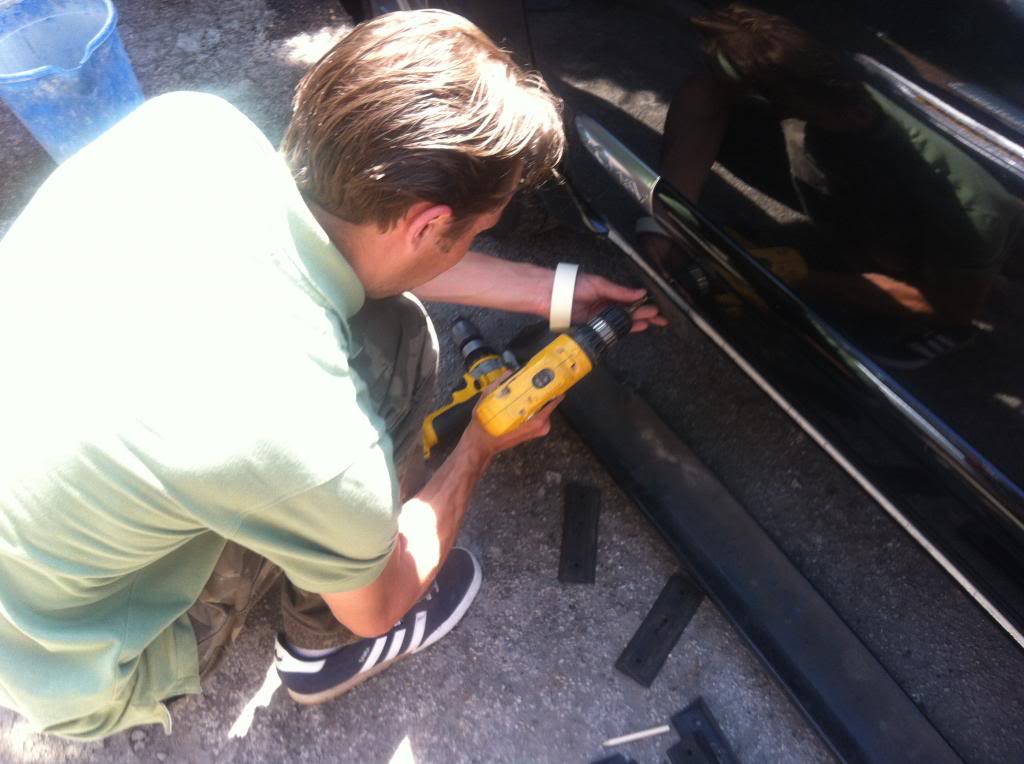

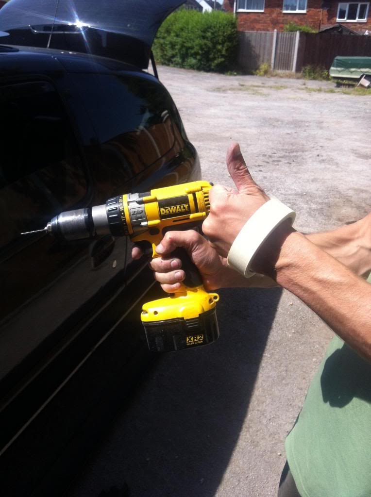

Acquire a cordless drill:
Step 6:
With your clips now marked where they should be, hold them in place, stick in a screw (preferably with a washer) and drill away:
Fail:
Anyway repeat the previous couple of steps all the way down, we only used the one screw which is in the middle we did 7 either side.
Then screwed 1 into the side of the wing as you can see the hole in the photo above in the wheel arch. and then bolted the rest of the screws on under the skirt which youll see under your car.

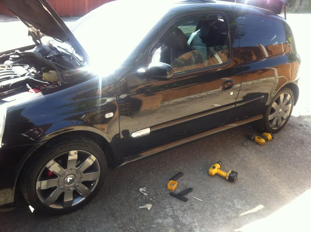

And then we have the finished product, boom!

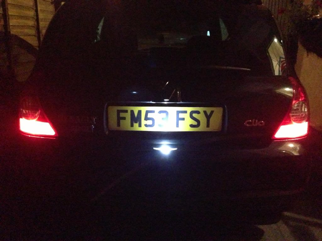

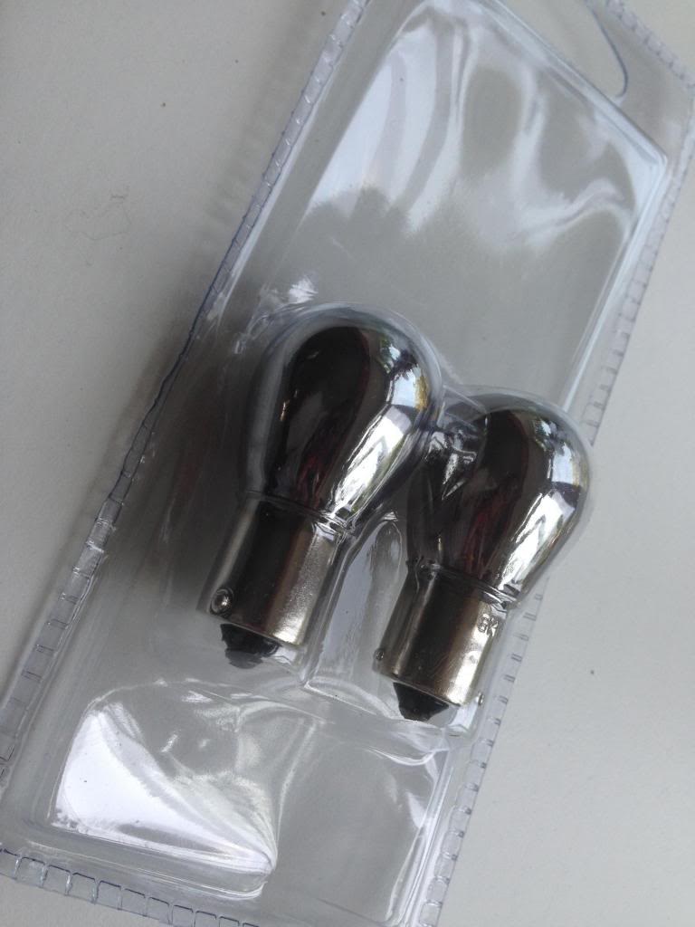

Tiny update, got Chrome indicator bulbs all round now! theyre the cheap 3quid ones off ebay, seem to do the job! all work.. so far.
Before:
After!:
Also I did the mistake of waxing the whole car in the scorching sun, so after 2 hours and sunburn later I have this! I call it.. the mirror and its dog.

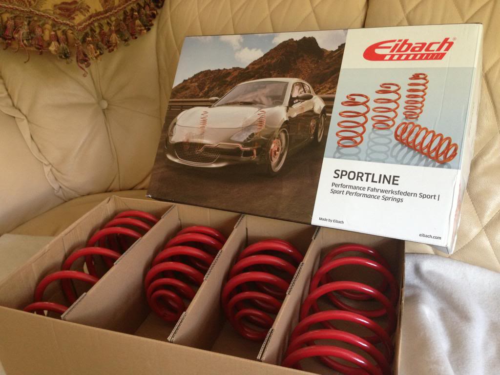

So the first thing I bought are these:
http://www.kamracing.co.uk/car-tuni...k2-all-excl-1-2-eibach-sportline-springs.html
Just waiting on them to be delivered!

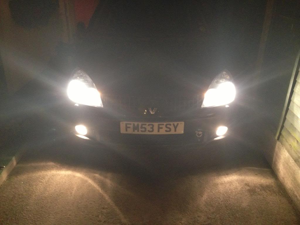

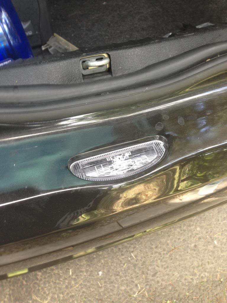

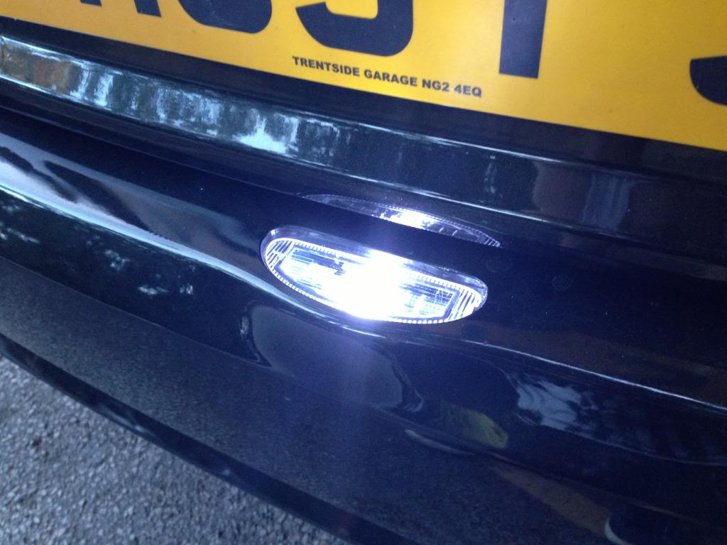

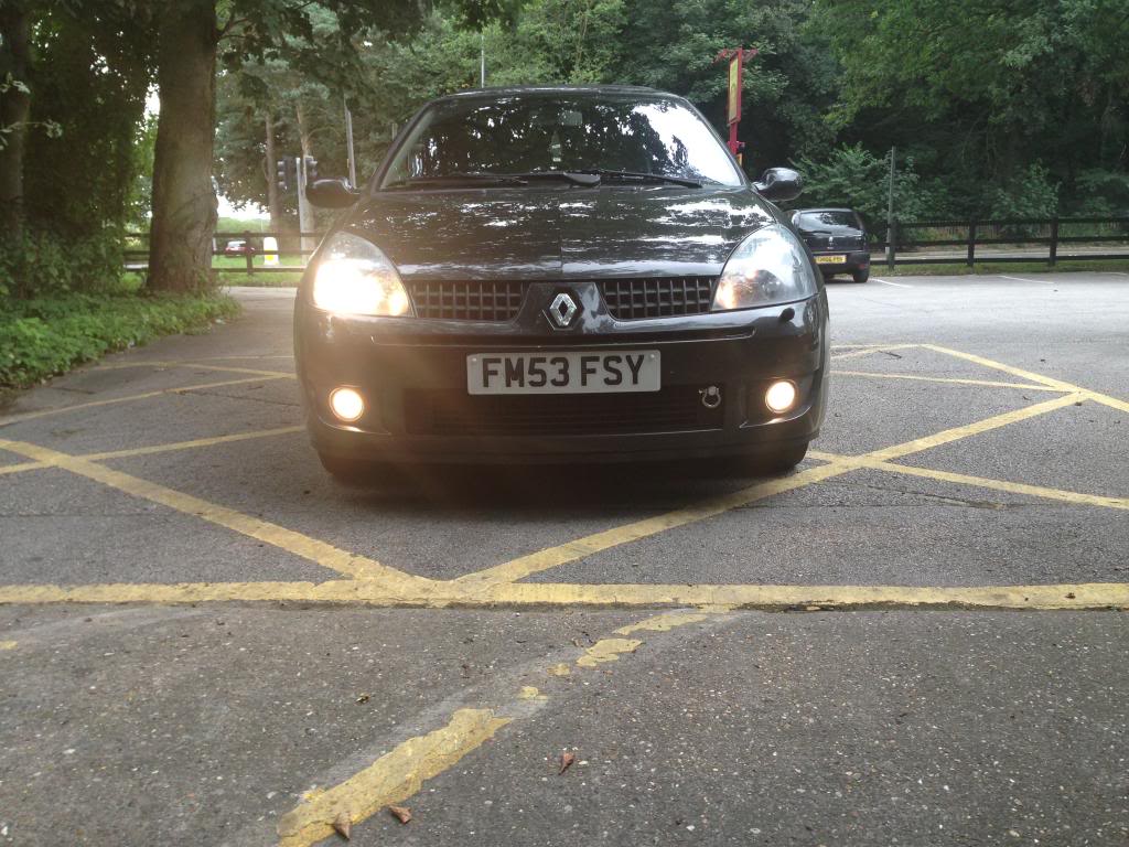

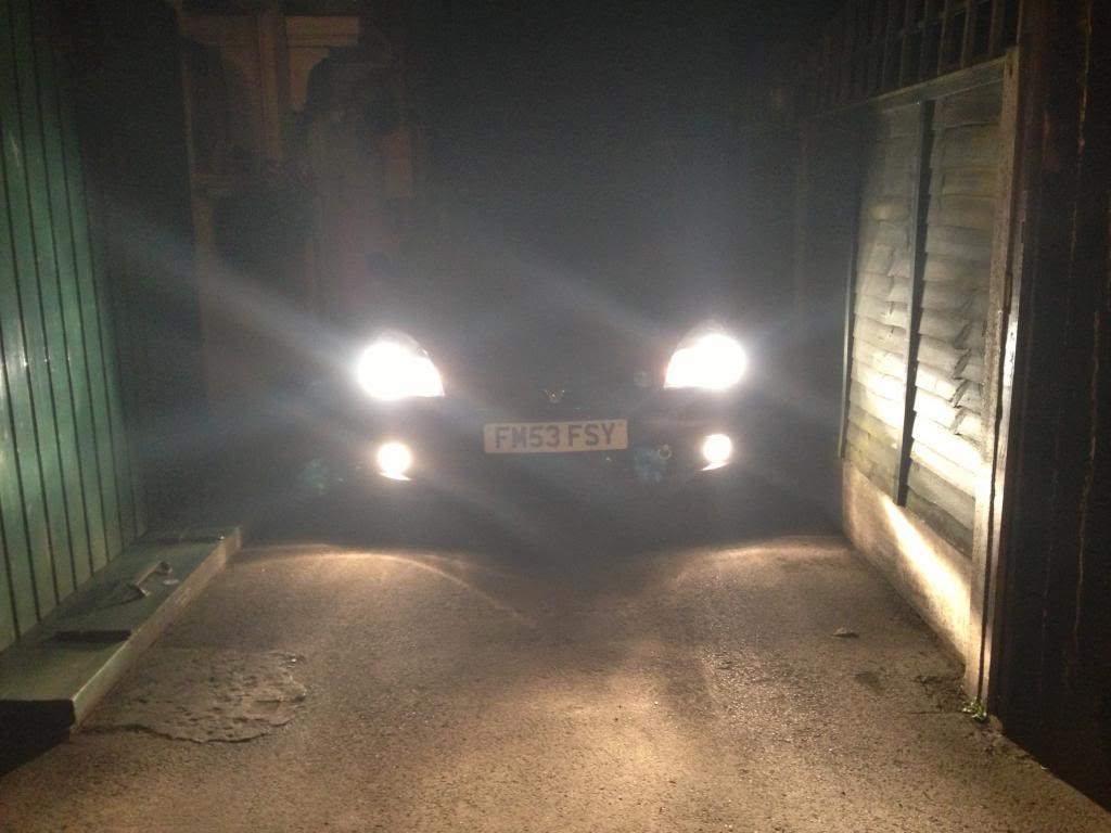

Also my cars headlights are standard bulbs, and ive been driving around with them like this for around 7 months now:
Standard Halogen bulbs, one of them being popped for what feels like decades now.
So I went out and bought some 120% brighter bulbs!
theres hardly a difference between them being on and then putting my main beam on. Im now one of those dicks who have headights who blind you no matter what I do.

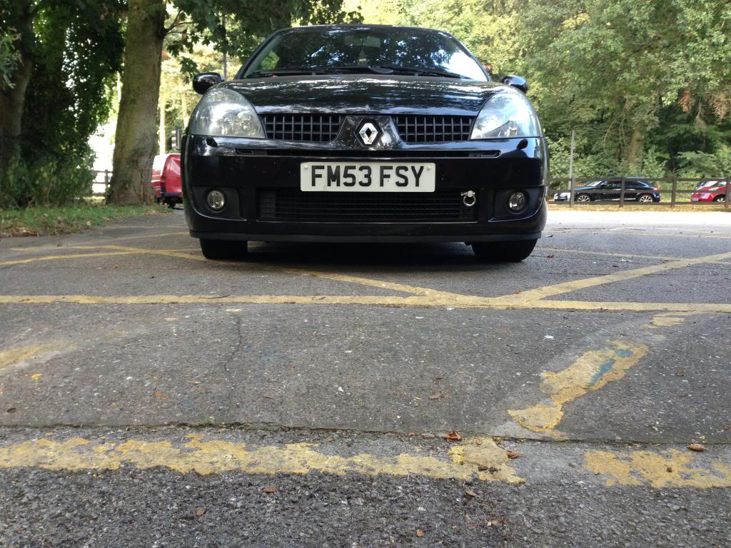

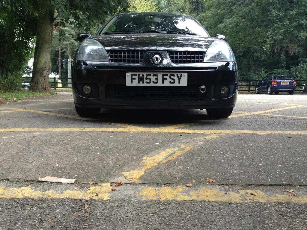

and to all your disbelief .. I finally gave in:
Before:
After:
The lights are back to standard!

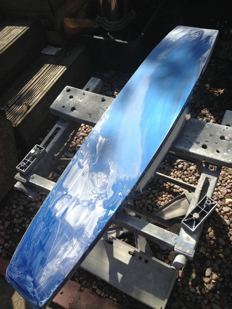

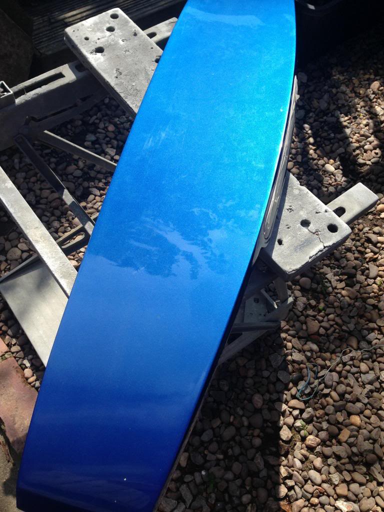

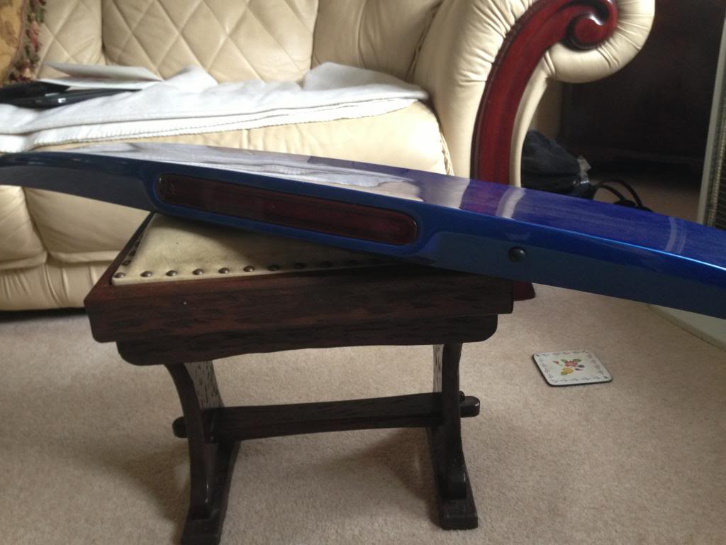

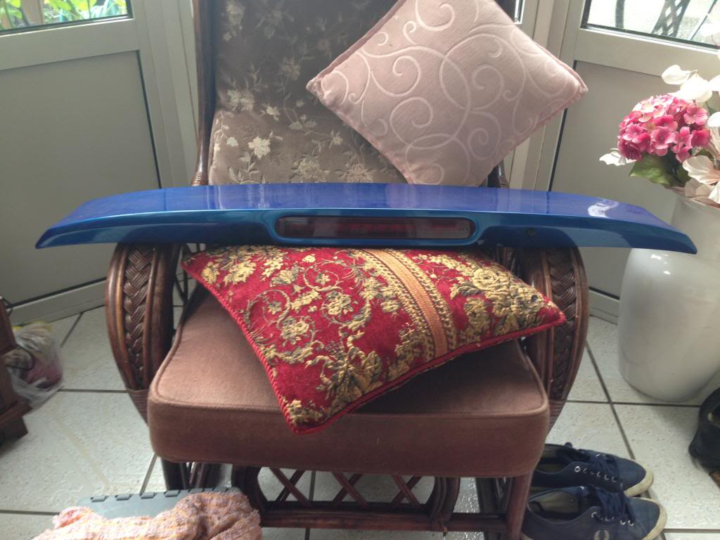

Also bought this, waiting on it to be delivered and we'll get my bro onto spraying it!

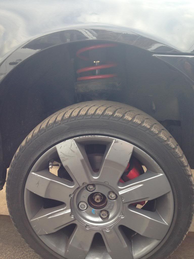

- Install Lowering springs, once theyre in I can figure out what size spacers I need for the front 2 wheels.
- Paint cup spoiler and install!

Looks good!
Although you beat me to the cup spoiler ;)

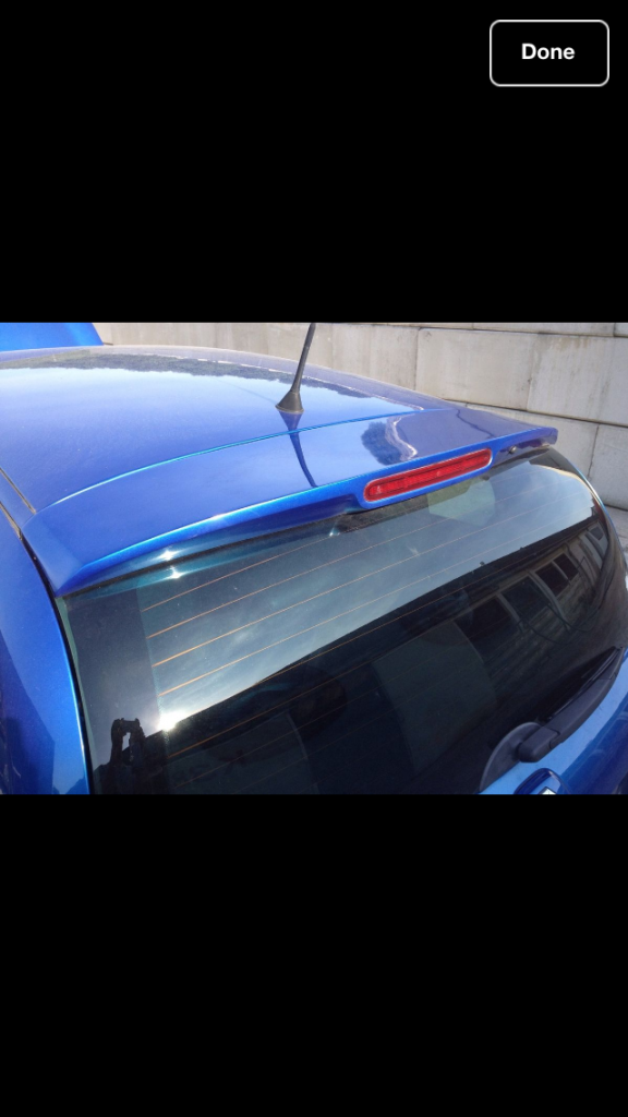

Haha did you have your eyes on that same one too?
I posted a wanted ad on here for one, as idealy I wanted it already in black so I can receive it and whack it straight on rather than the ball ache of sanding it down and re-painting.

Another update:
Springs arrived in the post today, WHY the courier dude had to come at half 6 in the morning is beyond me, had to shout from the upstairs window telling him to hang on as I fail at putting clothes on.
Happy days right? Went to go get them fitted.. quoted me 120 to fit em! W.T.F, that's pretty much just buying them over again. Rang a few mates, got a deal for 60quid, mate of a mate whos a mechanic supposedly to fit them.. on his driveway? either way if hes apparently done it before and a 5year qualified mechanic then ill risk it. Going tomorrow morning at the crack of dawn!
So no springs fitted as of yet.

Boom! external stickers x2! went round to show the brother and get them on: this is what I now have (on both sides, same place, one photo though):
I like em! think they look the part. However part of me is thinking a few month down the line ill think they look tacky and end up taking them off?

Springs are on!
To my shock the lad that did it (friend of a friend) was only my age! Bit worried at first but this guy knew what he was doing, full credit to him. Pointed out things that's wrong with it that I didn't even know. Apparently my rear engine mount is either gone or on its way out.
Also!
My Drivers side spring.. ive been driving around in it like this for ages. Managed to come out of the top of its housing and start wrapping itself above! I noticed for ages one side of my car was A LOT lower than the other. ha! Sorted now.
Heres where it was done:

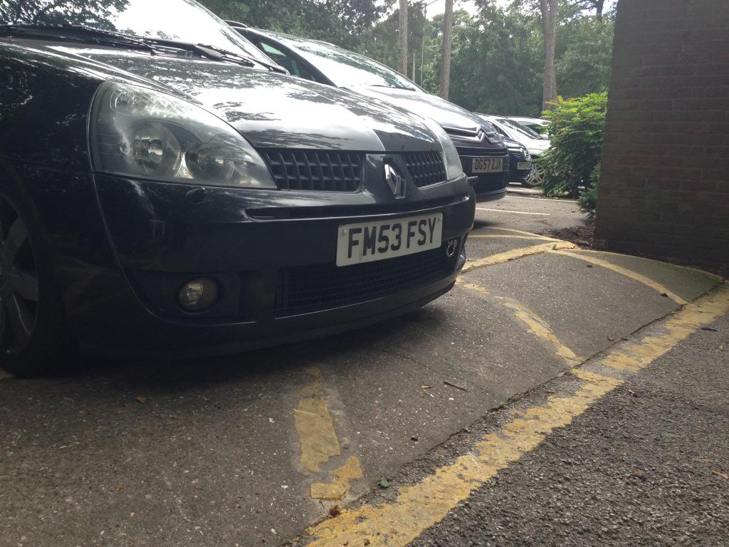

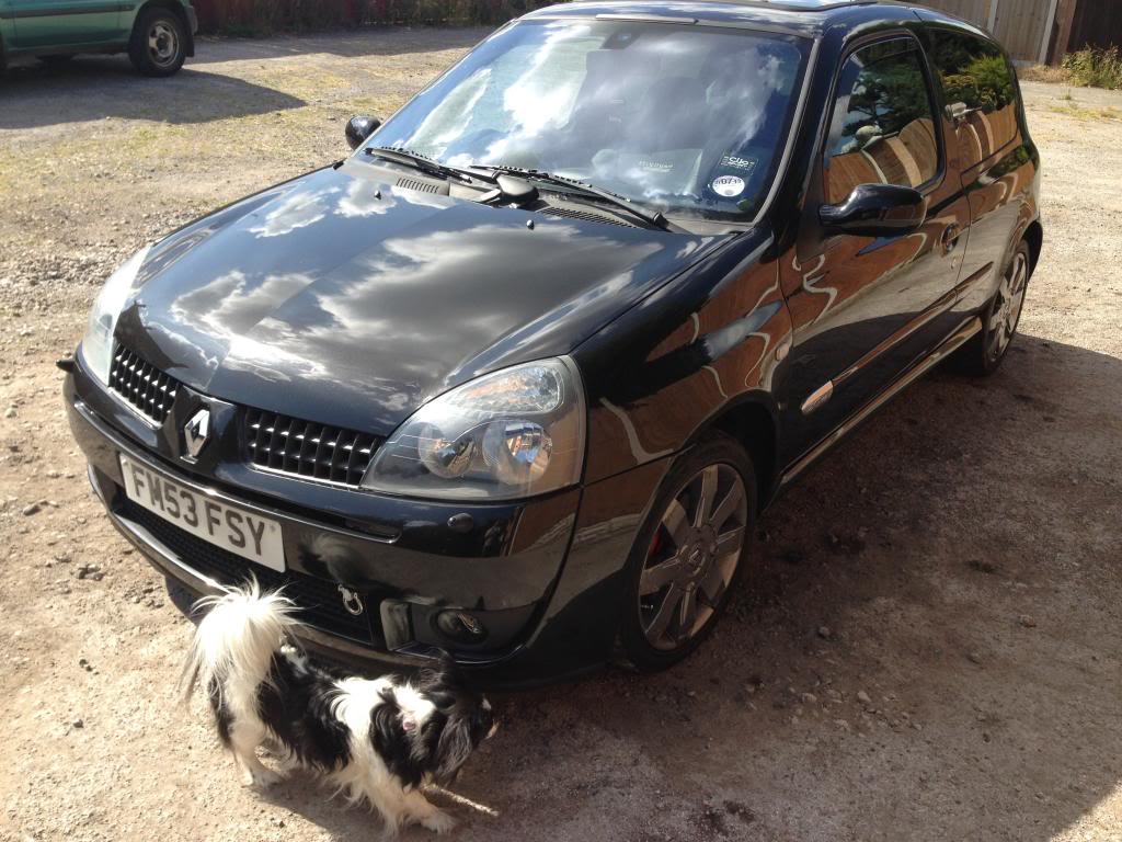

Heres a few before pics of my tractor:
(NOTE! You can barely tell much lowering in the front due to my wheels being so sunk in, next payday is spacers time as this is looking ugly like this! 19mm Spacers in a few week time)
Before:
After:
(This bump is barely a bump, just a slight raised one. Nevermind an actual speed bump -.-)
(notice what I said about the spacers, the fact you can see all the arch liners makes the front end look higher)
30mm Drop at rear, 45-50mm at the front. You can see the slight raised the angle of the car now. Not going to lie, I would like it abit lower but no. Seeing how far I am off the ground now is stupid. This is the right height! Better photos soon to come once I space the front end!
The ride has changed. Its a lot more firmer with the road and cornering is SOLID. Whereas before if I took a corner at an above average cornering speed I felt like one side was going to take off. This is now more one with the road, all 4 wheels solid with the ground. Comfort is the same! Obviously its never nice when you go over bumps or potholes but for normal cruising its the same, and same is good!

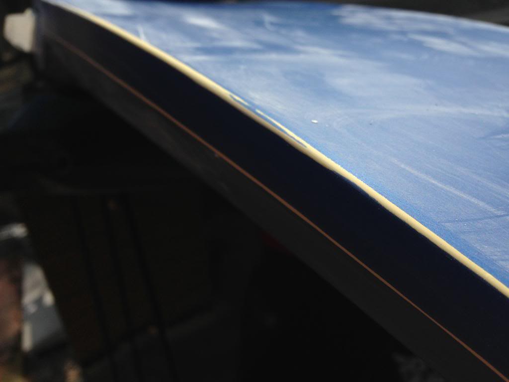

However this finally arrived:
It didn't arrive like this, I started to hack into it.
Dog even got some enjoyment out of it as he loves popping bubble wrap:
Behold!

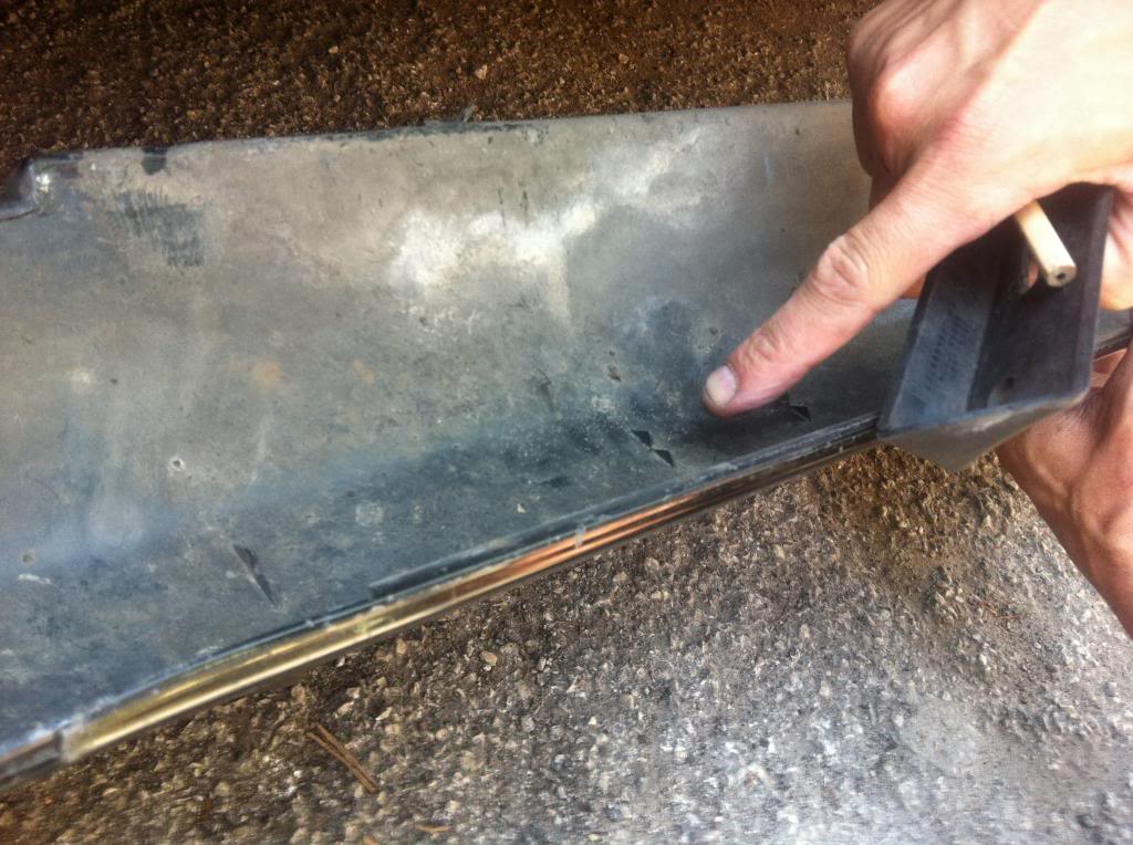

So off down to the brothers for me to prep it up.
See the 2 dots above ^^ 2 Nice deep chips in the thing. Wouldve needed to be touched up if my car was the same colour anyway.
And that's it so far. Now sitting in the garage waiting on when my brothers got time to spray it. Probably around 2-3 weeks time.

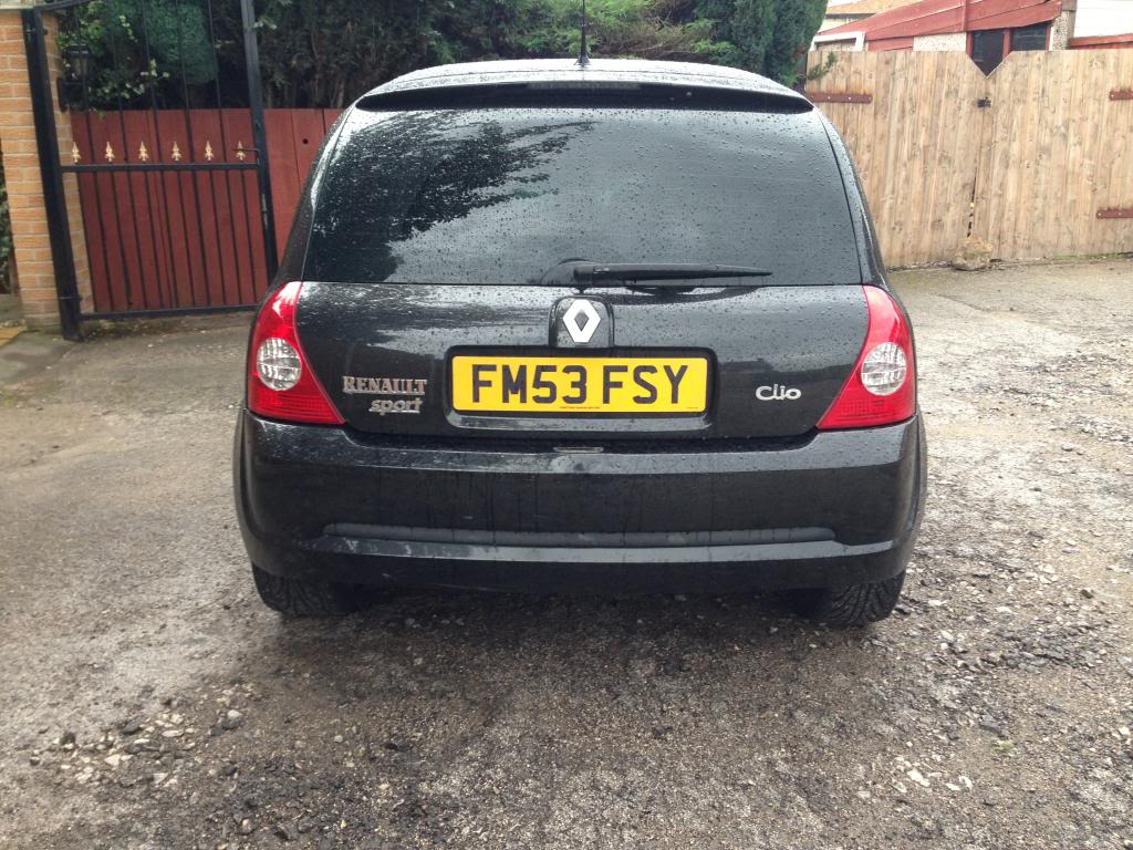

Long time since an update. Just couldn't be bothered for a long while ha.
Anyway got a few things done:

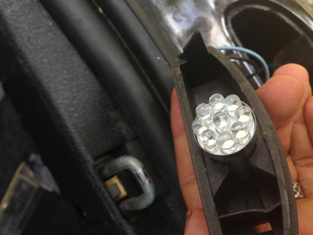

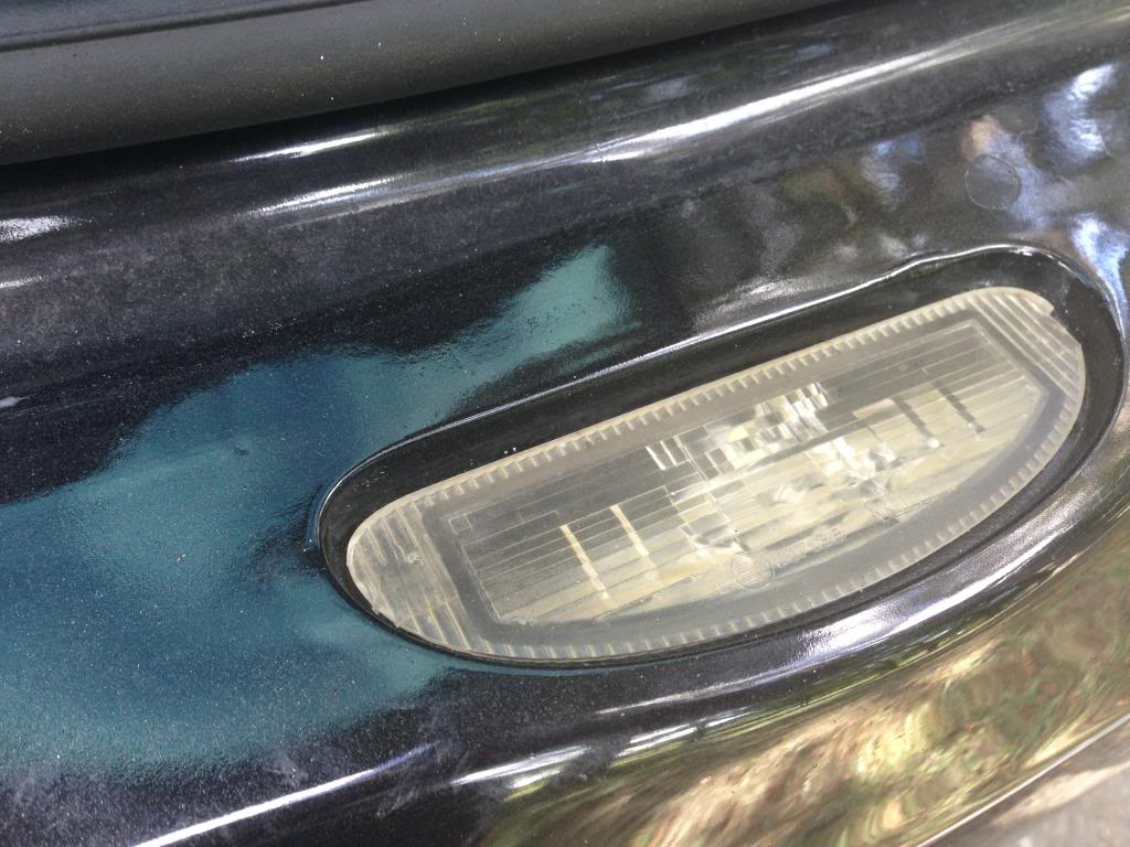

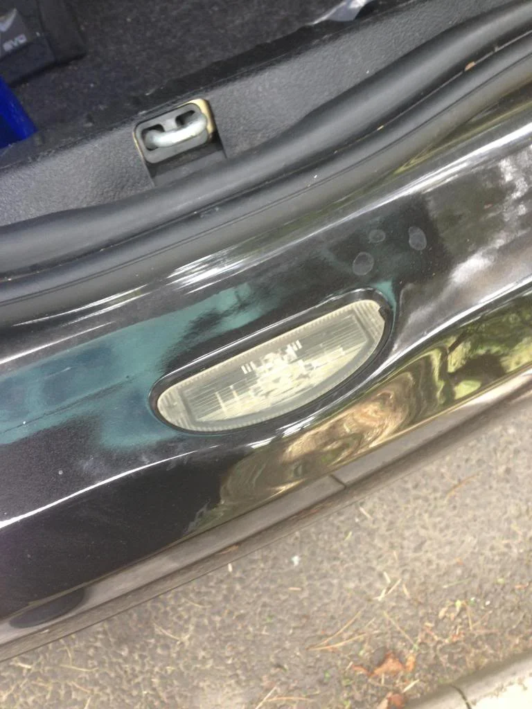

- LED Rear light
- New rear bumper light replacement jiffer thing.
- Spacers.
Start off with the old and new jiffer thing:
and new! SO much tidier! it does make a lot of difference.
Also got a new LED bulb for the thing:

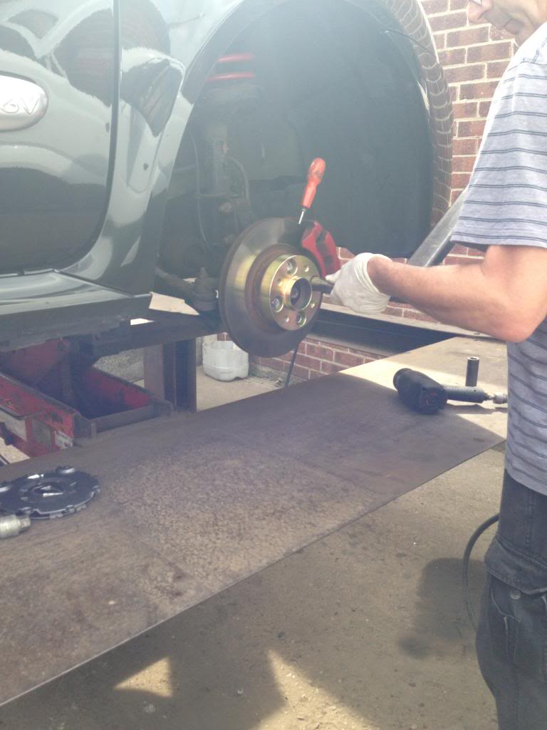

and then onto the spacers.
Desperately needed them, people who saw the car loved the look of it but most mentioned I needed spacers for my front 2. already knew this for long time but just never got round to it! ended up ordering 25mm Delta Mics off the bay thanks to a few other sport rep threads on here. I'd Recommend them especially if youre also going down the rep route!

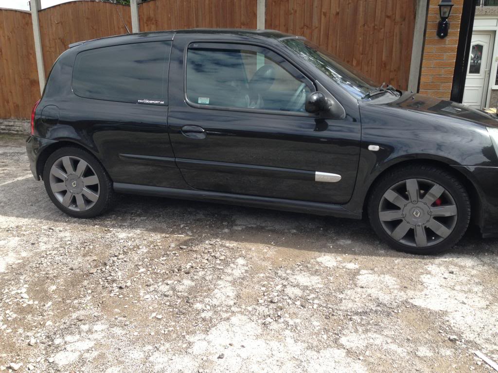

Heres a few before:
Bad right? Yeah./
I'd Also get them painted same as your alloys before you put them on! I haven't but will do once I get my alloys refurbed.
On the ramps:
And then theyre on! Heres a before and after!
Incredible difference! I could feel the difference aswell.
Now im contemplating getting a set for the rear. Probably a 20mm. what do you lot think?

really looking good mate! btw how much were your springs as looking to get the same? and what LED rear lights did you get?
Springs were 160! Not gonna lie I would be abit happier with the front like 10mm lower but hey looks good now! any lower and ill end up taking off my front end from a speed bump.

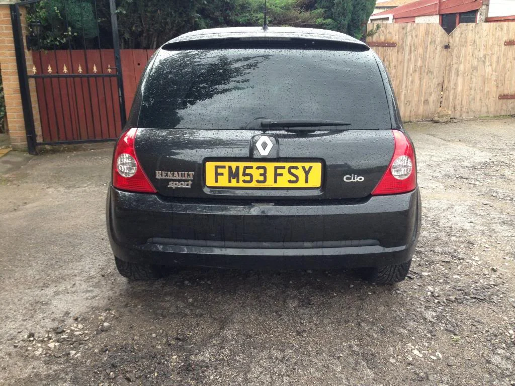

Thank god you changed them rear lights haha!, The car has changed so much since the 1st pictures it's laughable, What's next?
I know I am preferring the rear lights now aha! and yeah ive done the same! looked at the first uploaded photo of the thing then look at it now.. completely different machine visually.
Got the cup spoiler but having trouble fitting it.
but:

Whats the trouble with the spoiler dude? i had trouble fitting mine. The brake light plugs didnt match, the washer jet pipe wasnt long enough and the original clips were stuck in :(
Major bodge but i got it on in the end
Complete opposite for me mate! put a help section up in the Discussion section.
Brake plugs match. Washer jet plenty if not too long and clips are gone!
Mine don't friggin align! you have the same problem? I put it on, but the right side don't sit flush. So bad I cant even screw it in. Ill have to get long screws! left side sits nice and I can screw it in fine. the right hand side pops up, wont come down and the whole things seems to me 0.5cm smaller than my tailgate so fitting it is still atm a right fail.
it might be sitting on your washer jet hose, there's a channel in the spoiler that it sits in. mine wouldn't sit flush either but was too short to follow the channel.
I had to leave it disconnected, plug it up, and push it into my bootlid out the way
