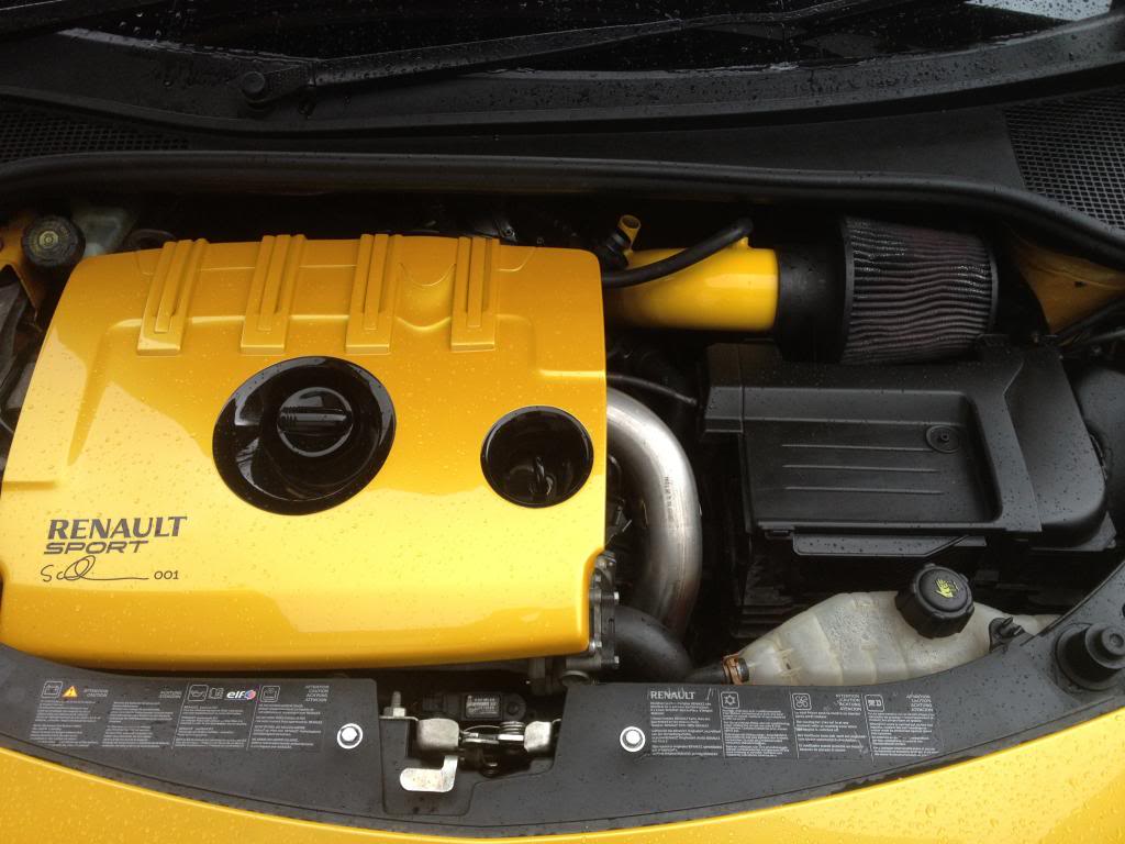

New 3' intake pipe. Trying to push towards 320 bhp when I eventually get round to mapping it now pumps fitted. Just need a small pipe for breather to intake to finish but that aside really happy with it. Got my old one if any one needs it for their Clio conversion. Open to offers and can have it powder-coated black for small cost, when I'm doing the silver intake pipe too.....
Really happy with performance since pipes been fitted. Still some work to do with TB, that seems to 'hover a bit' before revs drop down again????

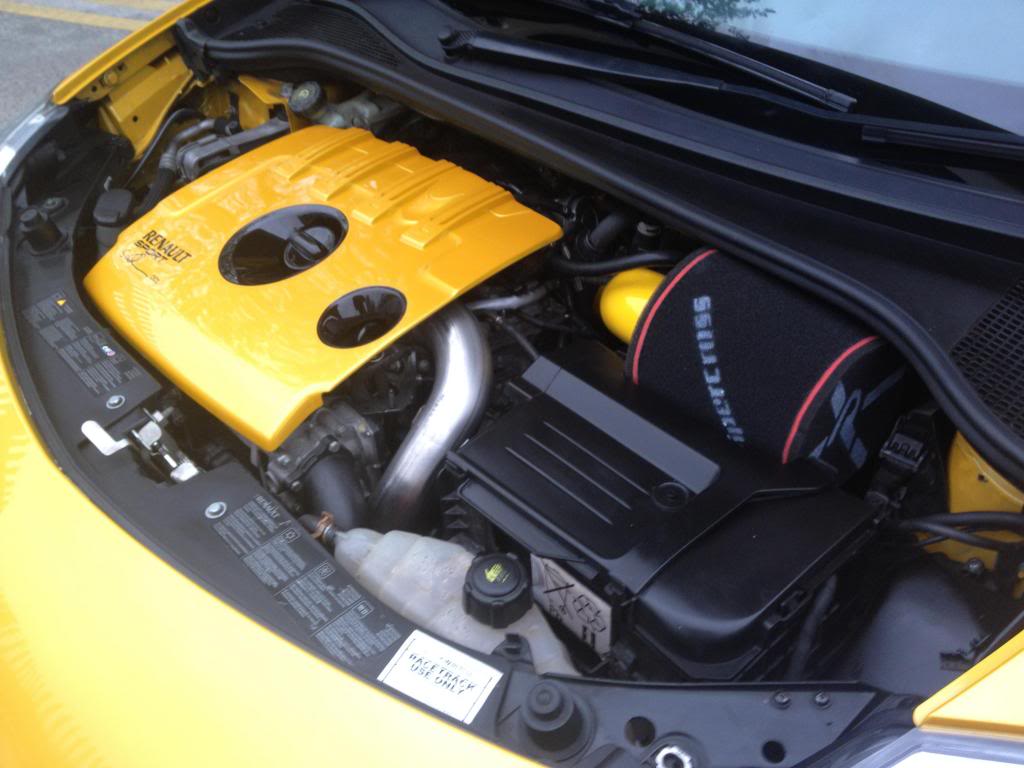

No real update aside from time to revisit a couple of things that I've wanted to do for ages. Bumpers coming off to be painted due to stone chips and stuff. Whilst its off, the intercooler going to be painted. I'm going to look at the intercooler pipes and going to run them differently in order that I can refit the original fan rather than the current aftermarket one. Pipes going to be powder coated yellow. Air-con re-gassed. 330mm brakes getting refurbed and I'm going to look to change the front pads.
Next the exhaust, planning to have a larger link pipe and centre section.
Finally remap and should see 320bhp+....then sell it lol

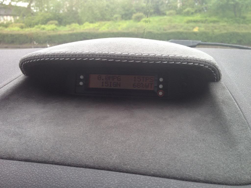

If your using it as a daily what sort of mpg are you getting?

Had it NA before going down the Meg route. Was only seeing 19 mpg...(!)
This looks awesome. Not a lover of the LY inside tho. Finally a 197 with the engine it always should have had :)
Its Marmite but looks better in the flesh. I use it daily, which means during the day too. I can get 27 mpg.....

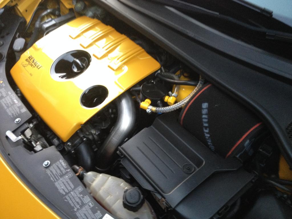

Little update. Fitted a cusco oil catcher. Never thought much to it but enjoyed my Sunday after tinkering and fitting it. Took the car out and thought what.....!!!! The car was 35% quicker. Thought I was imagining it so took my son out who thought I'd fitted an hybrid. I'm not sure if it's the less fumes in the inlet or the fact that I've configured the pipes to the inlet better but I can now feel every single one of the 340 torques......result.
