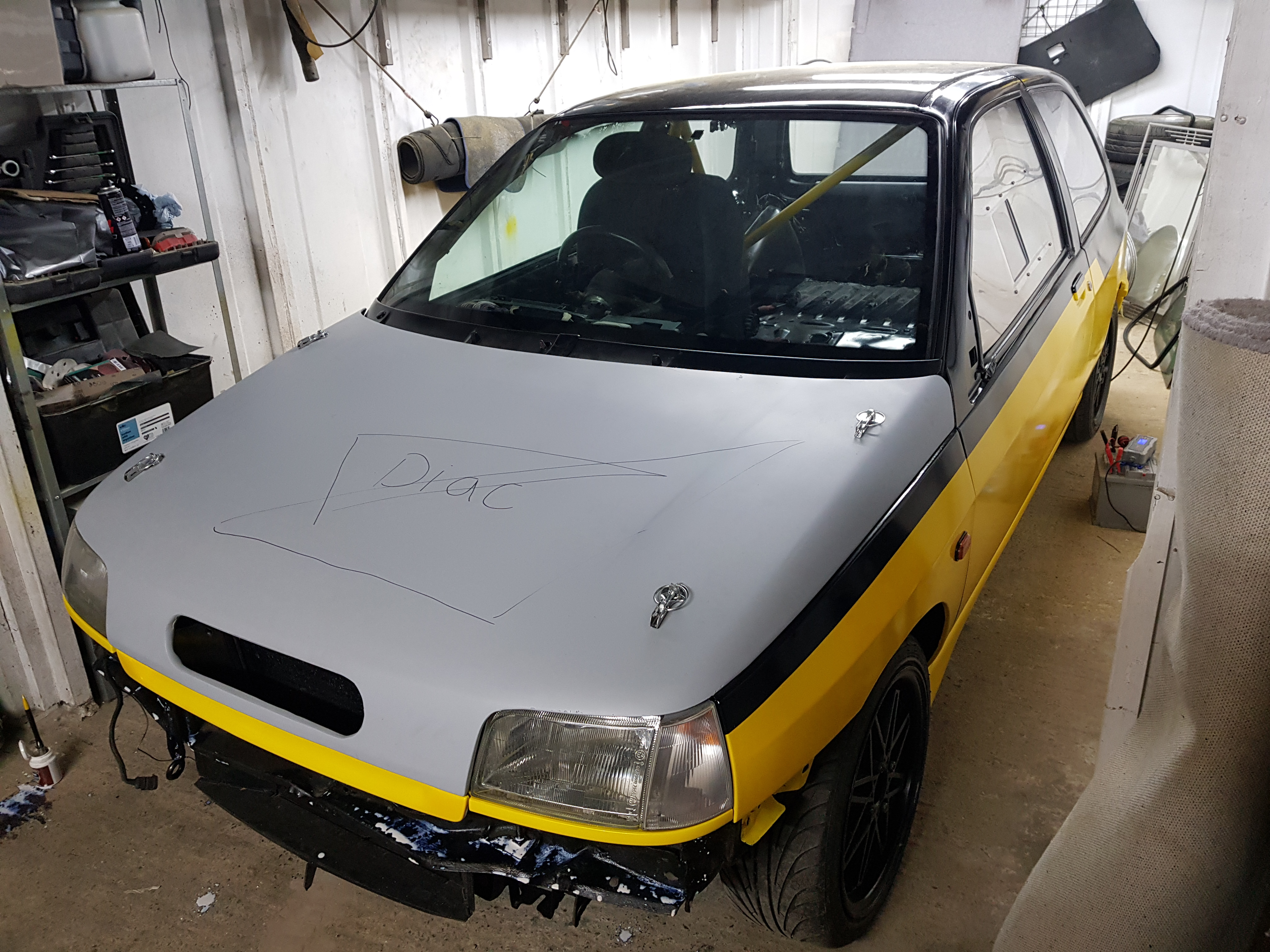

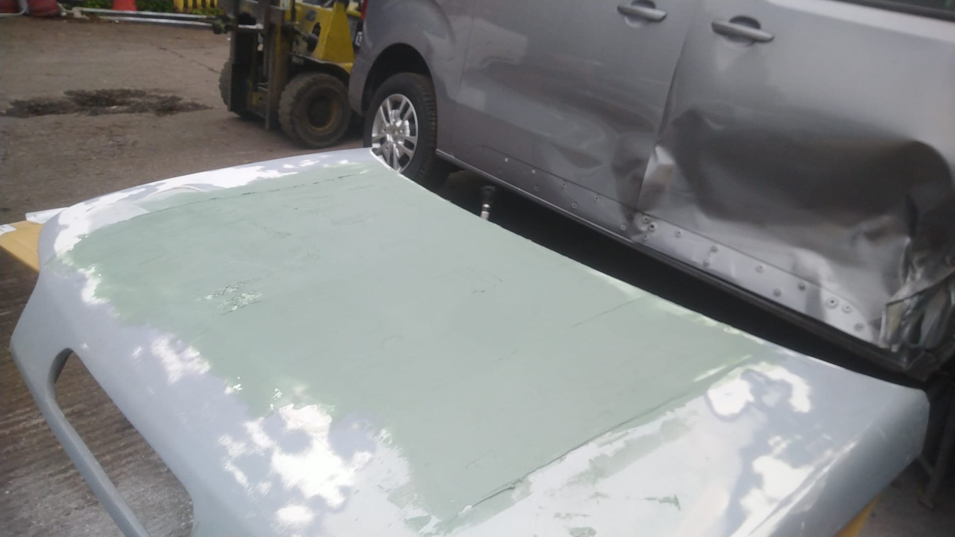

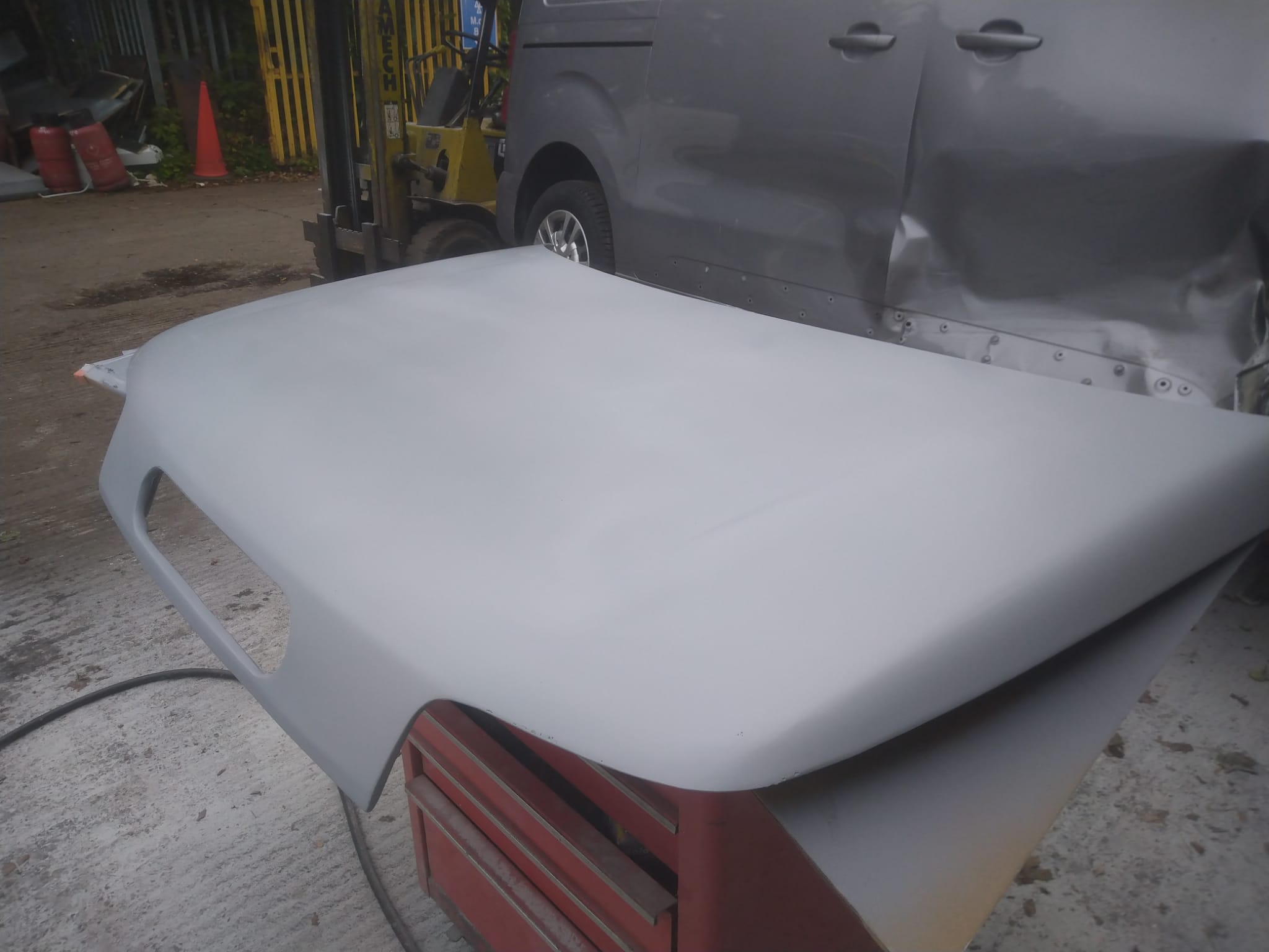

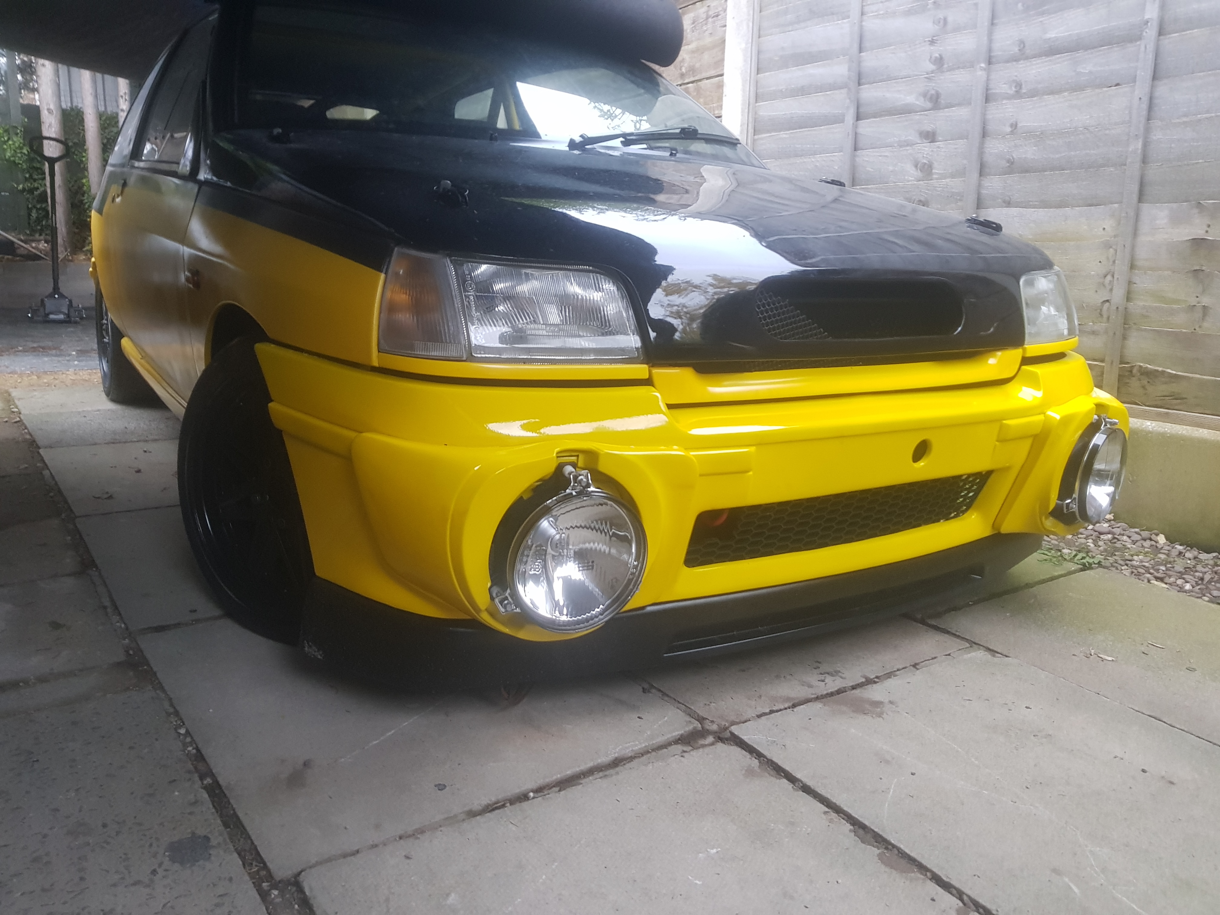

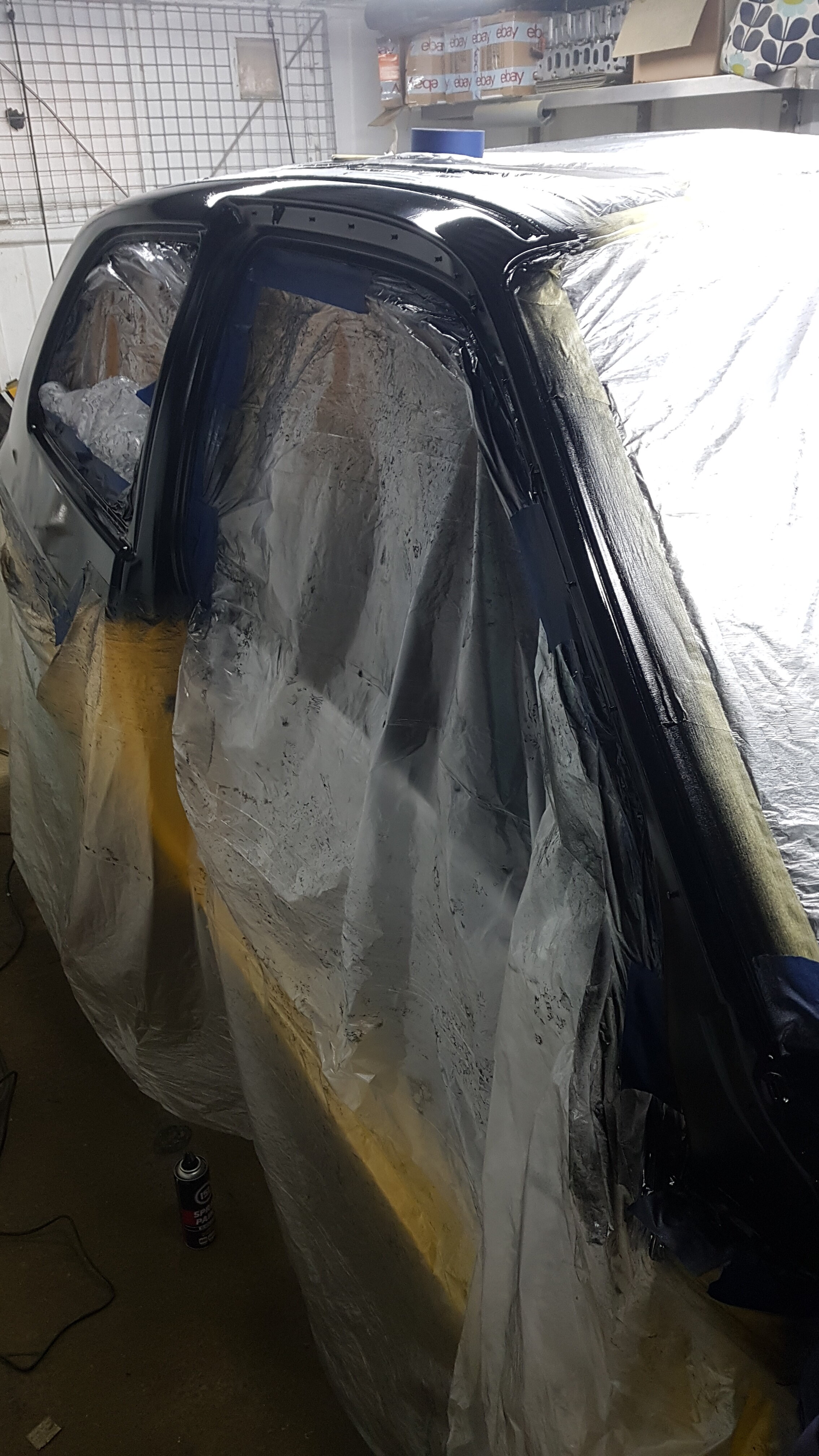

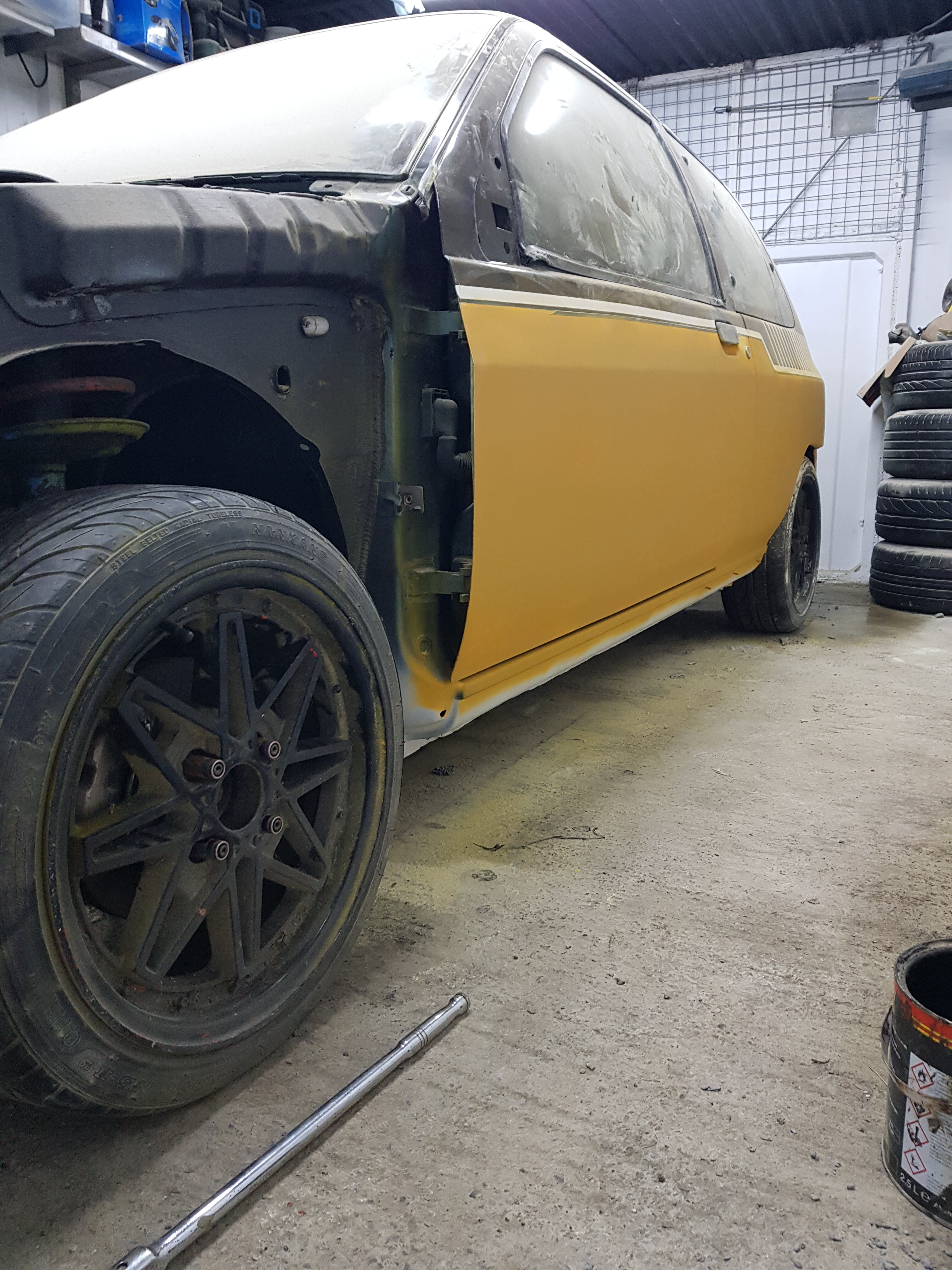

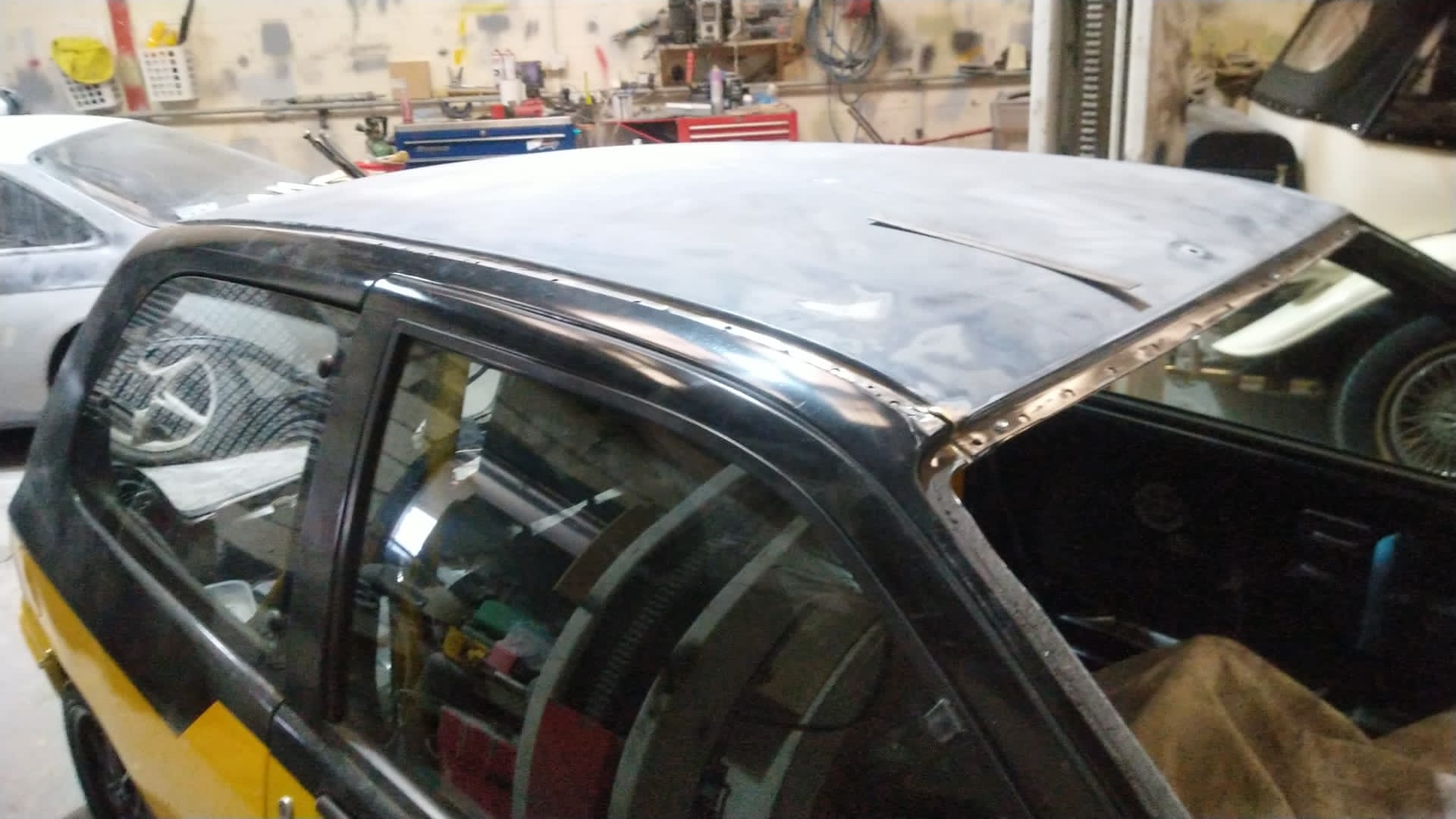

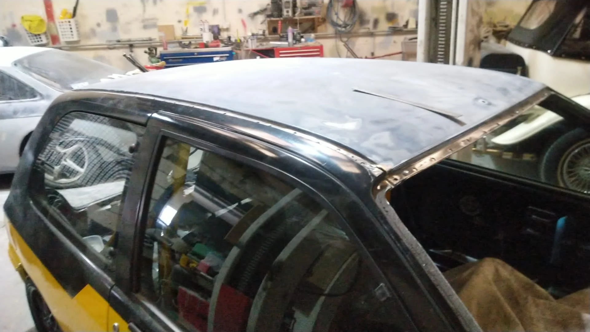

A few photos of the development.

Keep us posted, what's the rust situation like? it looks like it's a decent shell from the pictures? I think the only RSI bit left is the side skirt are you going to put any rsi badges or original RSI wheels and spoiler back on it?
  Williams
Its rock solid mate, I got underneath it and grinded all the surface rust off and treated it the under sealed it. I'll be removing the sub frame and wishbone to powder coat them yellow.
I'm having a steel racing cam made for it which will take 6 weeks from now. I have ported and polished the cylinder head and added dimpling. The engine is being rebuilt and with a Laguna 2.0 bottom end.
