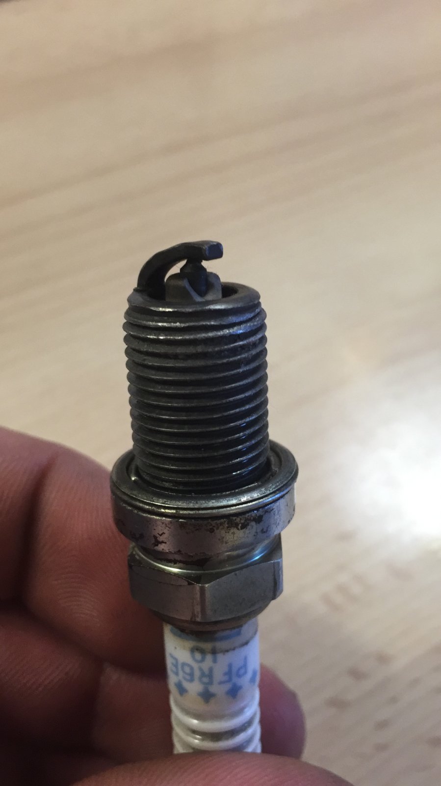

Definitely spat a plug out. Do a search for timesert, also helicoil but timesert is the better option.

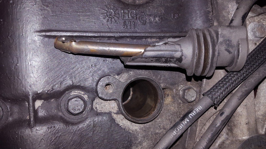

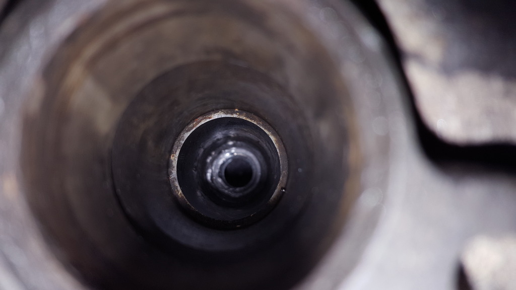

In the morning take the upper inlet manifold off - there is a guide for spark plugs that mentions how to do this. you will then be able to look down the spark plug hole and see what damage the threads have. It is likelt to have damamged the threads as the spark plug will have been blown out of its hole takign the threads with it. You will also need new HT leads - or atleast the one affected.
Timesert or helicoil would probably cost up to £100 to have done. @Alistair14 - what do you reckon the cost is?

Reading up and it seems there are mixed reviews with heli coils but the cheaper option. Time sert will need the head to come off and belts doing again.

Timesert is a permanent fix mate. Helicoil may be troublesome if not done correctly.

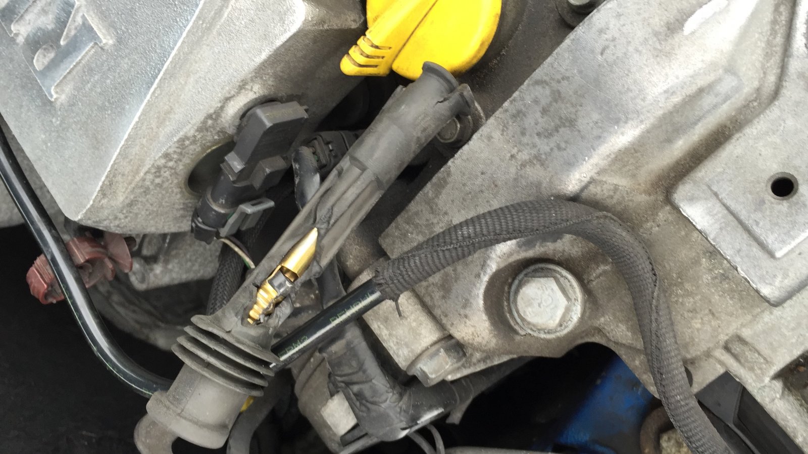

This is what's left of my lead.
