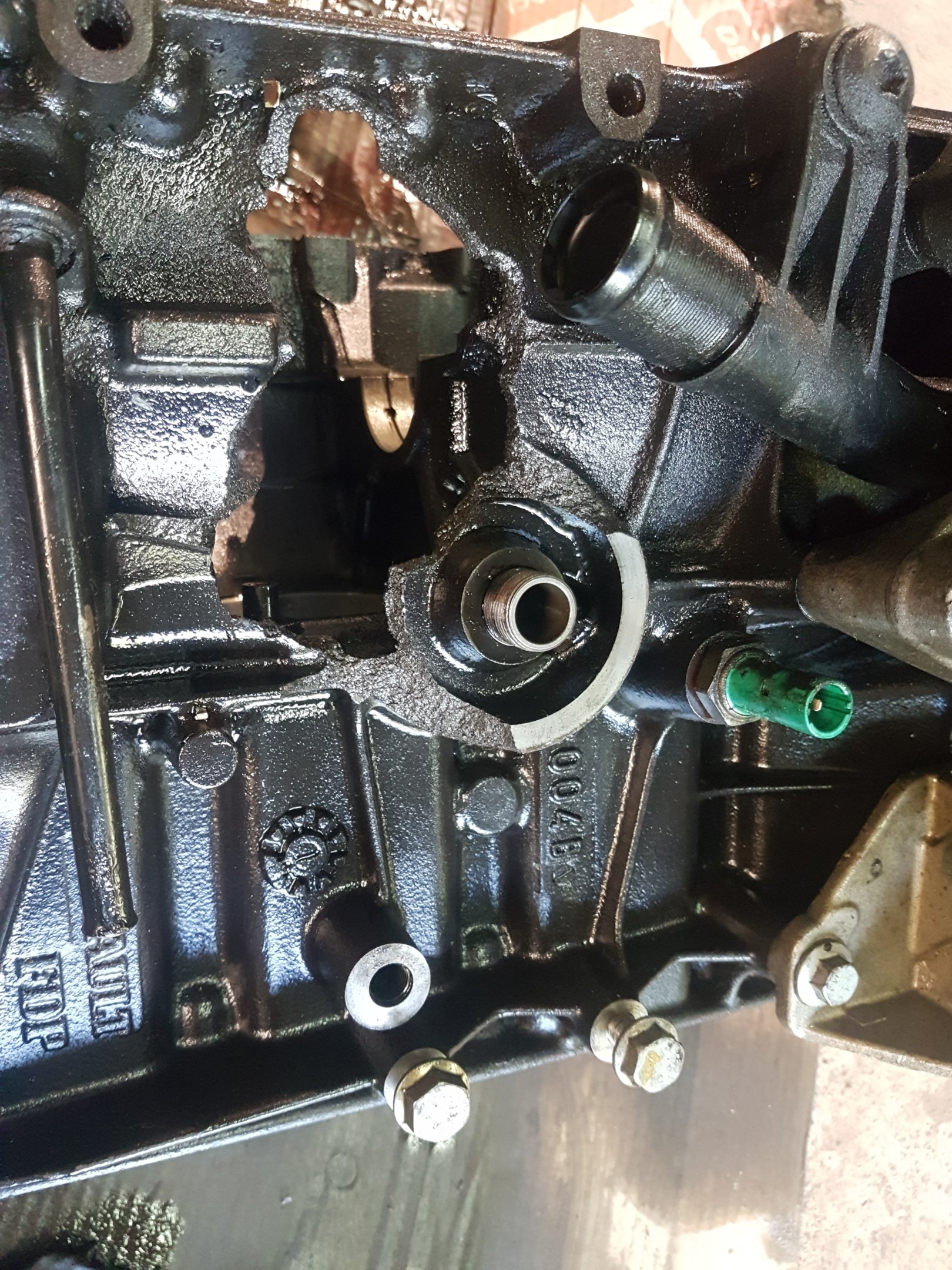

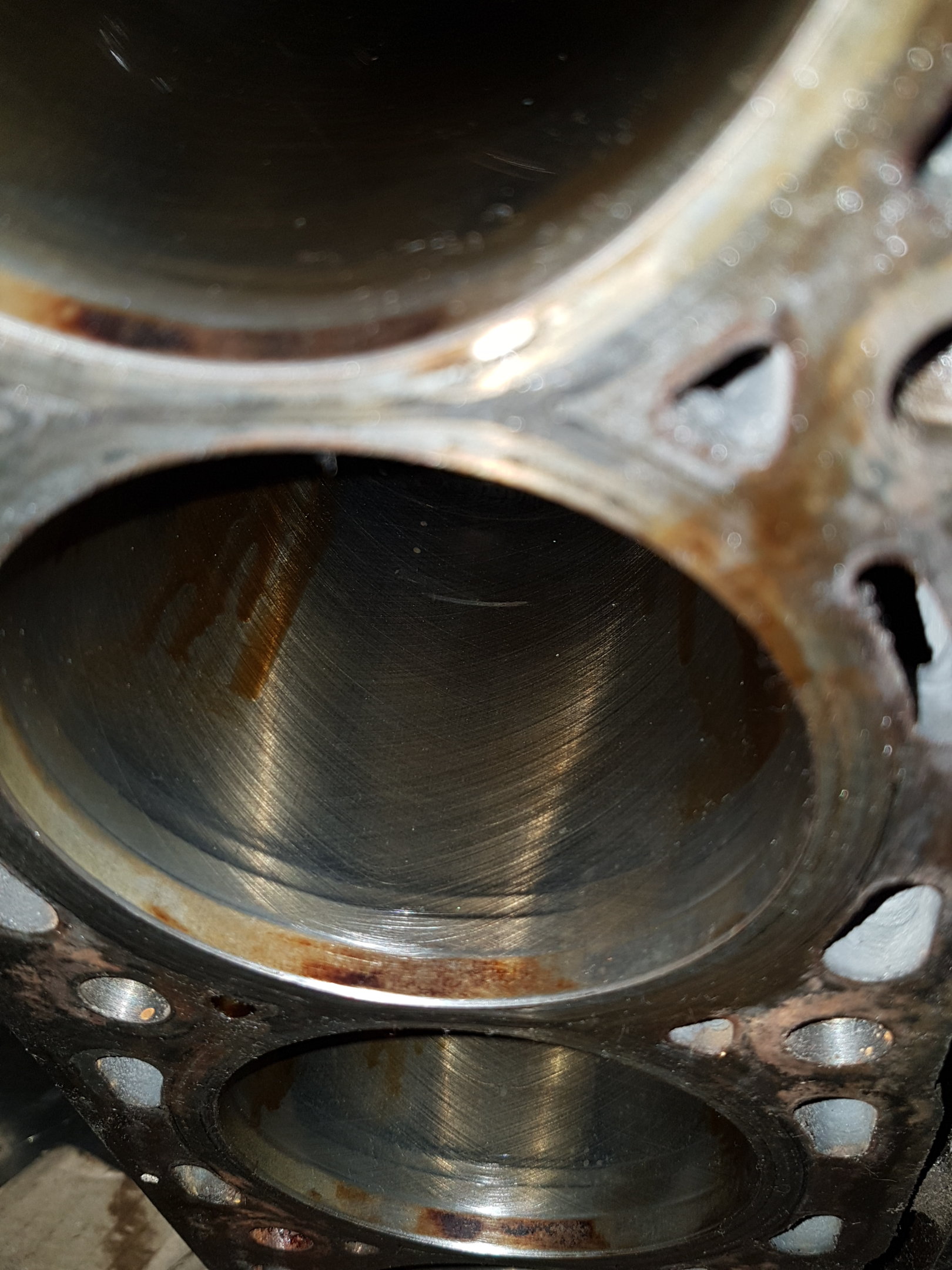

Hi guy, finally we get one almost new

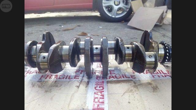

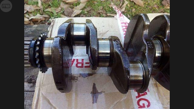

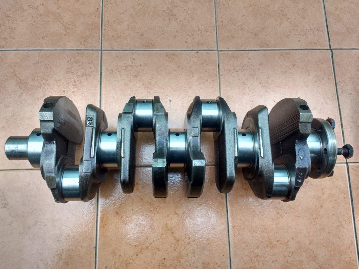

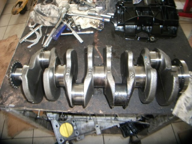

Here some pics that explain better the situation
172 Crank, has only one hole per main (as it can see, not all mains has a vissible hole)

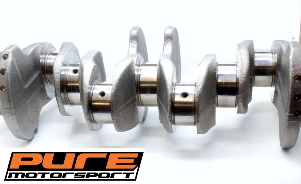

Crank 182 all mains has trough hole in all mains (pic from F4R 740, that seems to be identical at leat from casting pattern)
ciguenal-motor-original-megane-scenic-20-16v-f4r-D_NQ_NP_697541-MLA27952938420_082018-F.jpg
Crank Clio III 197, similar to 172 ph2 but with 8 counterweights, seems to have trough hole in all mains
The problem is that with one hole, if main bearing is only half grooved, half of the time there isnt oil supply to rod bearing

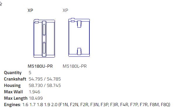

ACL and King bearings has a 3/4 groove design as below scheme that bring a better scenario, but still 1/4 of the time without oil supply to rod bearing.
2018-12-03 15_40_44-Renault 1.6 1.7 1.8 1.9 2.0 King Racing main bearings MB5180XP-STD.jpg

You are right, but i think that there isnt a problem when you have a cross drilled main (two holes in main) as most of the ckanks has for that engines.
172 ph2 crank has only one hole in main surfaces.
