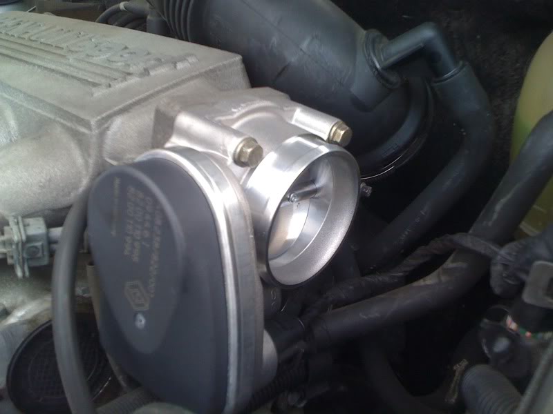

Guys, I know this thread is old, but - is it possible that problem here (car goes to 2,5k rpm and throttle is not responding) is throttle pedal (is that on picture below what you mean with TPS?), although we checked on Clip while problem appeared and the position was changing while I pressed pedal?
