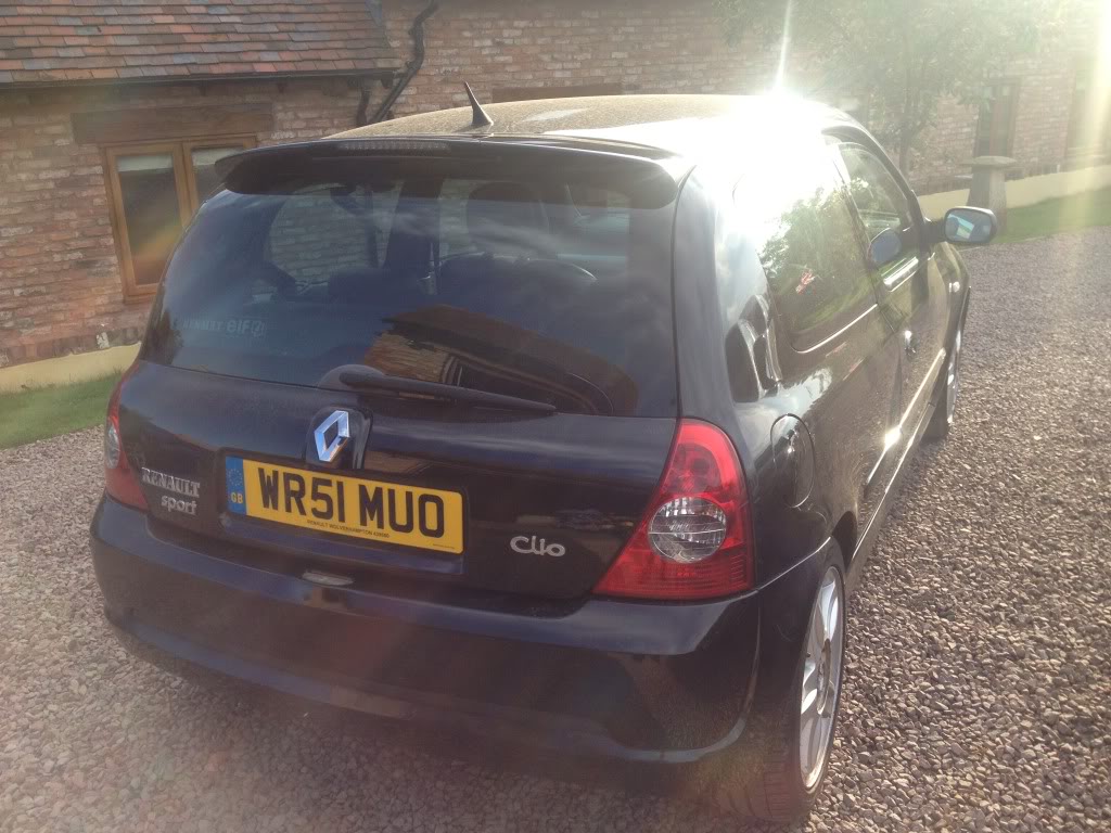

Would a v6 spoiler fit a 172? and would it look any good im looking at 1 at the moment? :o for my Monaco
It fits:
They fetch between £200-250, Don't forget if you buy one you will need to change the tailgate struts to shorter one's!
You can use the BMW 1 series bonnet struts instead of the genuine renault one's which are only like £10-15 each.
Iirc they're £170 from Renault from memory, the struts are £80!
No they're a lot more, I've got the receipt somewhere as I bought mine brand new from renault last year, used jag x-type bonnet struts which gave more lift than the standard trophy tailgate struts.
That price might actually be a discounted one i quoted now that i think on it!
You'd be doing well to get it for that discounted mate. Mine had boed (sp) a little so was a pita to get to fit on the boot, It had went straight over time lol
