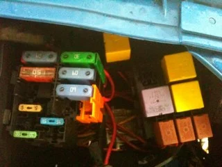

So £60 and three relays later and I'm nowhere? :( I presume I've changed the right ones? The yellow ones are the new ones. The only difference was the new ones had 5 prongs instead of 4.
Any other ideas?

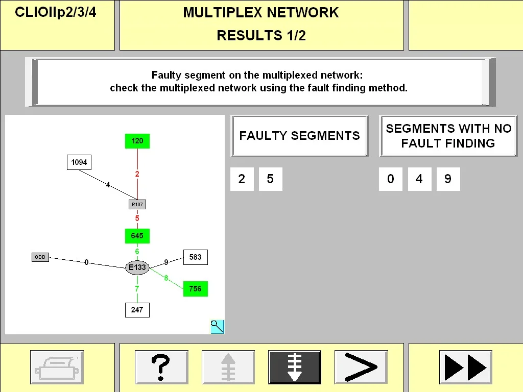

No mate not sorted it yet. I'm struggling really. I had an auto electrician round and the problem seems to have got worse. My clip was reading the ECU, but wouldn't erase faults. It was showing a connection issue between the cars computers;
120 is the injection comp which is showing as ok. You could read it, but nothing else. The red lines are the issue. Since the auto elecy has been round, the 120 is now a solid red block, and it won't read it at all. I sent the ECU away to Camco and it's running fine up to immobiliser point (as far as they can test to without car), and the immobiliser isn't showing any faults what so ever. So i'm going to get a different auto elecy out and see if he can solve it. I'll get him to double check the earths for me (other guy wasn't interested in looking at them for some reason :S)

I had the same issues as yourself and have found the problem to be faulty relays or their connections.
The three smaller (brown in your pic) are ignition, immobiliser and throttle relays try swapping them about.

Crap, are you sure? Can't believe I changed the wrong ones :( Think the auto eleccy guy looked at them, but i'll have another check. Hi and Welcome btw ;)
Yeah, when I removed the middle one to check my fault, I'd turn the key and nothing at all would happen. Worth a try.
The immob system is all on the UCH by the way, all it does if the conditions are met (correct key etc) is send an 'OK' signal to a pin on the ECU... If the immob is active it wont let you erase/modify the ECU, so that would explain the guys computer not being able to do it, I had the same with my ECU once. My guess is the UCH isnt sending the correct output (if any) to the ECU... Which could indeed be relay related, or the UCH itself..
Makes sense Jord, but CLIP isn't showing issues with Immobiliser or UCH :S I've been told the immobiliser is in the ECU itself though? Was talking to a guy from Camco and he said that I could get my ECU immobiliser removed.

Nah, its in the UCH under the glovebox. There is a wire from the decoder ring on the key barrel going into it, then a wire coming out to the ECU in the engine bay. The Renault tech docs explain the whole immob system, il see if I can dig them out. The ECU requires a specific OK signal (every ECU has a different one) before the engine will be 'unlocked' so to speak, which is provided by the UCH if the key etc is correct.
All they do to 'remove the ECU immobiliser' is trick it into thinking that its receiving an OK signal, mine and all the other Mk1 F4R's use this same method. We have to solder an emulator onto the ECU (which imitates the UCH's signal), then hard reset the ECU to remove the stored immobiliser code. Then, when you turn the ignition on the ECU stores the code from the emulator, and because it matches it thinks everything is OK and lets the car start. Problem is, that method is yet to work on a Ph2 as far as we know, because its only ever been done on Ph1 ECU's. This is down to the Ph2's and newer using the more complex CAN-BUS system which confuses the matter further, so id be interested to see how he could emulate the ECU on a Ph2/182..
Any wiring diagrams you have mate would be useful. I've got the usual f4r manual, which at least tells you what the pins on the ECU do, and a little about the fuse box, but not much else. It seems very strange for it to lose connection with each other though, unless I knocked a wire when I was messing in the engine bay. Its wierd that the UCH (BOX 645 on the clip picture) is reading fine though. I would imagine there to be a fault flashing up if that was the case :S. Buy Bens ECU/UCH etc and fit them? Not sure if 172 ECU on a 182 will cause issues. Will probably need reflashing with the correct info.
