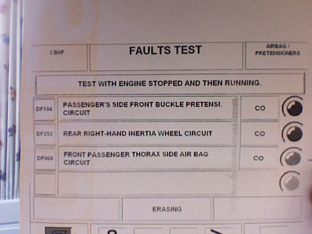

Does anyone on here know which side the second problem down (rear right-hand inertia wheel circuit) is talking about? is it passenger side or drivers side?
Please see attached.
Reason i ask is i need a new selt belt pretensioner unit for the rear and am now confused as to which side for....

Drivers rear inertia reel.
Unusual to have a problem with that though iv never seen that fault before on a clio 2.

If youve hit a pot hole / had a bump this is a very common fault. The rear seat belts have a locking device in them which triggers off in an impact ( to stop the passenger from shooting forward ) once these have fired off you cant repair them - you have to replace them. You will also need to replace the Air bag computer dependant upon the model type of your car.
