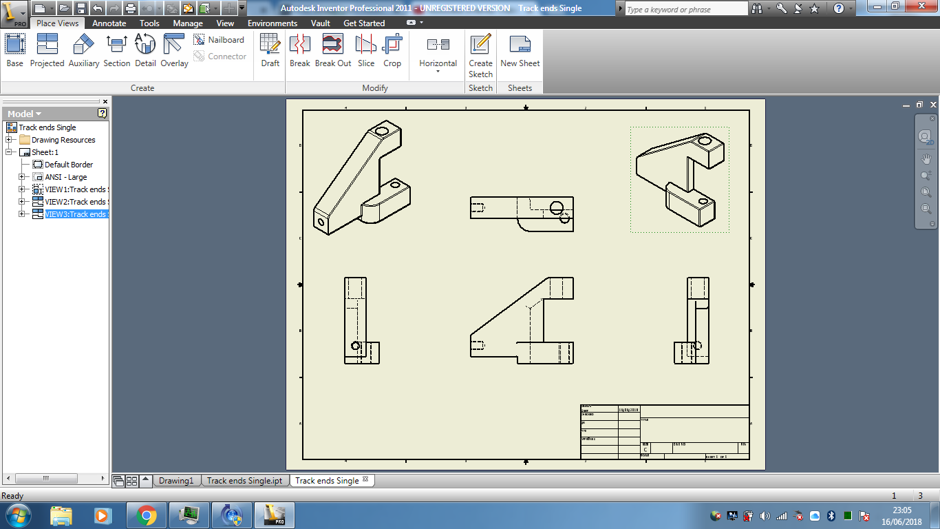

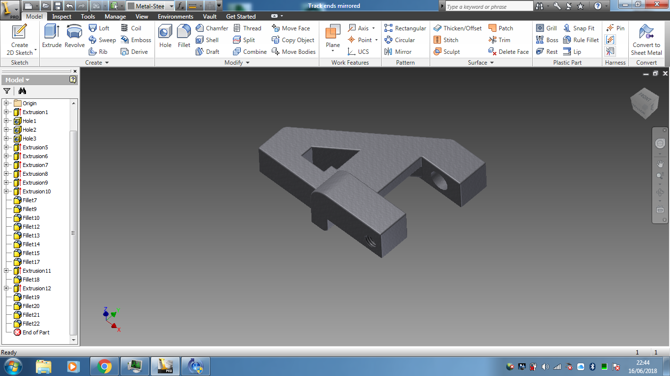

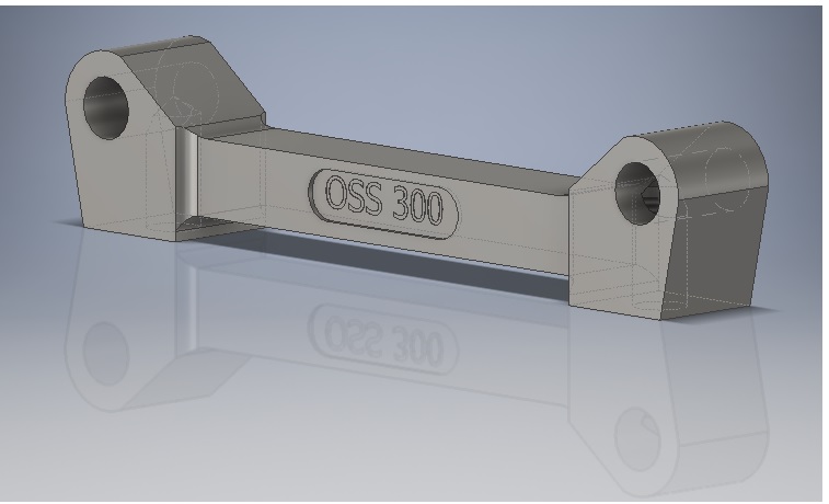

these give you enough ideas of what I want? lol
this is one side, the other side would be mirror image
Clio_fool
I definatly could make those, how long it would take is another matter. Depends what job I'm on as to how much time I can plunder. I probably toss it off long enough each week to make those ?

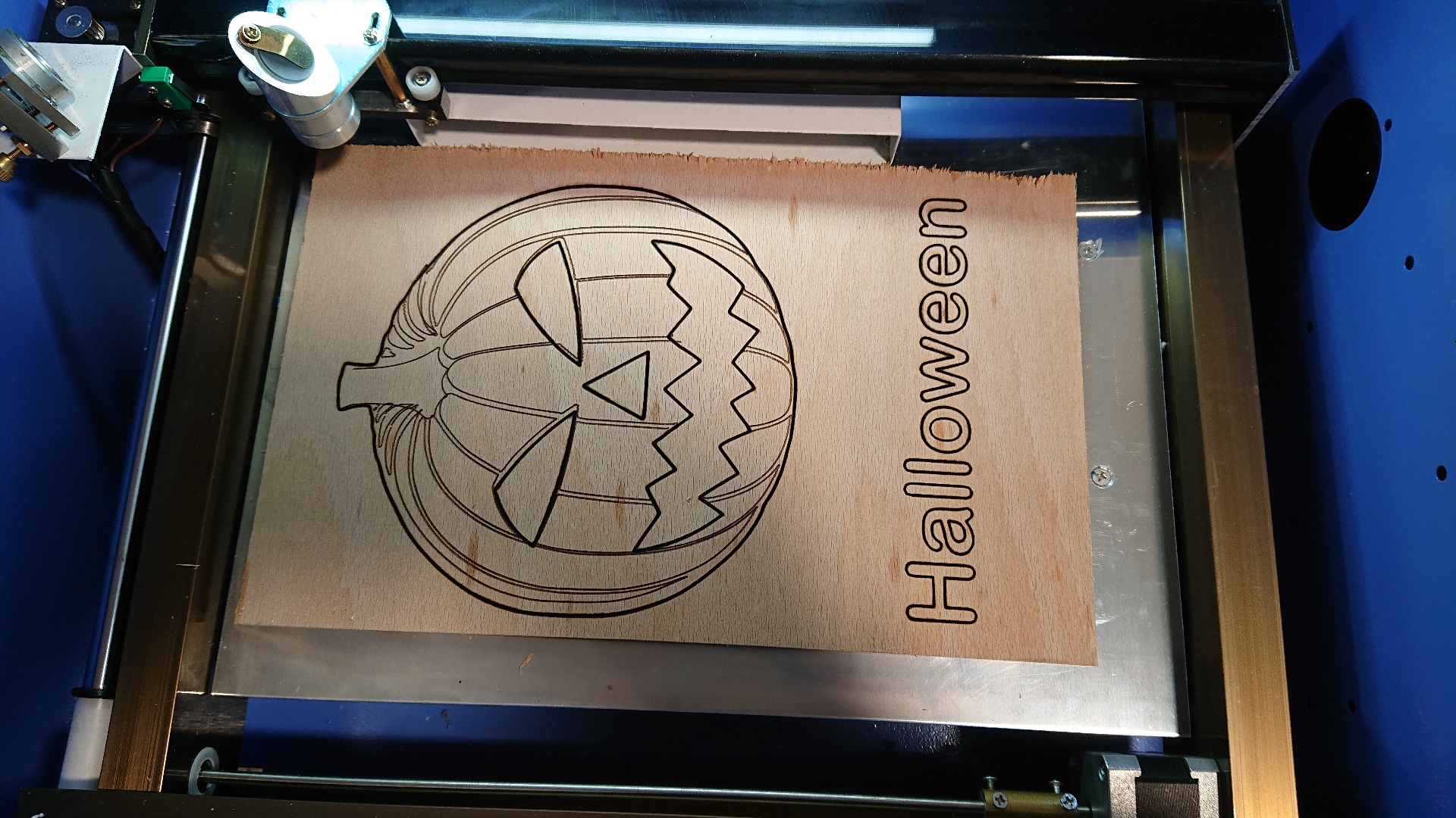

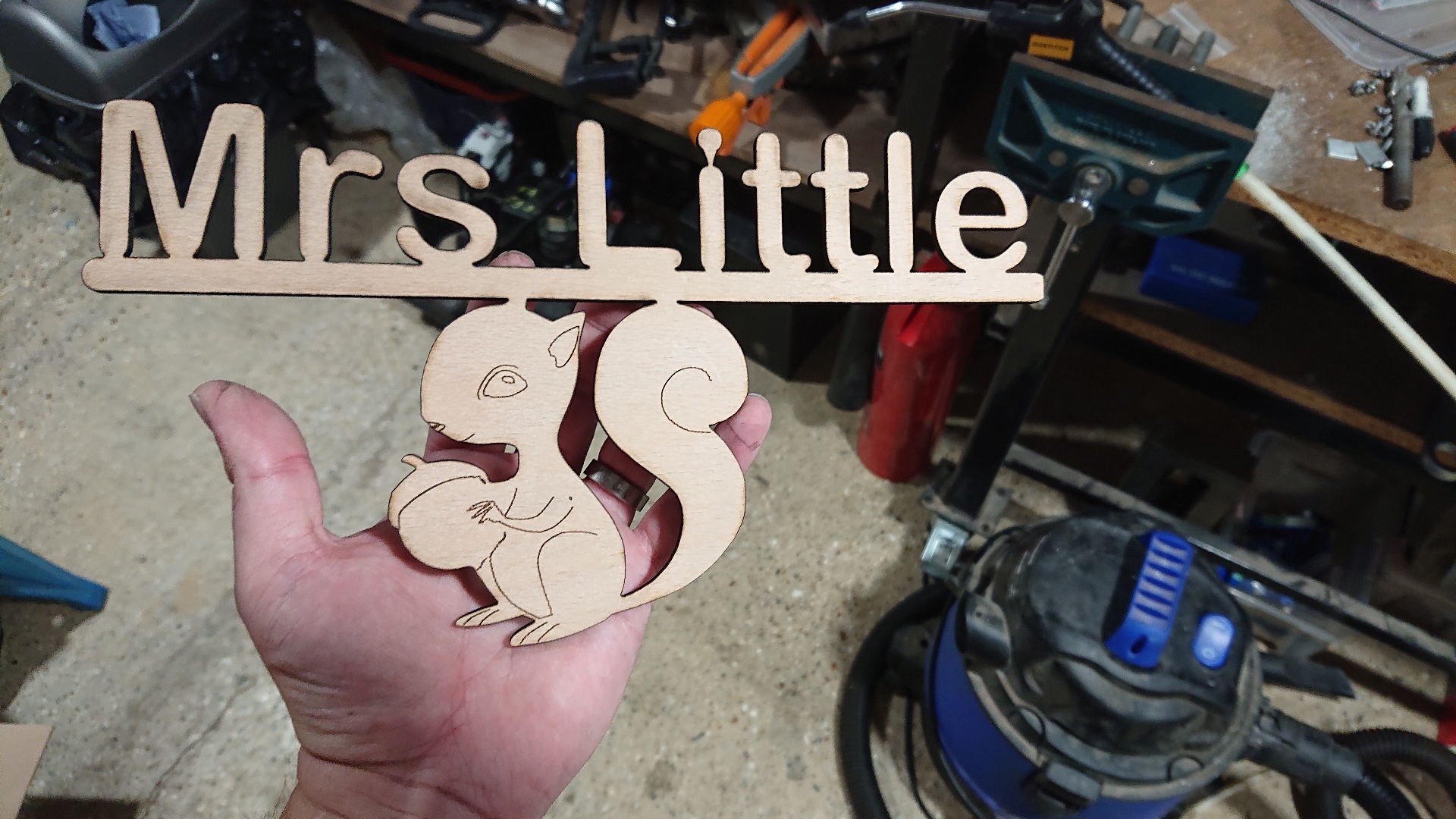

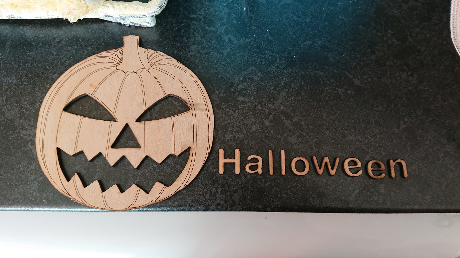

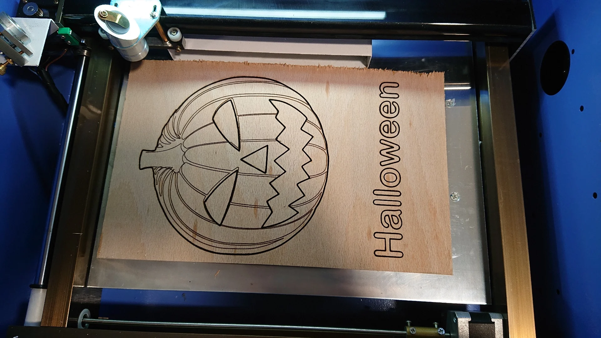

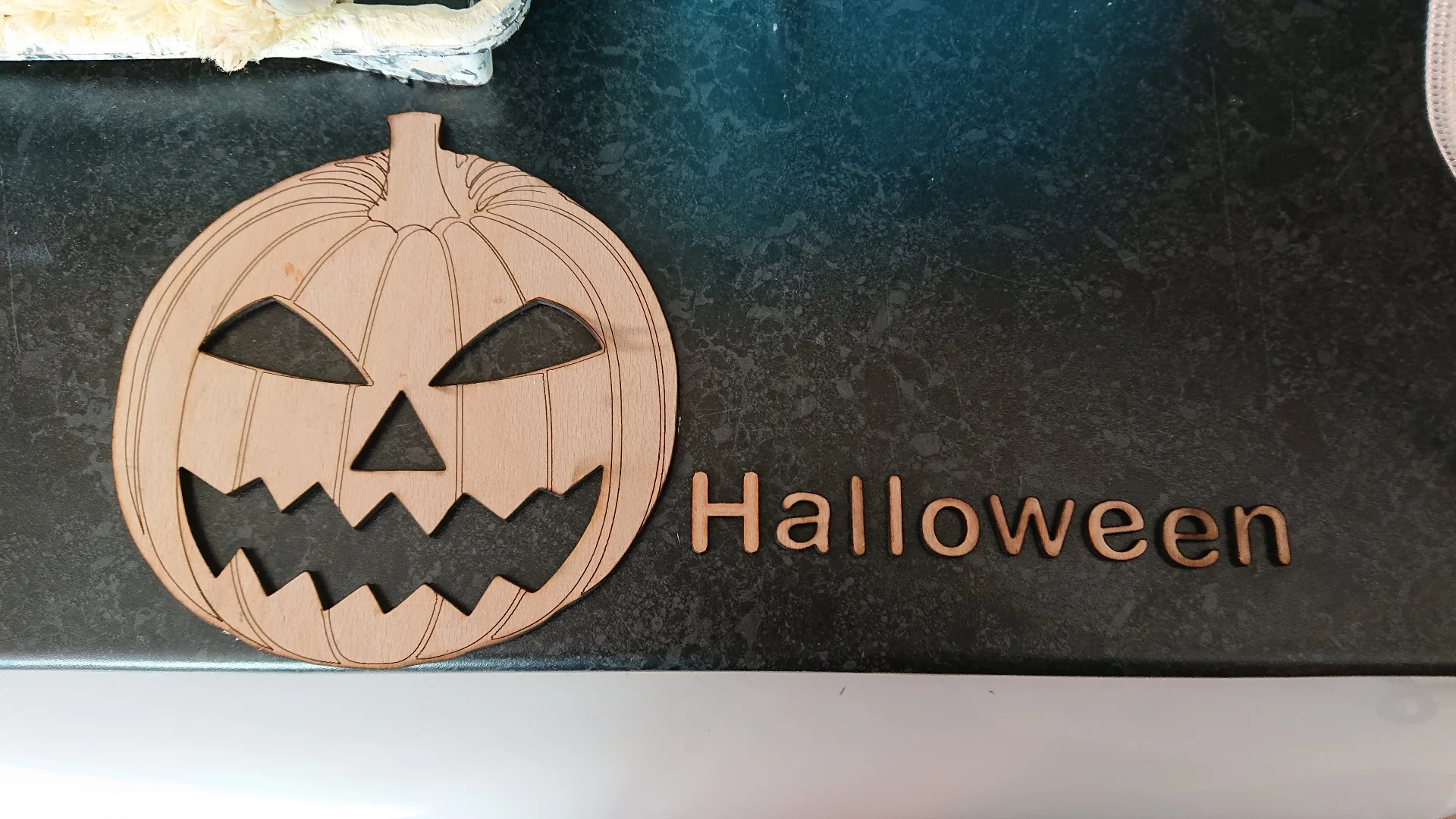

ok laser cutting is my new favourite thing!
the bed wasn't parallel to the head so the laser focal point was not at optimum. so ive ripped the bed out and put a new one in on springs. now I can adjust each corner so the laser focal point is perfect for cutting.
I can smash something like the below out in 4mins flat
ive got some acrylic to try out next, I want to also try some 5mm thick ply.
Oh the fun...

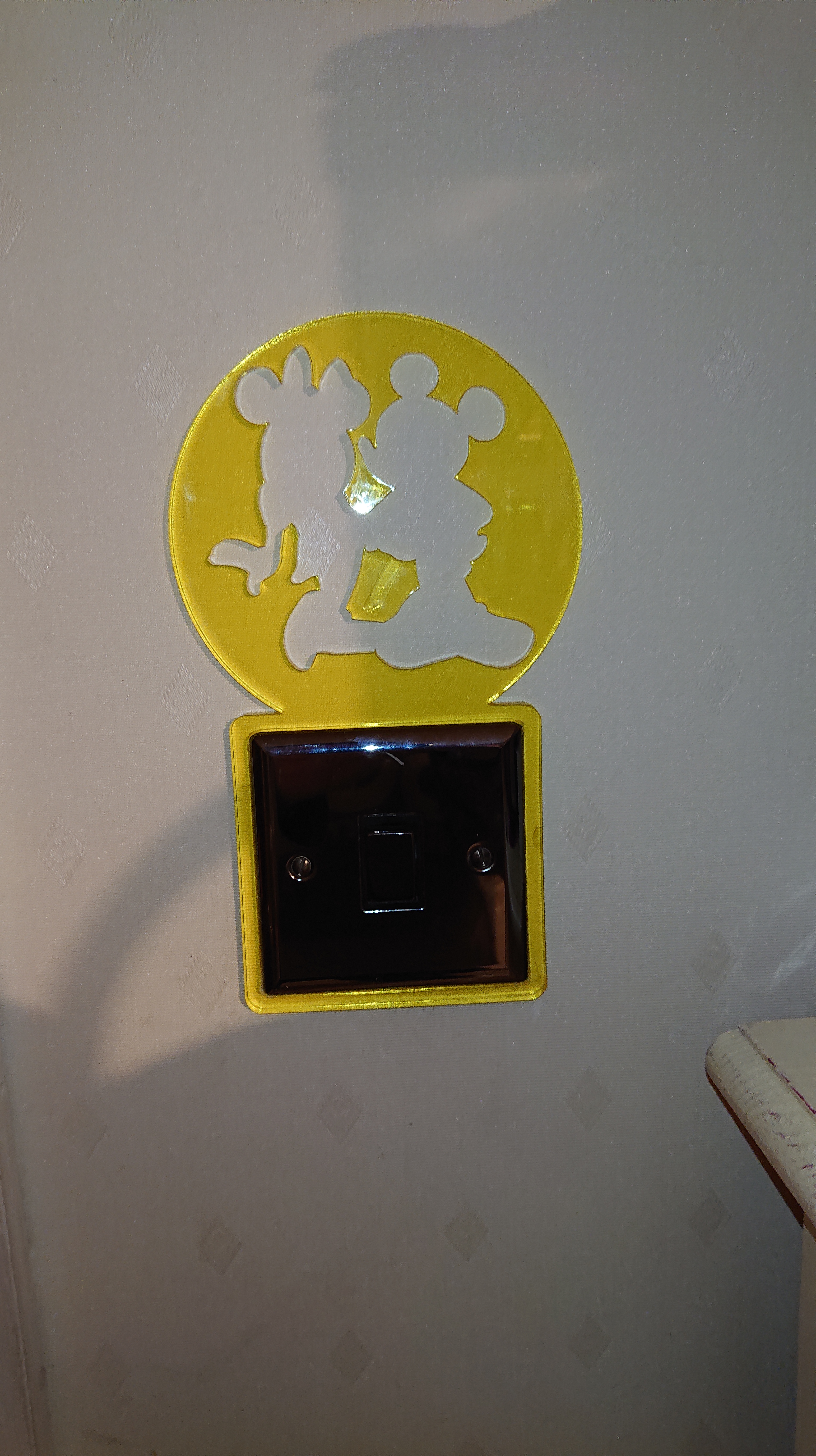

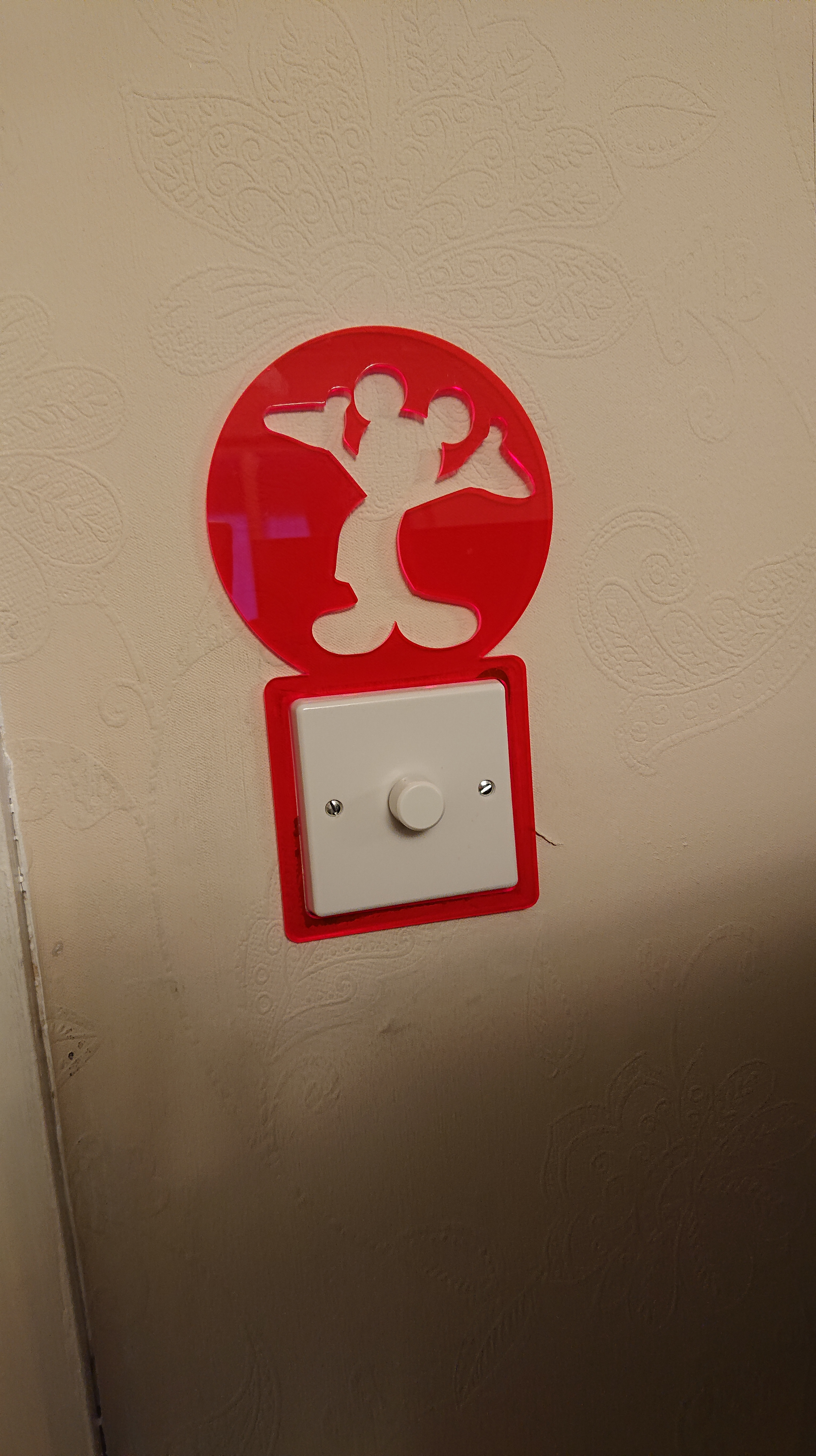

First time cutting acrylic and it's done a cracking job.
Single pass on 3mm thick and 2 passes to cut 5mm thick.
So I'm happy and the kids are happy
