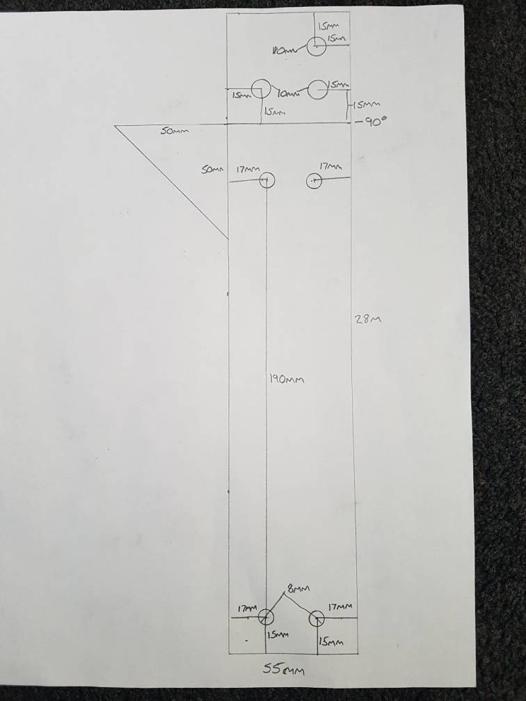

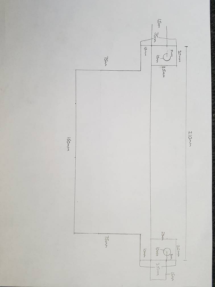

If you can understand it lol
Missing dimensions on that sketch by the look of it. No dimension of where the triangle is down the left side.
That and I take it the pitch between the holes is not important as they aren't referenced to each other.

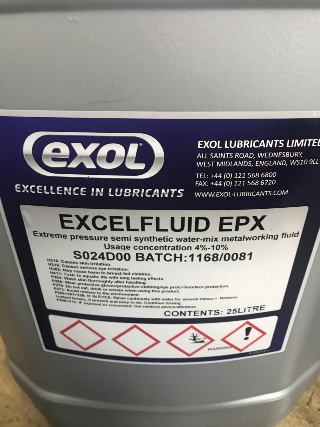

something i could really do with, mine starts to go off after 2 weeks and has completely gone by 4 weeks.
what coolant do you use?
We’ve always used this..
I’m the main machinist always struggle to keep the coolant clean always going off so hopefully this skimmer may help
Do you have a filter on the coolant return? Bits of swarf in the coolant rusting doesn't help.
I do yes, all be it not the best.
But I only machine ally, so not rust there. The coolant compartment on my machine being 25 years old is showing signs of rust. I did paint with hammerite but that didn't last long before coming off

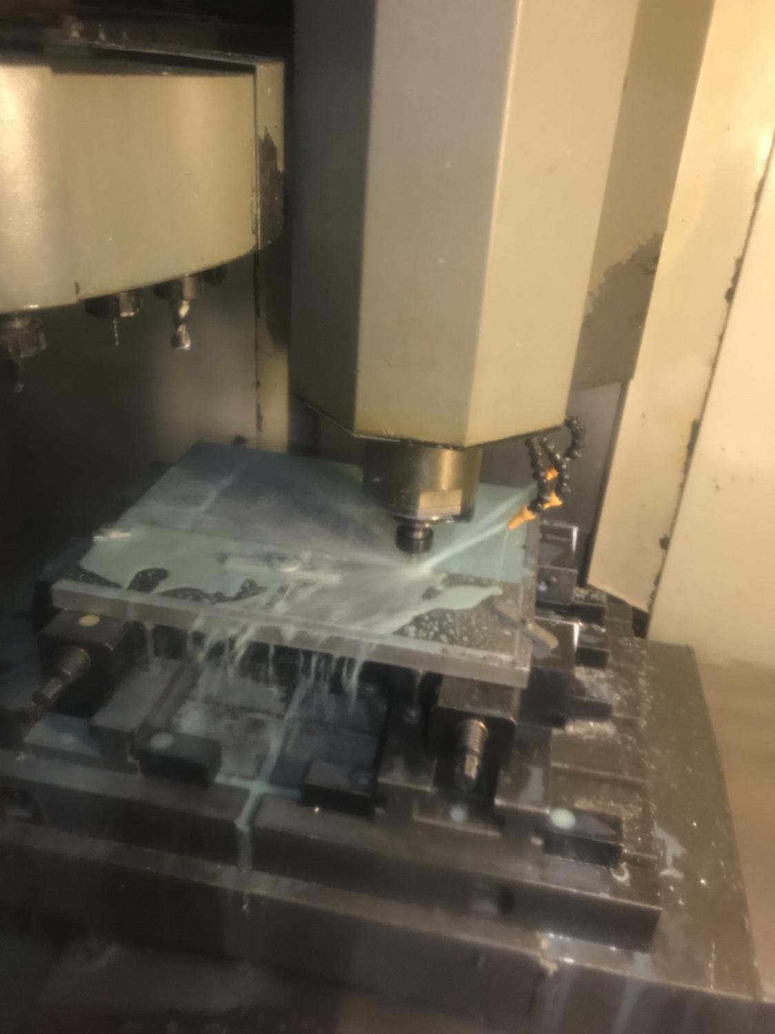

Mines lovely and blue now after cleaning the machine down today!
Just wish we had some interesting jobs in

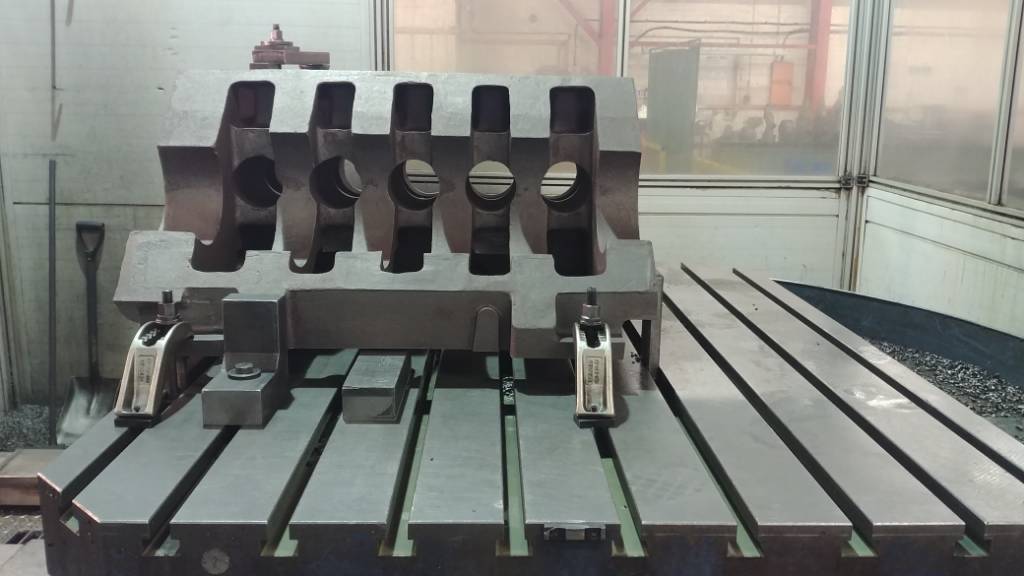

I wish we had some different jobs in. I'm sick of these bloody castings now.
We've no filter paper in the coolant tank and everything is covered in a layer of iron paste that's rusting. The coolant return channel was clogged with it yesterday, I had to chisel it out!

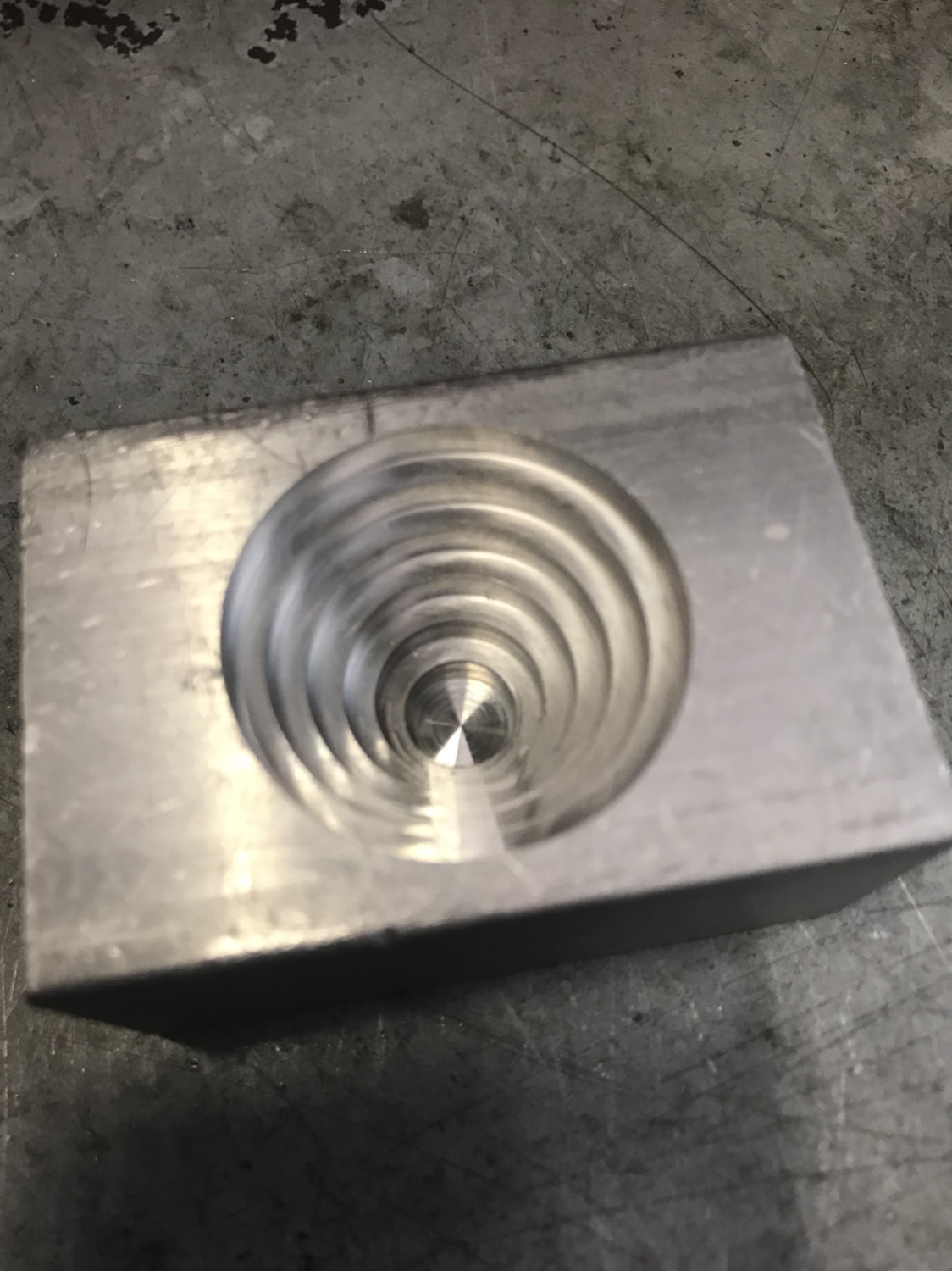

I’ll sub you my s**t out ha! Just counterboring blind holes atm! Finally figured out how to program with i and j’s [emoji4]
I's n j's, kin el I've not done that for a long time. Heidenhain lingo is so much easier to program I'd be fucked playing in ISO again [emoji16]
