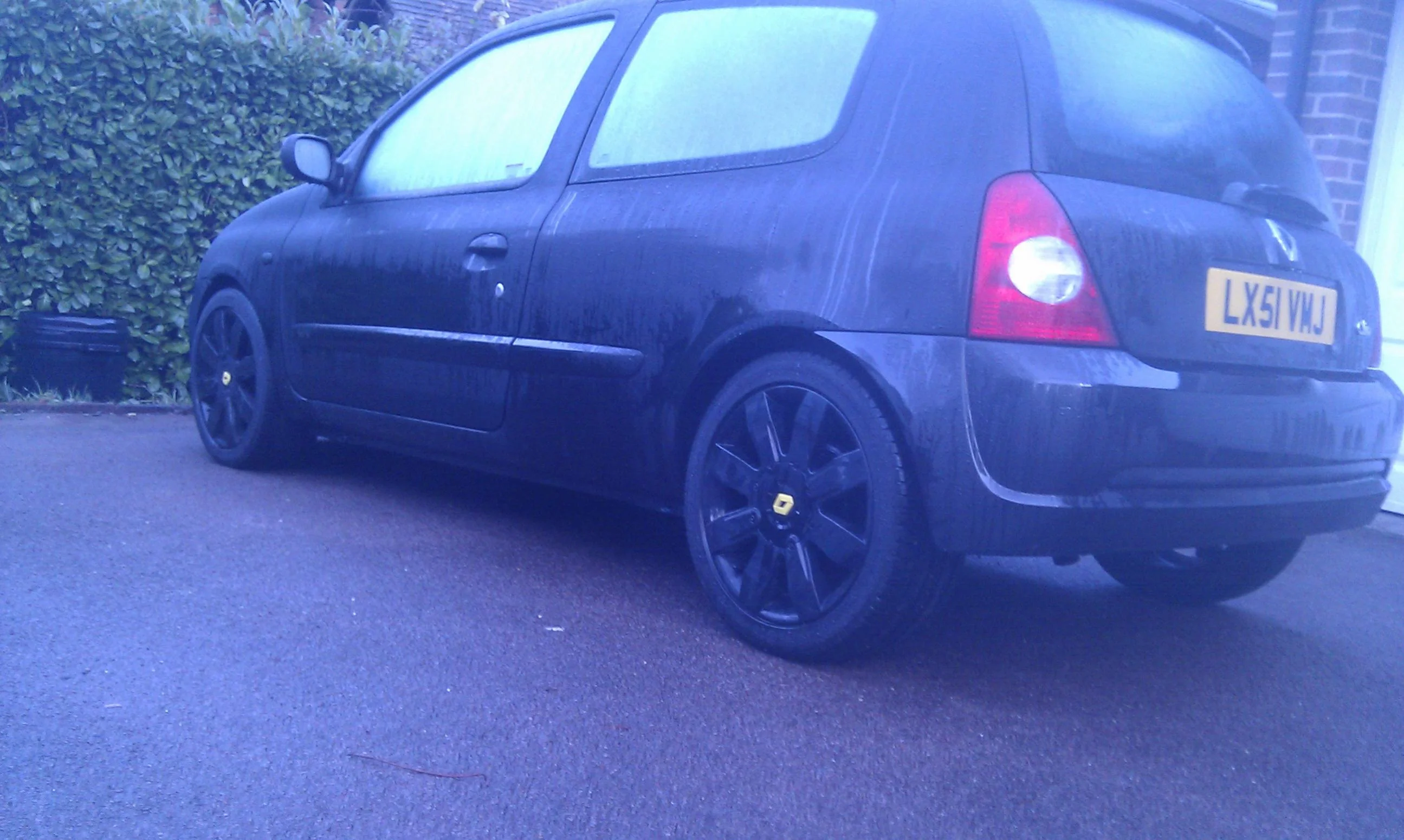

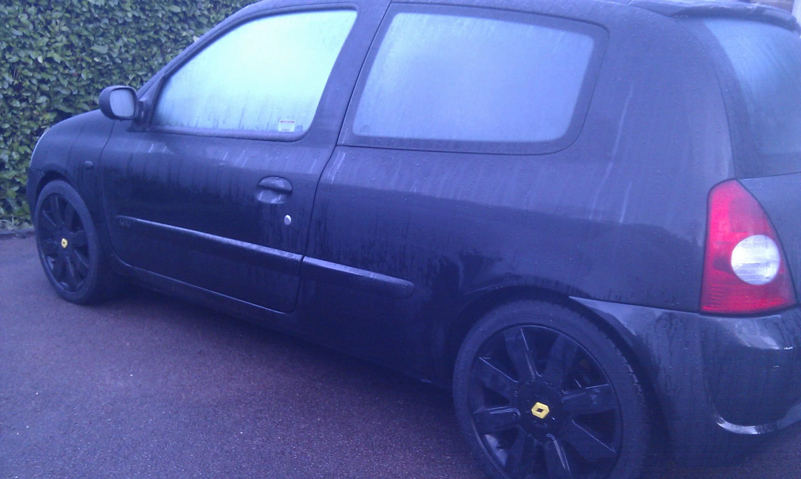

Okay so firstly apologies for starting another thread about coilovers!! Appreciate you reading and any help or advice!!
I fitted my V-maxx coilovers quite a while ago now on my own and I had never done anything like it before and when I had finally finished I was just happy that I had done it, so I didnt fiddle around with them too much.
Now looking at my car Im not happy with the way it is sitting. Just wondering if anyone can help me out with it before I start! I want to raise the back of the car and the front could do with coming down a few mm. I dont want to use the word 'stance' but I want the 'nose down' if that makes sense! Is this achievable with 16's on the car or do I need 15's?
With the front coils I know that if you wind down the spring platform (adjuster) then you will raise the car. Is this the same with the rears? As when I fitted the rear springs I thought that if I raise the adjuster then it will raise the car, or if I wind down the adjuster will it raise the height? Ive taken a few pictures to help explain what I mean.

Do you mean the other way round to what you have said?? So lower the adjusters to raise the car...?
From the picture I have taken you can see that the rear adjusters are currently at the heighest adjustment they can go...So they cant go any higher, so the rear cant go up anymore?

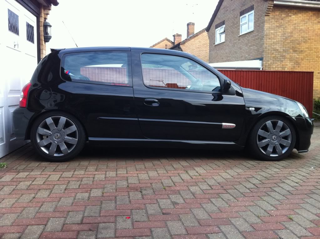

I get what you are saying mate, but I don't get how it sits that low at the rear with the v-maxx's wound all the way up :S
With mine (vmaxxs also) wound all the way DOWN at the rear, it's not even that low...
Either mine or yours have some problems lol

Haha, well for the fronts you wind them down to raise the car up, so Im thinking its the same for the back? Wind them down to raise them up?
Thats what I am hoping as they are wound all the way up at the moment!! Maybe Ive done something wrong? Havent included something from the old setup that I should have?
Haha cheers for the help matey!! Thanks for the picture too, thats the 'nose down stance' I want on mine that you have on yours!! Lovely car btw! ;)

No mate, wind them DOWN to go DOWN! And UP to go UP
That's why I'm saying mine ARE wound down all the way and not sitting as low as yours :S which I find strange!

Decided to ignore your advice :rasp: and contacted K-tec today...I then sent them some pictures of my rear springs and they immediately said they looked wrong! Apparently the spring is just failing! There was a batch of springs sent out too short?! So this explains why the rear of the car is so low! The spring isnt really supporting any weight, they are just flat! (You can see in the second picture ^^)
So anyway K-tec have said they are speaking with their distributor who then is speaking to V-maxx!! So now Im just waiting for the chain of people to contact V-maxx then contact me back! Hopefully shouldnt be too long :coffee: Meanwhile im driving around on broken springs :dapprove:
