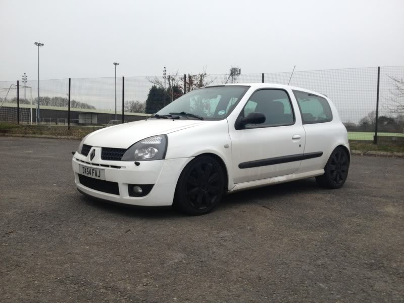

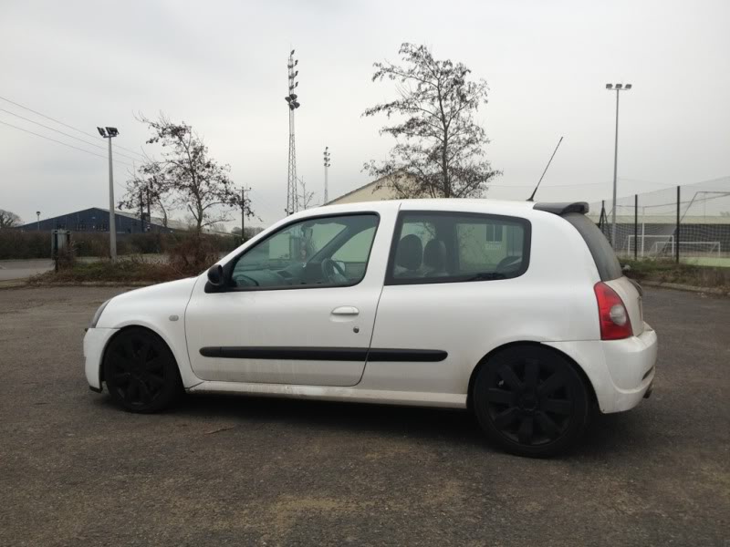

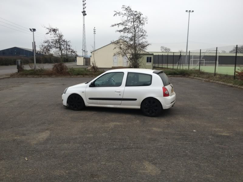

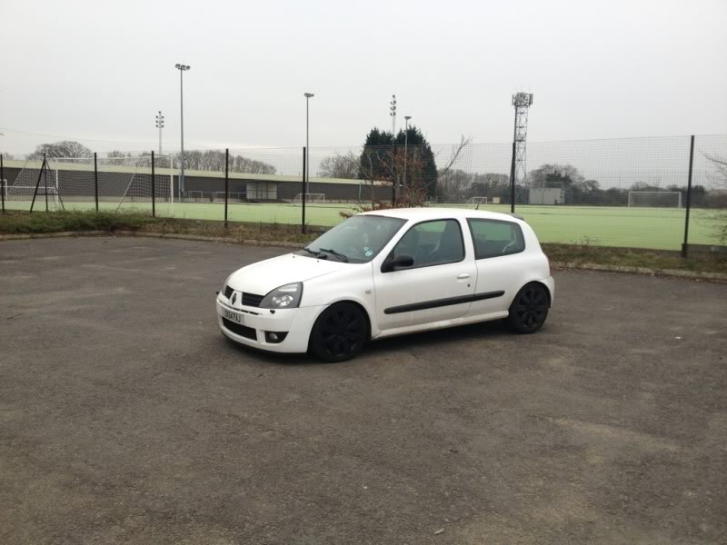

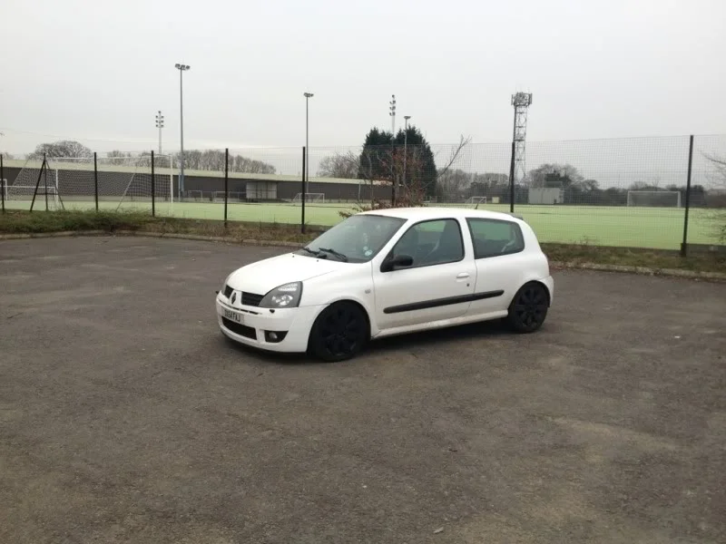

The worst pictures ever i know but my coilovers went on Friday night. The car handles like a go-kart now so im loving it but im being told by all my mates i should take it slightly lower? Sometimes i think it looks just right, others a touch high.
I might just lower the rear a touch more? Although i want to keep it nose down.

That's just right.
Maybe even a touch too low at the front for me, but i'd always aim for go, not show.

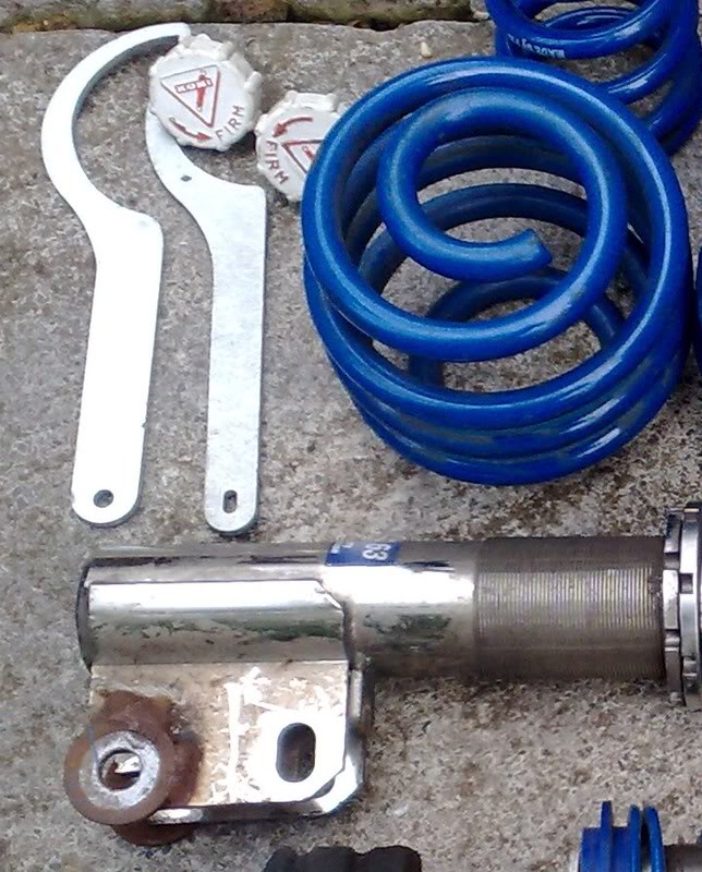

Also, anyone know which way you have to twist the know on Konigsports for softer and harder? Ive had a quick play and it seems clockwise to make them softer but id have thought it'd be the other way round..

Thanks mate. I was right! Still, wouldnt have been too hard to work out.

Height looks spot on mate! Definitely no lower.
Cup spoiler sprayed white, and either a new wheel colour/new wheels and that will be lovely :)
Some nice bright silver turinis would look lovely on that. Sheepish I know, but for a reason!
  PH1 iceburg
Good height that, the wheels must scrub though (unless you have made some modifications).

The height looks good but maybe needs to go up a touch at the rear for a nice bit of rake
_Tom
Thanks people. Sbridgey, it does have a fair bit of rake? I would always set it up this way tbh.

Sorry was being a bit special when i was looking at the pictures! :eek:

Fine as it is, maybe even a touch higher.
Can't stand the wheels in black though mate.

Thanks guys. Front splitter rubbed on a speed bump last night so its certainly not going lower. Just need to get it frickin lazered now.
Wheels look ok when they're clean. They're quite a high gloss black however they are kind of grey there from all the salt on the roads. Still, new wheels will be coming. Probably Turini's by the looks of things. Boring i know.

It is for go not show for sure.
Get some nice light 15's on if your after getting the best out of it. If it feels good now you'll love how it feels on 15's. It'll accelerate faster and change direction quicker. Only possible draw back to highlight for me might be that with the extra tyre wall on 195/50/15 you can feel a slight snap or movement when changing direction quickly. That was with paradas tho which have sidewalls made of cheese, a firmer sidewall or dropping to 195/45/15's should be the perfect setup.
And as for height wise i'd say it looks good to me as long as your not getting too much scrub at that height.
