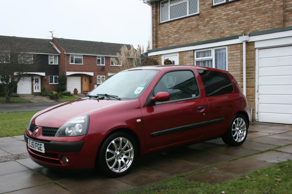

40mm on standard shocks will be abit rough, Im currently on 40mm lowering springs and it looks like this:

Hello mate, well I'm currently on 40mm springs and standard shocks, which is fine to be honest, its bumpy, but bearable. I only posted one picture btw? And yes, they are 15" wheels.
