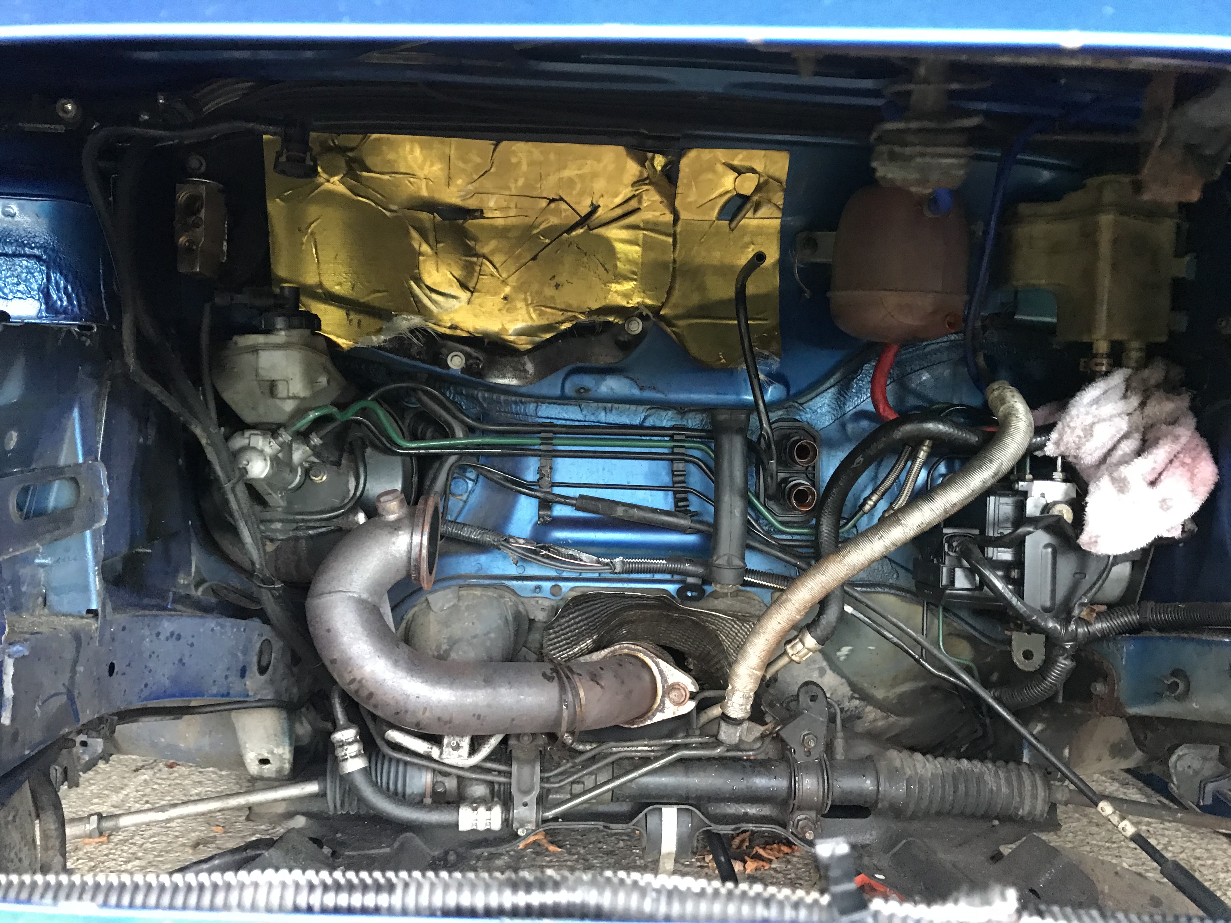

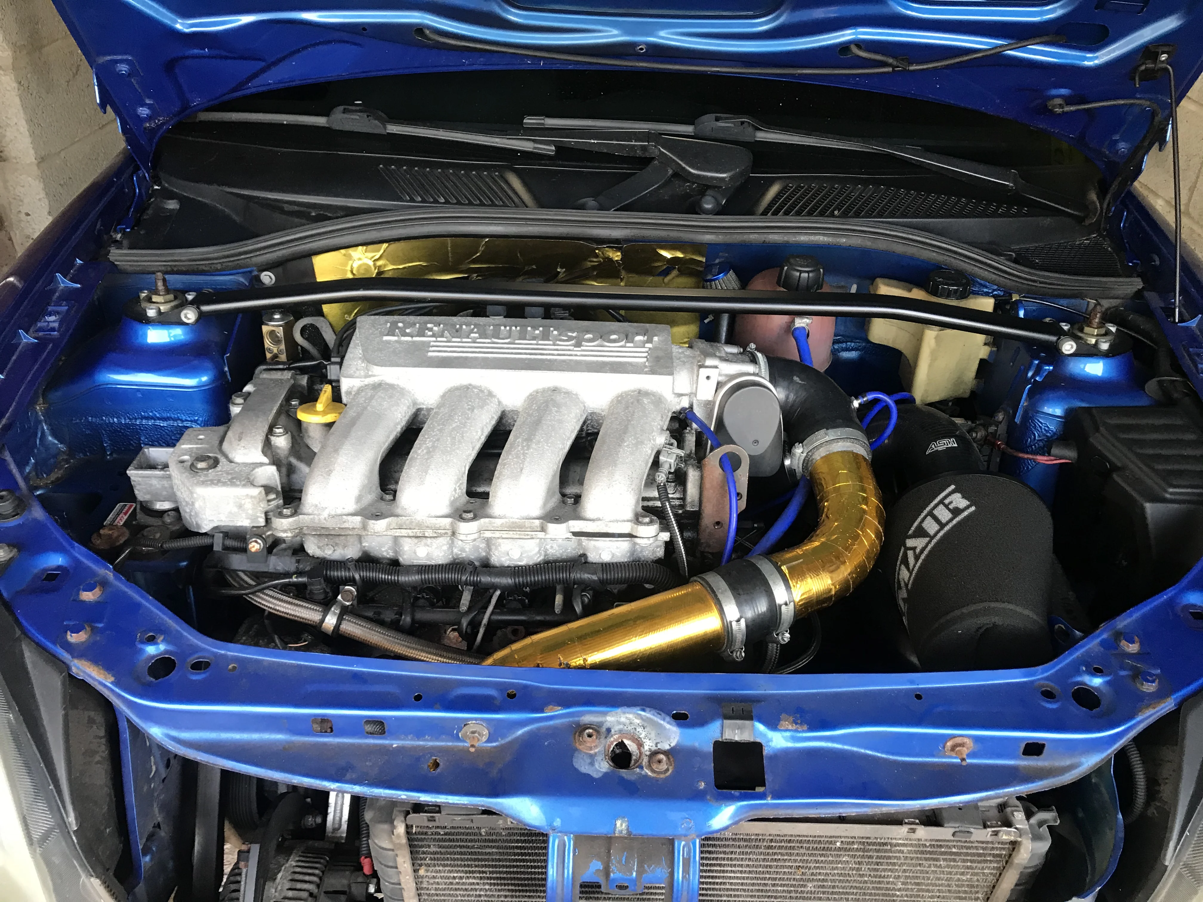

It was when I got the car into my garage and started to look over it I realised it’s a a bit of a death trap!
list of things wrong so far;
No decent heat shielding, just cheap tape that’s peeling off.
Massive fuel leak from a joiner in the fuel return line as it’s running a ph1 setup.
Boost hose kit looks like it’s been cobbled together and doesn’t fit properly in the slightest, and fouls on everything.

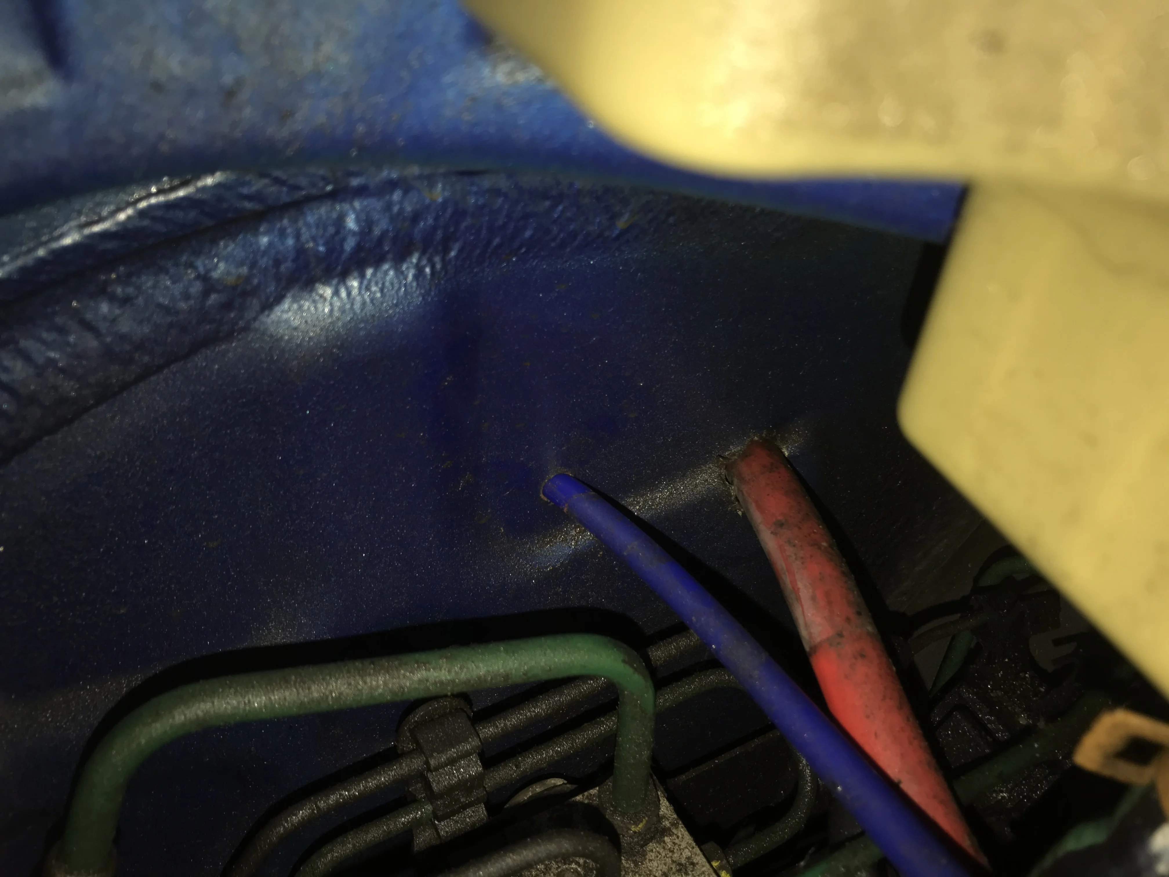

Battery has been relocated with the thickest cable ive ever seen, and where it’s gone though the bulkhead it’s nearly rubbed through. Would’ve been fun if that shorted out with a fuel leak!!
And so far that’s it.

Jesus, how can you put effort into pretty intensive mods but not even shove a grommet around a cable lol. 🙀
I know right, baffled me too! The hole isn’t even nicely cut, looks like it’s been done with a punch!

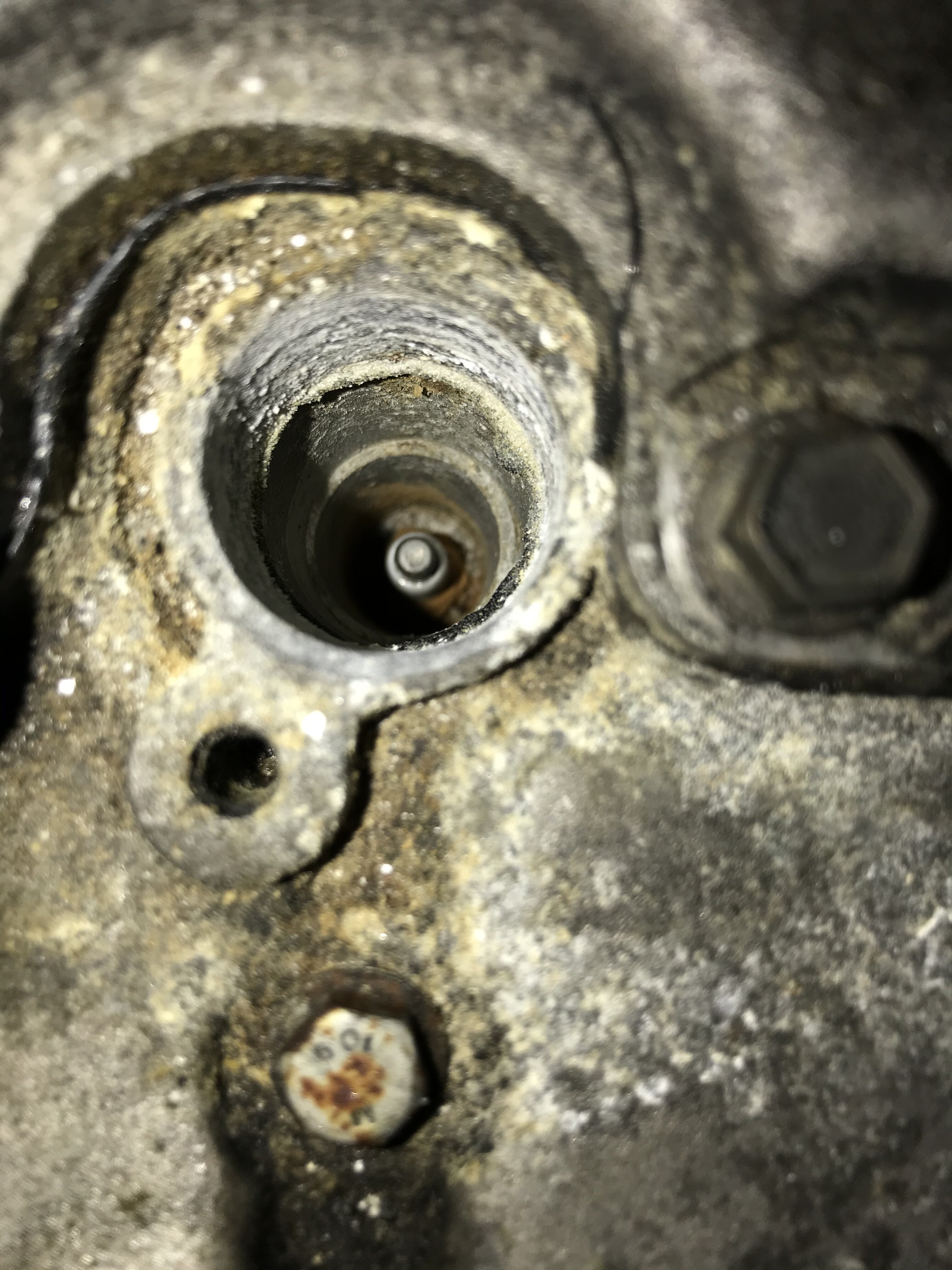

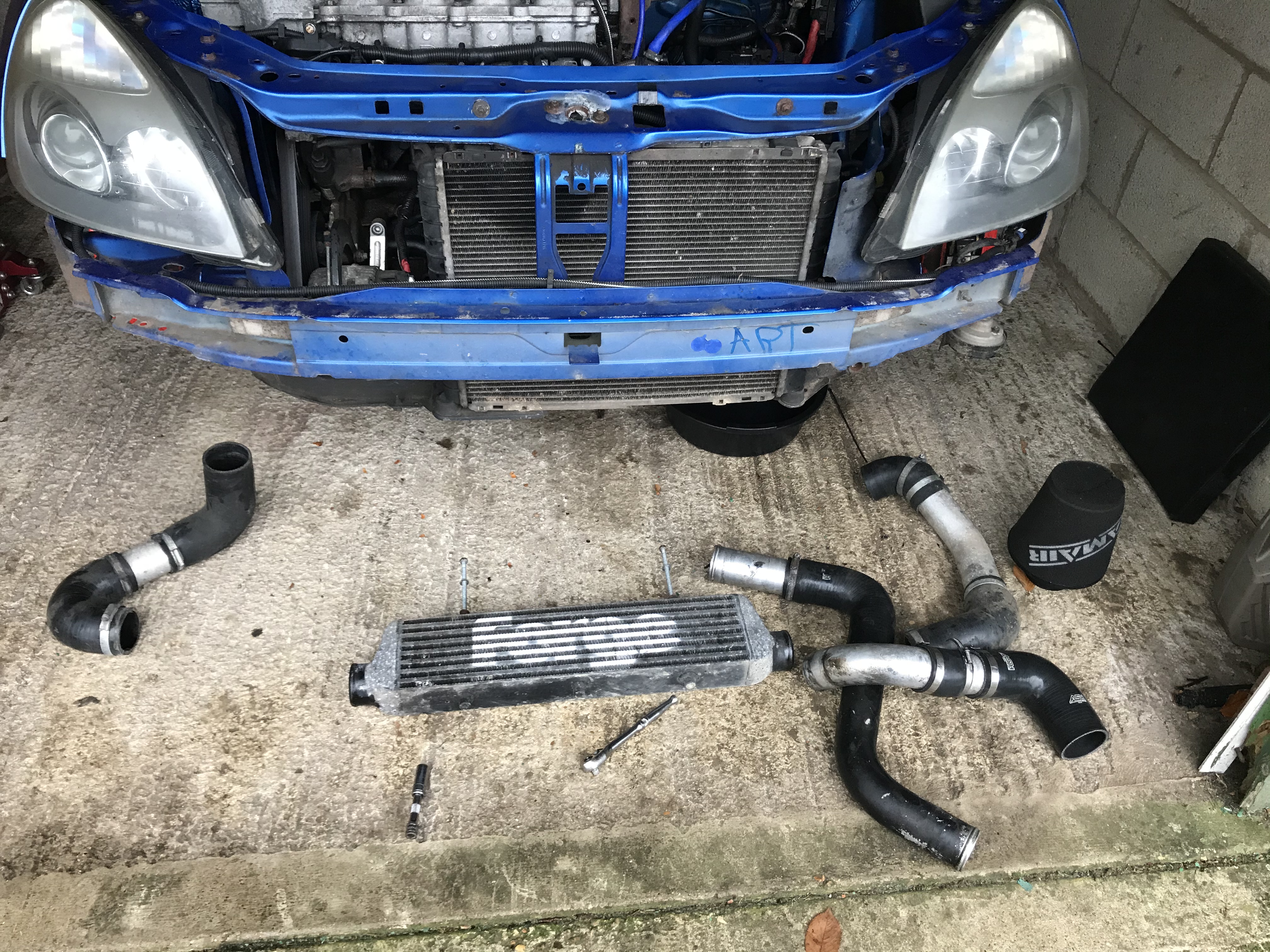

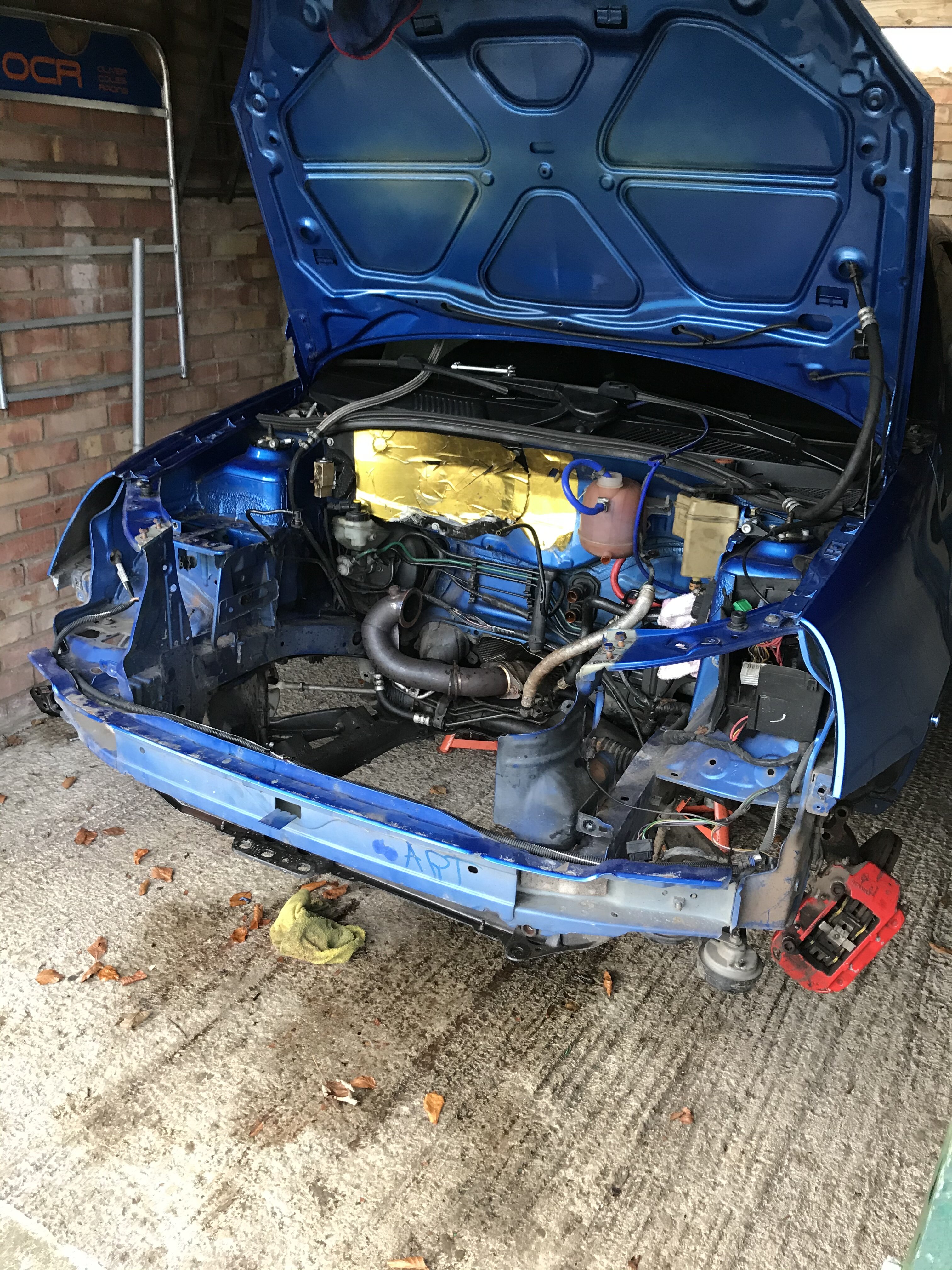

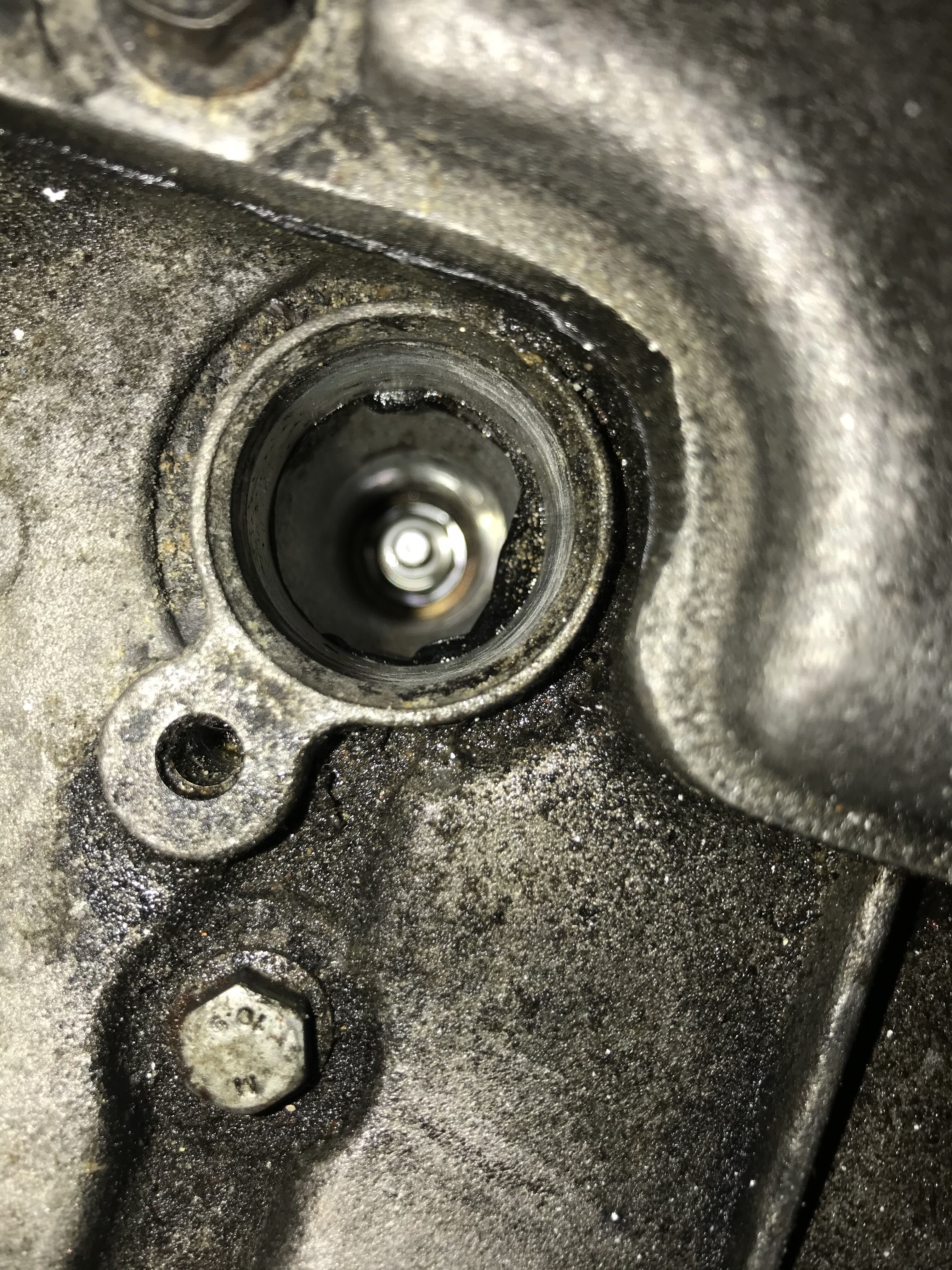

Made a start today, removing the boost hoses and getting the inlet off. Happy to find an EFI boost module plumbed in, not so happy to find a rusty spark plug hole and a cam cover hoofing oil out as black sealant was used. Not too much of an issue as I’ll reseal it when I do the cambelt.
Also found the brake servo pipe melted and collapsed as the attempt of any heat shielding was poor so it’s just purely melted. That was it today though, came inside because I was cold and wanted to watch the Silverstone 500.

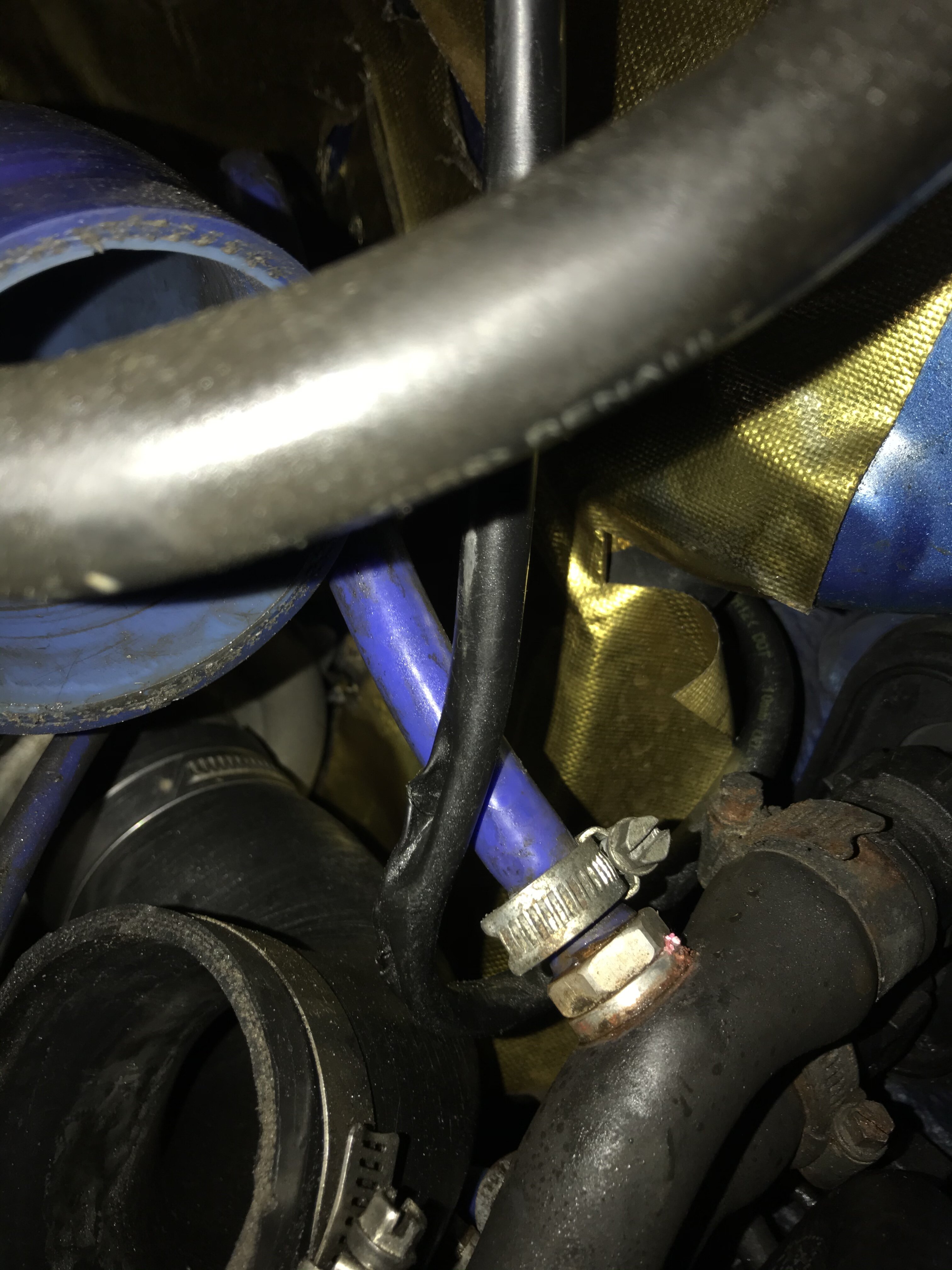

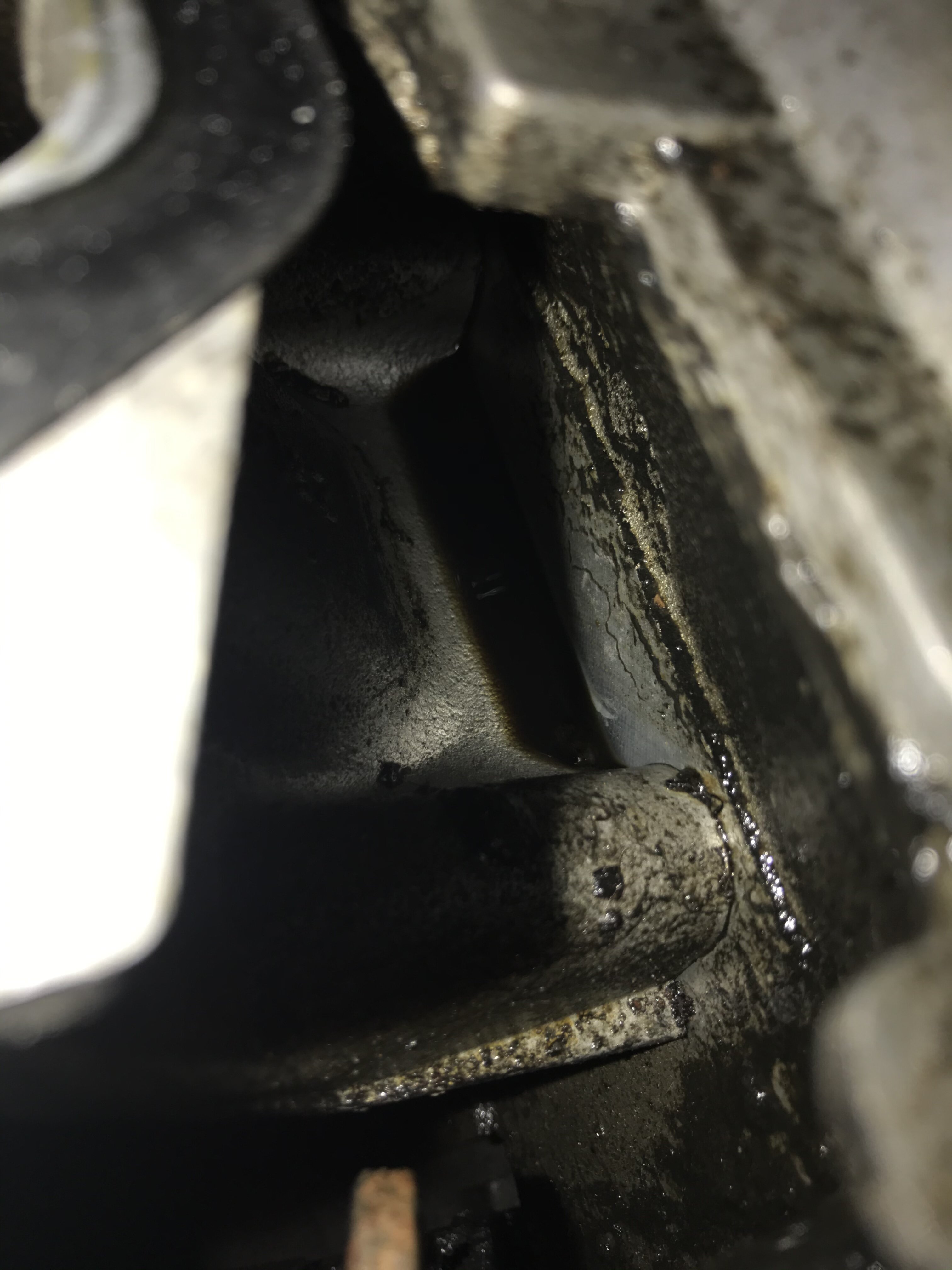

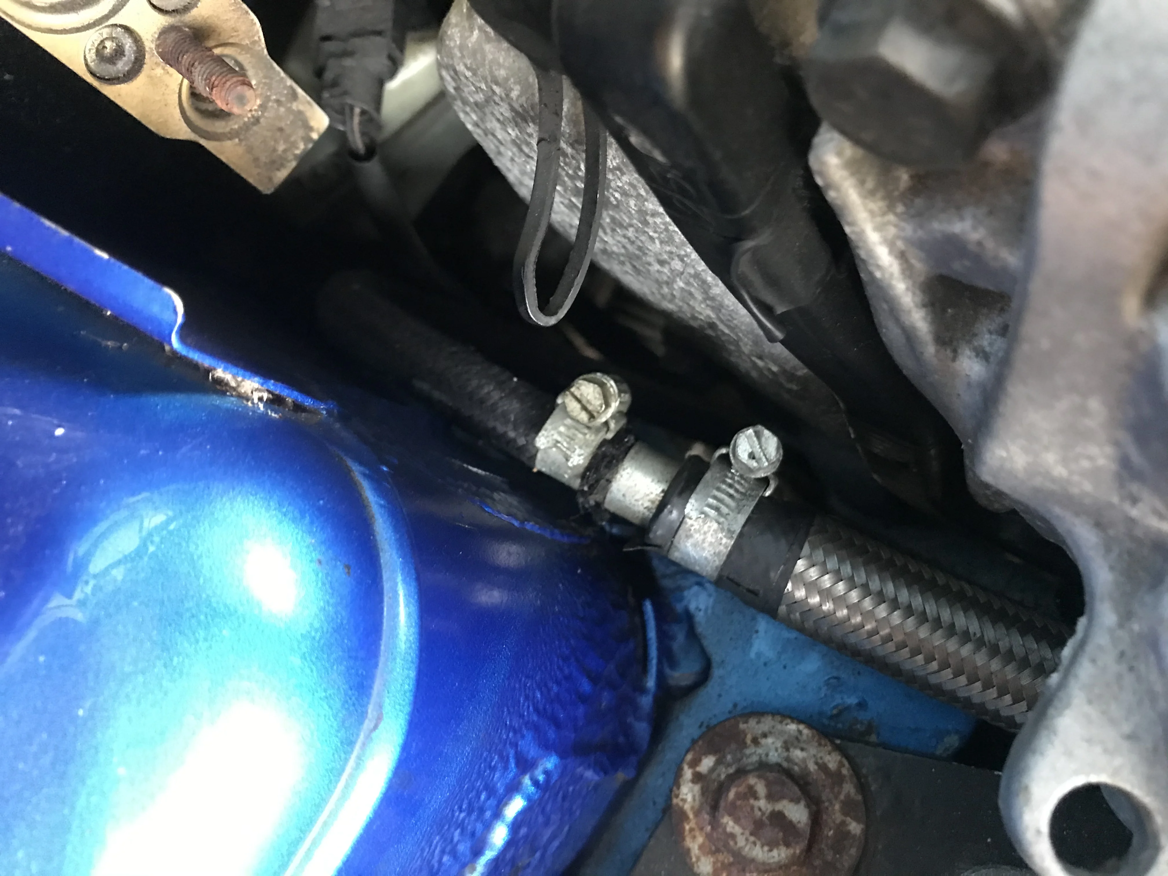

This pic shows the melted brake servo hose but also the coolant feed for the turbo, is their any other prettier ways to plumb this in? As I really don’t like how it looks
Dare I ask what your dad paid for this car 🙈 looks like it has been well bodged together! At least once you have done it then will be awsome little car and has all the right bits. They feel so quick tol and there is not a lot that can get away from them!!
Mine does not run the water cooling as my understanding is it is not that necessary. This was the previous owner that built it like this and confirmed before doing so with ED.
Too much lol! A smidge over 4K I think it was. Interesting regarding the coolant feed, I’m reluctant to remove it as that’s how the cars been running so it’s proven in a sense, would just like it to be a nicer install.
It was sold saying it had the ED kit on it but I’m not so sure, I think whoever built it has looked at the parts list for the ED kit then tried to buy the parts separately.

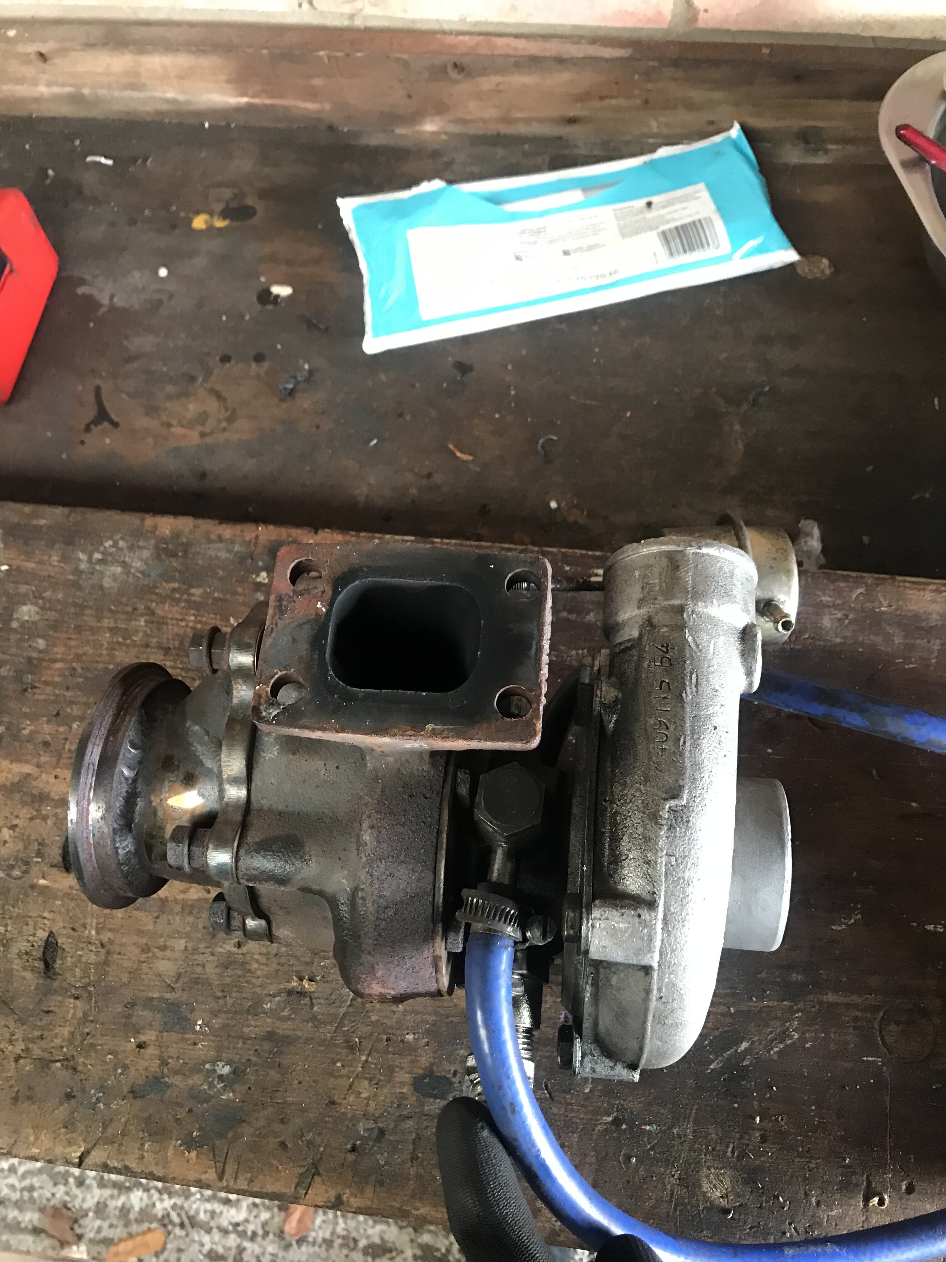

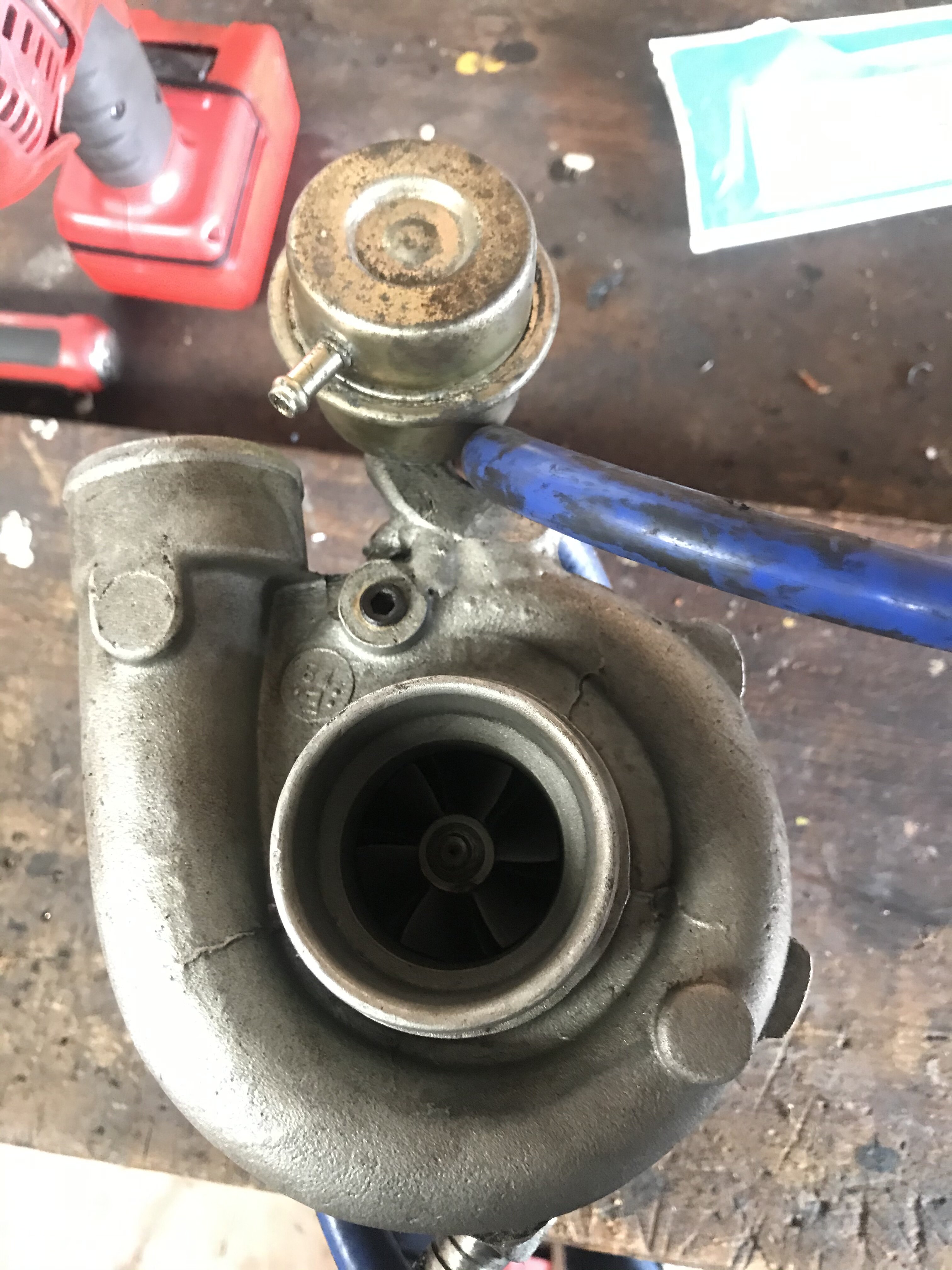

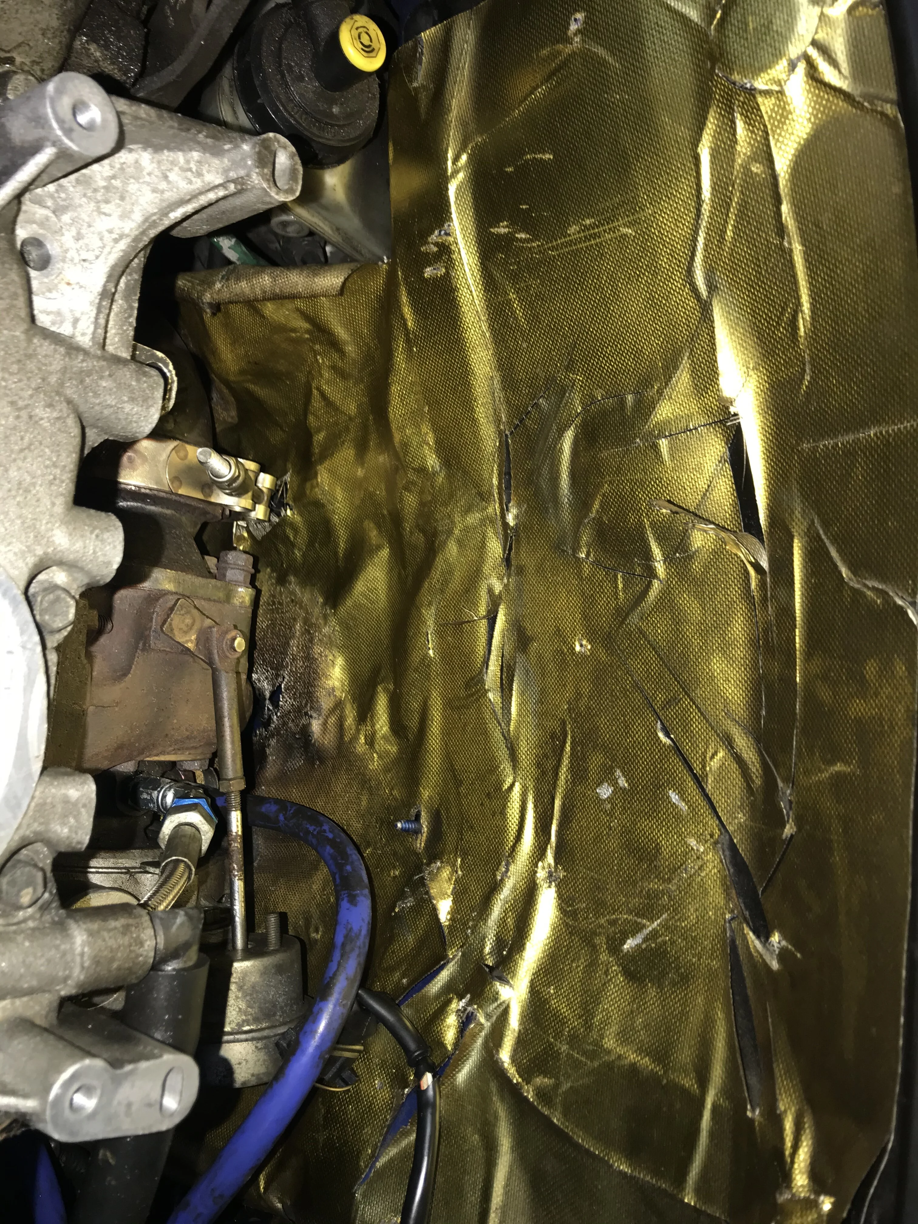

Some more progress today, got the turbocharger off. Looks largely okay but it has got some wear on the cold side vanes. Is it possible to get a Chinese turbo rebuilt? Think it would be a beneficial for reliability.

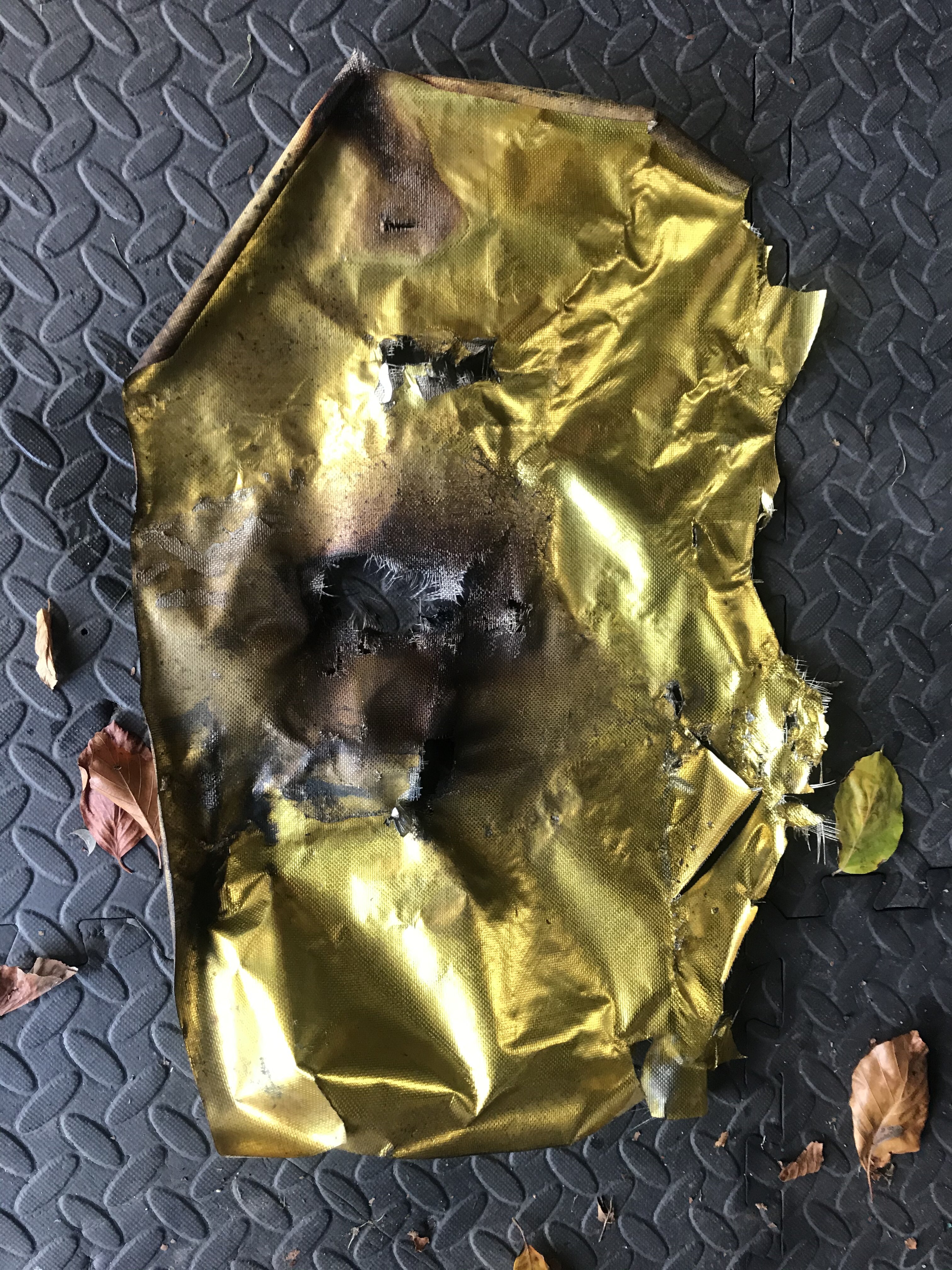

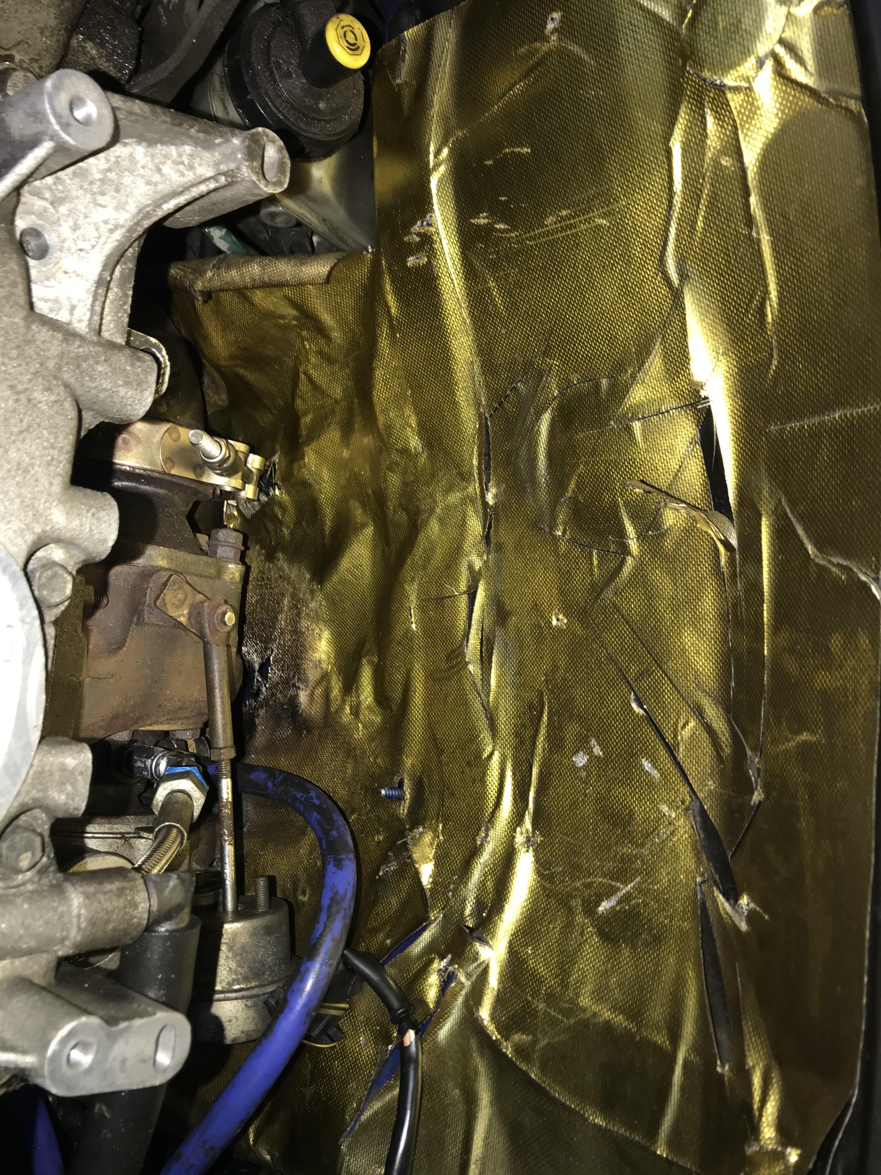

Also if you’re reading this and about to turbo your 172/182 please make sure your heat management is up to scratch! This car had gold reflective tape that’s nearly set on fire and everything behind it has melted, luckily the wiring is okay.

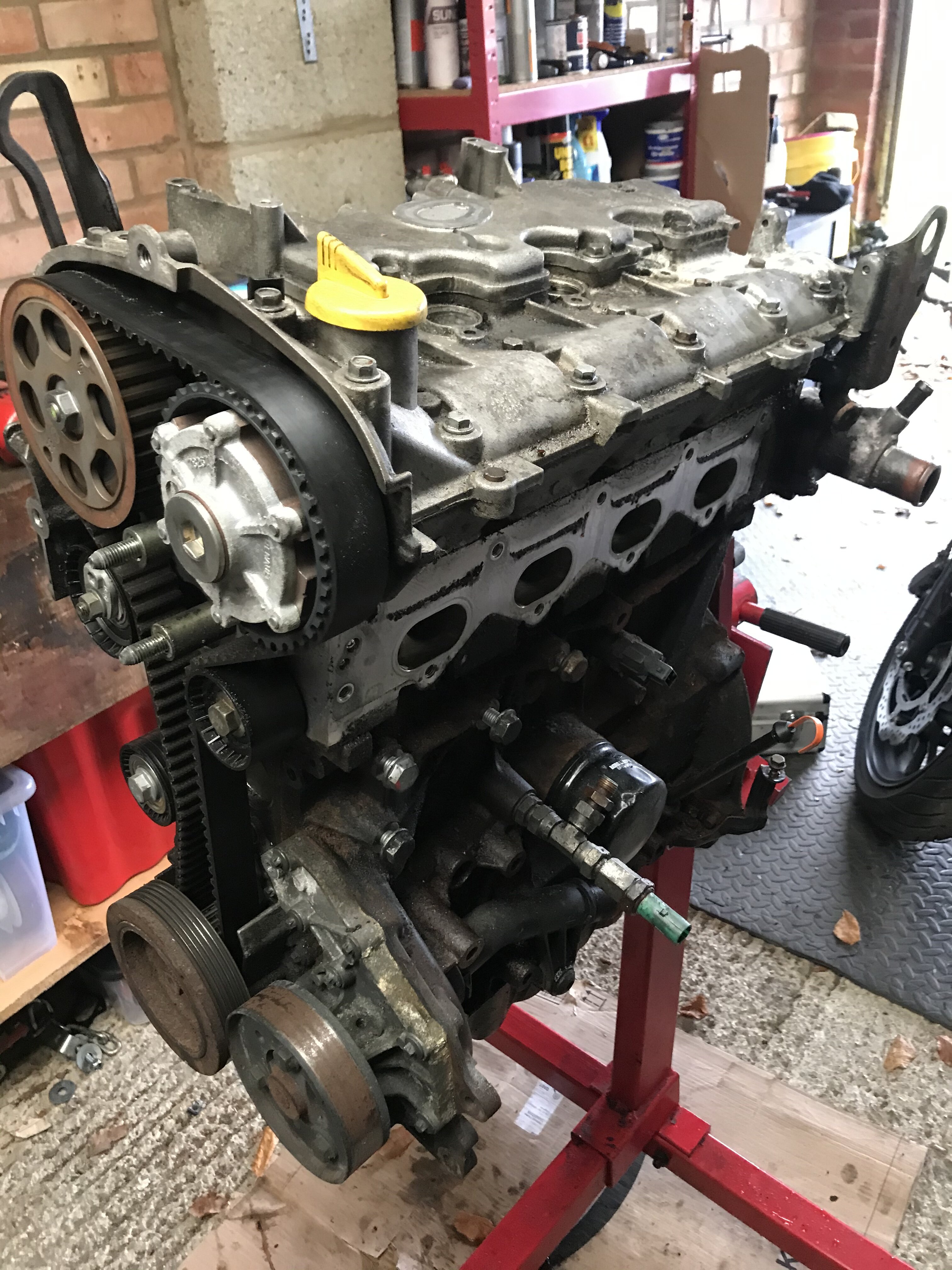

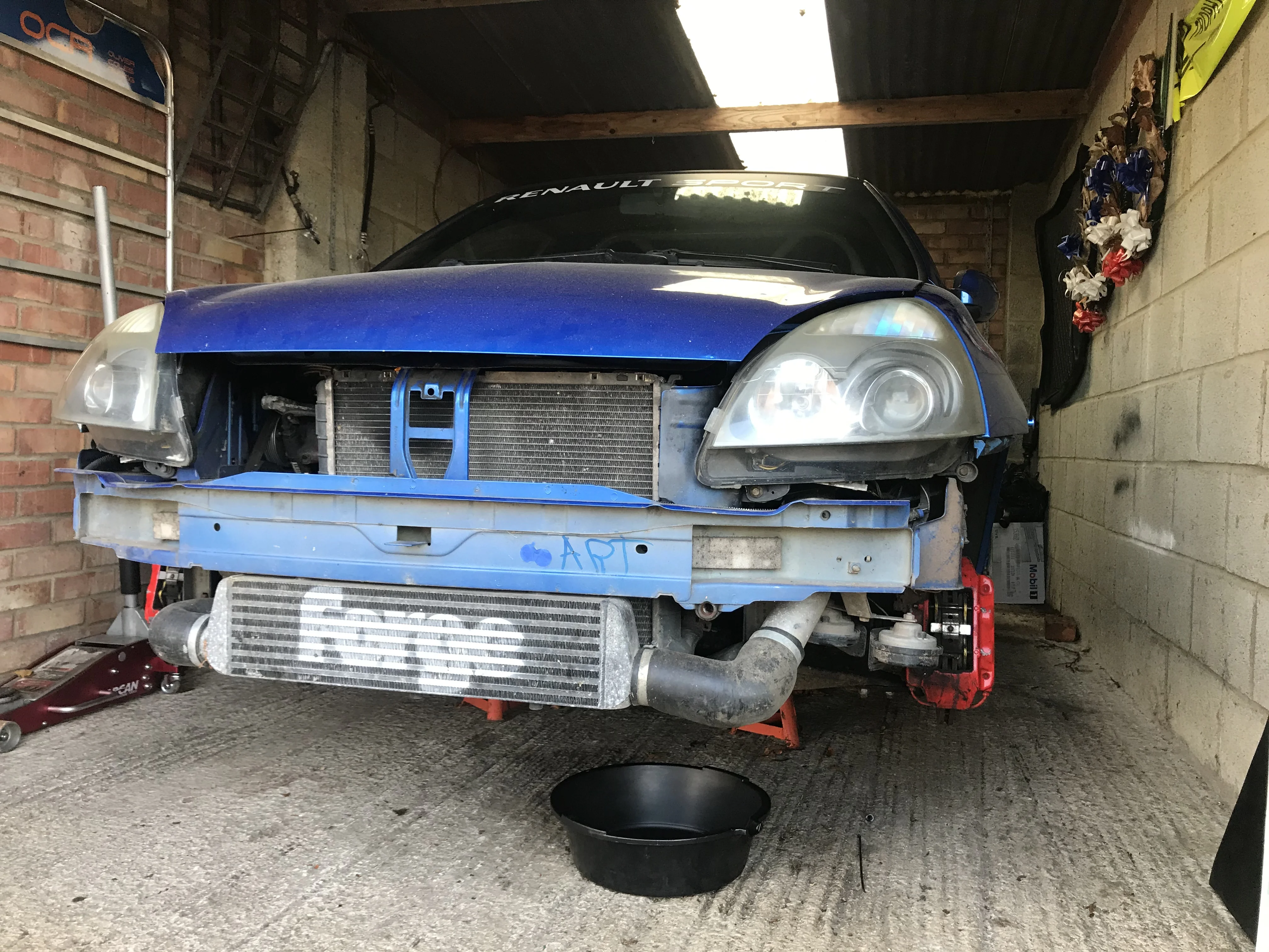

Some more progress today, engine and gearbox removed not much else to report except the gearbox spider mount bolts were finger tight! Next point will be to get the engine stripped and checked and replace anything needed. I’ve got the time so feel it’ll be worth it.
anyway that’s it for now cheers
Where’s your heat shield on the rack mate?
Person who built the car thought it wasn’t needed lol so many bodges and corners cut on this car, I can barely believe it ran or hasn’t caught fire!

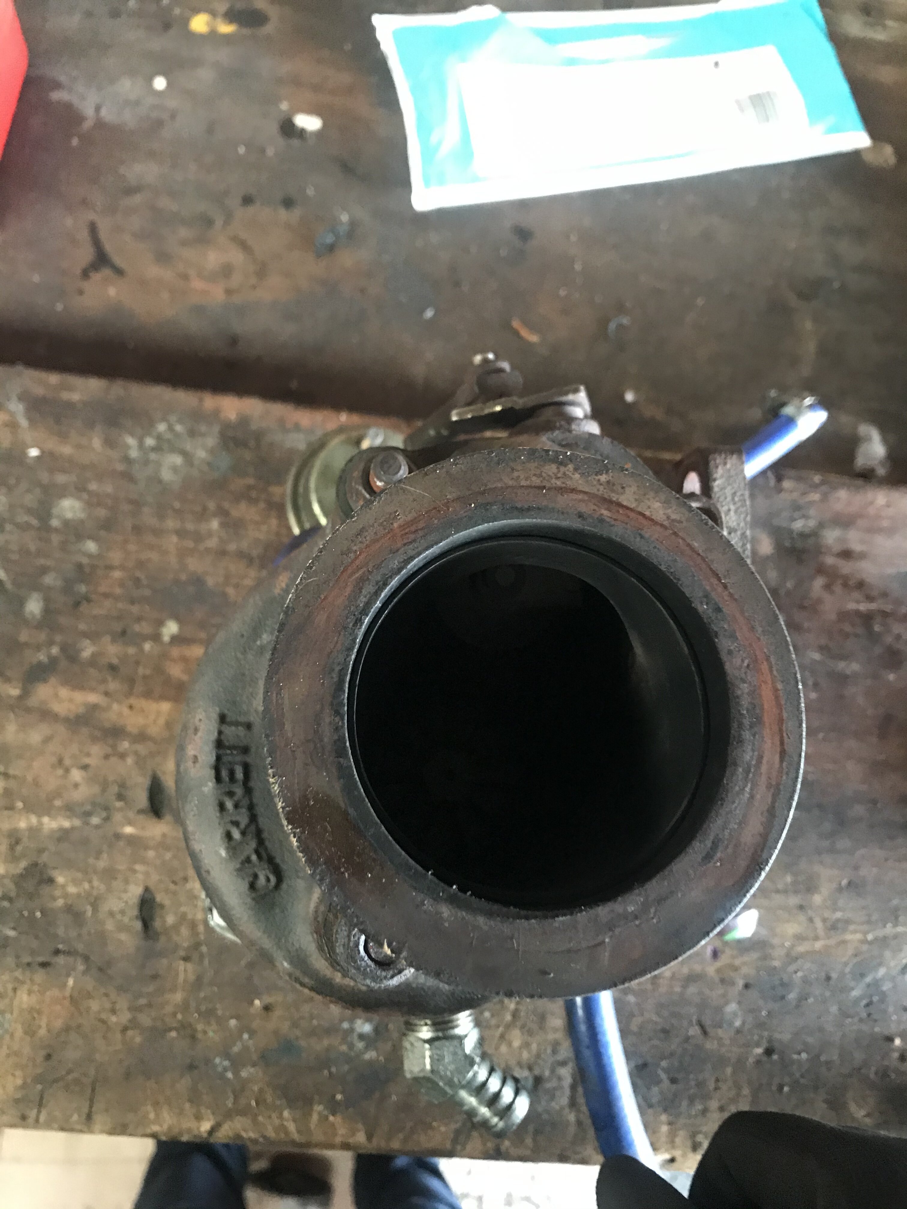

I need to find out what the turbo is, it’s got Garrett embossed on the hot side housing and not sure the ED one would? It needs a rebuild while it’s off anyway
No, ED one isn’t a Garrett. Got a pic of it?
So by a stroke of luck I found the owner who boosted this car on Instagram, he informs me it’s a GT2860RS turbo on it. Does this sound right? I’m assuming it’s a copy and not a genuine Garrett
Wouldn't have thought it to say Garrett if not a genuine one. Have you got any pics?

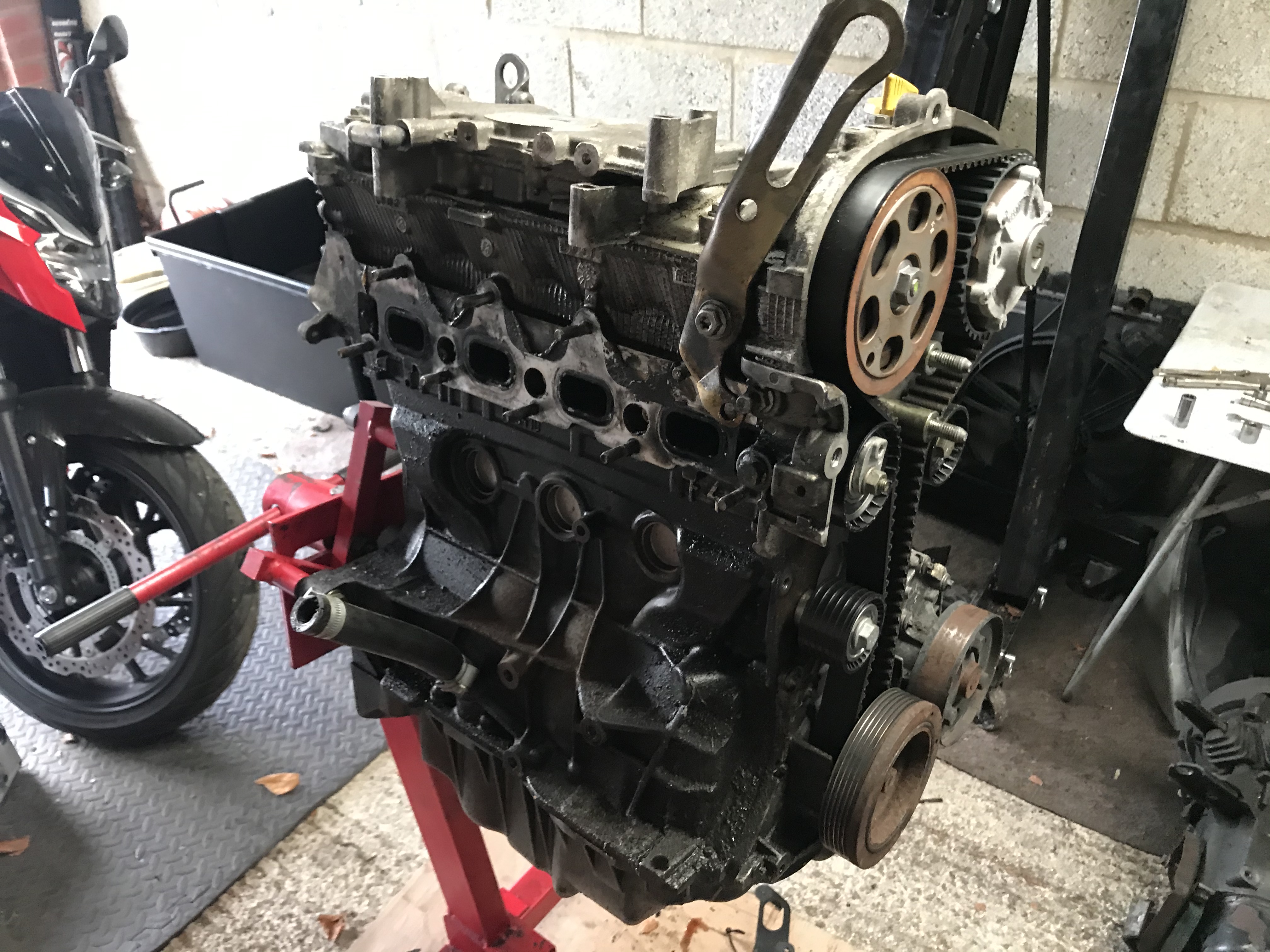

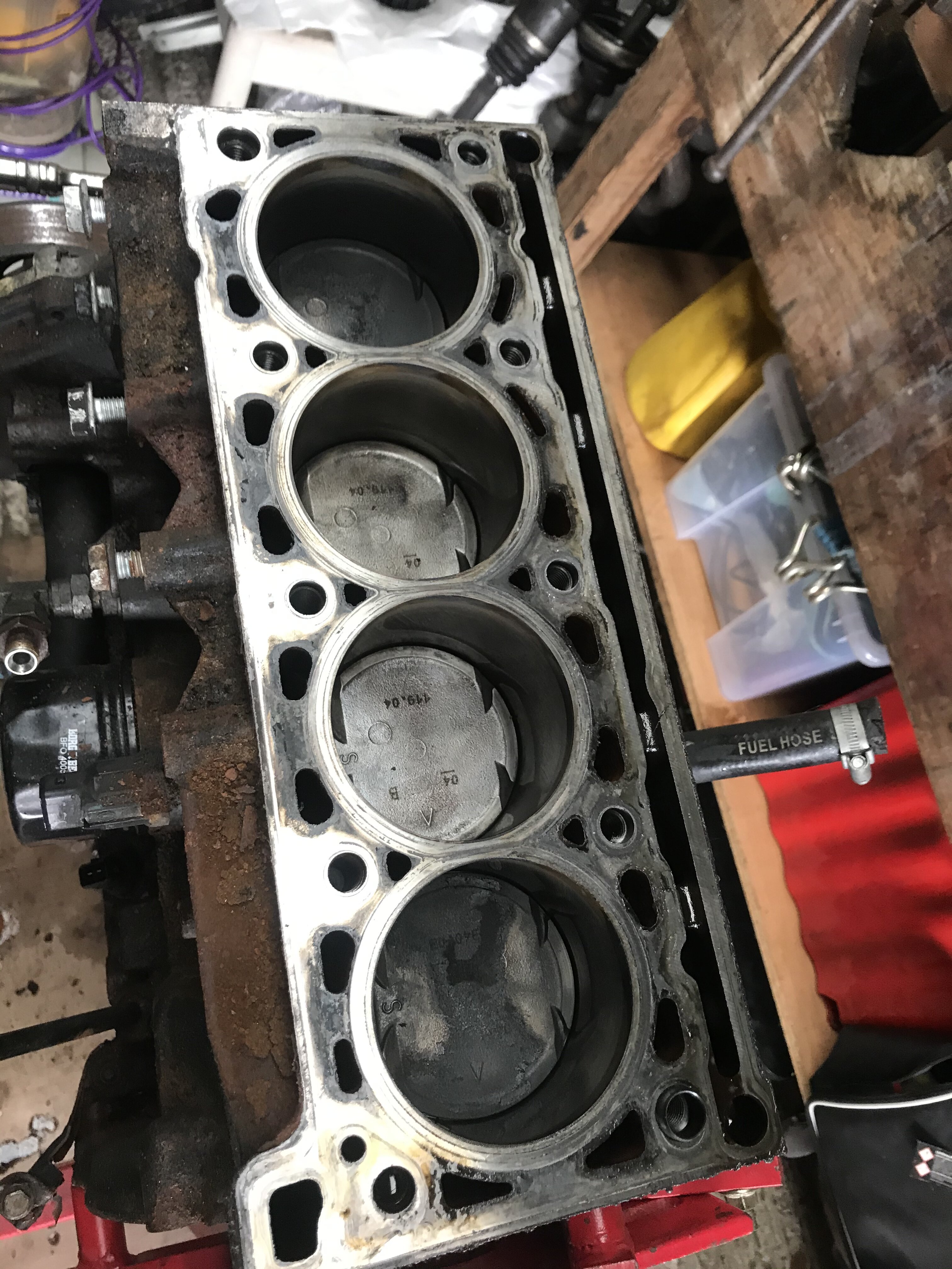

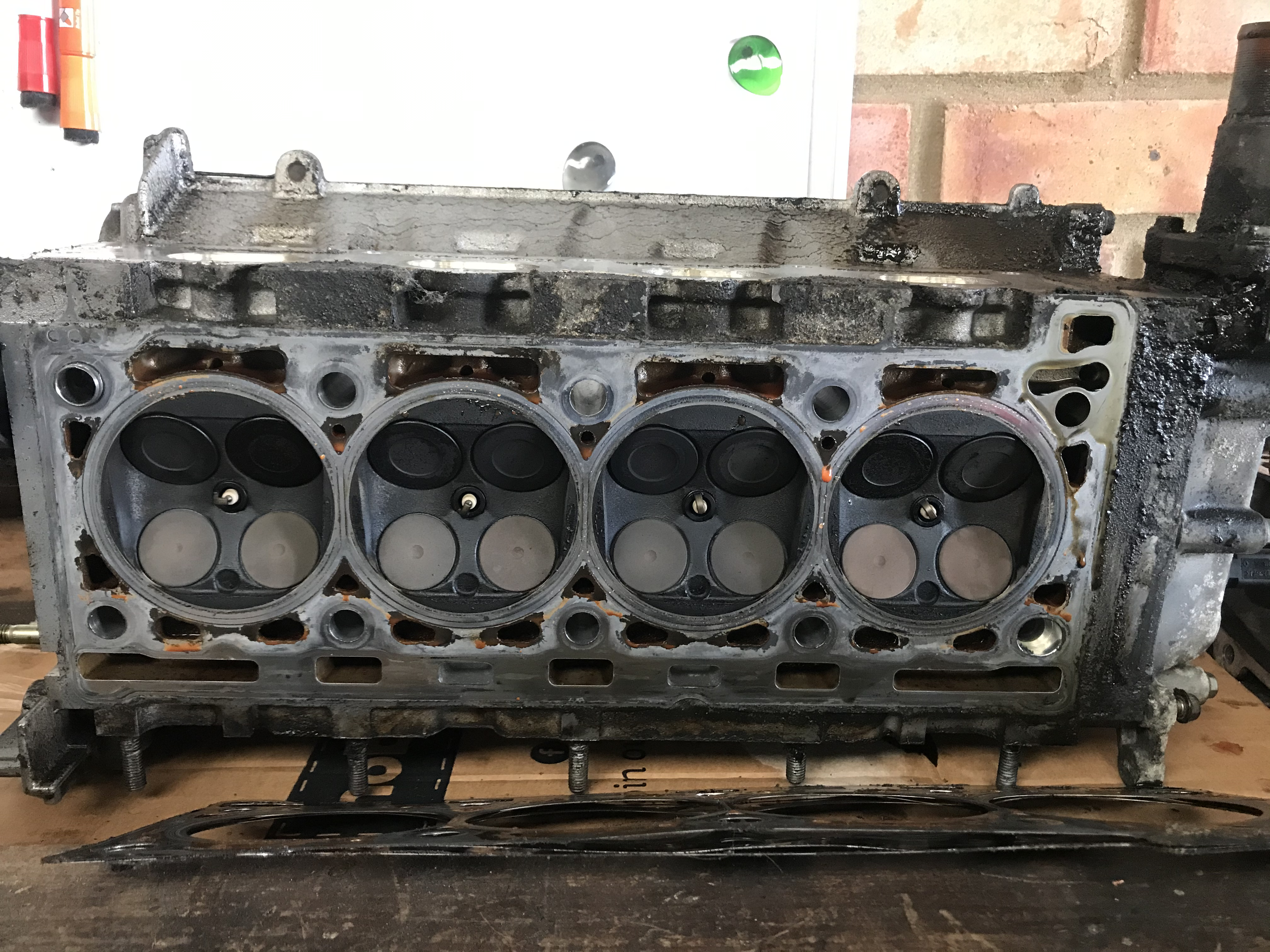

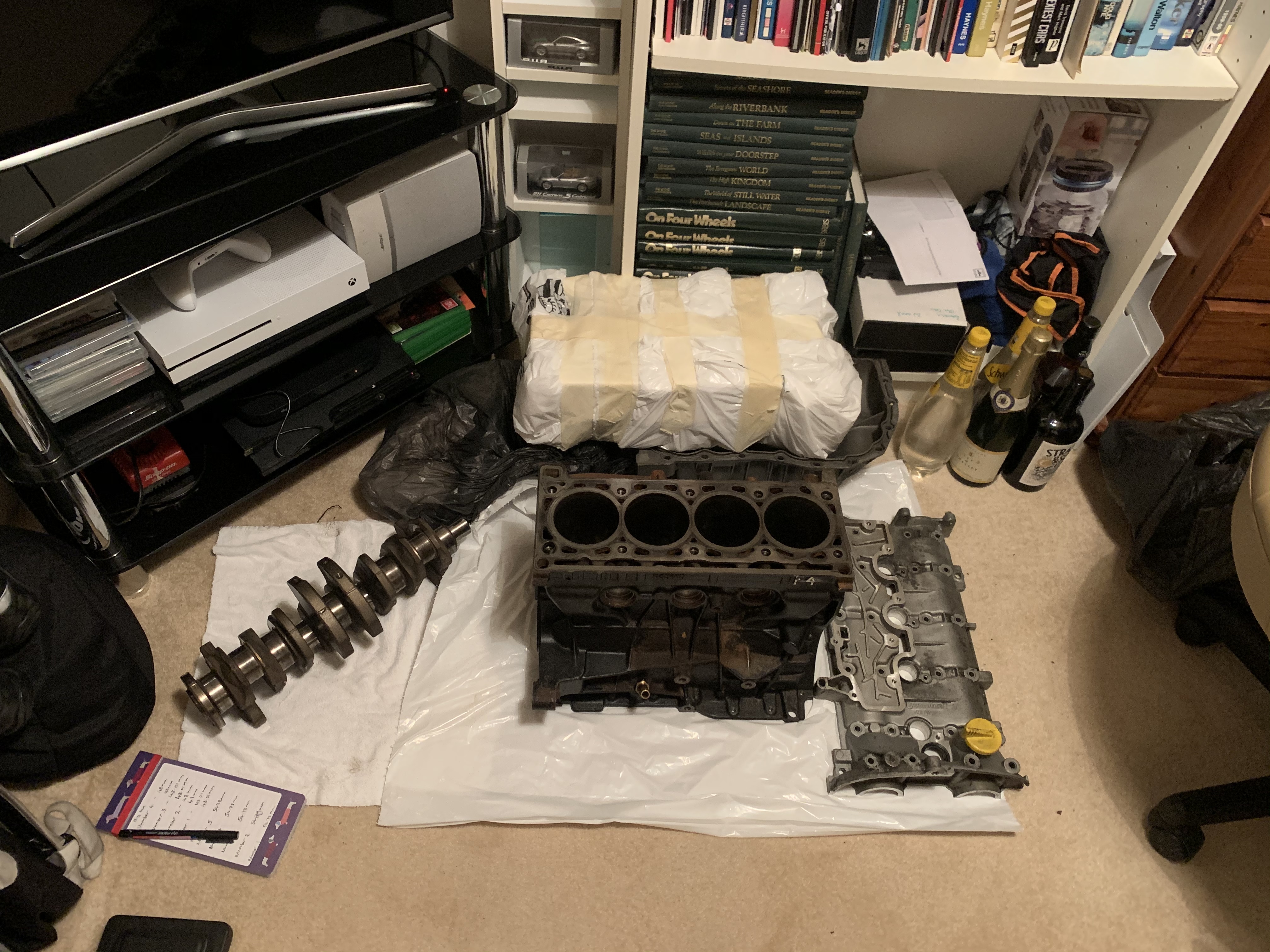

So at the weekend I got the engine out and got the cylinder head off. After seeing the rest of the car I really wanted to strip and check the internals and it all appears to be good. While I’m massively tempted to get some rods/pistons lower the CR and up the boost for now I’m just going to stay low boost and focus on reliability rather than numbers. Plus it would be stupid to go for a big build when I haven’t even driven the car in 240hp guise.
I have read though that I can use a Megane headgasket which would lower the CR a tad, does anyone know which one? I feel this would be worth while, while it is apart. I will be getting the map checked by Chris at EFI when it backs together anyway.
cheers for reading as always
FYI number 2 and 3 pistons weren’t clean like that when I got the head off I just cleaned them before the pic

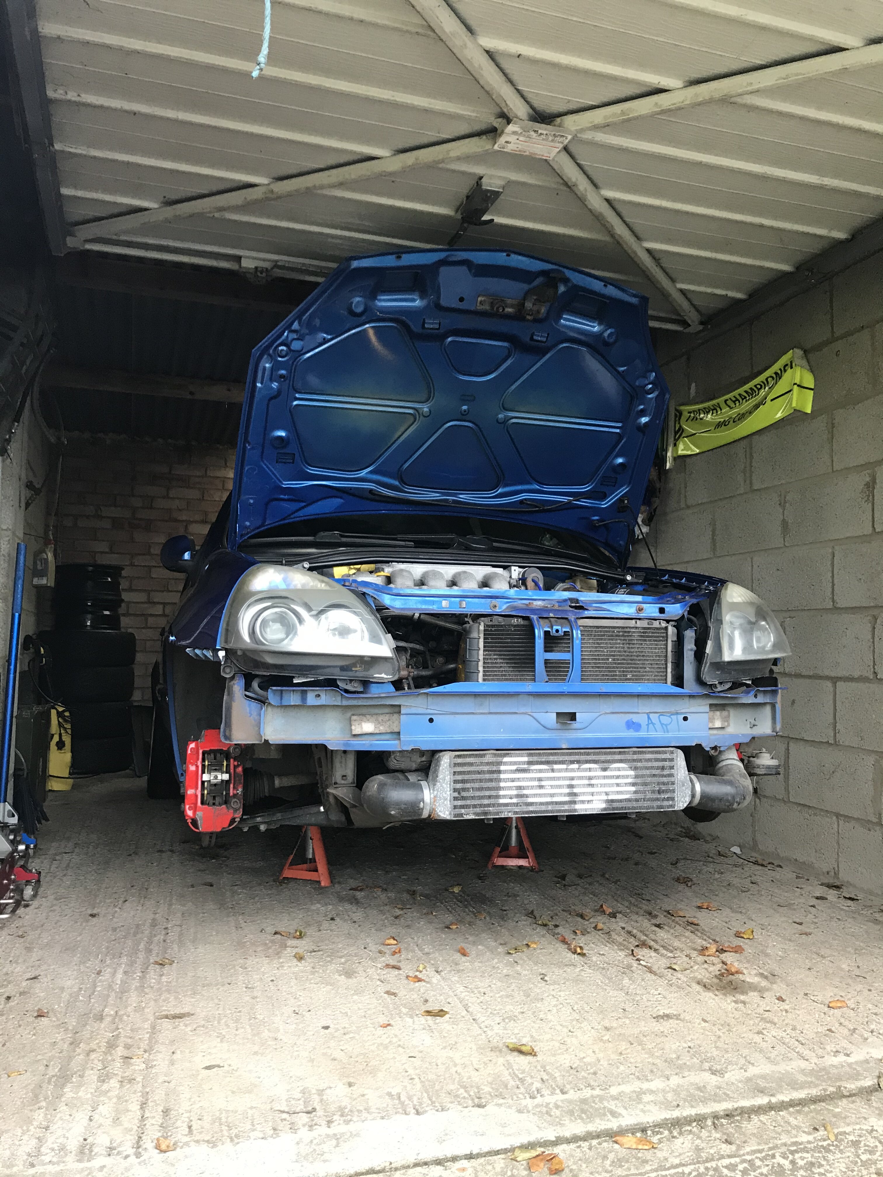

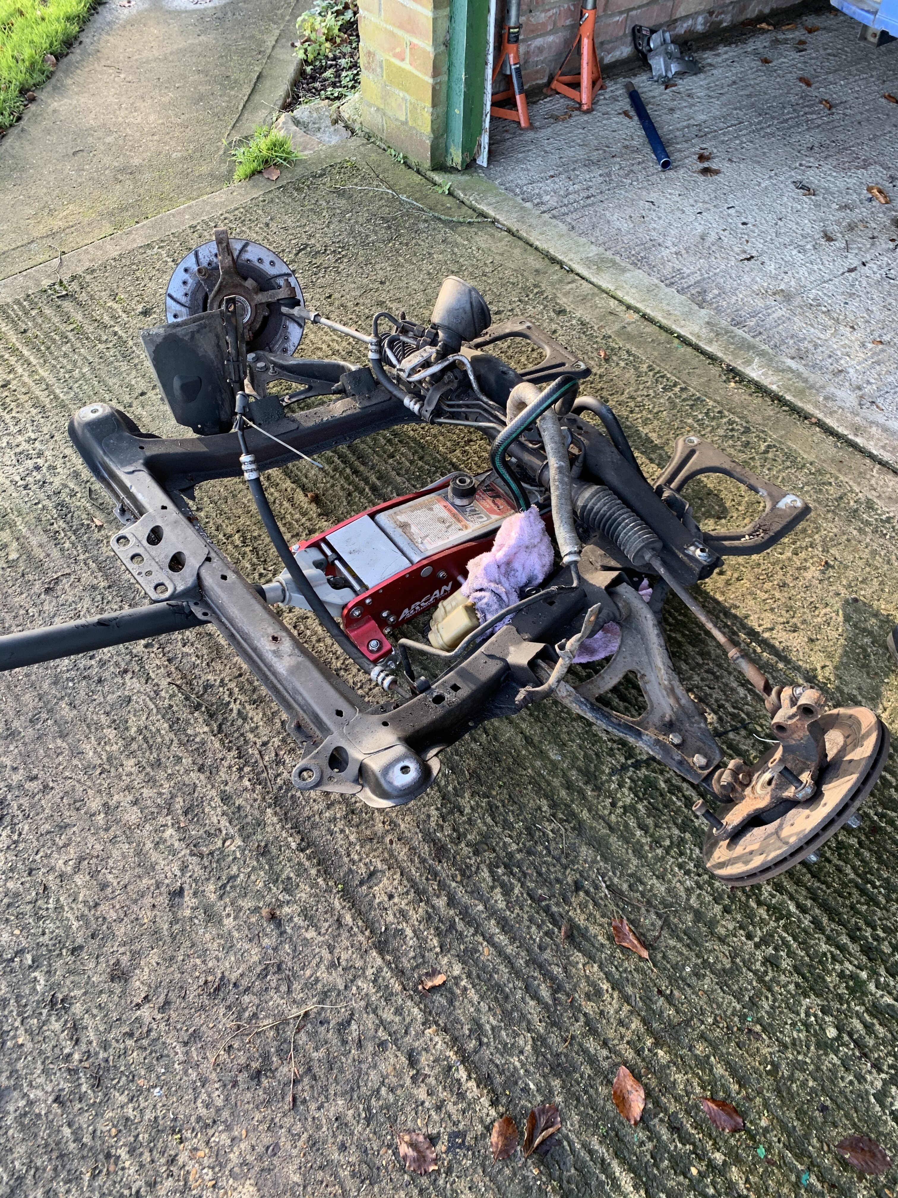

Not much of an update really. Got the engine stripped down checked measured and ready to go back together once I get some bits. It’s largely pretty good, will just get treated to some new big end bearings and leave the rest alone as it’s within spec.
Subframe is now off, all the bushes need replacing as I knew anyway. It just seems everything I seem to take off is either broken or worn out, I think it’s going to take longer than I planned! Just trying to keep motivation and not sell the lot to be honest.
