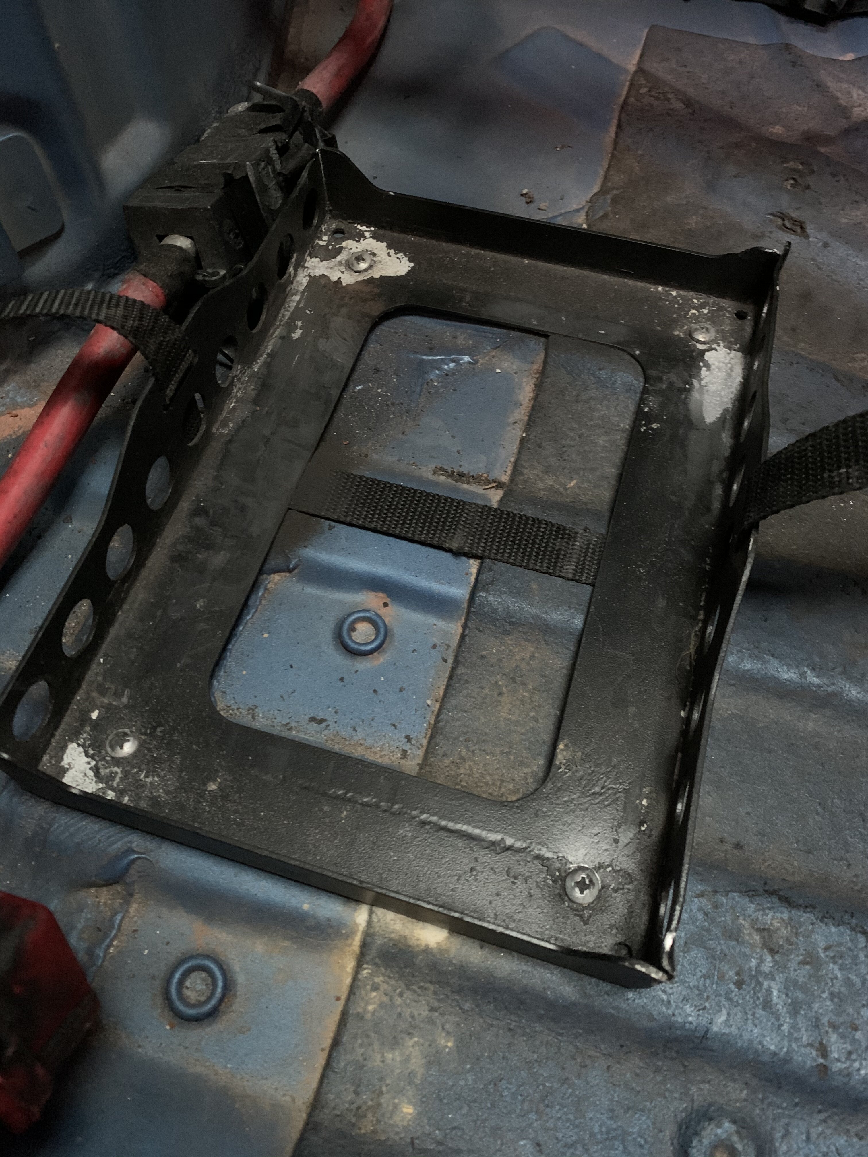

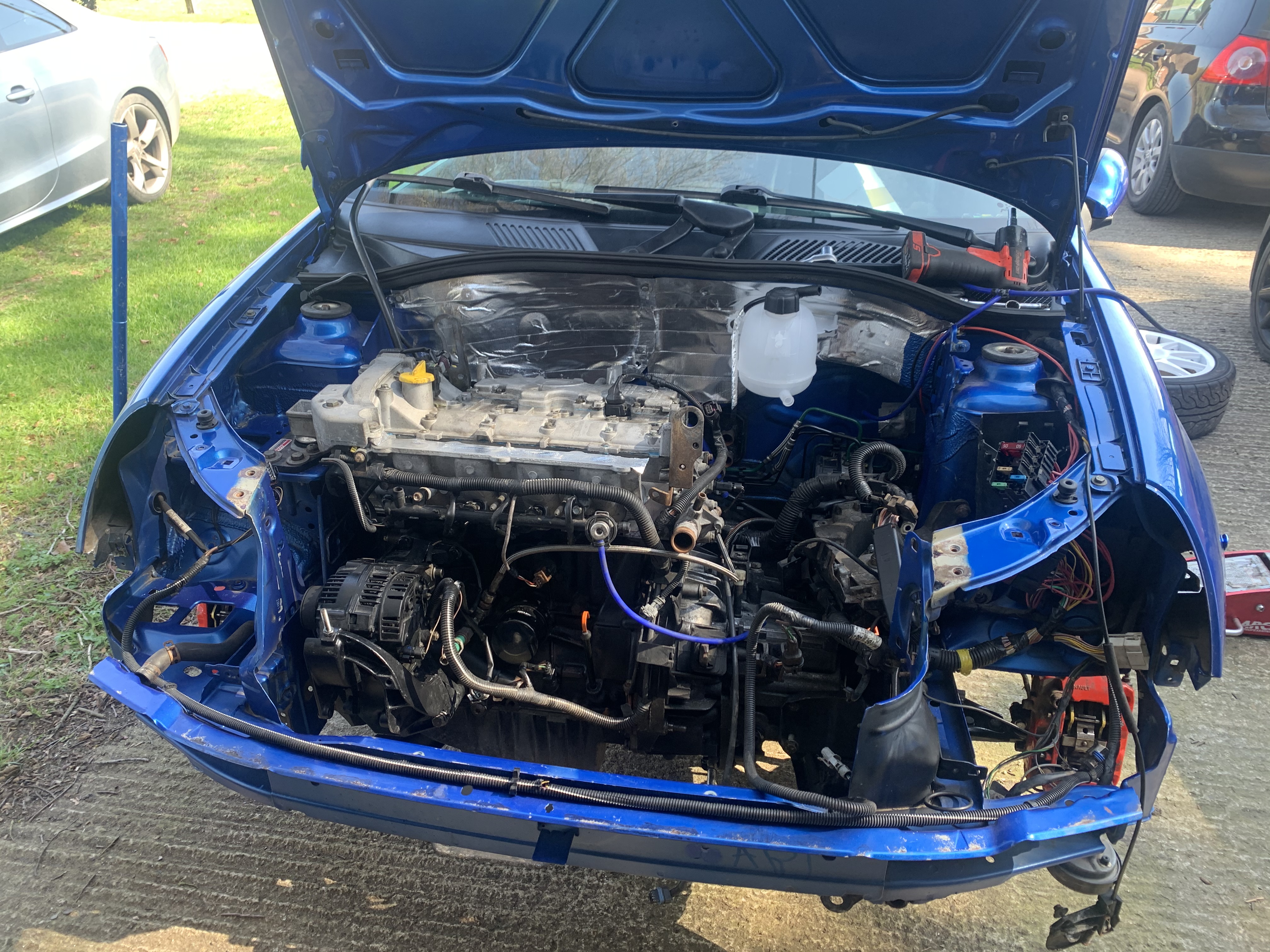

Removed the battery tray from the relocated battery today, glad I did as I had been tempted to keep it but will relocate back into the engine bay.
If you look closely it was held in with 4 self tapper screws 🙄 the car that keeps on giving aye!
As frustrating as this project is being im so glad I’m being able to give it a second lease of life.

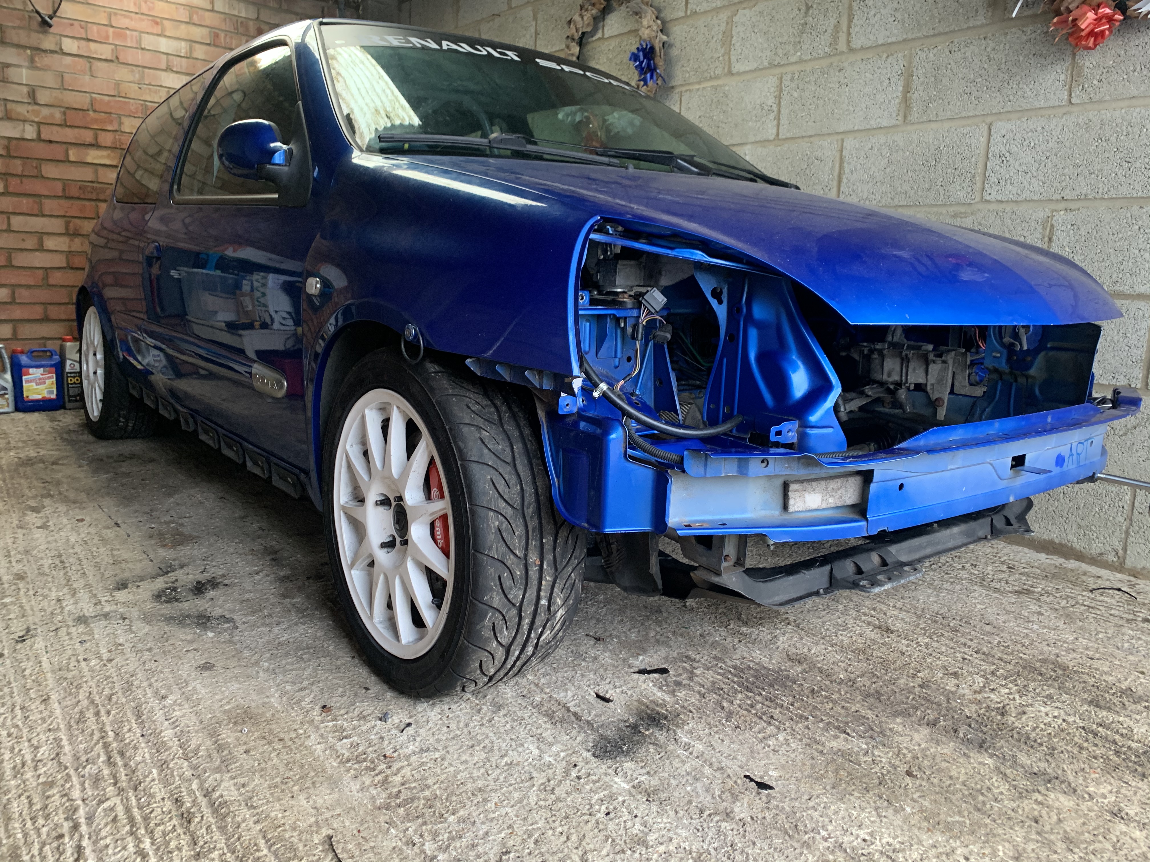

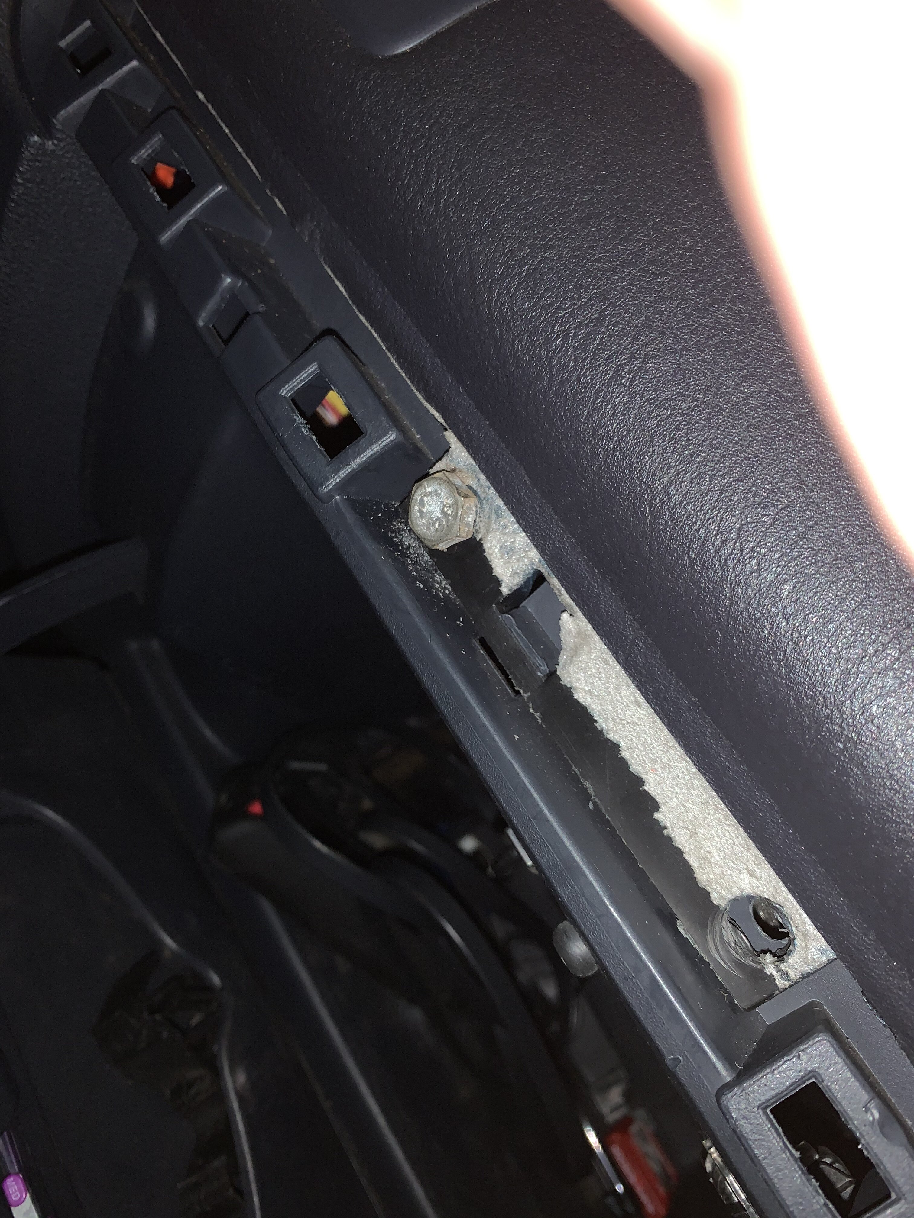

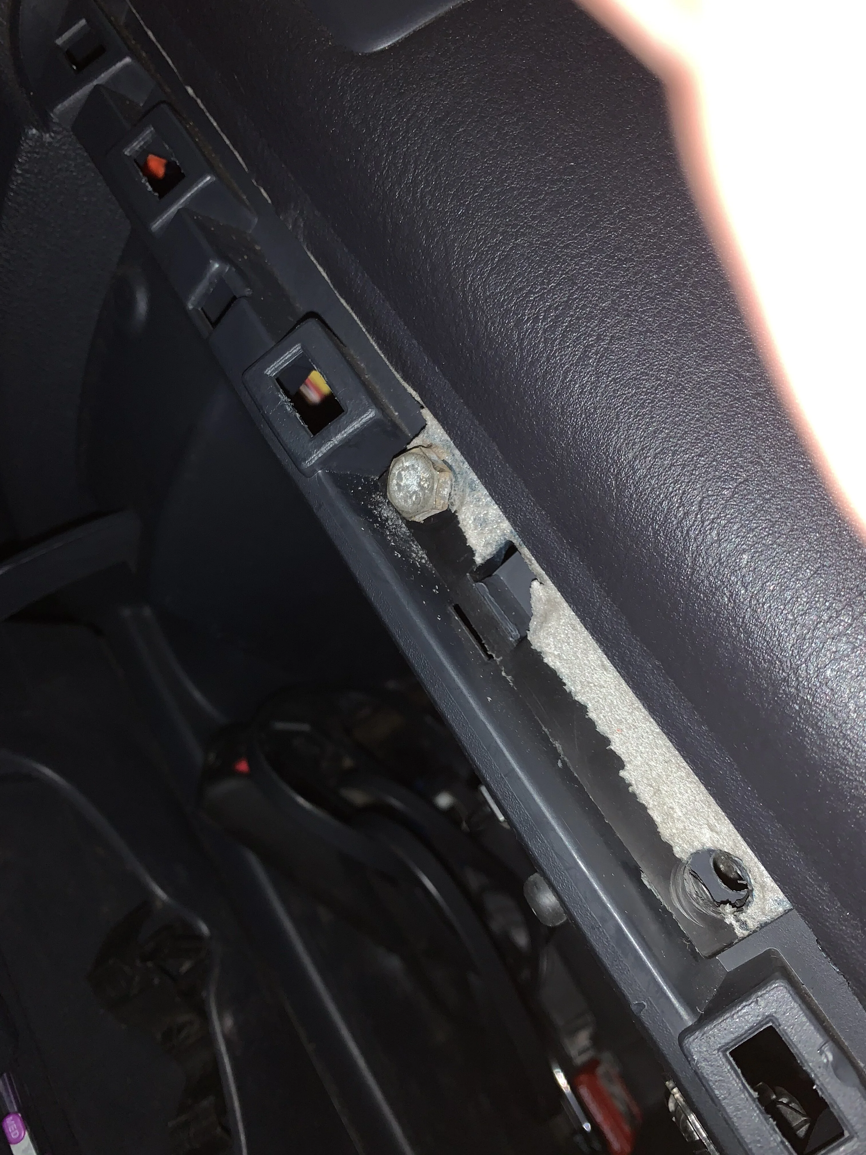

Been out working on the 182 today. But it’s so cold I wasn’t out for long. Can’t wait for 20 degree days and long evenings!! Anyway another day another idiotic bodge from someone, who uses a 13mm headed bolt to keep the top dash in🙄

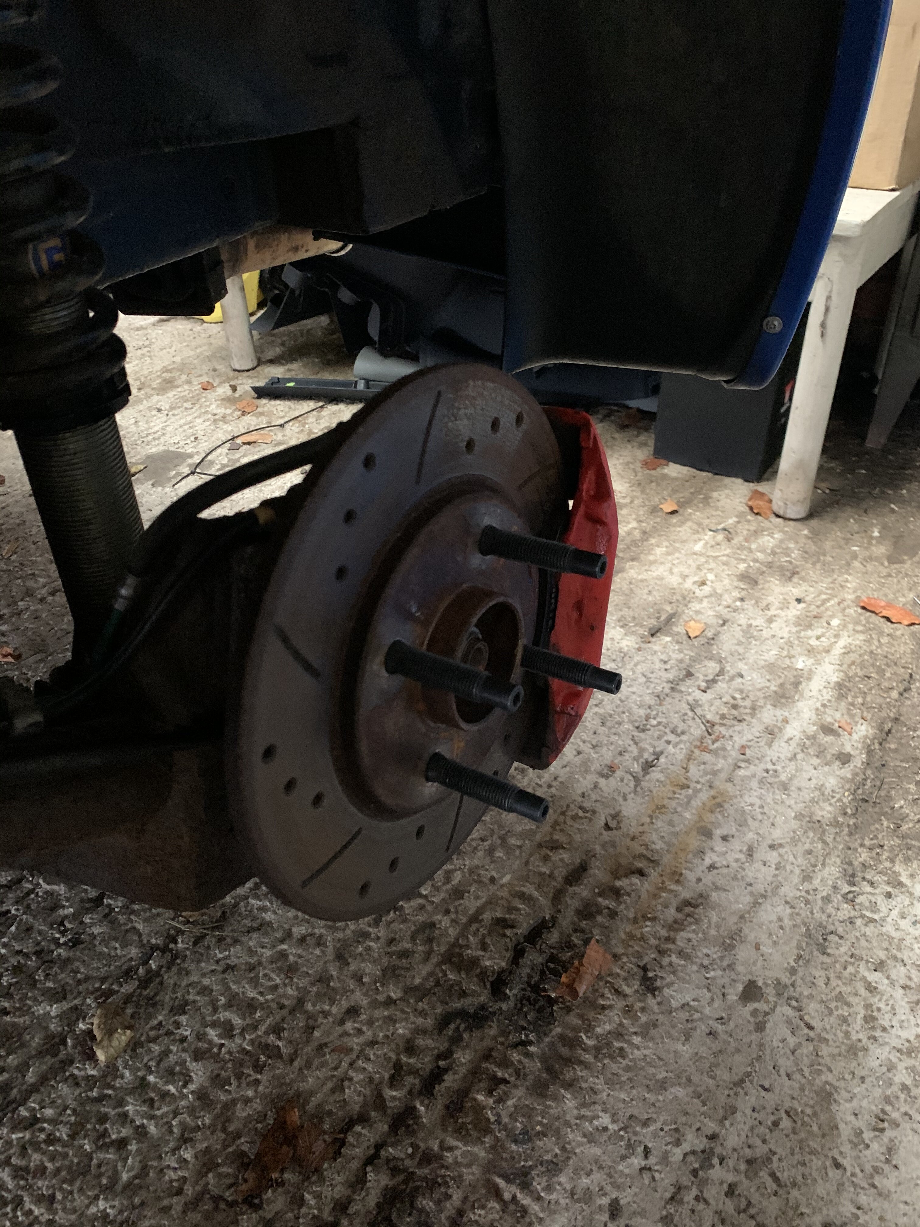

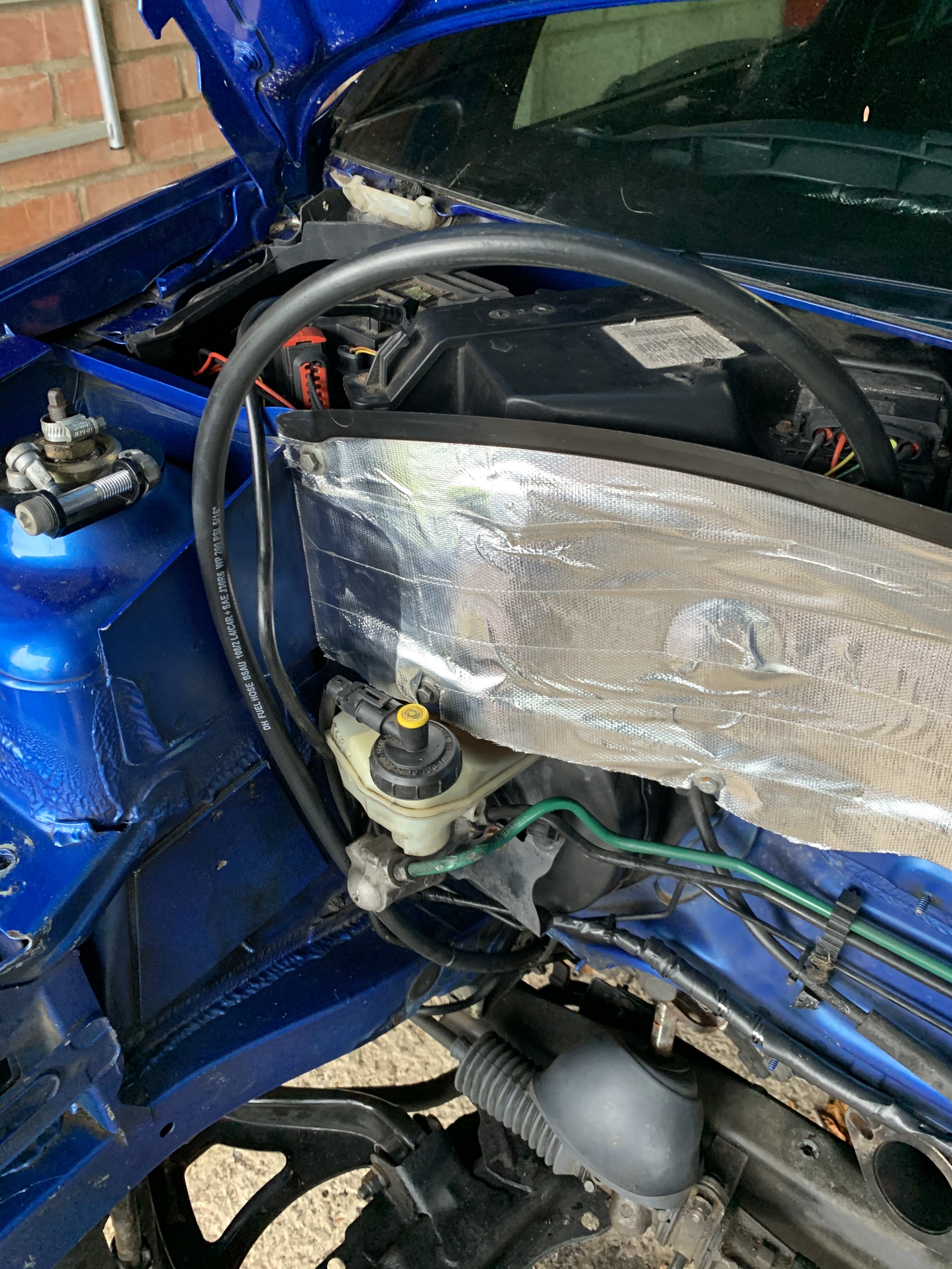

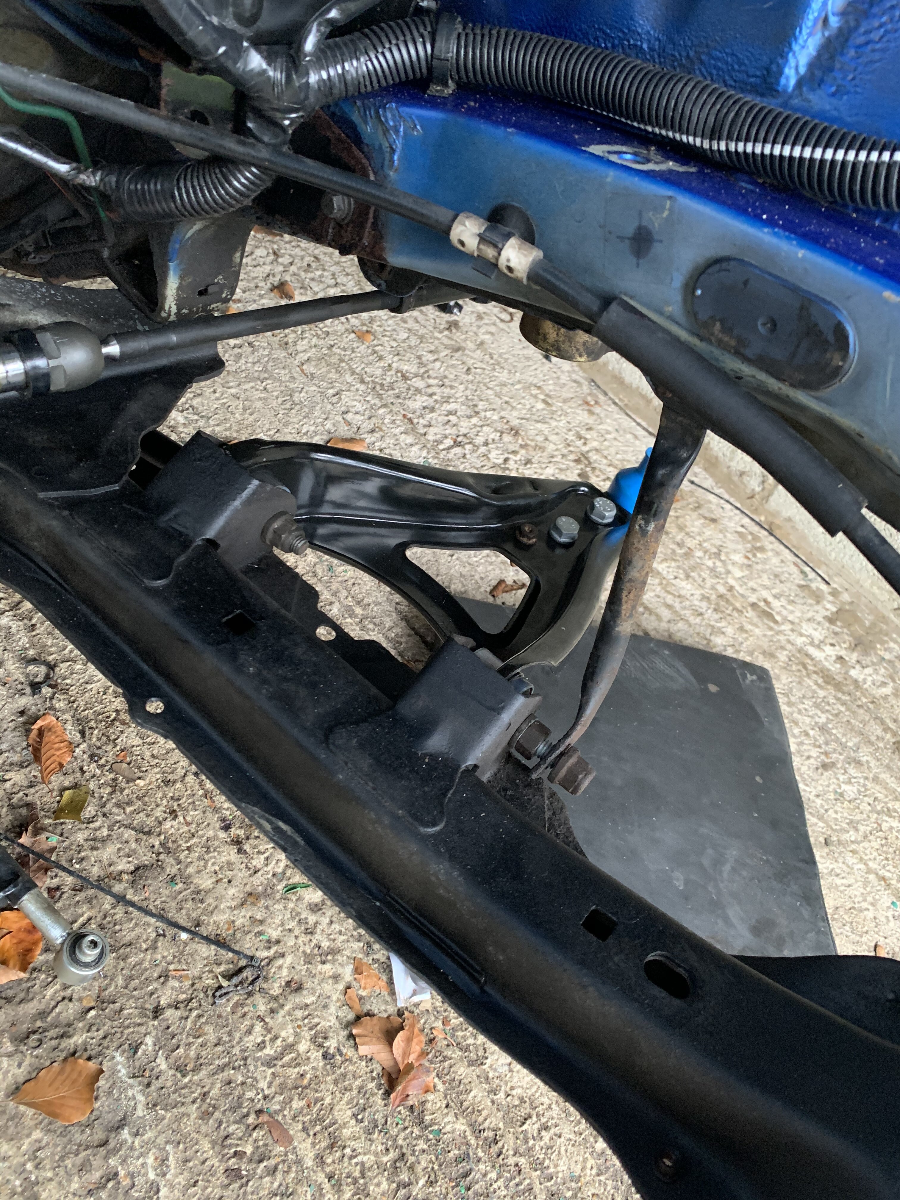

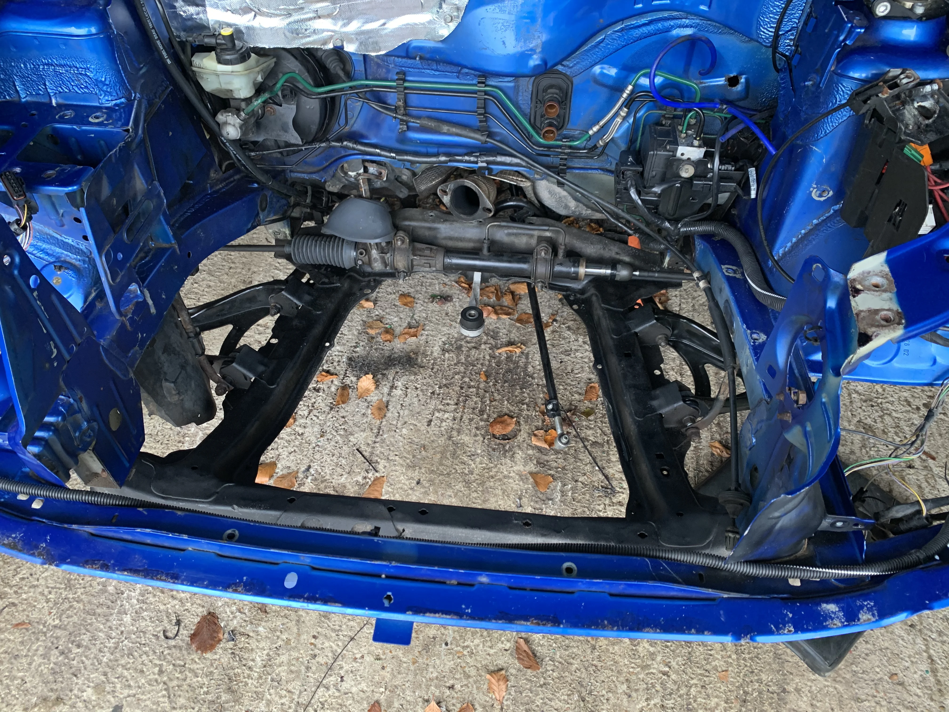

Some progress today! Subframe back on with new lower arm (offside was already new) new arb bushes inside and out. Also replaced the steering arm and track rod ends .
Fitted the rear pms studs, and ran a new fuel return line to the tank as the old one was too short. Aiming to have it rolling this weekend as long as everything arrives. Then I’ll just have to build the engine and throw that in. The end is nearing!

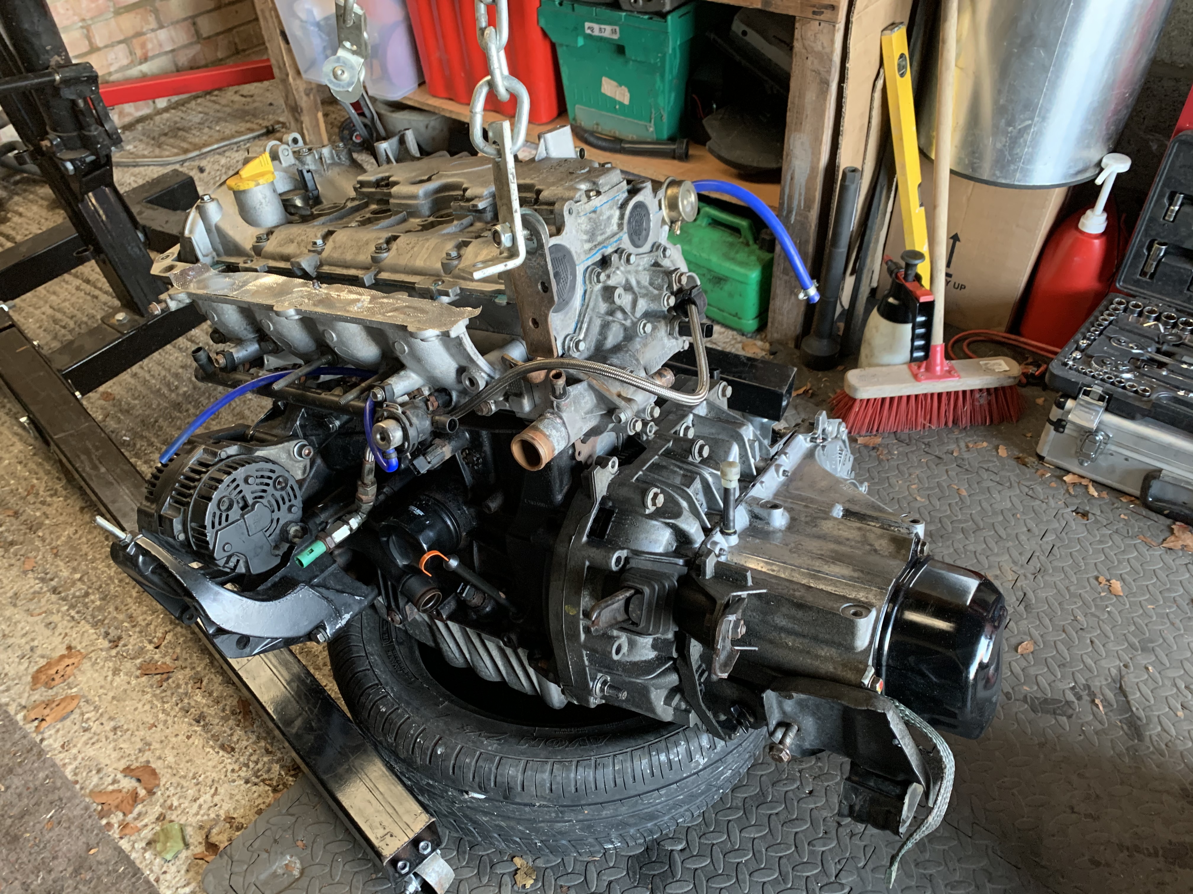

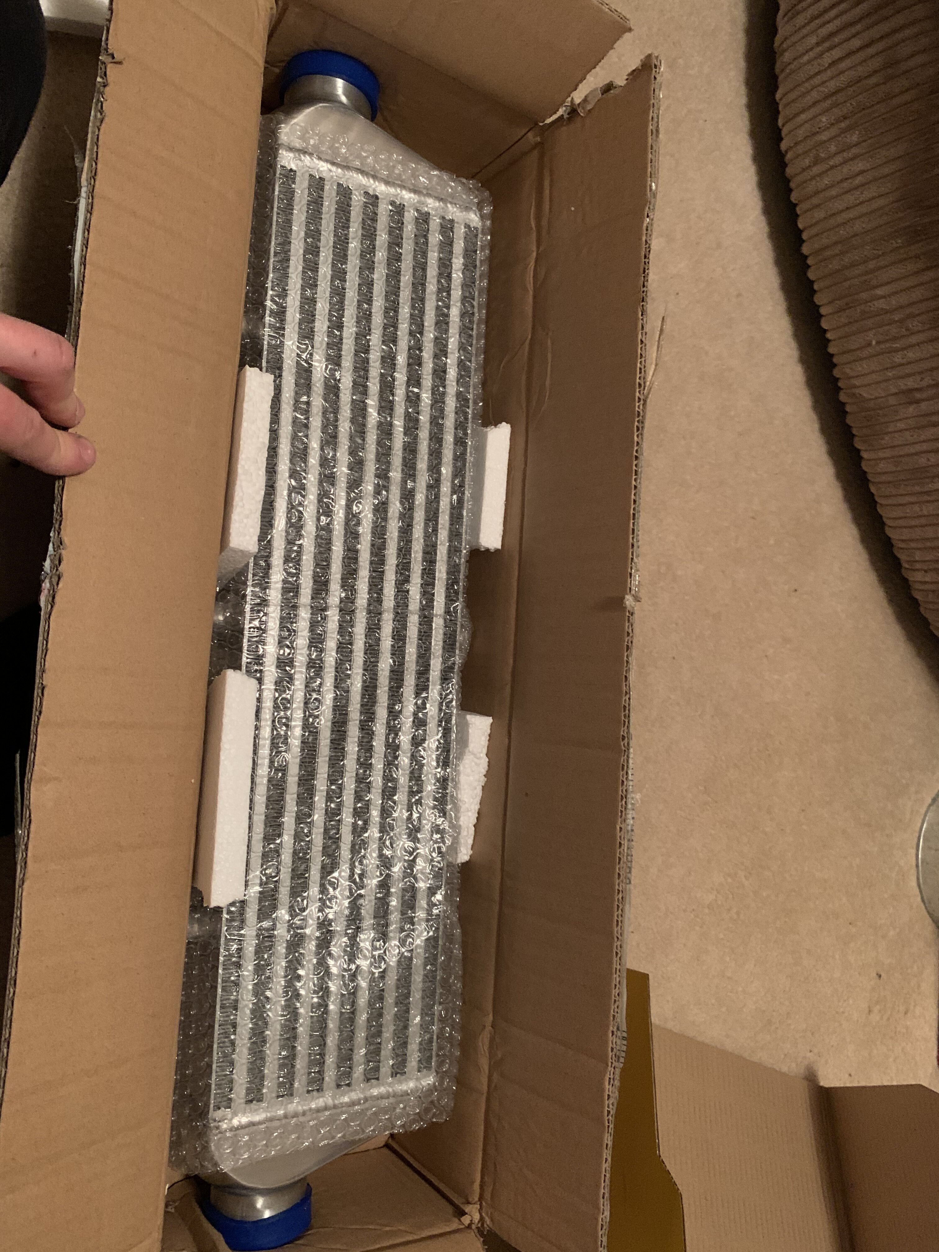

Engine is now built and back in the car, just waiting for a few niggly bits to arrive and then it’ll be plumbed in. Hoping to have it running this week! Ordered a new intercooler and boost hoses from ED and hope to relocate the battery back to the engine bay.

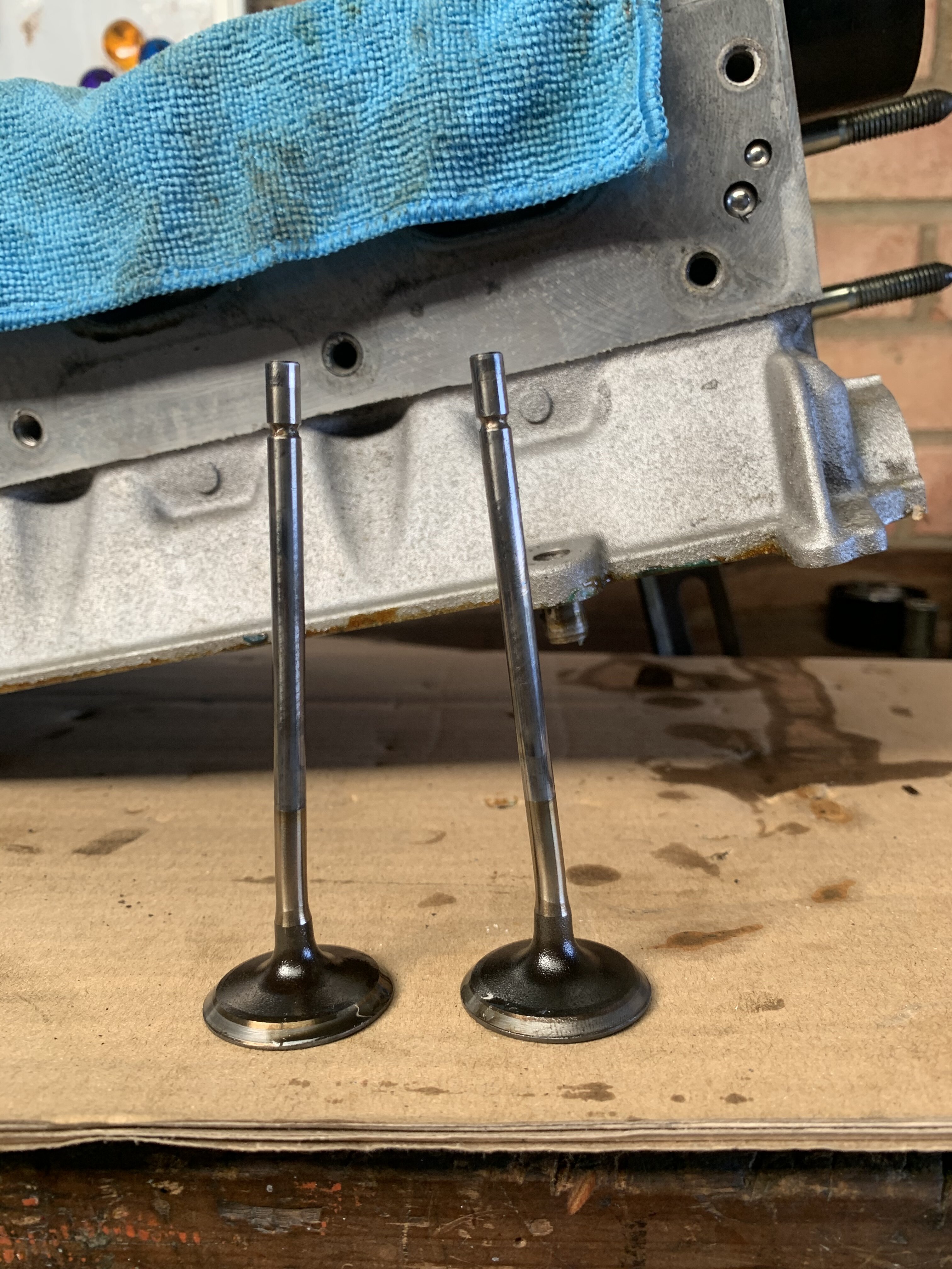

So the head had to come off, as suspected 8 bent inlet valves and after some investigation found the cambelt tensioner had failed. Now to note this tensioner came with a car that I broke and I now suspect that even though it was in a Renault box it was a fake rep off eBay as lots of other parts that car came with were infact eBay special. It is what it is and lesson learnt!
So now a nice rebuilt cylinder later, new lifters, cat cam springs, supertec inlet valves and wossner inconel exhaust valves she’s back together and running better than ever. It’s also important to know I haven’t been bank rolling this project this is my dads car still.

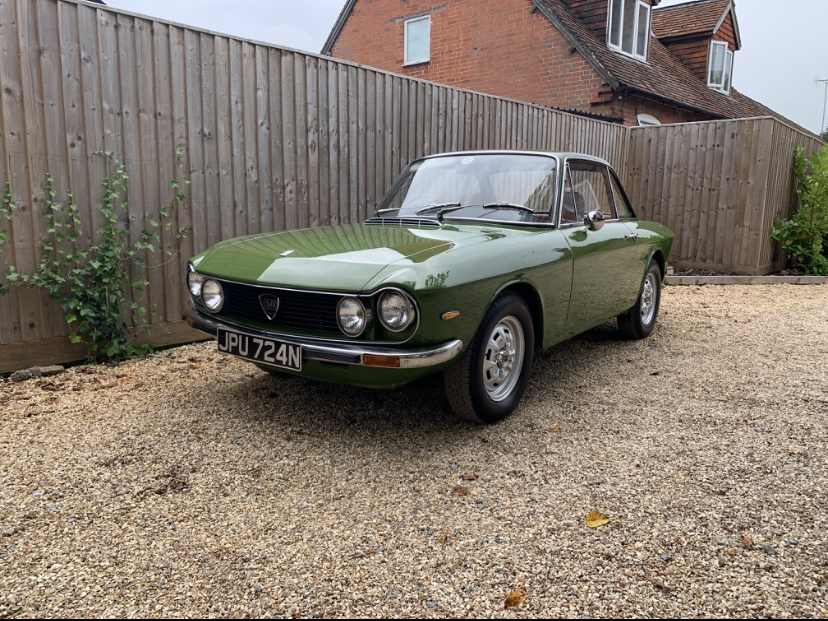

And I hear you ask ‘what’s his dad replaced the Clio with’ and to that I answer a 1975 green over tan Lancia Fulvia, just a little bit different but as he said ‘more suited for a 66 year old’ 🤣
