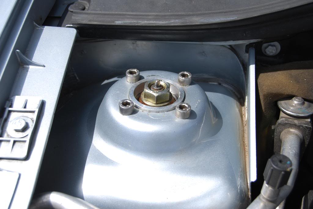

See if this helps
That is very helpful thanks. However I did not get any rubber washers or O Rings :/
All I got with the kit was the lower part of mount, locking ring and a spacer. What is the OEM shock turret??

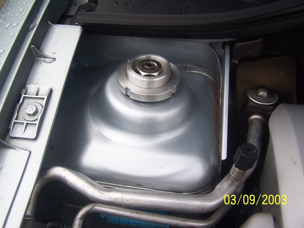

Remove everything from the top original mount apart from the standard spring hat/cap including the original bearing. The new top mount has one in it. the first time I fitted them I left this bearing in place which was wrong, and the creaking noise increased. The metal sleeve/spacer sits on top of the spring cap, followed by the stepped spacer shown Yellow in 172BEN's diagram. Then fit the top mount which should let the stepped spacer sit inside the bottom of it and stick the compression nut on and do it all up.
Place a washer on top of the top mount and place it back in the suspension turret and centralise it, place the 'o'ring around the strut and press it in around the turret so you have no metal on metal contact. then wind the big lock ring on. best to mark it with a bit of paint and check it reguarly for it working itself loose.

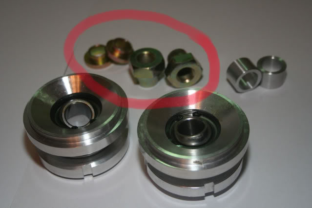

The middle photo above is what the bottom half of my compbrake looks like. The 1st pic is the sleeve/spacer. What i dont understand is how the spacer will sit underneath and provide a stable connecting surface, just leaving that bottom half alone without fitting anything to it would be more stable, its a concave shape too where as the spring top platform is flat. Is that exactly what yours looks like?
it sounds like your missing the parts ive circled in this pic.
Am I correct? if so I'll get them mailed straight out to you
-Jon
Sam, see the 2 stepped spacers on the left of the pic that KAM has circled, you put them under the topmount so it slides and sits into the spherical bearing, place the spacer from your 1st pic under it so it spaces the topmount off from the spring hat. Then you can wind on the big nuts in the right of KAM's circled pic. fit a rubber washer and get your suspension strut back in the car.

Hi Dave thanks for your help, its starting to make sense!
So those silver spacer things literally sit smack bang under the stepped spacer on top of the strut platform? Thats alot of pressure on such a small spacer lol

Thats what I thought when I first looked at them, so didn't fit them. What a mistake, it creaked and knocked like the wheels were about to fall off. Gave compbrake a call and they put me right. Fitted the spacers on top of the spring hat and never looked back, handles lovely with them on.
