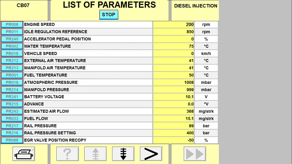

Some of you may know I bought a van which had petrol run through it.
Ran it for 1 minute on the day I sorted it. Was a little tough to start but I figured that would be the air in the lines. Yesterday I went to start it and it was really difficult. Took 5 attempts before it went into life.

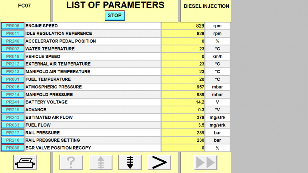

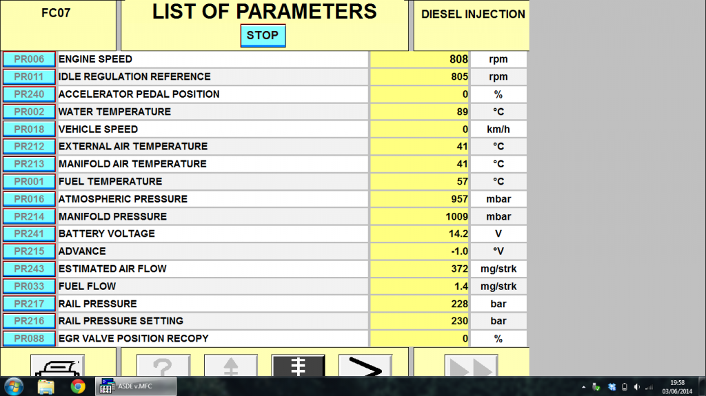

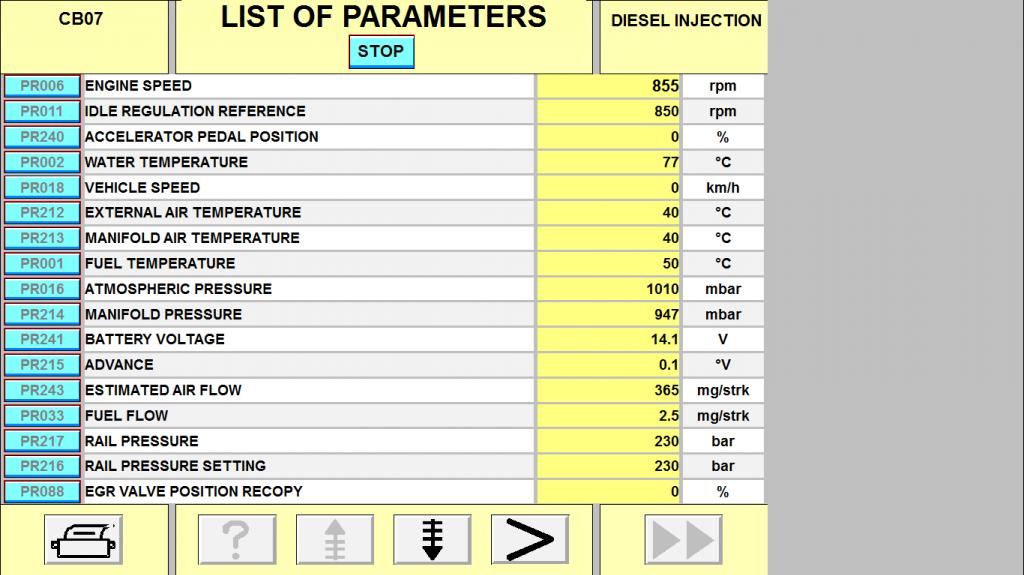

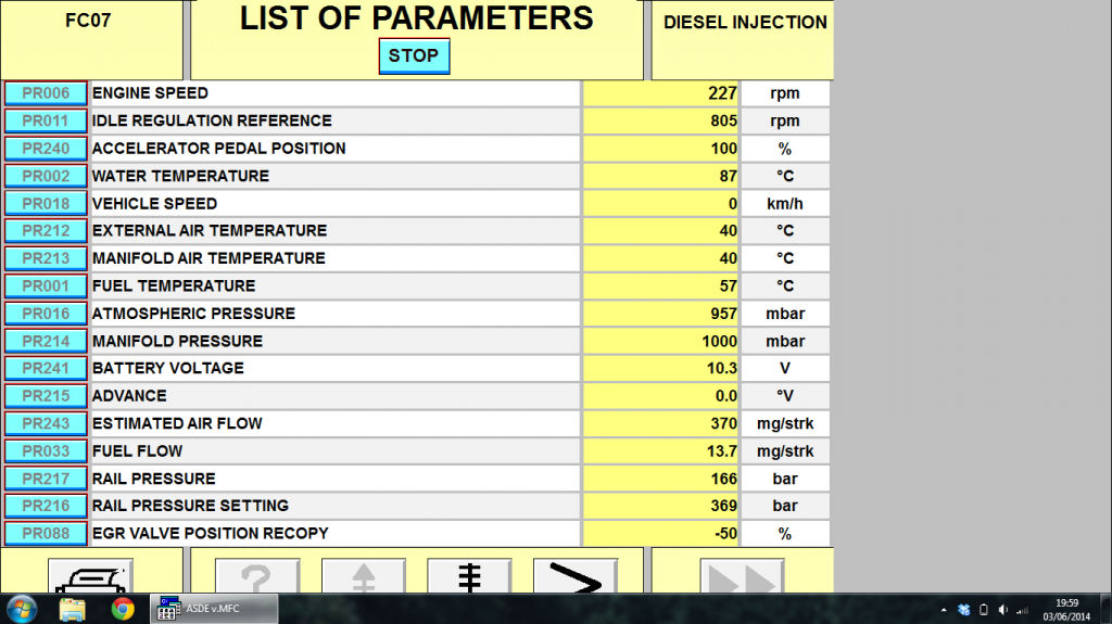

Took some clip screen shots at various points and took 1 or 2 of my clio.
Kangoo seems to get to about 160 bar when it's not starting.
Clio hits about 300 or so and springs into life.
Just looking for confirmation that this fuel pump is also FUBAR.
Trying to start Kangoo
Kangoo running
Another of it running
Clio Running
  clio dci , ren8
So for starters did you fit new injectors or a second hand set ? if even one of your injectors is leaking back to much fuel you will lose pump pressure as it cant make enough to keep up on cranking , & would explain your ruff running .

If its not making what its asking for (setting) then it has an issue. A good pump will hit 350/400 on cranking.
I assume it cranks just as fast as your clio, as I've had that where a starter motor was weak, so it wasn't spinning the pump fast enough to make the pressure required, it would fire up on brake cleaner everytime.

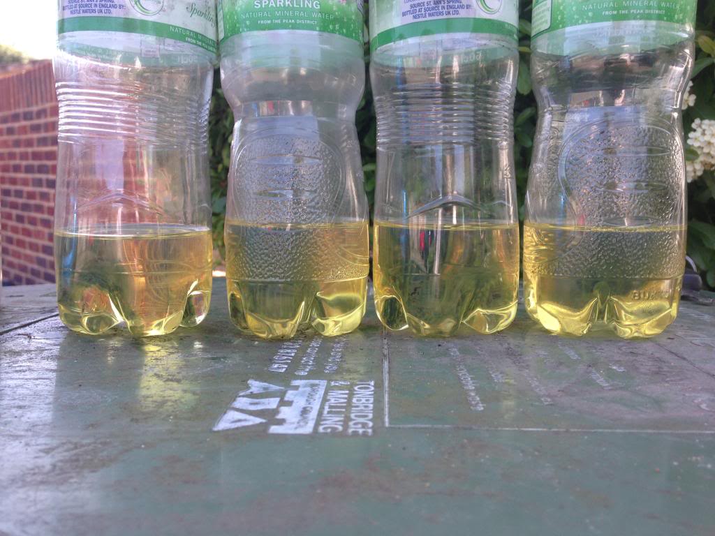

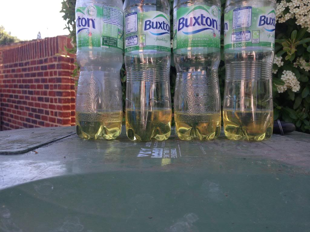

Did the leak off test today like this
Ran it for 4 minutes with it just above 1k
From right to left
injector 1....... 106
injector 2....... 108
injector 3....... 117
injector 4....... 97
Dr HMS Derv Destroyer
  MK1DTi/vivaro/corsa
They're f**ked LOL! You should have hardly f**k all
hold on 4mins? I'll have to check but I'm sure delphi official test times is only 1mins
GrahamS
  335d
@HMS Derv Destroyer
Pretty sure I did it right. Blocked off the feed back to the pump so no air was taken in. Just ran the car with the pipe on the return nozzle.
Engine was cold. Does that make a difference?
Had a google and can't find the correct method or specs so that would be ever so handy. Starting to loose it with this van now!
I did a quick go on the clio as well for 4 minutes but the car had just been used so was baking hot.
got 50, 23, 25 and 30
  MK1DTi/vivaro/corsa
Little to no feed back is new or good condition injectors.
Yours in the Clio are fine , don't faff with something that works still ;)
Leak offs done on cold engine will give better readings , warm engines will help the injectors.
Im sure it's idle or 1k rpm and for short time.
Have you tried leaving It upto temp on idle with everything connected back as should?
Still struggles to start ? From cold?

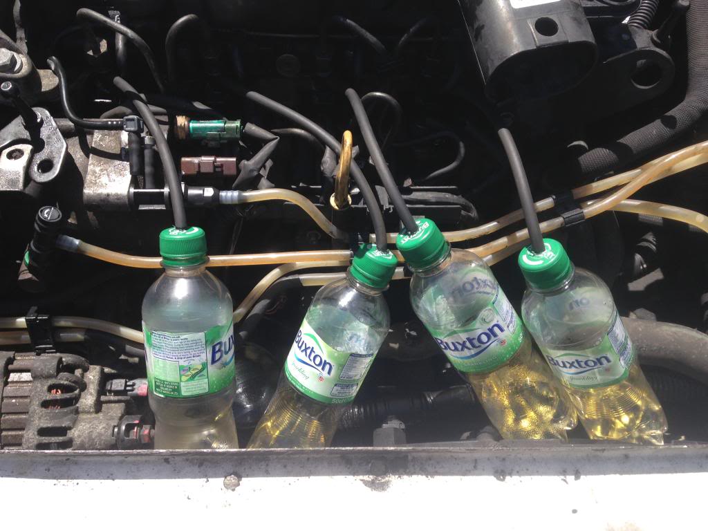

I've done a leak off test on the kangoo (struggles to start, starts with brake cleaner and runs lumpy when started) and the clio (runs fine). Done both on completely cold engines for 2 minutes and then measured.
Kangoo
Injector 1 - 41 ml
Injector 2 - 44 ml
Injector 3 - 39 ml
Injector 4 - 35 ml
Clio
Injector 1 - 15 ml
Injector 2 - 10 ml
Injector 3 - 10 ml
Injector 4 - 29 ml
If there are any home brew tests I can do let me know and I'll get them done pronto.

As said before you secondhand injectors were a waste of money & are dumping to much pressure back .
  Renault Clio182 bean
Just based on reading what you have found, I am 99.9% sure its your injectors.
I see this all to often on the Volvo Diesel injectors especially, they leak off way to much fuel causing difficult starting,
the more fuel the injectors leak off the harder the car is to start due to fuel/rail pressure.
And regarding the pump readings on clip, you cant rely on the pressure readings if the injectors are leaking too much fuel,
it will mislead you as the pressure drop is due to the injectors.
I bet after you get it to start it idles fairly lumpy especially for the first minute or so aswell doesn't it.
