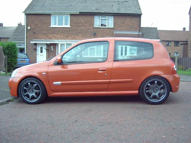

Or you could just get some of these babys:D
