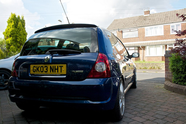

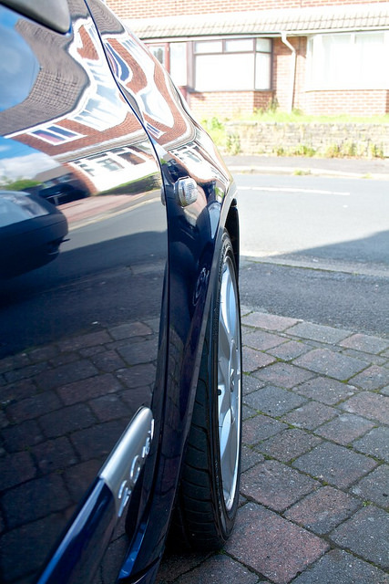

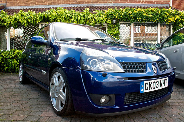

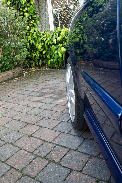

Your wheels are a different offset to mine I think but this is my 172 on cooksports. 25mm spacers on the front and 15mm on the rear.
Only rubbing I had was the inner arch. If you look in my project thread I've removed part of it, took all of 5 minutes with a stanley knife.
