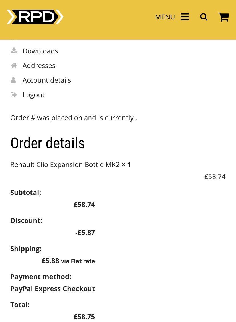

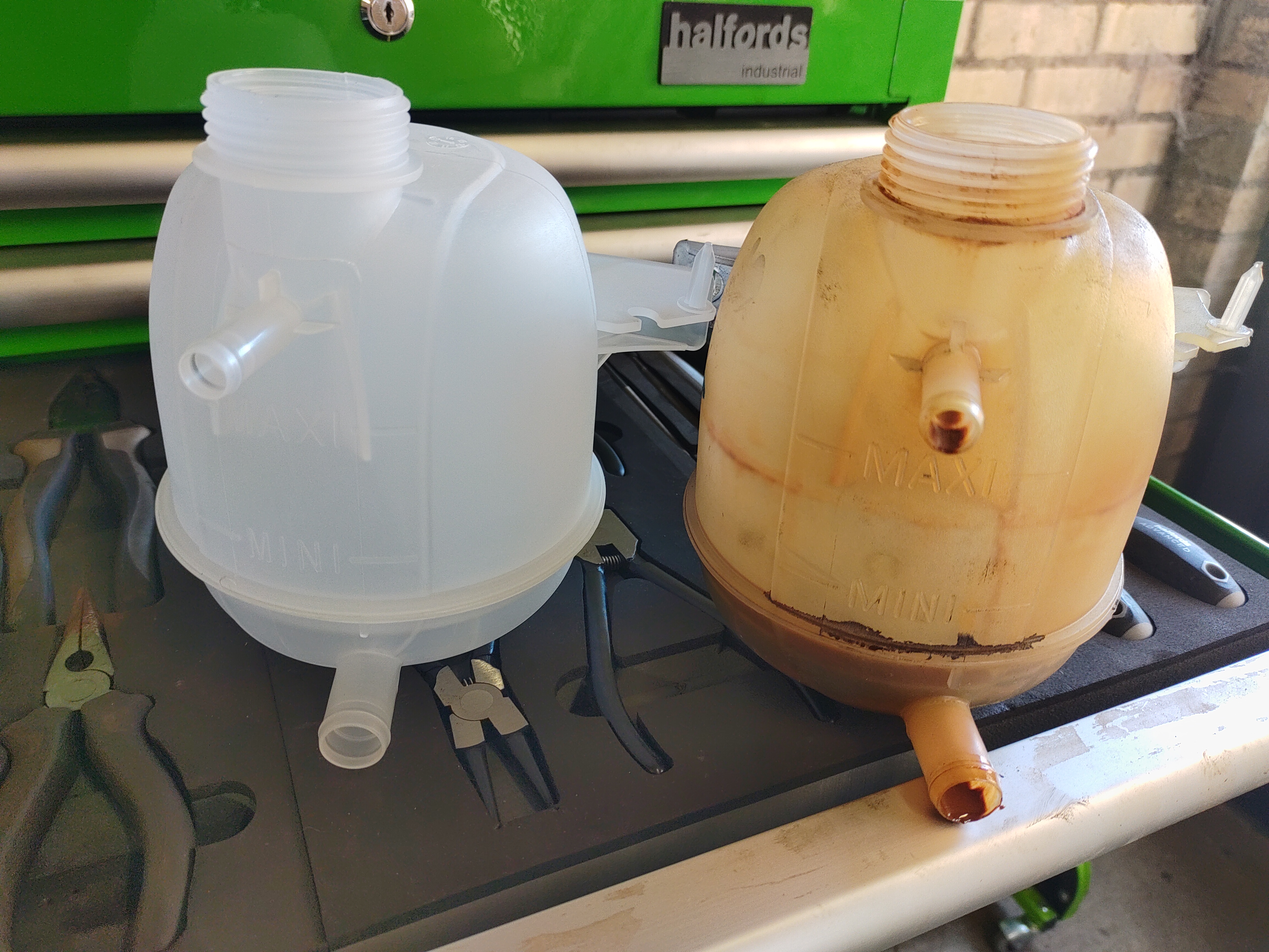

I bought this "Genuine" one from Renault and it has no Renault markings. In fact, it looks identical to the cheap one I bought off eBay for my BG a few months before.
https://renaultpartsdirect.co.uk/parts/cooling-heating-parts/renault-clio-expansion-bottle-mk2/
Part number is 7701470460
The original part number for my 182 is 7700805031 but that's NLA.
So it looks like Renault is now supplying a cheap alternative. I wish I'd saved my money and bought an eBay one now.

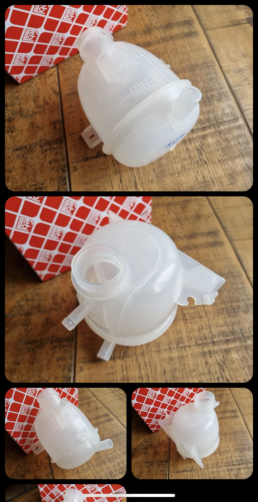

That's my Febi tank listed on eBay and works well on my sprint car, the problem I found with the cheaper versions is the top pipe collapses and distorts out of shape......you probably wouldn't notice until you remove the top hose or it starts to leak.

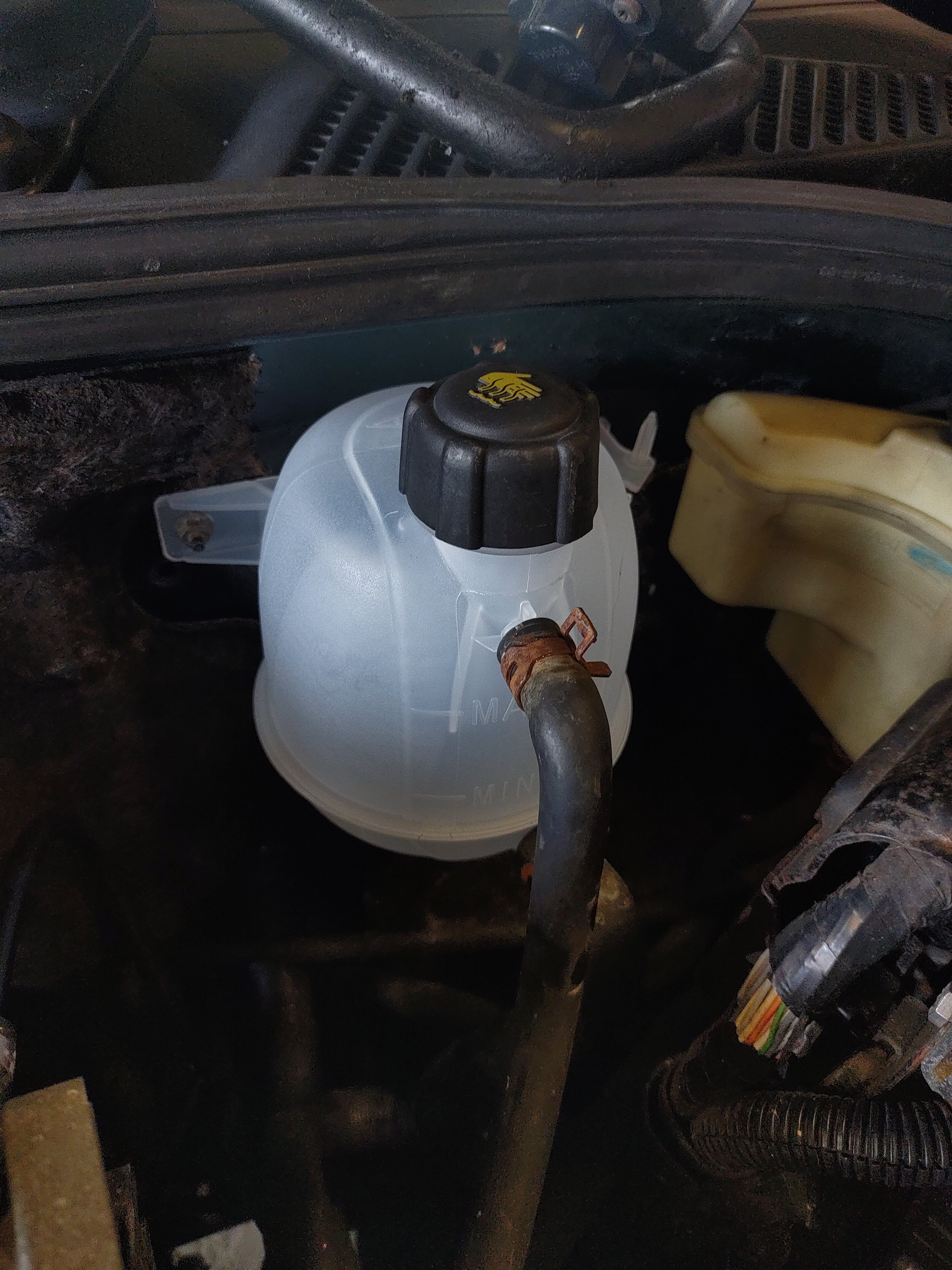

Does the original cap screw on ok with the after market bottles? I bought an aftermarket one a few years ago and the thread isn't the same as the original bottle, you can screw the cap on but it's hard to get it on without cross threading.

Yeah goes on fine. I think on the first time it feels like it isn't correctly screwed on, but every removal afterwards is fine.

On the one I ordered from Renault, my old original cap wouldn’t fit.

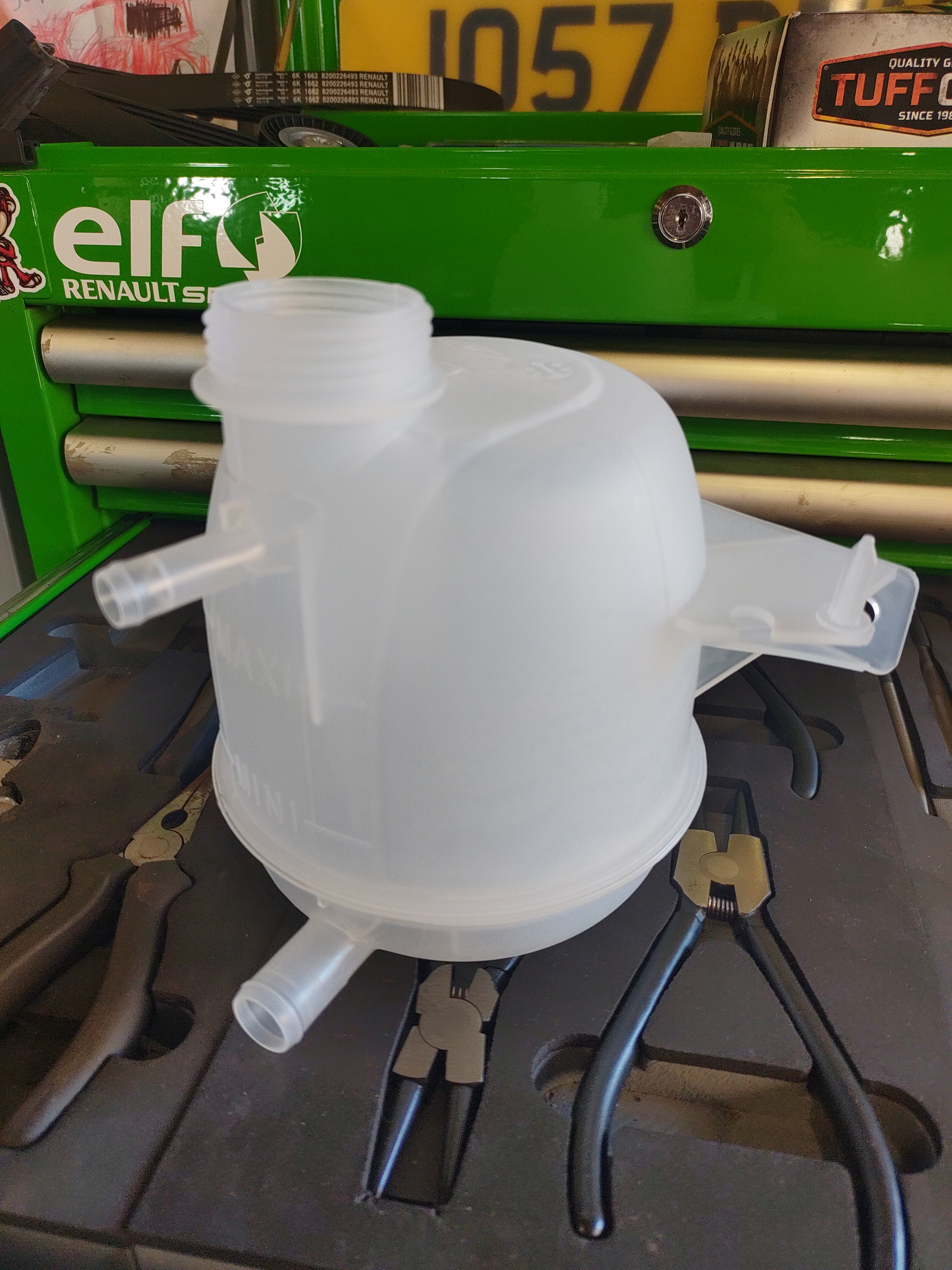

I got mine from BTT Motorsport for £16.95 but I don't think they do them anymore.
It looks exactly the same as this one and has been on the car for over a year with no issues.
