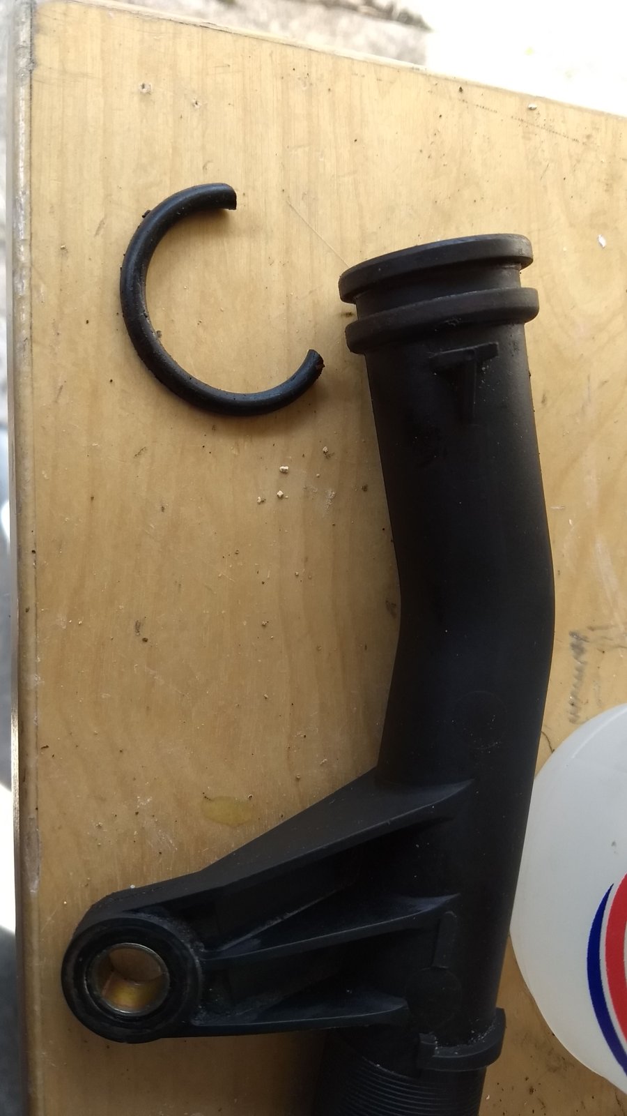

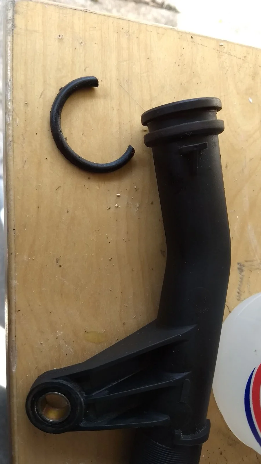

Hi All,
my project clio was experiencing a very small coolant leak at the front of the car(side of the engine). I've torn the car apart and found the reason for the leak, picture below. the o-ring on the coolant pipe hose flange had split, as you can see in the picture. clio dealers want £6 for the o-ring which i'm not willing to spend. can anyone confirm the size? i think it's 4.5mm * 23mm but if someone could confirm this that would be great. cheers.
Hi All,
I found the size for anyone interested is 28mm inner diameter and 4mm thickness. renault dealership wanted £5.60 for this o-ring which i've found elsewhere for much less.
part no. 7703065311
