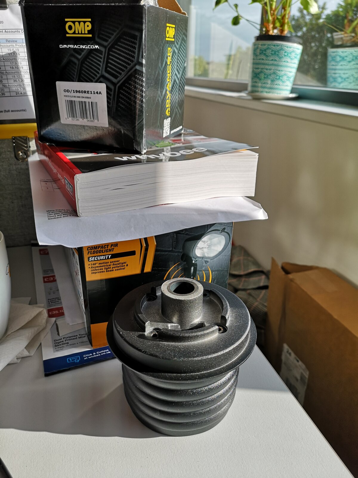

Hi, I ordered a 182 boss and it came and would not fit the car. I searched on here and found a reference to a tab being needed on some on not on others? Does anyone have a part number or can explain further?

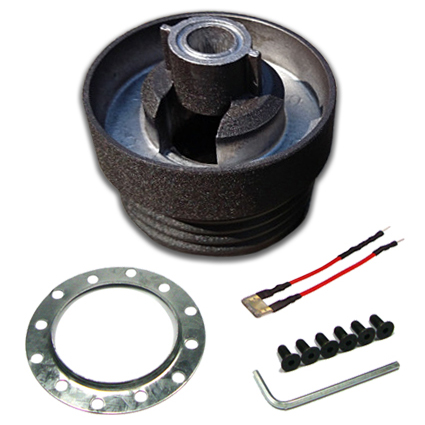

The OMP one I had which looks like the one JB21 has linked to above caused steering angle sensor errors in my 172 (non cup). I changed it for a momo one like the one shown by loggyboy above, you need the tabs on the side to turn the steering angle sensor with the wheel, and no problems

Mine knocked the traction control and ASR off as well but I think that was down to the position of the steering angle squib. I left it as I turned TC off every time I got in the car anyway.
JamesBryan
  Titanium 182
It'll bring the esp light up too because the steering angle sensor won't be moving inline with the wheel.

Will return this OMP one to YB racing.
Ordered the MOMO one from KAM Racing.
