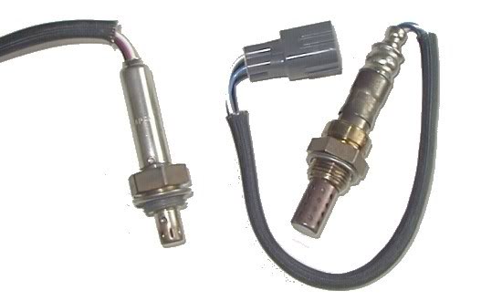

  172 A Cupwork Orange™
engine parts? the lambda sensor is in the cat and is screwed in and there is 1 connector on that basicly plugs in good old renault 2hours to remove and fit a new one hahah
http://i190.photobucket.com/albums/z178/tr332k/jlambda2.jpg
  Clio MK 4
So i wont have to remove my BMC kit with the CAF as i had such trouble fitting it i dont fancy removing it and refitting?
wouldn't have thought so tbh just renault talking out of there bottoms as per by the sounds of it mate, above is a general idea of what your lambada sensor looks like, look under ur car at your cat and will see it :) as said above buy a GSF for 65 quid and fit it your self ten min job,
