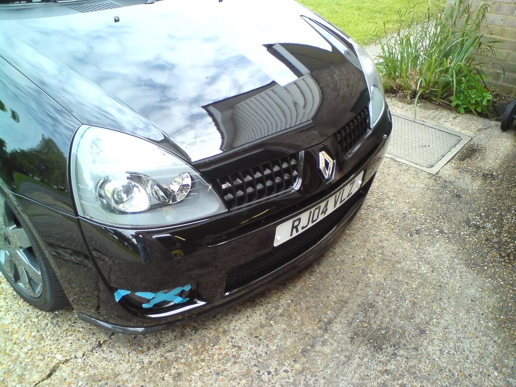

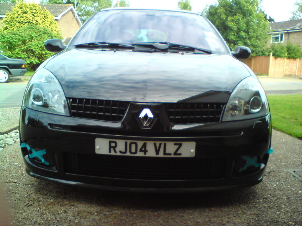

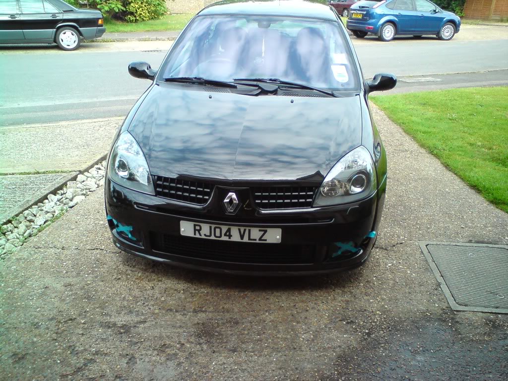

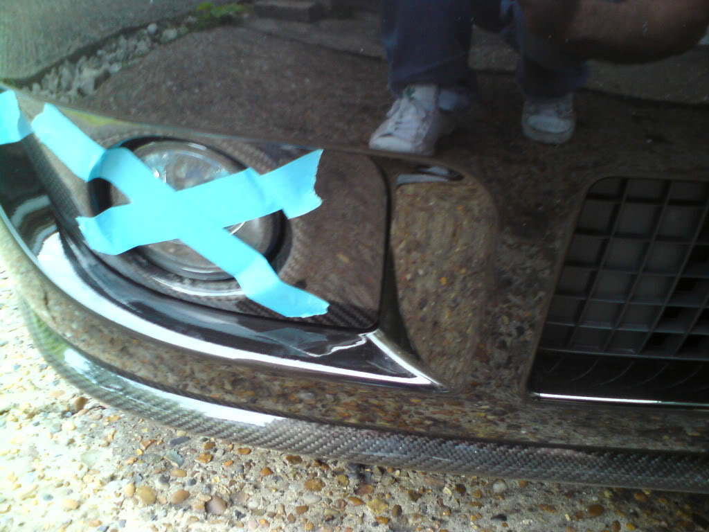

Not really anything to write home about, but fitted some new carbon foglight surrounds and painted my grille black gold as I didnt think the standard bluey colour really looked good against the black.
Excuse the tape, the adhesive was still drying!
Opinions welcome (even the negative ones!) :approve:
Nah! way too much effort to paint the lower grille too! I just removed the grille from the bumper, washed it with fairy liquid, fully dried it with the aid of a heat gun :), then wiped down with IPA (alcohol degreaser), blew all the dust off with a hair dryer, masked up the area that sits under the bonnet. Then gave it a light puff with some primer (didnt completely cover it), then waited 2 mins, then carefully went over with black gold in light coats, waited 20 mins with it sat next to a heater, then put the laquer on in light coats then with a heavy coat as its too complicated to flat and polish to get a shine on it. Let it harden over night before driving though or it will easily be chipped off.
