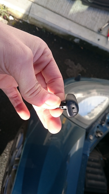

MOT time at the end of the month so I thought best to tackle the issue of the faulty washer pump as I've been without washer jets for a few months. Not ideal over winter haha.
What a ballache this was! Removing the wipers was surprisingly easy, however I didn't realise you have to remove the wiper motor to get to the Washer tank and also remove that to fit the sodding things. Ended up replacing both motors whilst I was there, at £10 a pop you can't really argue. Also replaced the washer jets themselves with some OEM Citroen items, gives a nice even spray over the windscreen now instead of a piss poor jet.
DSC_0022 by couzens1989, on Flickr

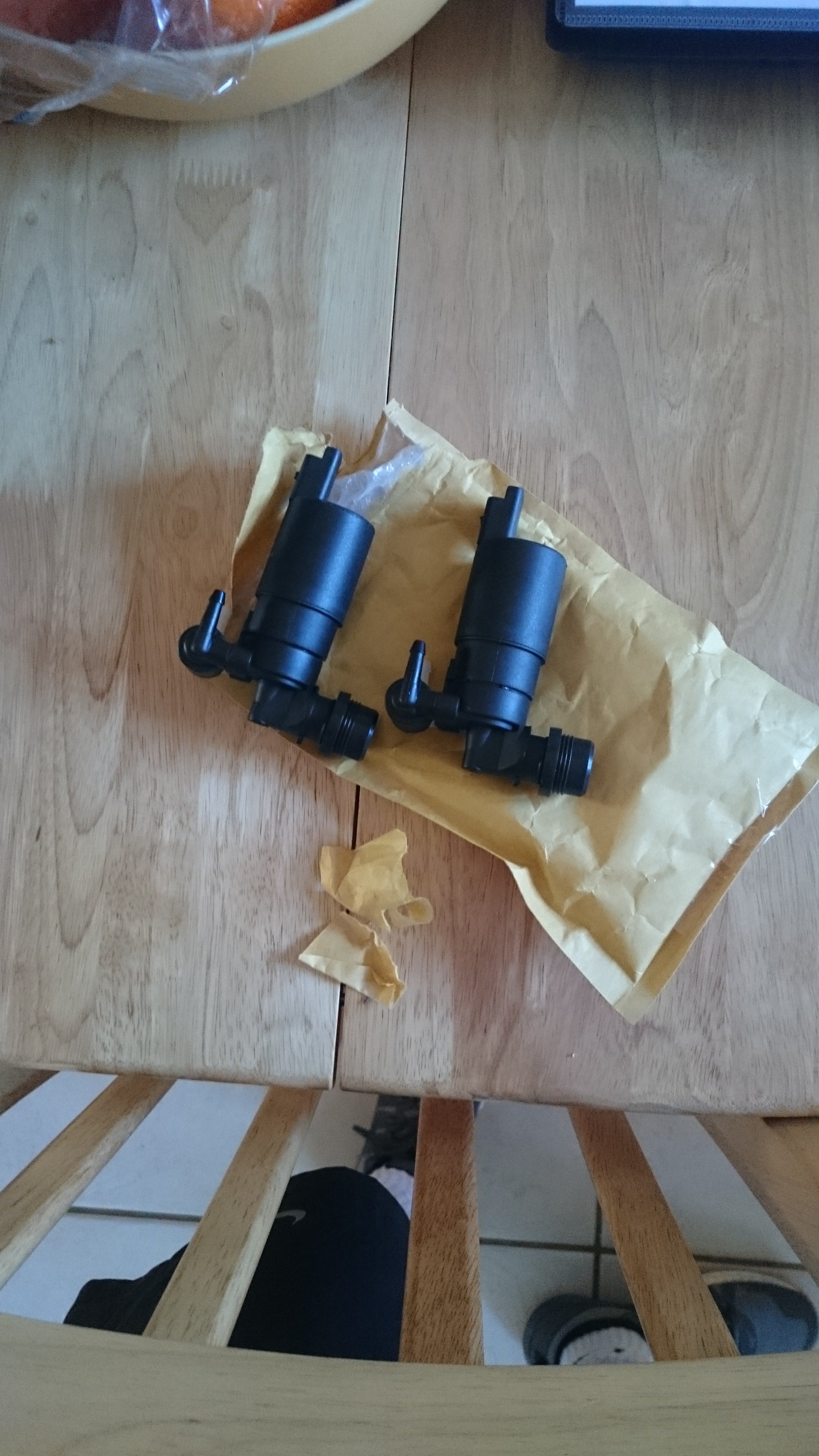

I think the motors on mine are packing up, it's a really weak spluttering spray.
I've got the Citroen jets to fit too. Where were the motors from mate?
EBay mate, make sure you buy the correct motors though! I bought the wrong type to start with. These are the ones you need....
