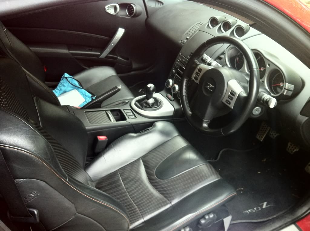

Bit of a small update on what I've been up to since having it. First of all an interior pic to keep Steven sweet

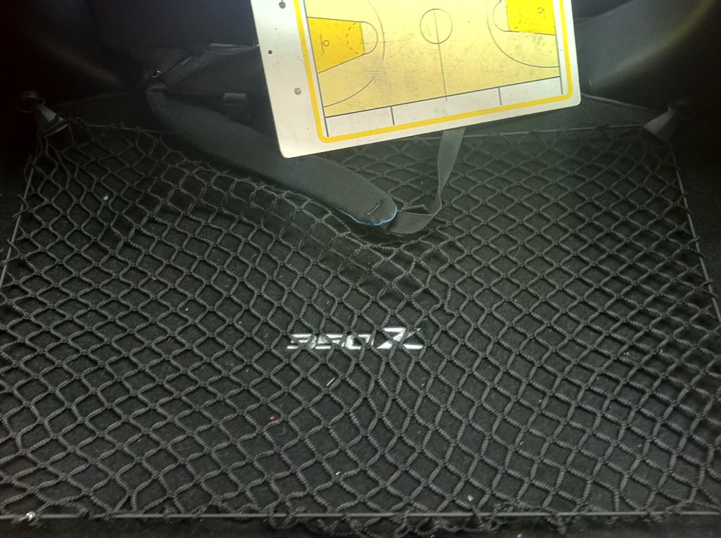

The standard boot mat is as flimsy as tescos own brand bog roll so a new boot mat from Nissan was on order, fitted, thick and much much nicer. I moved the boot net from the clio across as I found it so handy to stop things sliding about

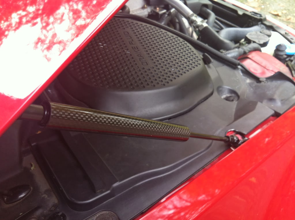

Some carbon bonnet struts to do away with the manual holder

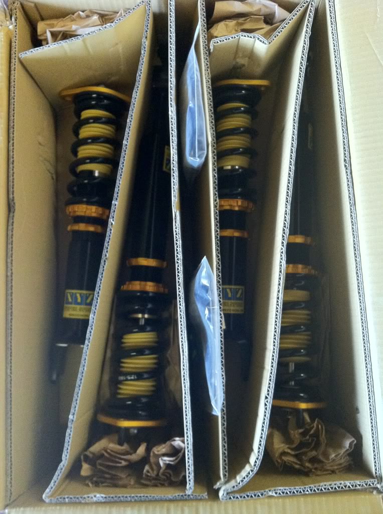

Then these arrived yesterday
Once I work out what the craic is i'll get onto fitting them. Unlike most shocks I've worked with before the bottom of the strut rotates to enlongate or shorten the strut as well as the usual spring collars for the height. So unsure how what settings and that it needs to go to
Chris has them on his and the ride is very good, I don't even need to mention the looks
Wheels are on order and should be here within the week or so
Prob just trial fit them and then off again before we get the worst of the winter stuff
That design is superior. It means you can set the height and still adjust preload/spring tension rather than changing the height and preload changing too!
Exactly^^ always pissed me off with the Clio that you ended up losing preload when you made the car lower. Utter stupidity.
Set your height with the lower collar then adjust the preload with the collar and locking collar that the spring sits on. Realistically I'd fit them on then take the car to a local specialist to give them a tweak set the geo and if you're feeling flush have the corner weighting done.

Spot on will do, there's a DIY garage place not far from me you can rent the geo bay with corner weights by the hour so I'll prob head there after fitment

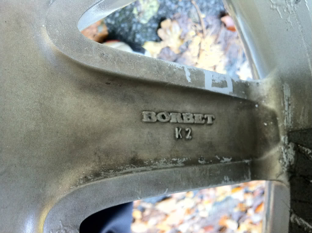

Well the wheels just turned up, delighted with them
Just a teaser, anyone guess the wheel? (The couple that know need not apply :) )
