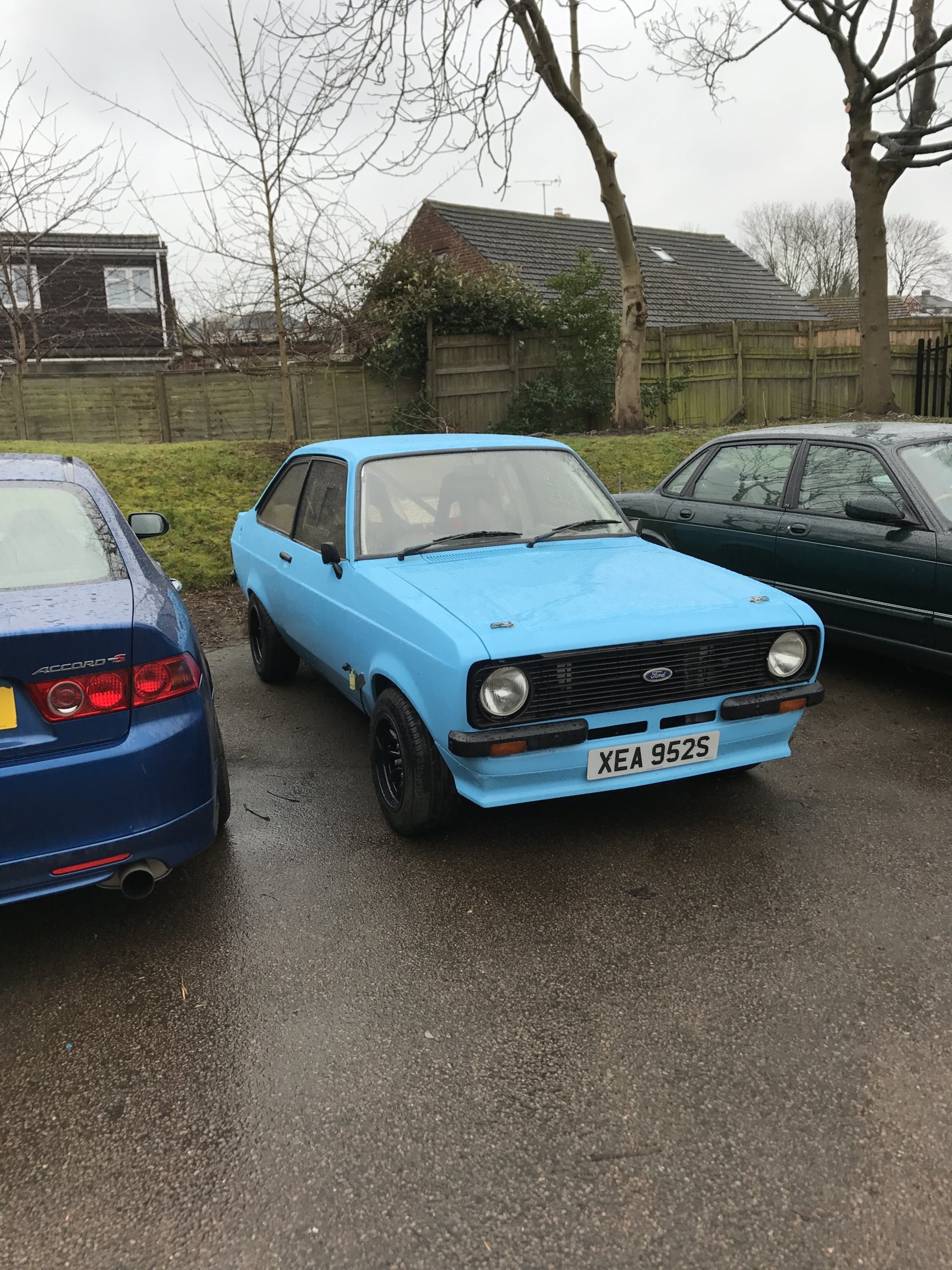

Immaculate ford anglia

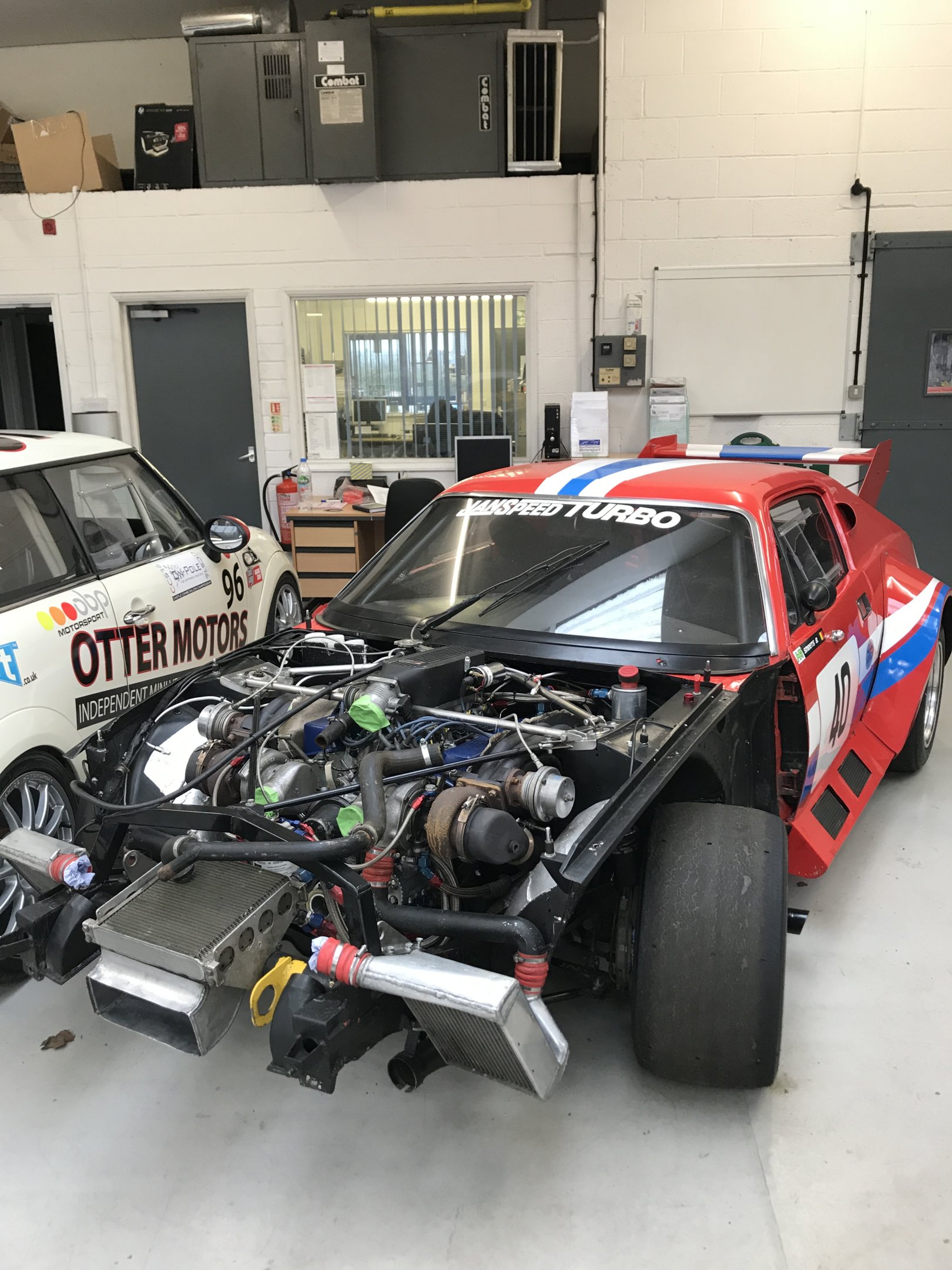

fully reworked janspeed twin turbo v8 (i think)

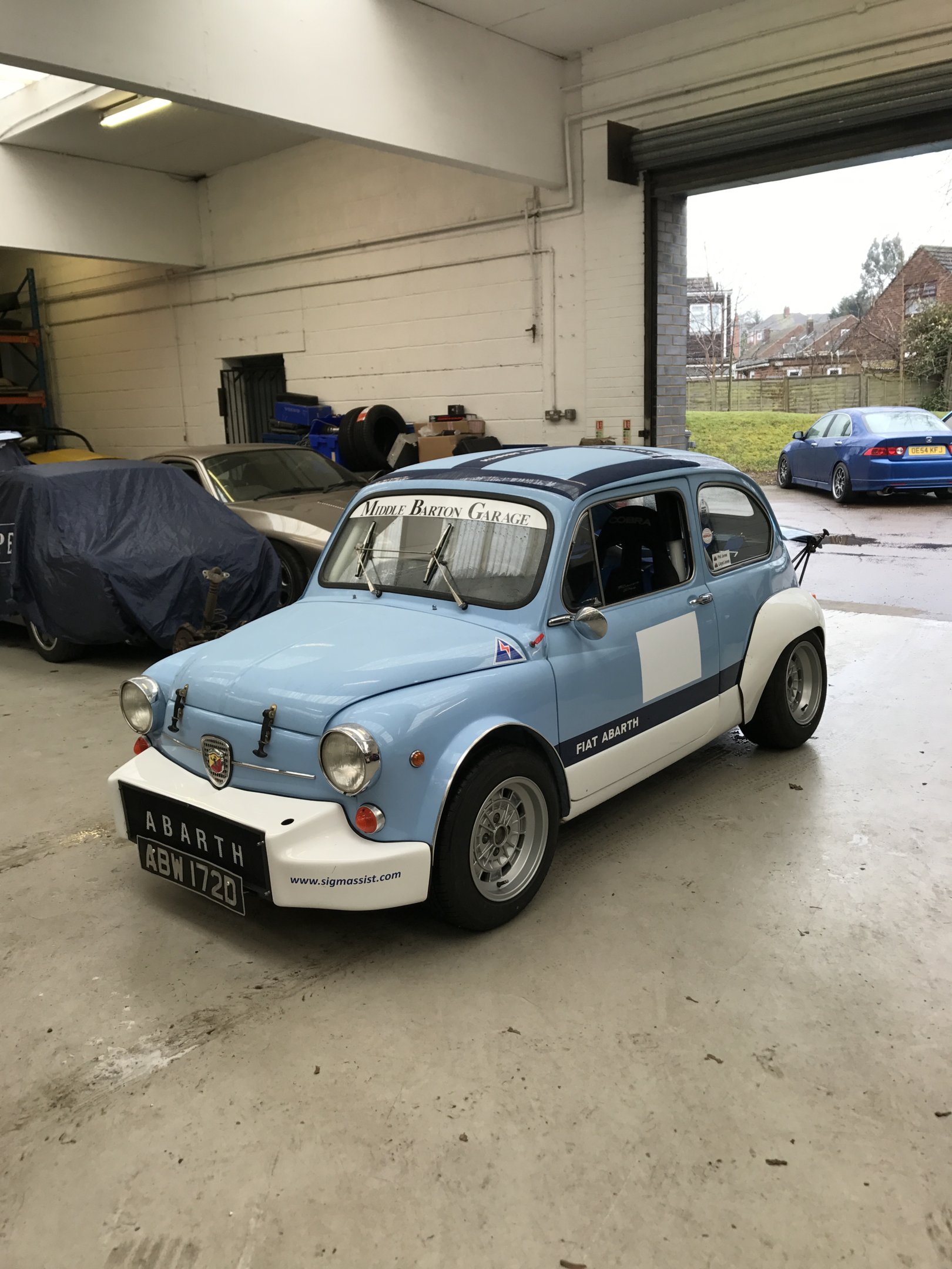

And a fiat 600 factory wide body hillclimb car that came in for weight and rolling road.

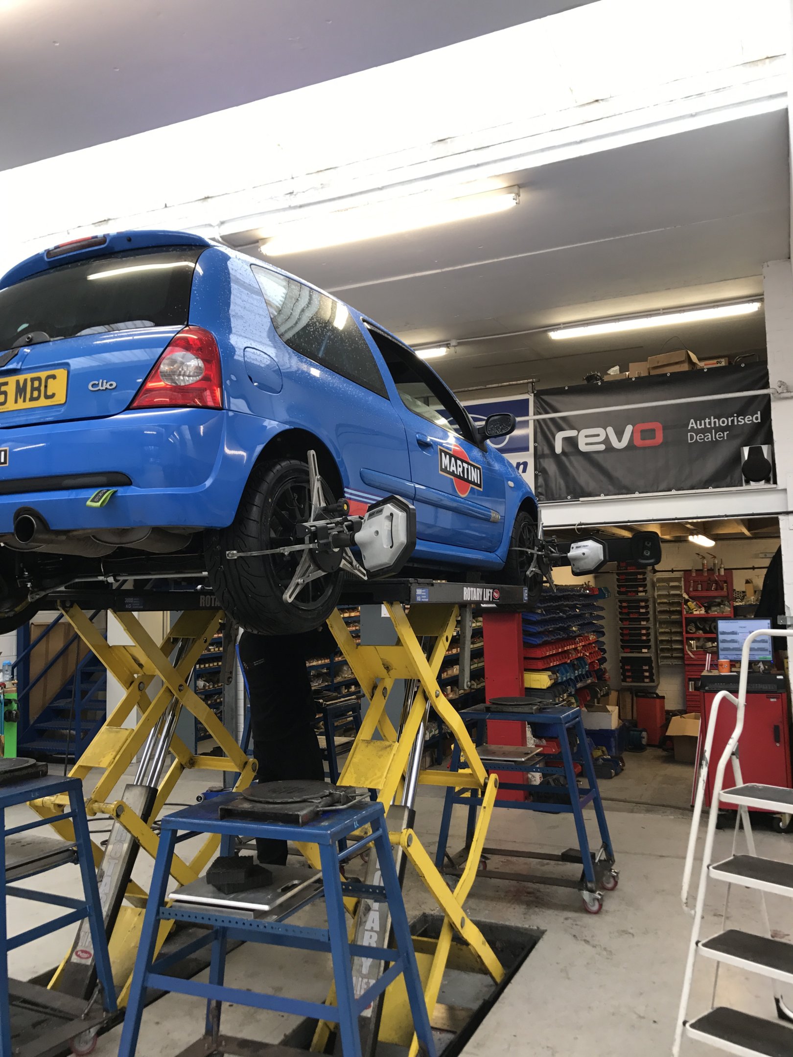

we got mine on the ramp first as we discovered the mk2 needed a new top mount, which northampton motorsport ordered there and then and fitted (top blokes)

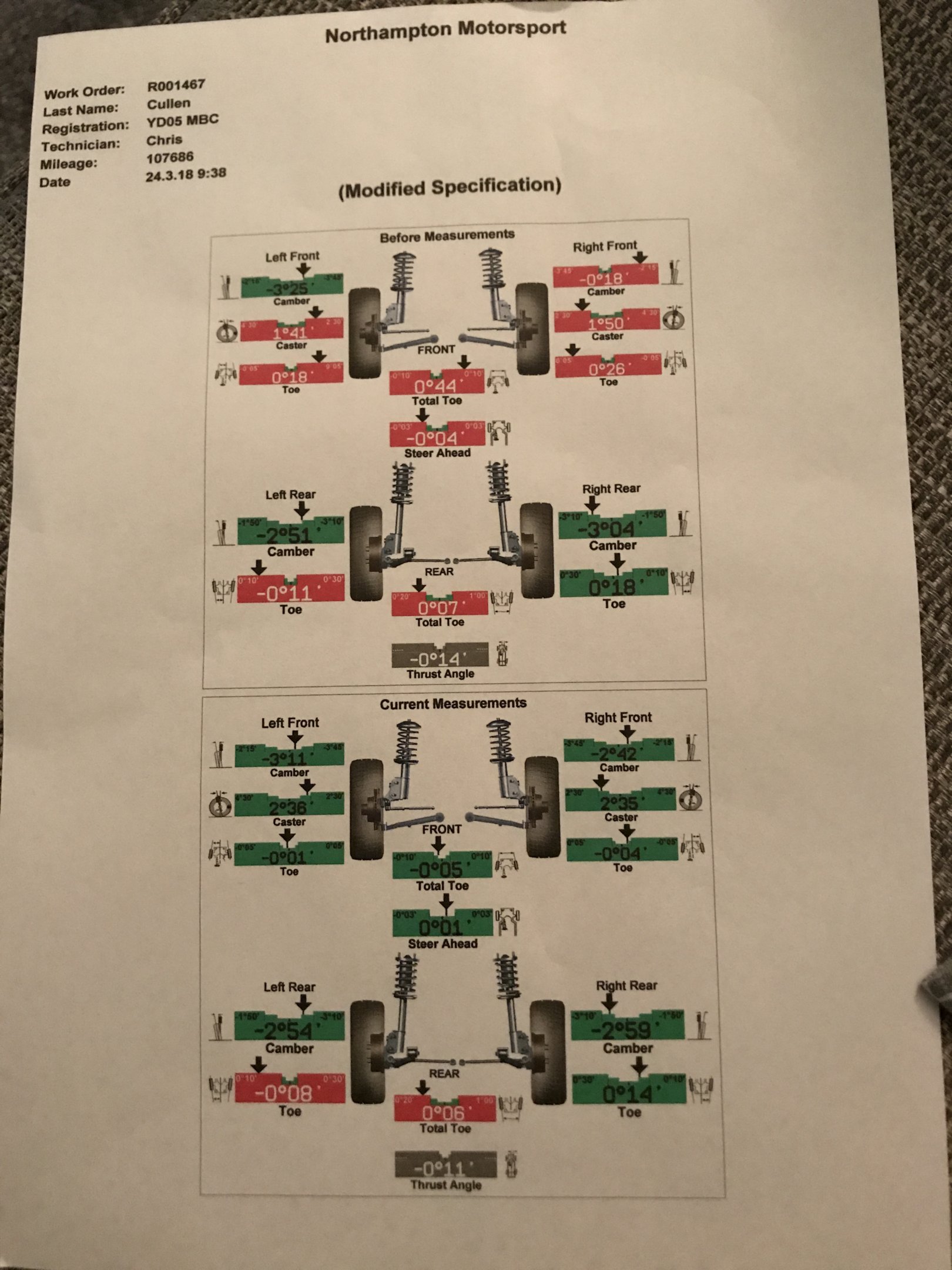

The camber shims i had discovered installed on the car the other night were negative 3 degrees camber slightly more than i expected.
I had wanted to run -2 to -2 1/4 on the front but due to the rear im now running -3 all round.

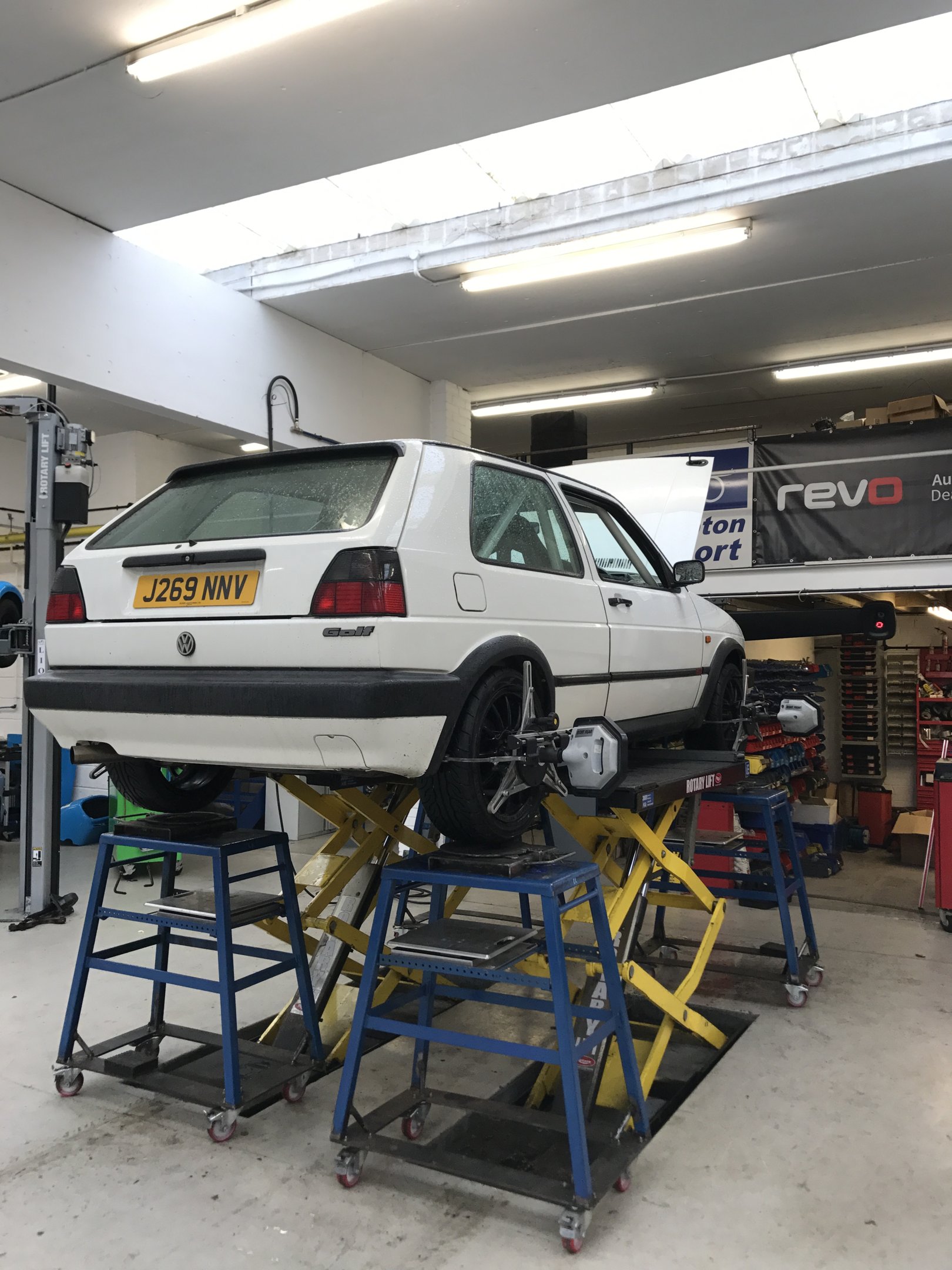

Mk2 on the alignment
And the graph, the rear passenger is out but we think this is due to the stub axle that has been tampered with,
that will be changed out this week as i received the new ones. thanks @H2MRK
Happy with the results now the car drives straight :smile:

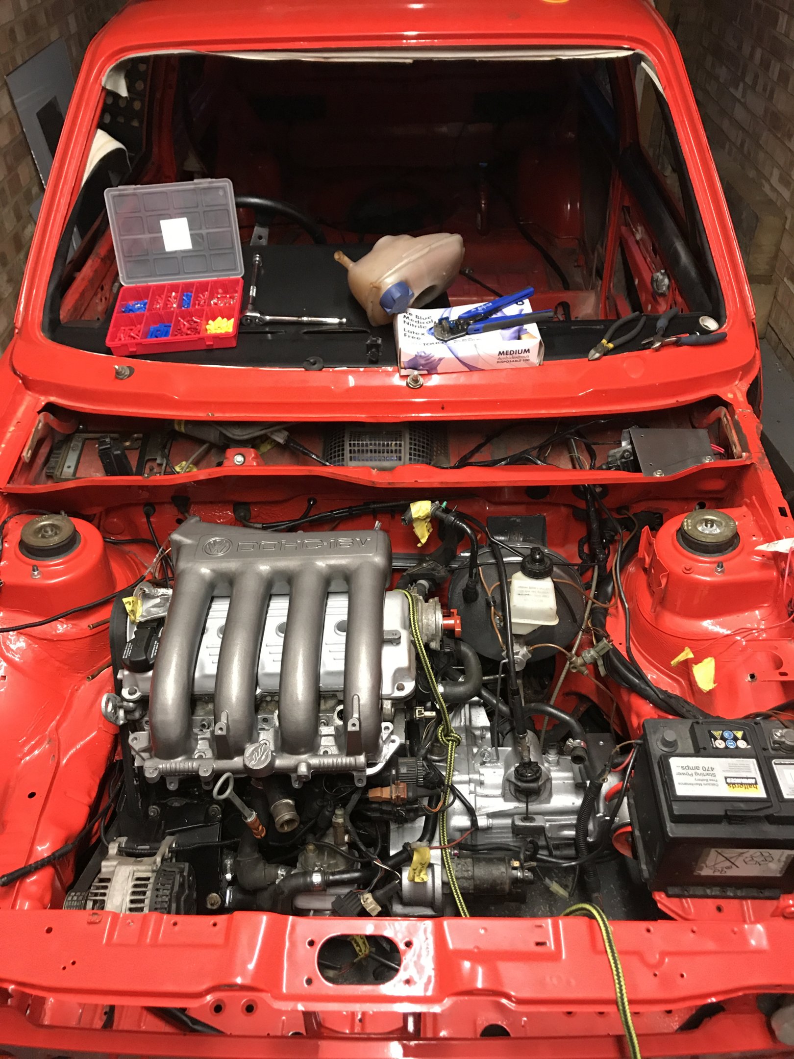

After spa I decided to sell the clio to rebuild the new mk1 golf shell I had just bought.
April 2018-august 2018

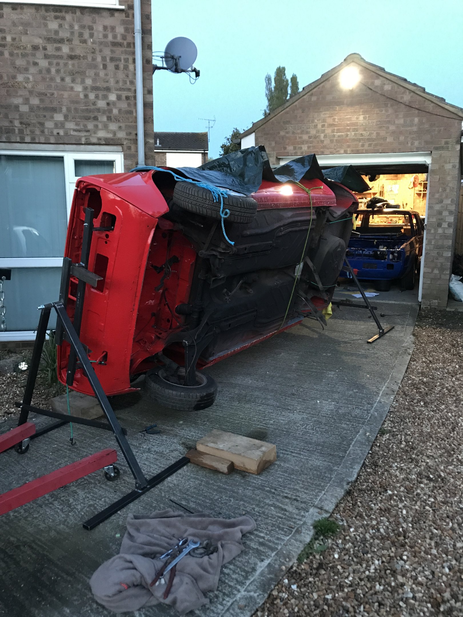

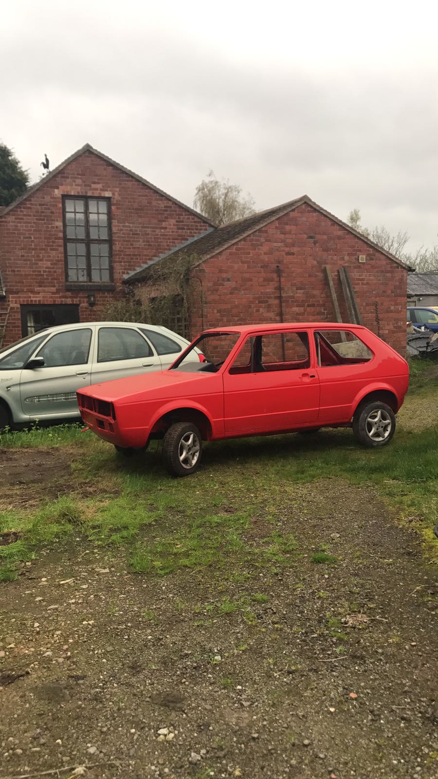

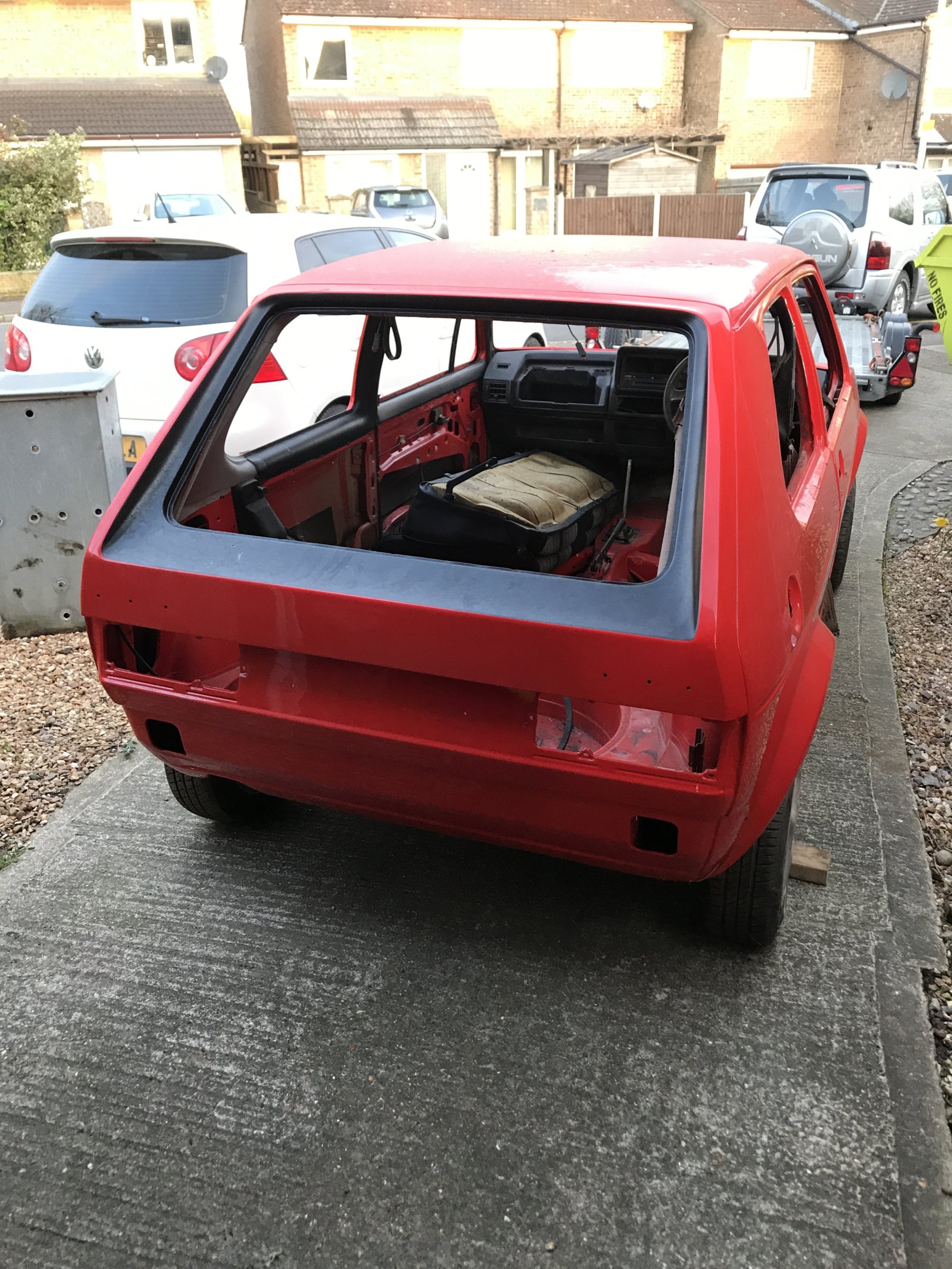

Found a fully refurbished shell in a barn in coventry

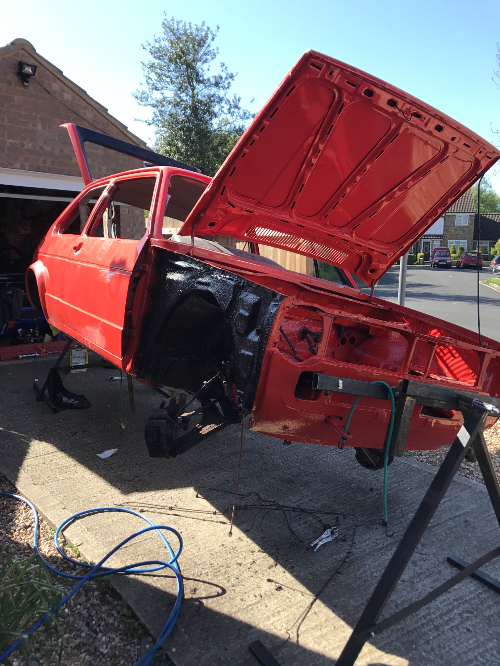

Once home I got the car on the jig and re undersealed it all

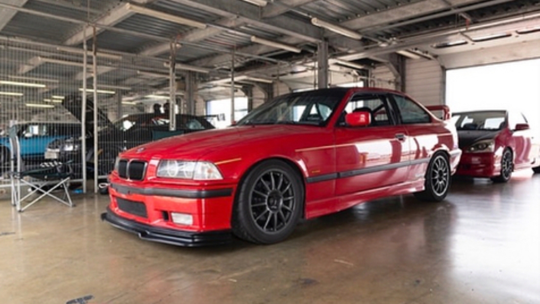

New car after selling the mk1 1

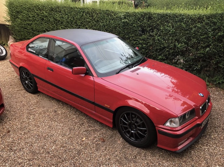

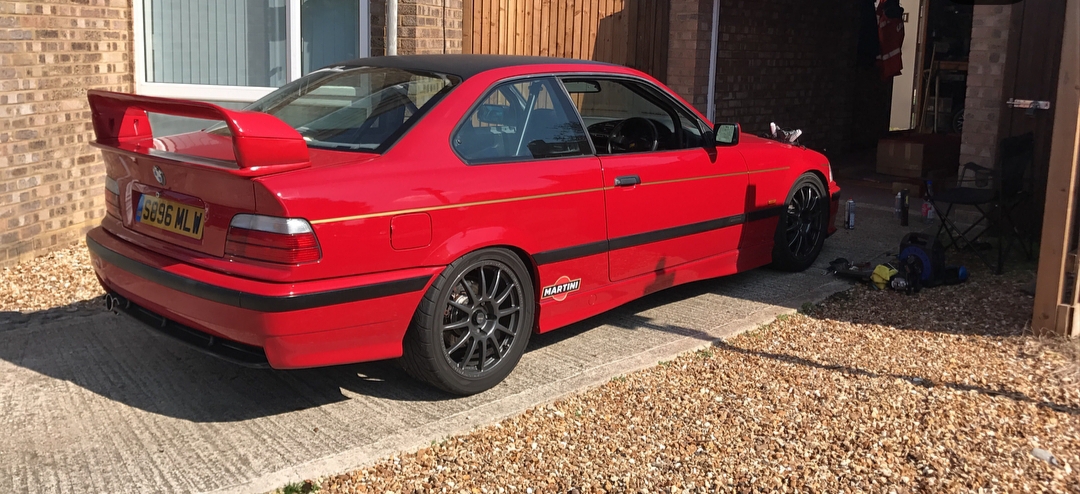

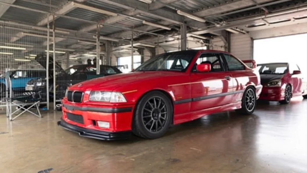

bmw 328i 240hp
full cage
ado8r's
cobra buckets and harnesses
td 1.2 17x8 all round
m3 medium case diff
hsd dualtech coilovers
uprated anti rollbars
After I got my hands on it and a few trackdays

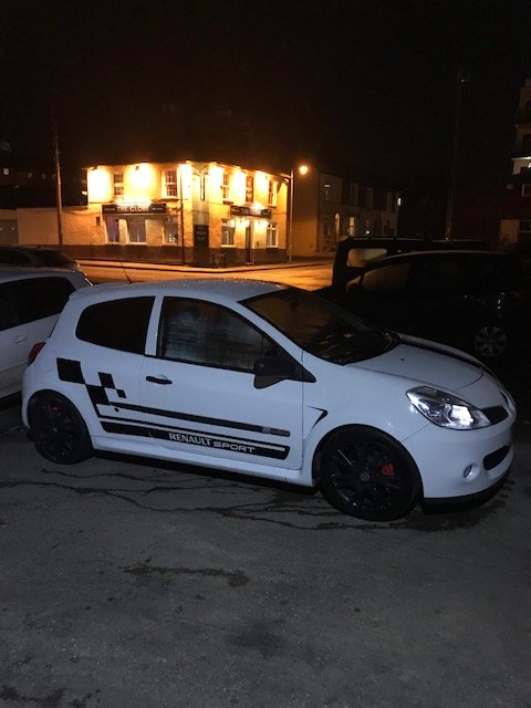

Bit of history car was a cat c pre 2015 and was repaired by the same bloke I bought it off who is my best mates friend runs G.A.D bodyshop, owned the car all that time, and has done the mods aswell, I even had a few laps in this car in 2015 at Bedford autodrome and was not aware it was a cat c, just goes to show its about the car and not the history

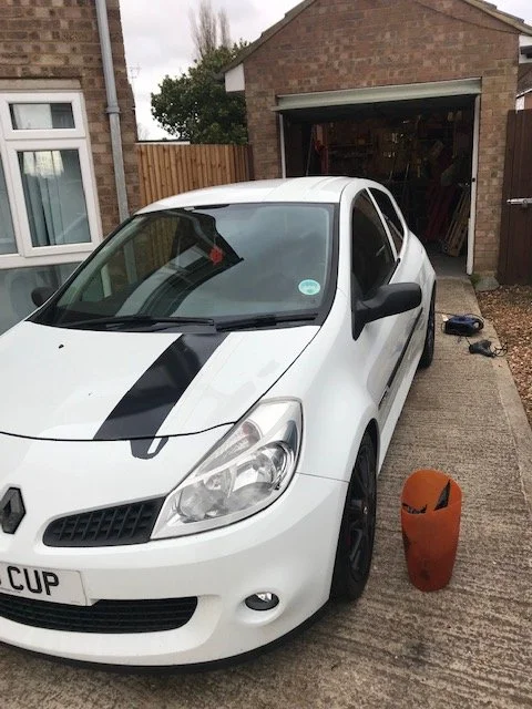

Clio 197 cup
39k
4 branch mani
decat
sports system with downturned pipes
quaife diff
lowered on springs
recaro seats
Picked it up for £2800 which I think is a good price
Car is currently being de stickered in between defrosting my fingers.

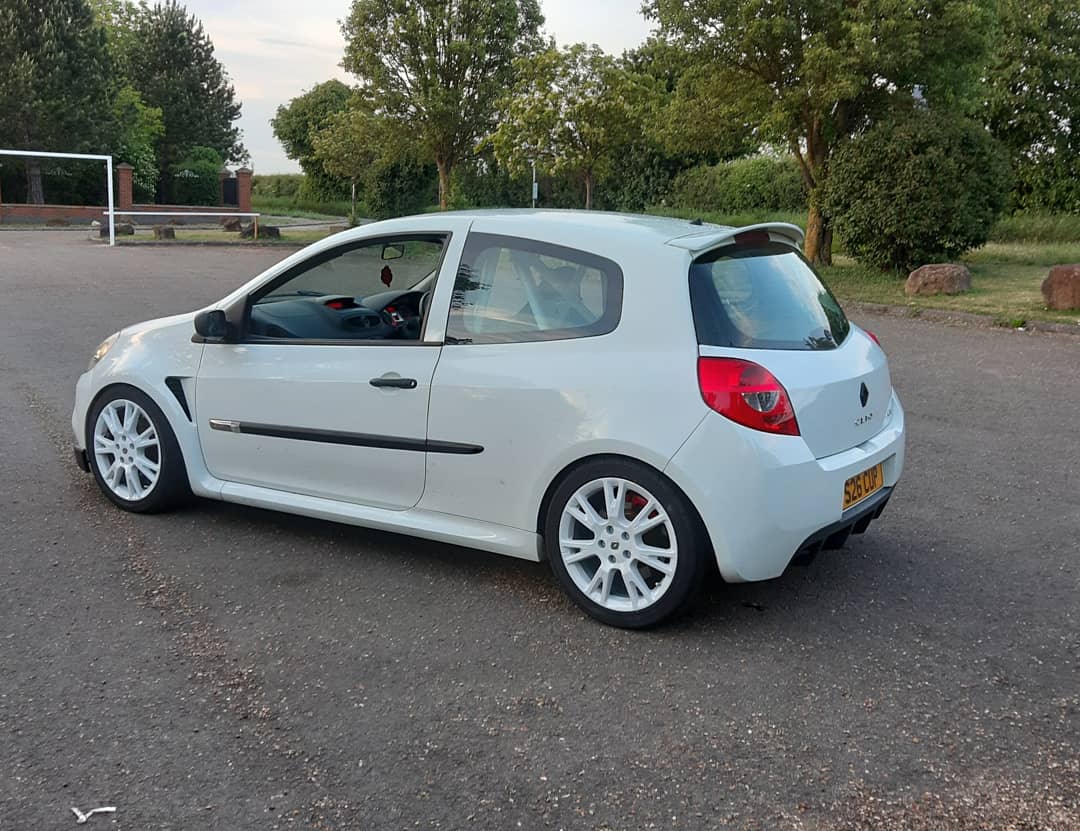

Sooooo I'm.back in a clio 182 and I've been busy,
This is how the clio 197 ended up after I vanished from the forum.

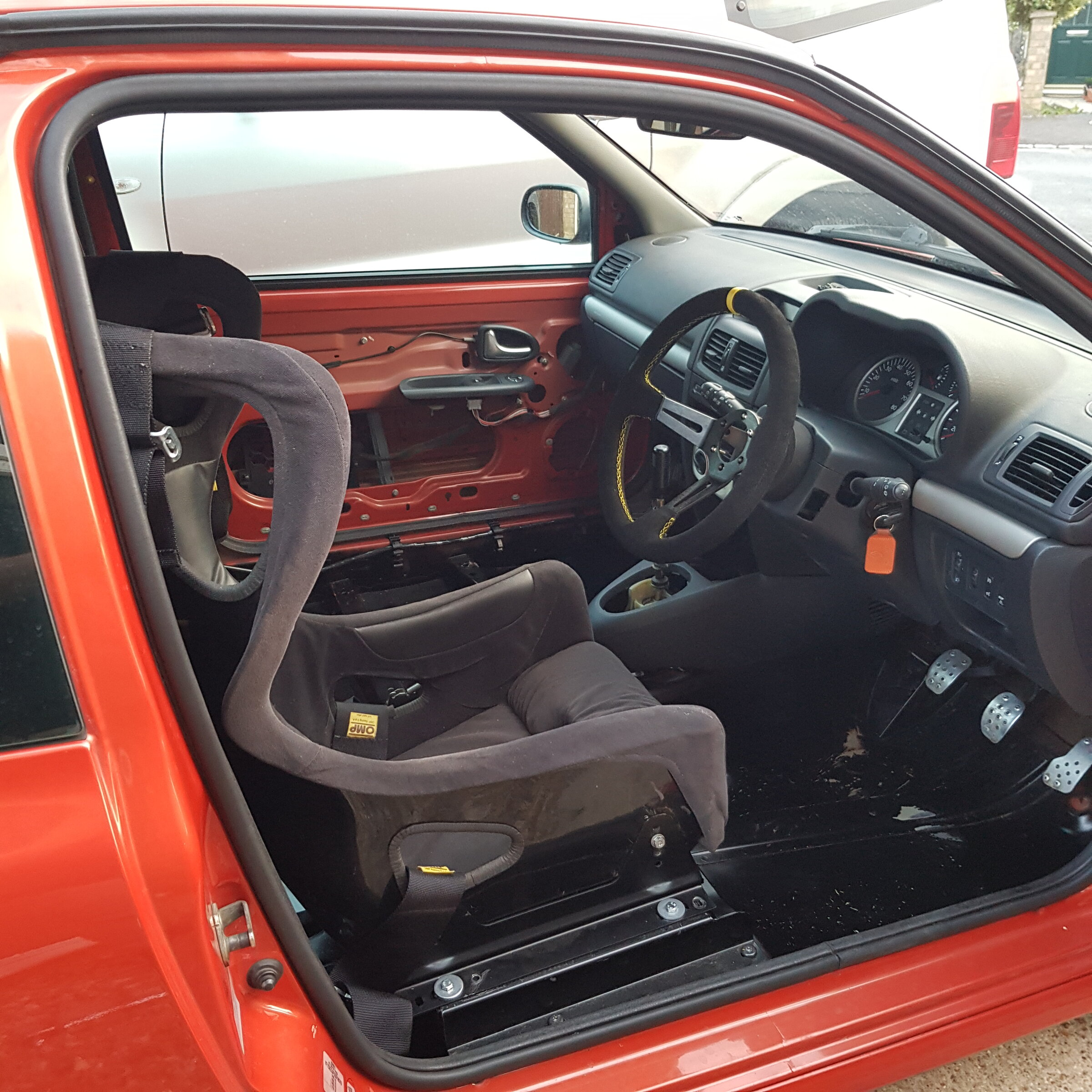

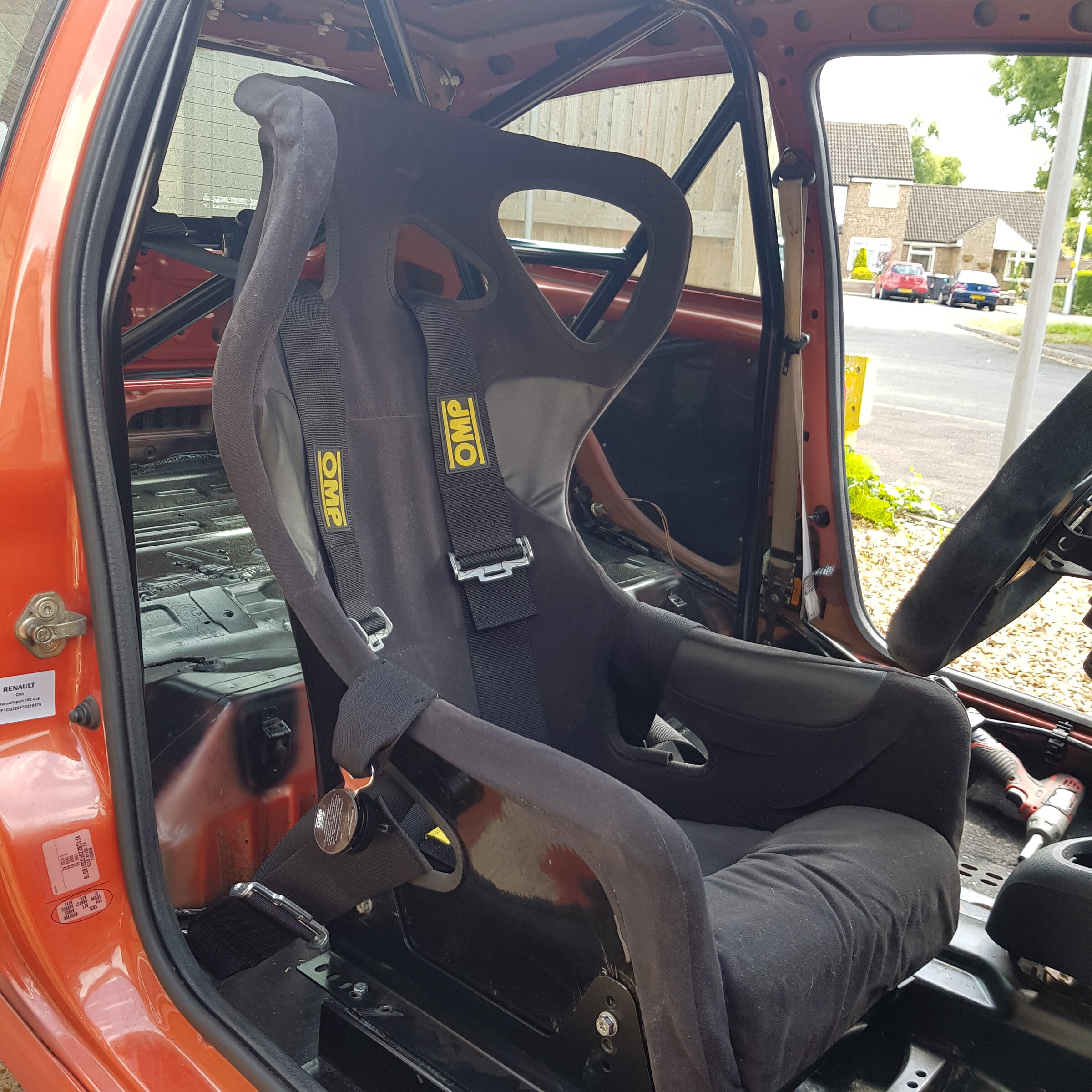

And this is the new creation inferno orange 182 bought from a mate who had done alot of work to it and owned it for 3 years prior to me getting my hands on it
Bc coilovers
X2 omp bucket seats
Half cage
Some technomagnesio wheels with ar1 tyres
White line rear ARB
Omp flat bottom wheel

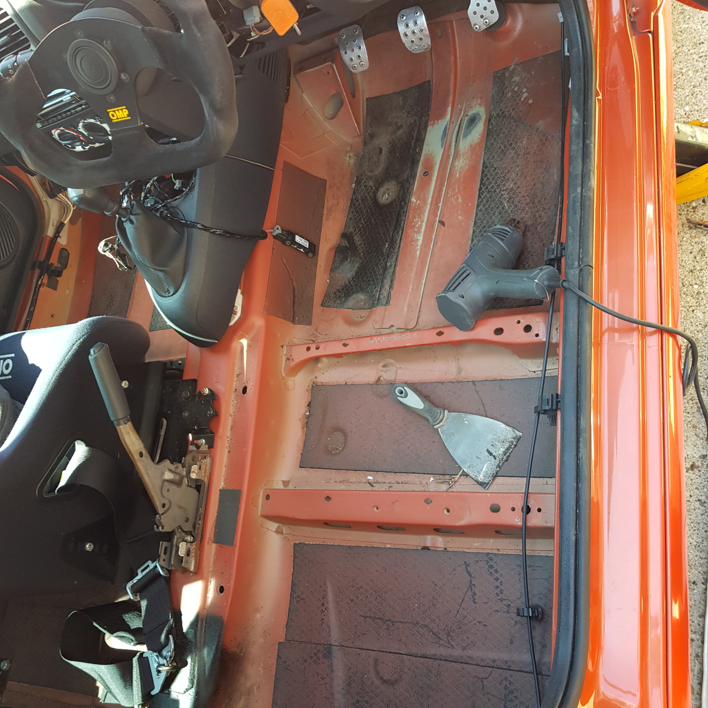

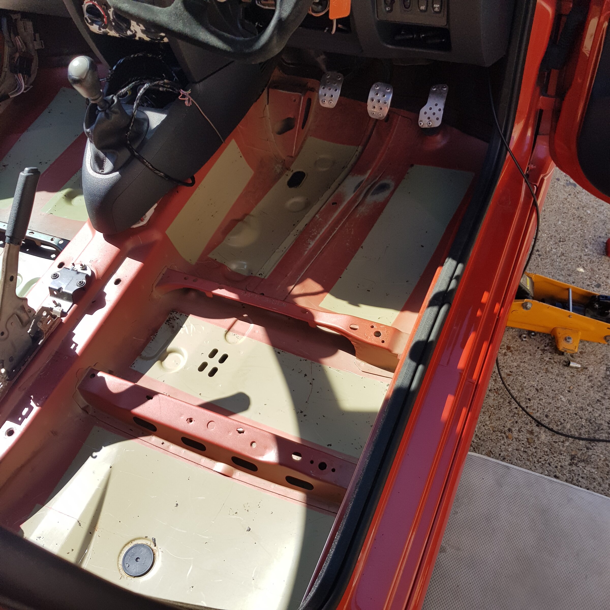

This was the car as I bought it clean and cared for

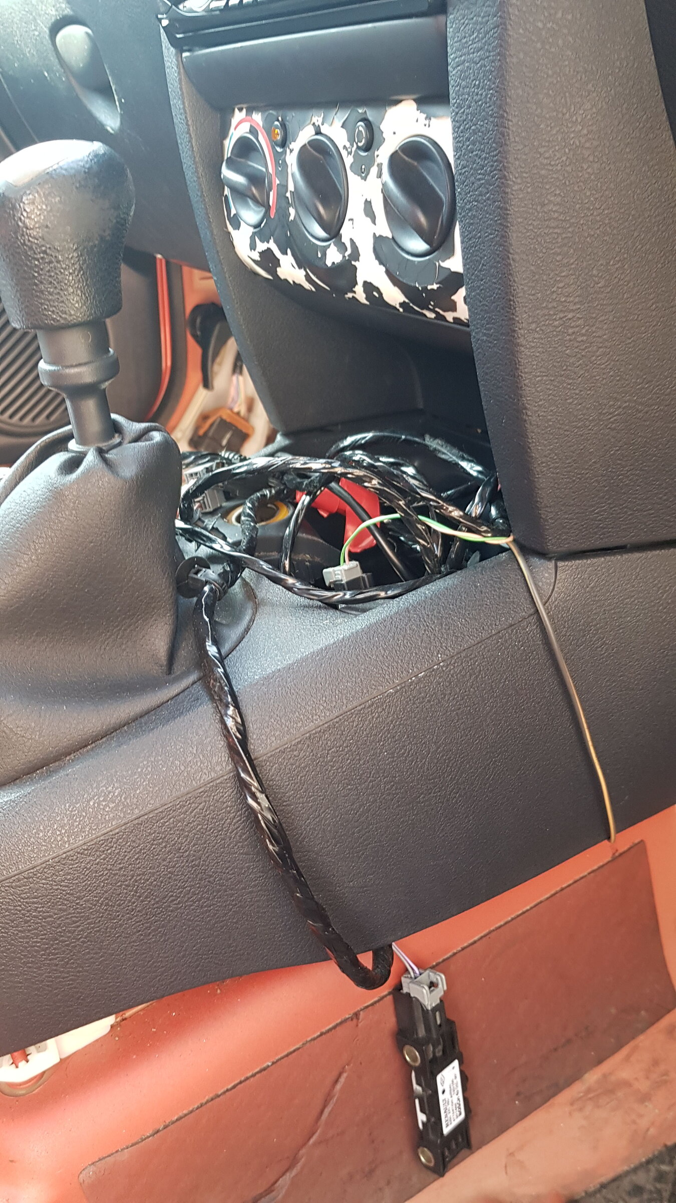

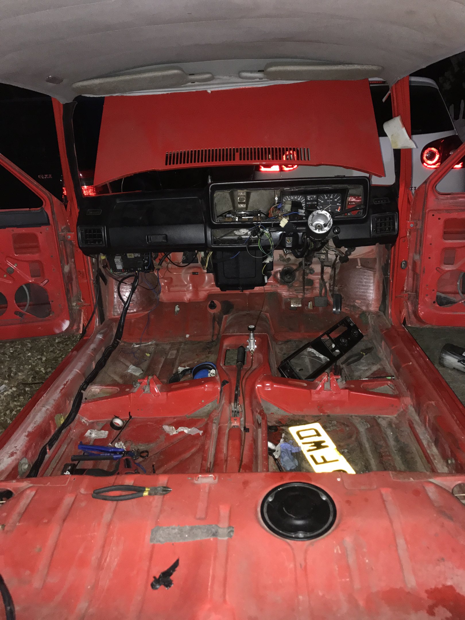

Since then I have fully stripped the car of all sound proofing roof and floors sorted some untidy wiring out and clean up the dials
Before
During
Hideous

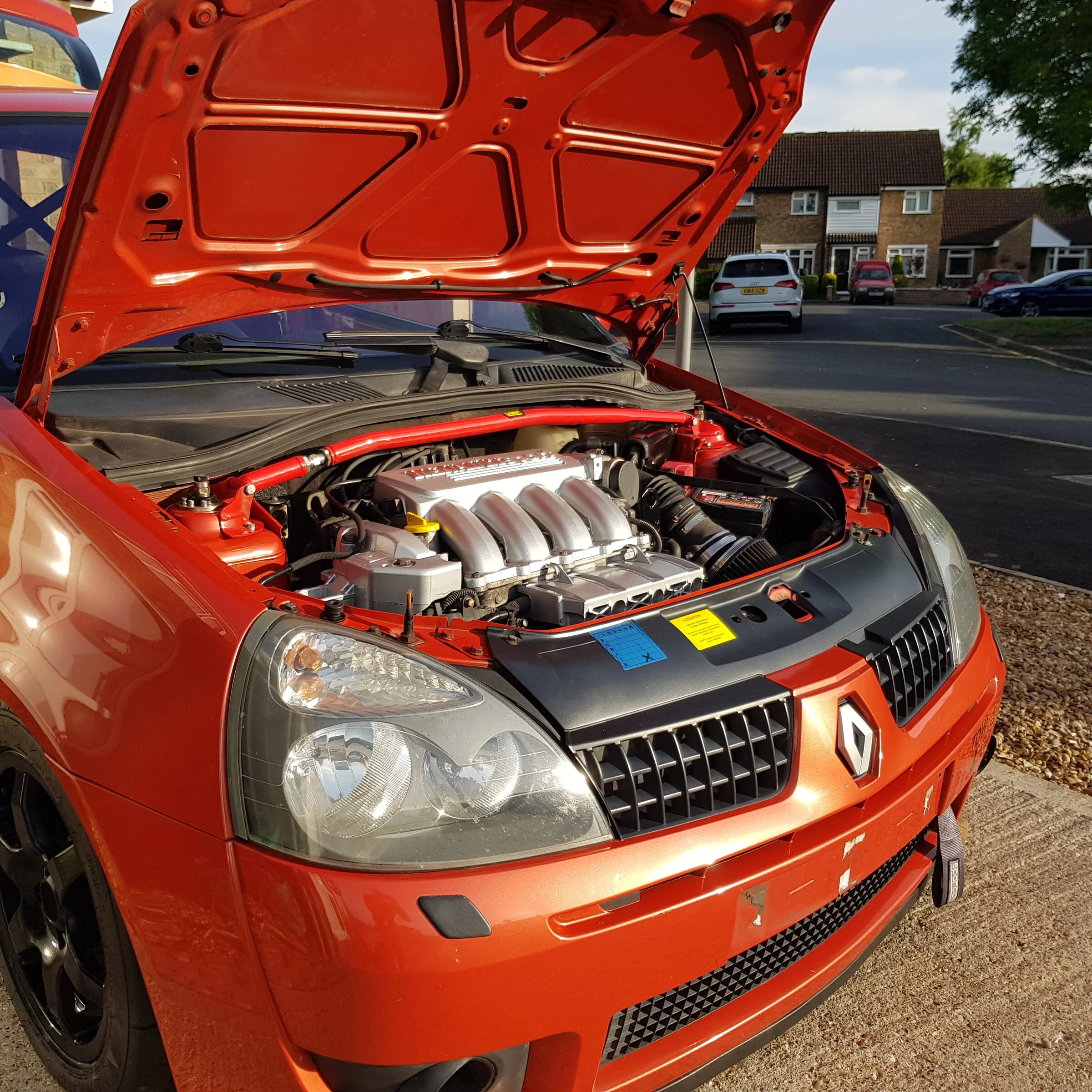

I started the engine bay up aswell with a few rattle cans as I like my track cars looking smart
Also put some air holes in the front as I like the look more than it being useful
Ive also cut in a proper cold air feed duct to the air filted just next to the tow hook, tempory until I do a battery relocation and an enclosed filter.

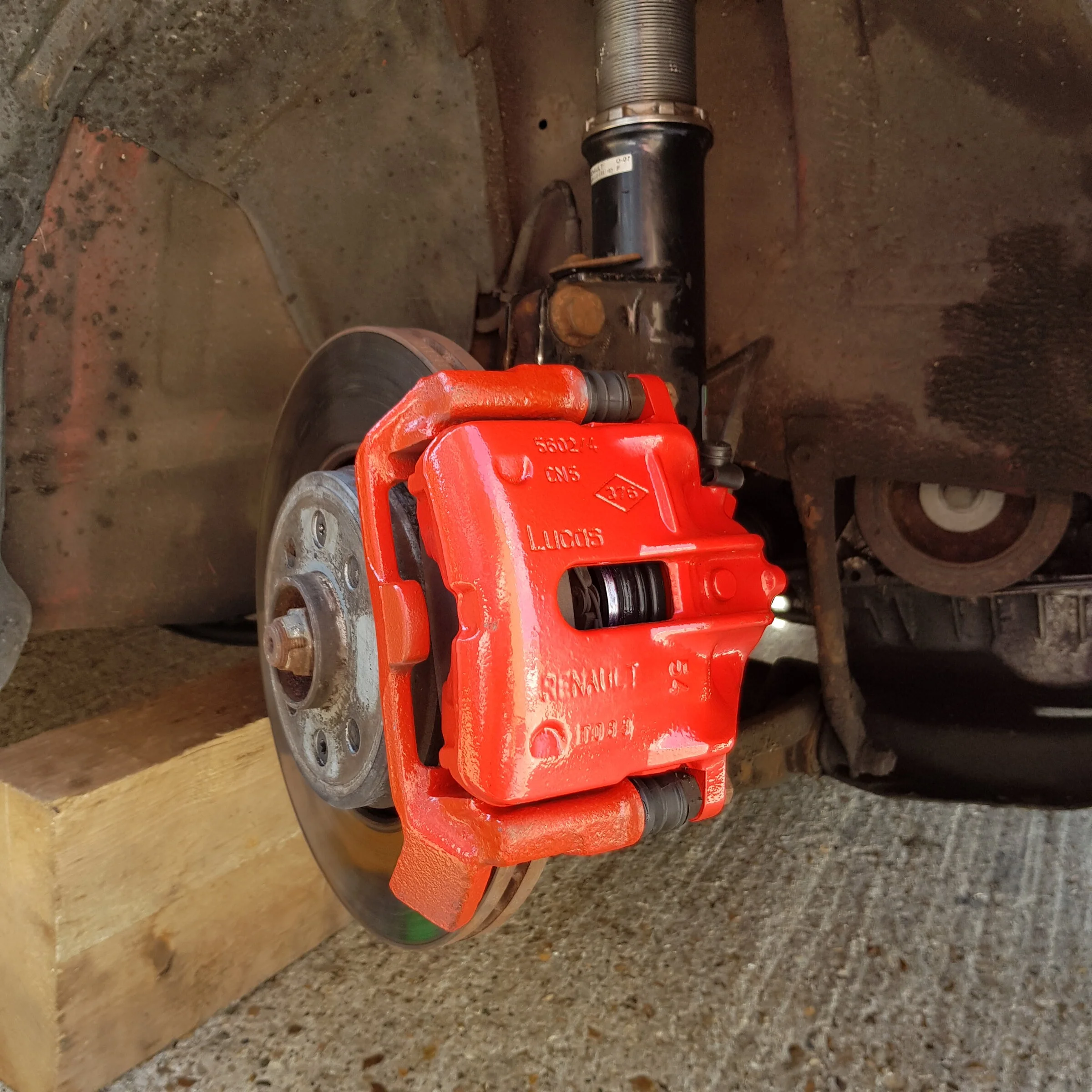

Also rebuilt both front calipers and gave them a lick of paint the setup is now
brembo hc discs
Hel braided lines
Motul 660 fluid
Mintex F2R pads front
PBS pads rear with standard discs
