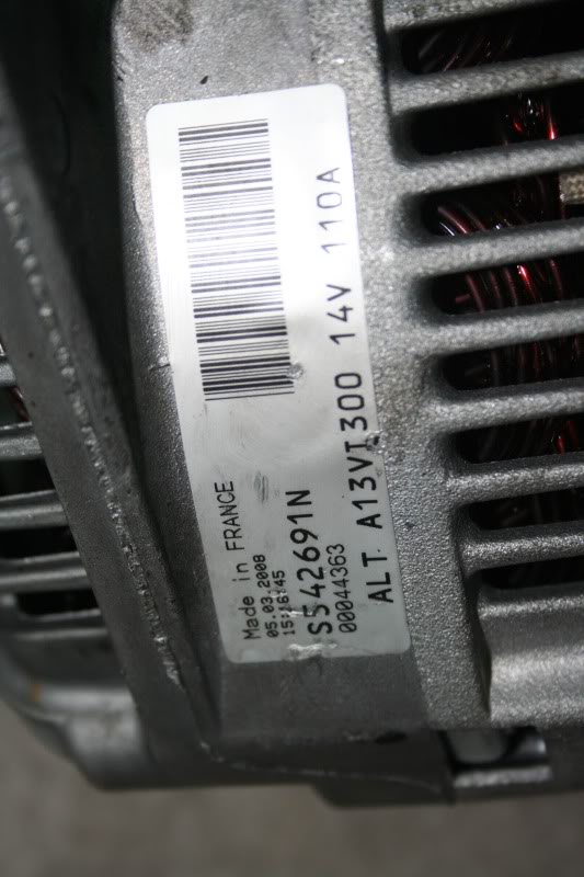

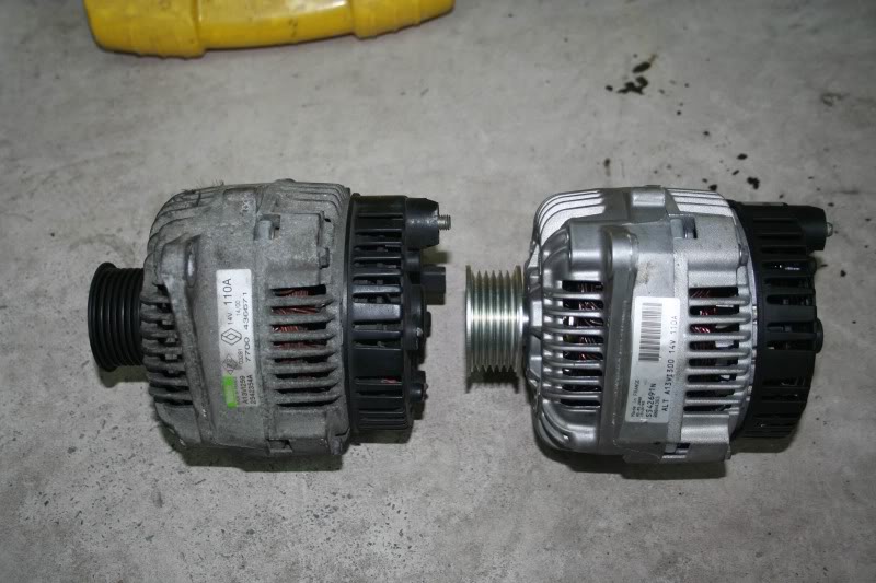

i need to know whether i have been sold the wrong thing, the pictures below show what i have got...
the old alternator on the left, the new on the right (supposed cup alternator)
the label on the new alternator

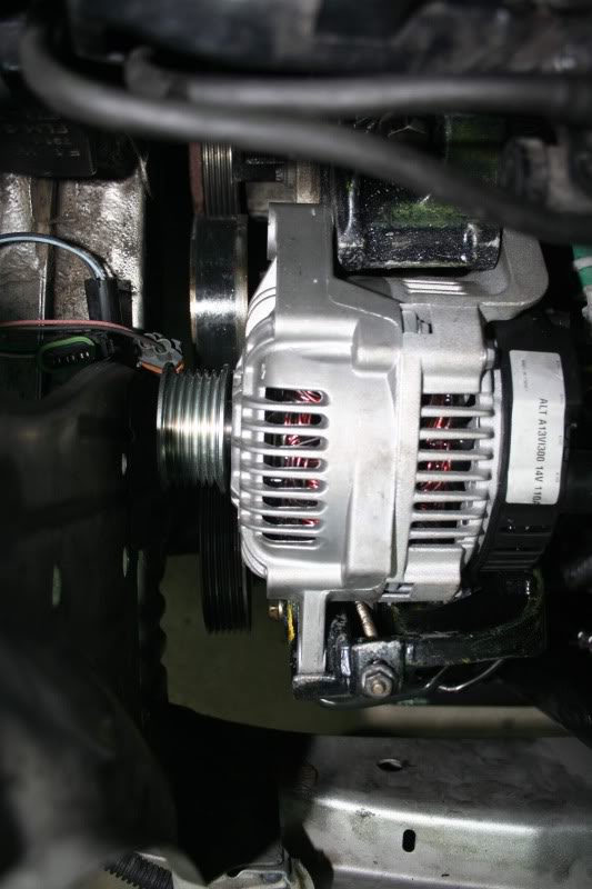

how it sits in the cup mounts, you can clearly see it sits squiff and doesn't line up with the other pulleys...
i need to know if i am doing something wrong or if this is totally the wrong alternator.

wrong one. the cup one has the bolt hole that fixes to the tensioner about 30degrees furthur round. that's a standard 172 alternator

As said above- i fitted a laguna 1.8 8v alternator when i binned the aircon on my ph1 (along with the brackets etc of same laguna) Mk1 clio rsi(1.8 8v) will also have same alternator. F3P is the engine code of these 1.8 8v engines iirc. Plenty of scrap lagunas around to get one off i would think.
  Ph1 172, Leon cupra
Good work,will bolt straight. Only problem i had was that on the original alternator there were two wires-one for the charge to the batt and one small wire for warning light on the dash.
So on original alternator(and assume yours will be the same) this means the rectifier is self powered (internally), not so on the laguna alternator. So its just a case of powering it with a 12v feed,that is only live on ignition-i.e as per stereo power etc. You can feed off somewhere in the fusebox,or splice into stereo feed etc, make sure it isn't a permanent live or you will drain the battery.
I can take some pics of my alternator in situe if needed, let me know. When looking for a belt-i ordered a laguna 1.8 8v non-aircon but with pas,as it has exactly the same belt run you will be using(again mk1 clio rsi with pas non-aircon will be same)
Hope this is clear and helps!

Hey ph-reebone any idea what the part number for the cup alternator is? Cit-ren sent me a 'cup' alternator this morning with part number 7700436671 which I think matches your standard one.
All after I started ripping mine apart... dammit
Nafoff
7700857873 i think is my new one...bit faided though, could be wrong
can't see a part number on the other one.....check the pics of all of them in my project thread.....you should be able to tell from pics
checked on my original phase 1 alternator and yes its the same code as yours above
