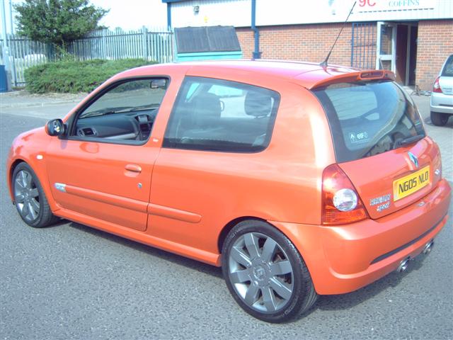

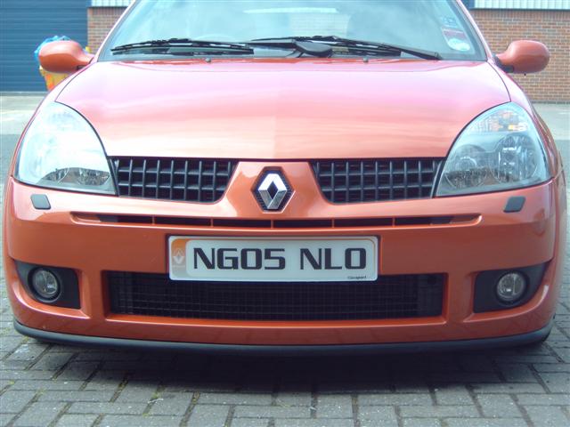

Mines lowwered 40mm on apexs last week had 3 people in the back no rubbing at all

it'll be fine!!! mine is lowered on h&r's pretty low!, only problems you may have is if you have an aftermarket exhaust, as this may knock on the rear beam...

blunty and especiallygt gaz do you or have you had problems with the front splitter on speed bumps?
never hit one yet! infact i've never boken my splitter :approve:
