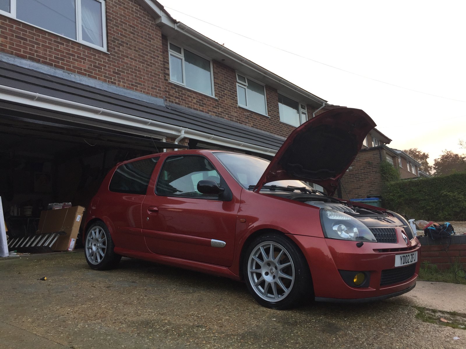

I have eibach sportlines and cup shocks. I've only done one track day and other than my crap driving it did well in all the corners etc.
Sits like this..
  172 Cup
I have the same as Davy. I wouldn't want to go any lower tbh for a road car.
