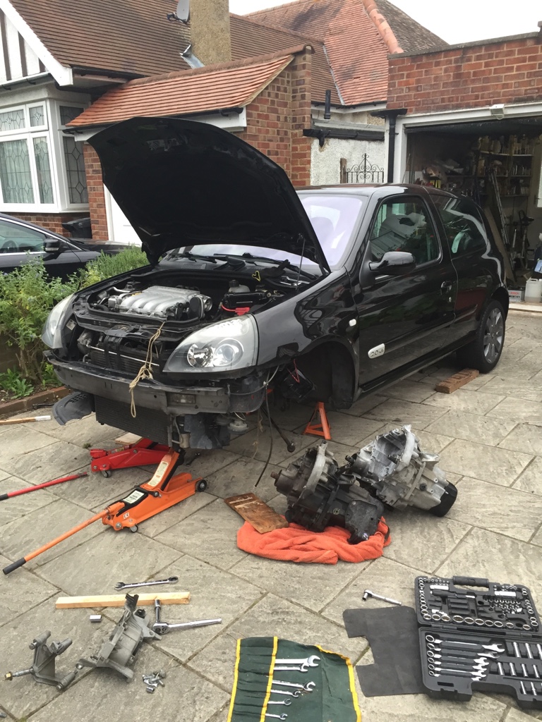

I apologise also BTW. Removed a box from my 182 last night subframe down on one side. Came out so much quicker than out the top. Putting it back in, i might have a bit more fun on the deck tbh.
We've all been saying for years it's more pleasant coming out the bottom :)
With the right tools, it is for sure.
With short axle stands, hand tools only and a regular trolley jack rather than a big b*****d like i have now, i'd still go out the top. lol.

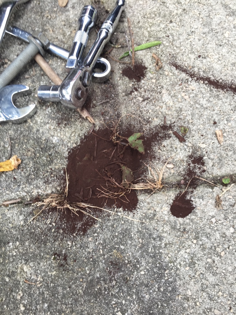

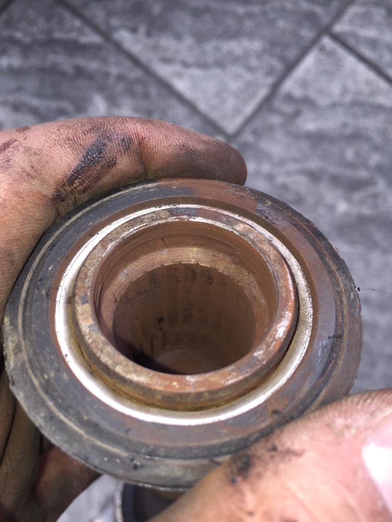

This is not normal is it for the splines on this driveshaft to all be worn away ? Only 1cm left on the inside ...

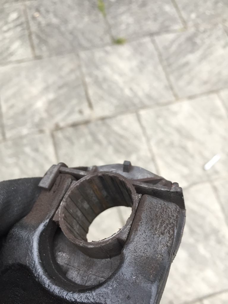

The release bearing has a tiny plastic big broken off, does this matter ? I can't think it would it's so flimsy and useless ( release bearing was changed with clutch not ages ago so is new )

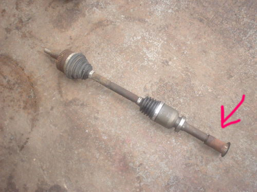

I bought a service exchange drive shaft for my 182 cup from Renault last year for £123.58 + vat 8201187820.
It came with the sleeve firmly attached to the drive shaft.
When I removed the old drive shaft it just came away from the gearbox splines with a bit of help from a pry bar.
All the splines were like new because they had used copper grease on them from the factory.
So yours can only be held on buy rust, I would try it in a vice or get some mole grips inside it, you cant use heat because you will damage the oil seal.

The sleeve just sits in the shaft? is that right. I can try and remove the old damaged shaft with mole grips?
And the new sleeve can be tapped into place with a hammer into the shaft?

You have removed the rack from the subframe and then lowered the subframe? just trying to understand how you've done it!
Hi midge, where does the elastic band go? sounds silly but I cant figure that one out. (like most things in this thread!)
I removed the rack bolts at the back of the subframe, tied the rack to the exhaust mani and a few other places, and lowered the subframe off. Ill post up all my stuff once im finished in my project thread (if i ever finish aha)

Any tips for fitting gearbox. I was thinking lower engine slightly. Is currently jacked up on sump - will put a bit of grease on the splines. Hopefully it will meet up first time and then I can crack on with putting it back together and then tackle the sump.
Sweet sounds like it will be alright then luckily got 2 jacks.

I thought the sleeve was stuck on the gearbox not the driveshaft couldn't really tell from the picture.
Now I know stuck on the shaft the best thing to do is let wd40 or penetrating oil soak into the splines then put in in the vice and hit the sleeve with a chisel.
Clean the splines then tap the new sleeve on with a hammer / wood block.

There are splines on the drive shaft and inside the sleeve that's what stops it from spinning just like the gearbox side hence my confusion.
The best way to get the drive shaft out the hubs is to hit the centre with a pointed chisel and big hammer.
and like you say the sleeve just simply sits into the drive shaft with tightness.
The sleeve I linked earlier will fit a 182 gearbox fine.

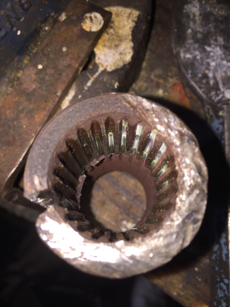

Spent an hour heating the driveshaft sleeve up and trying to whack it off. Eventually cut it off !

Im absolutely gutted - Changed the gearbox, change the sleeve on the drive shaft
Had 1st and reverse - as far as I can tell both drive shafts are now fine. but after initial movement of 2 feet I had exactly the same slipping whirring noise.

But the main thing is I have exactly the same ticking tapping sound with the clutch up I had before. I didn't change the release bearing - its new and felt fine when I tested it, it had one broken installation tab on it but I googled over and over and everyone said they where purely for install purposes and always snap off.

Clearly that adapter sleeve on the drive shaft was knackered. The noise in the video below sounded like that sleeve had lost its teeth and was just spinning so I was so sure in my head that it would have been solved along with the gearbox swap being done for peace of mind.
