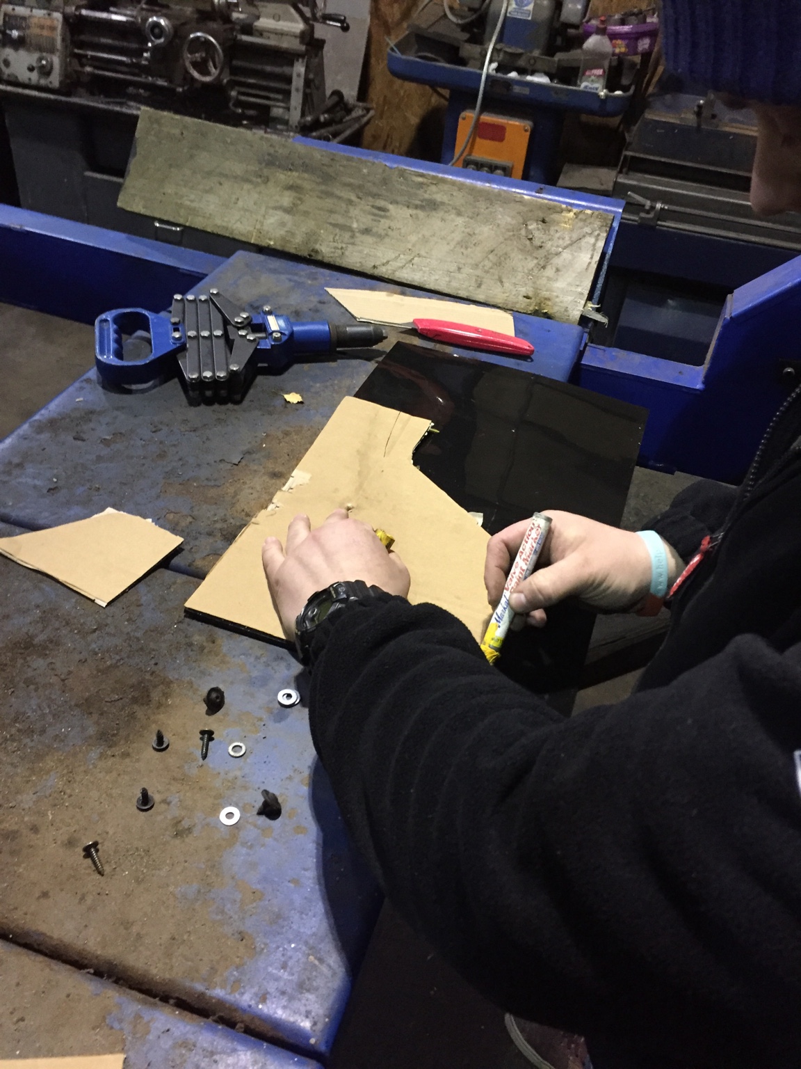

First I got a piece of cardboard and got a rough idea, then cut a stencil and drew around it then cut them out.

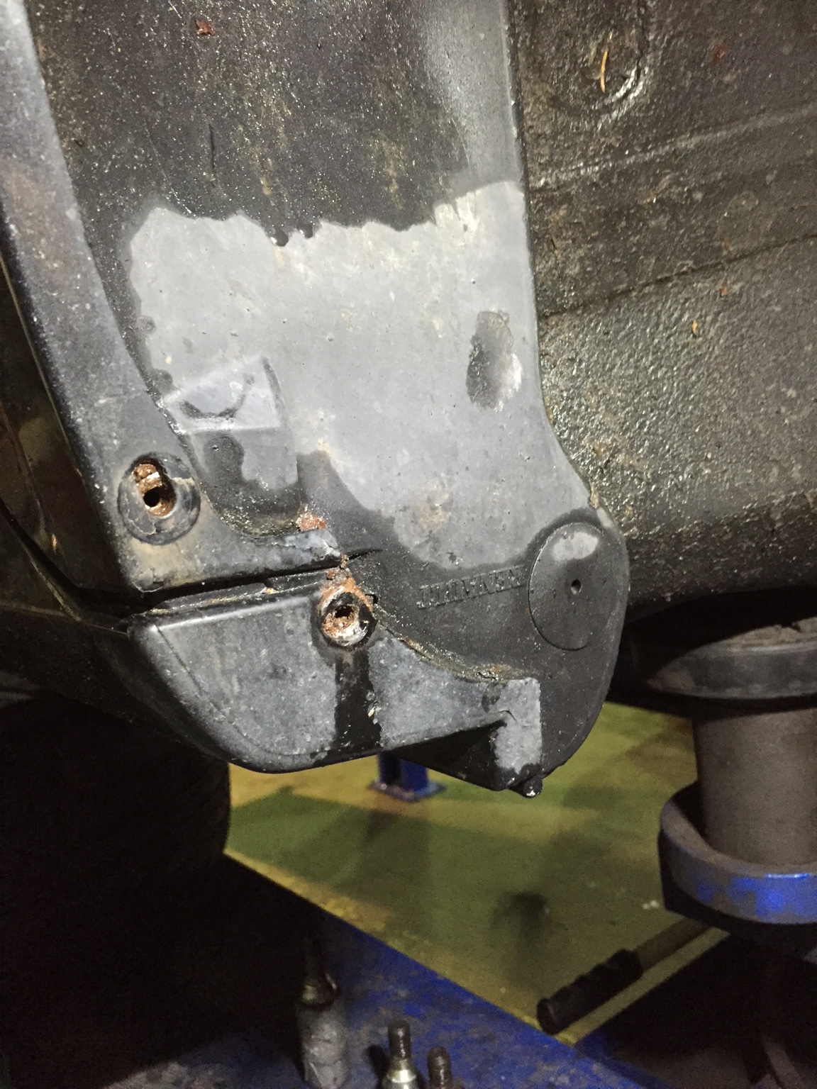

I used the holes that were already in the arch, used to hold the plastic arch in.

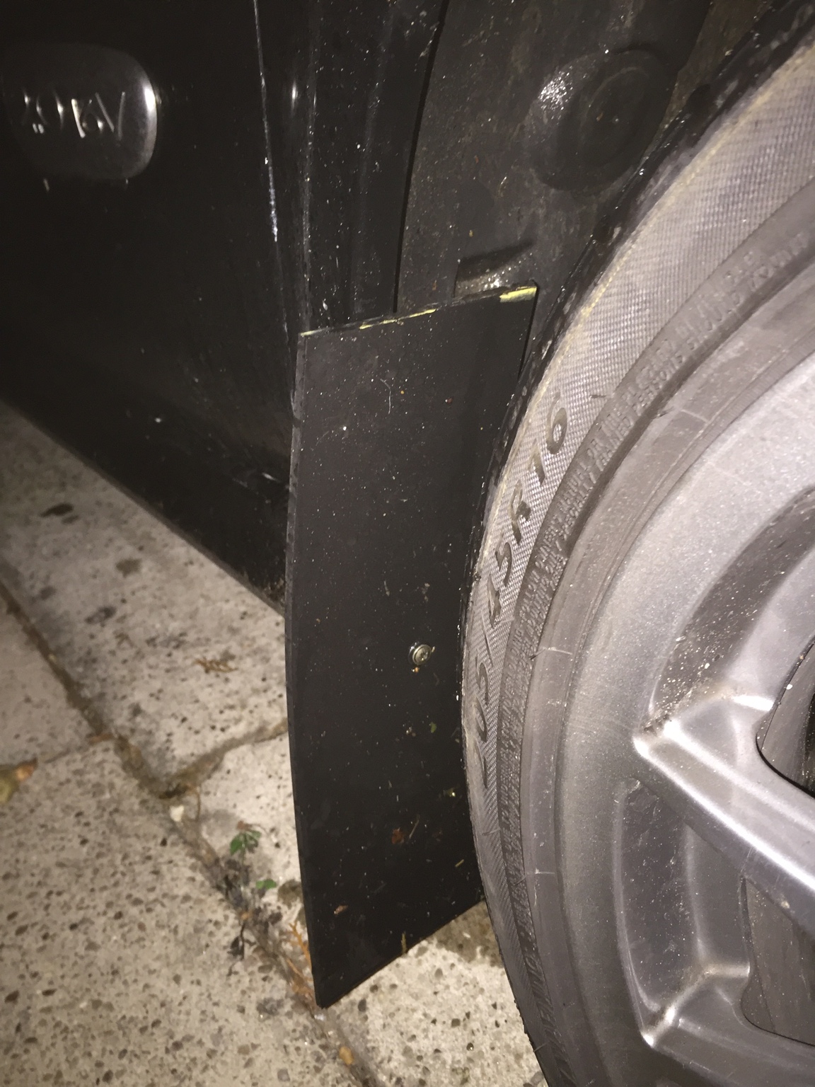

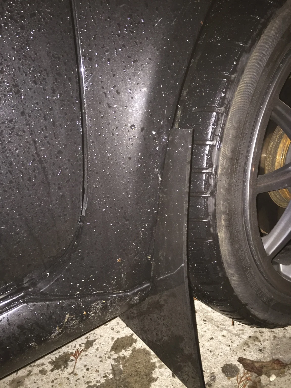

And the rest is easy, I did put an extra screw in just to hold them but they are very firmly on.
