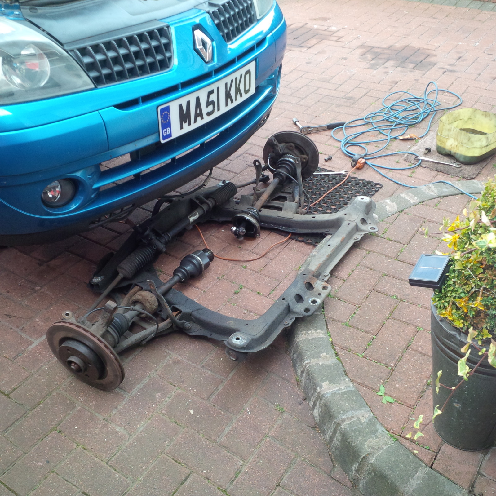

So managed to get all the widetrack bits on this weekend, didn't get many pictures cause I just wanted to crack on and get it done. Car drives so much better now.

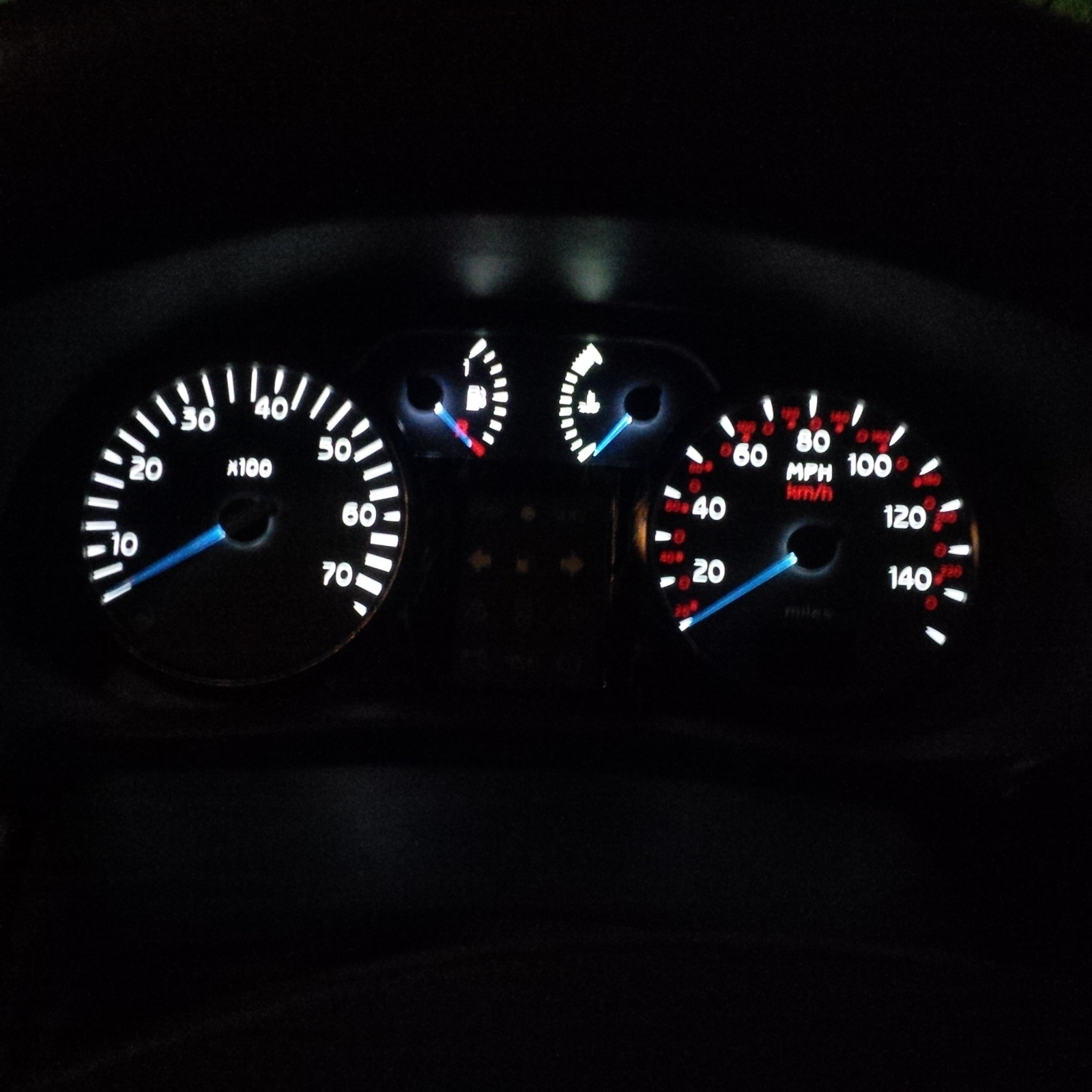

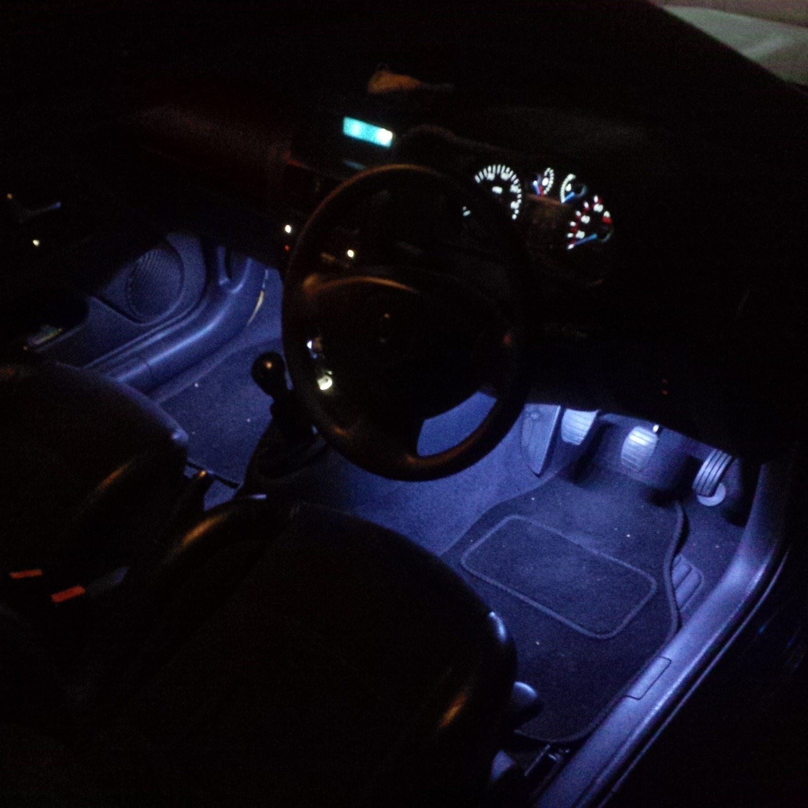

Also did a few interior bits such as fitting footwell lights and painting needles on the clocks.

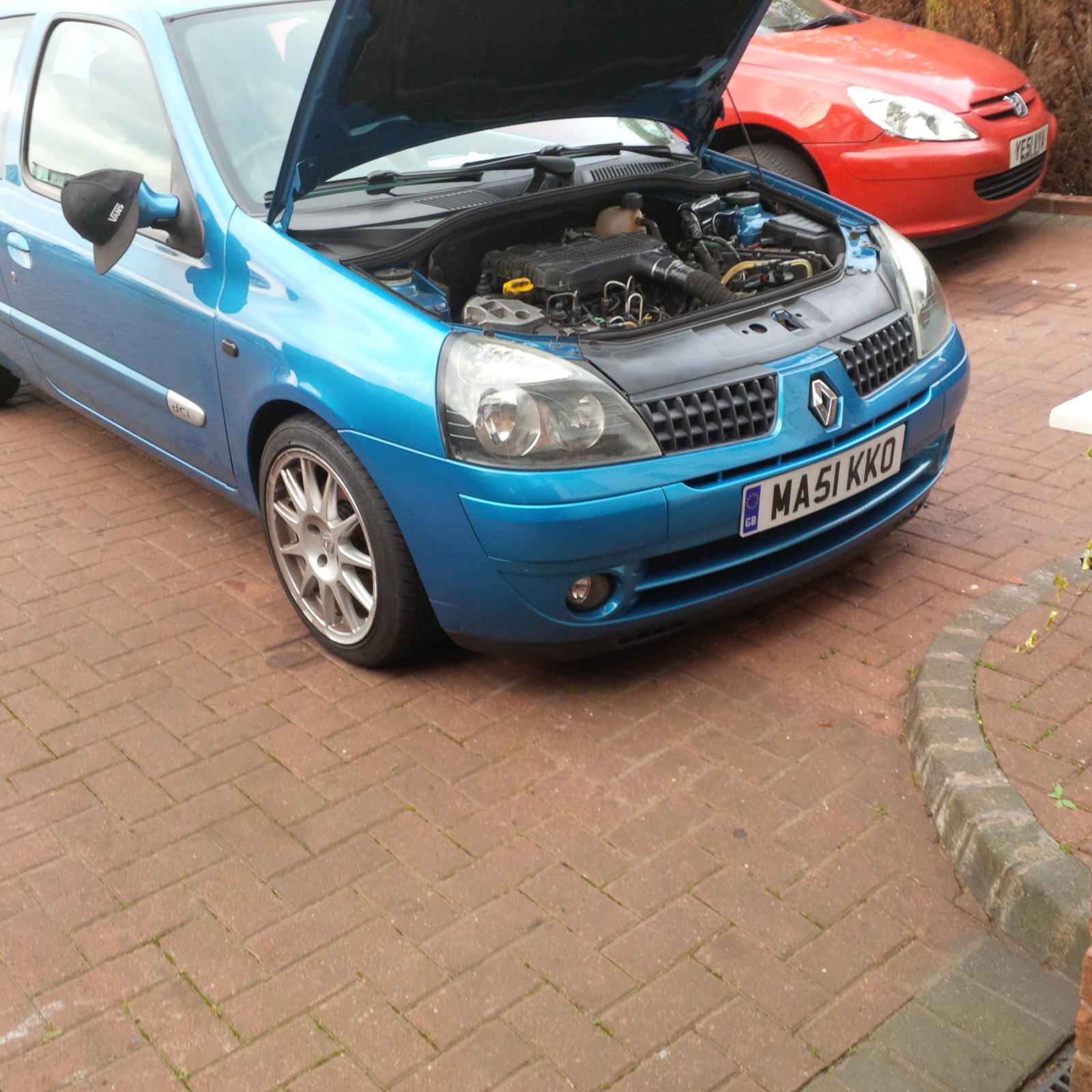

Haven't updated this in ages! Attended PFC expo which was really good thanks again CS team.
Car hasn't been running very well for a while now which was causing the eml light and stop light to flash when you put your foot down. In turns out that an injector was leaking back to much so replaced with a new one and now the engine is running a lot smoother.

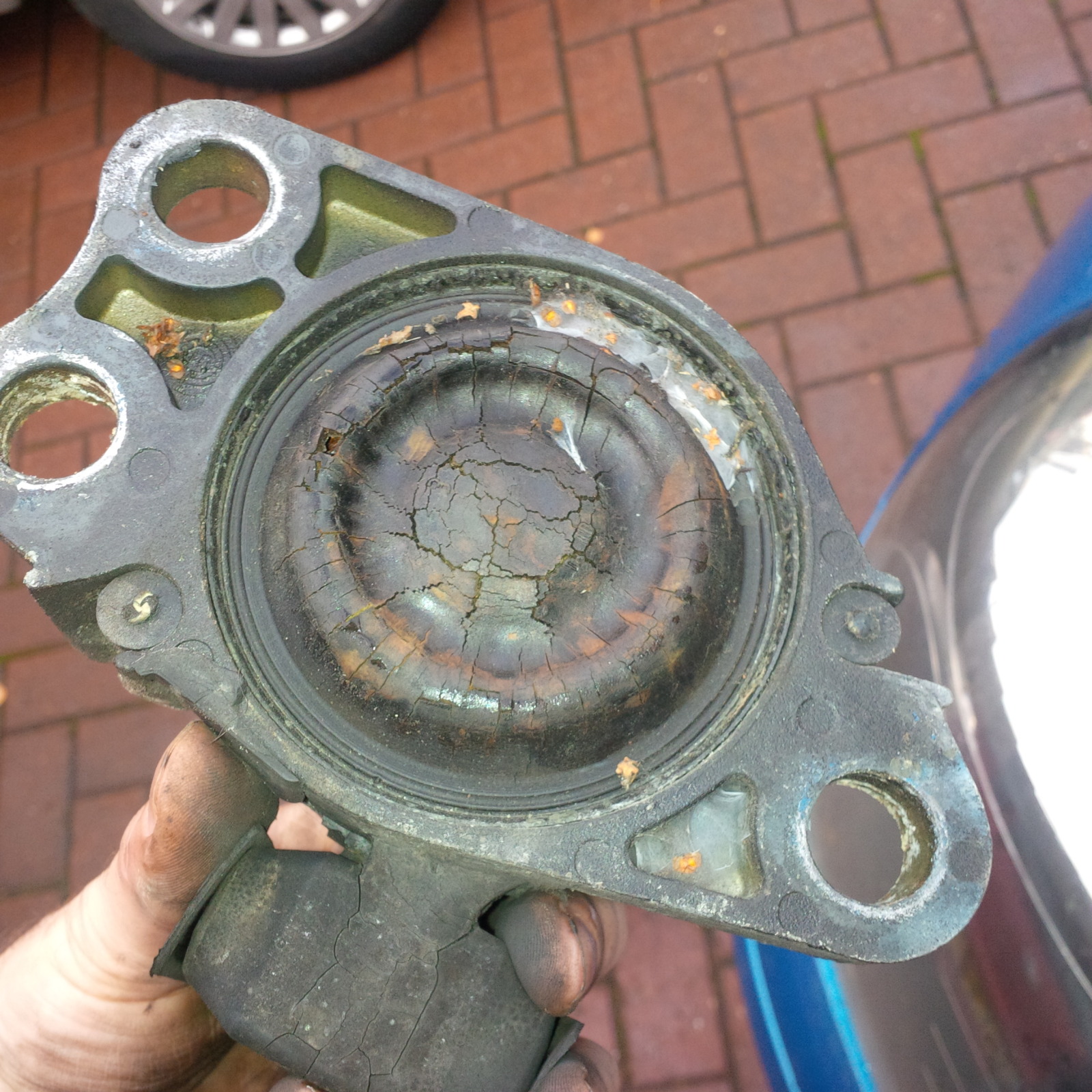

Still trying to find the source of the knocking on the front end, going to replace the engine mounts next month because there looking rather worn.

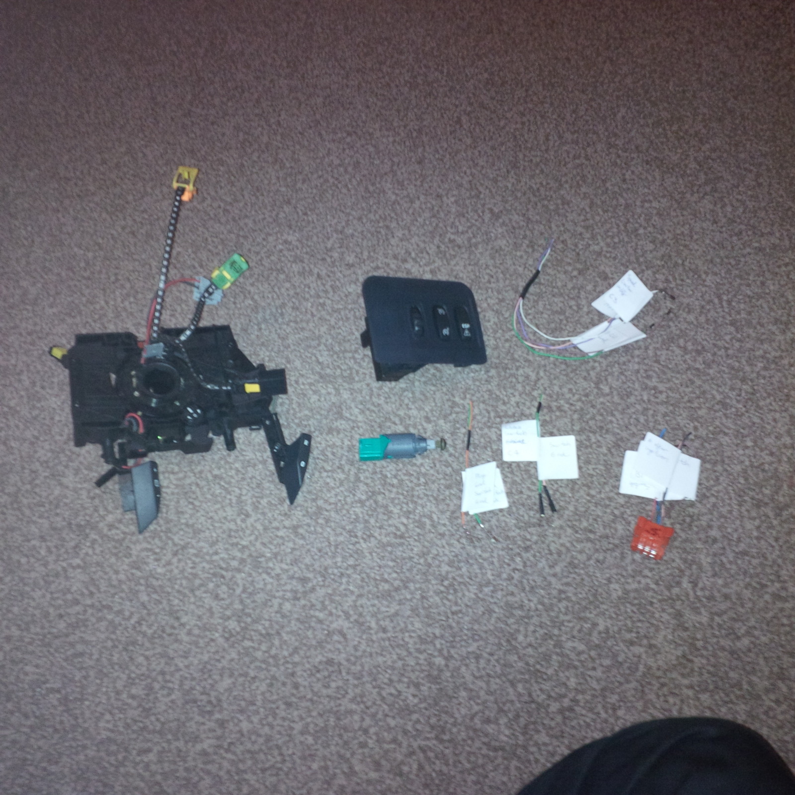

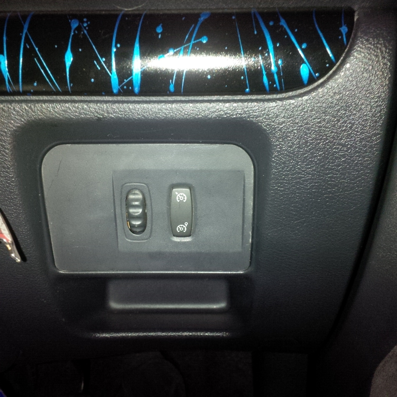

Found the problem with the cruise control too turns out the clutch switch was the wrong one, swapped it for a grey connector type and worked straight away. Bough another switch panel which was of a 172 with ESP and simply swapped switches over looks a lot better now.
As someone with a pre-ESP 172 with retrofitted cruise control with a panel from an ESP 182 with cruise control (aka. i have an ESP switch that does nothing and bugs me); why didn't I think of this?! You've literally made my night!
Car looks great. Widetracked non-sport is a winner. Got a mate running a 182 rep dci 65 with non-sport front axle and even with 25mm spacers it could do with a bit more.

I know what you mean people kept asking if it really did have ESP. Haha good to hear they can be picked up easily for £10, glad I thought of it now.
If he can find all the wide track parts cheap enough then it's deffo must to do feels like a different car with it all on.
