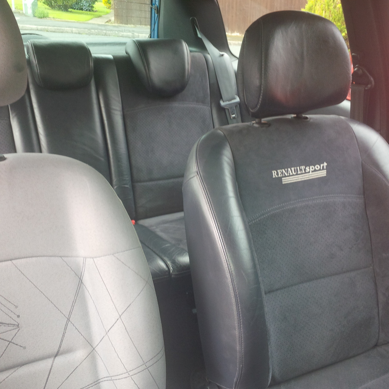

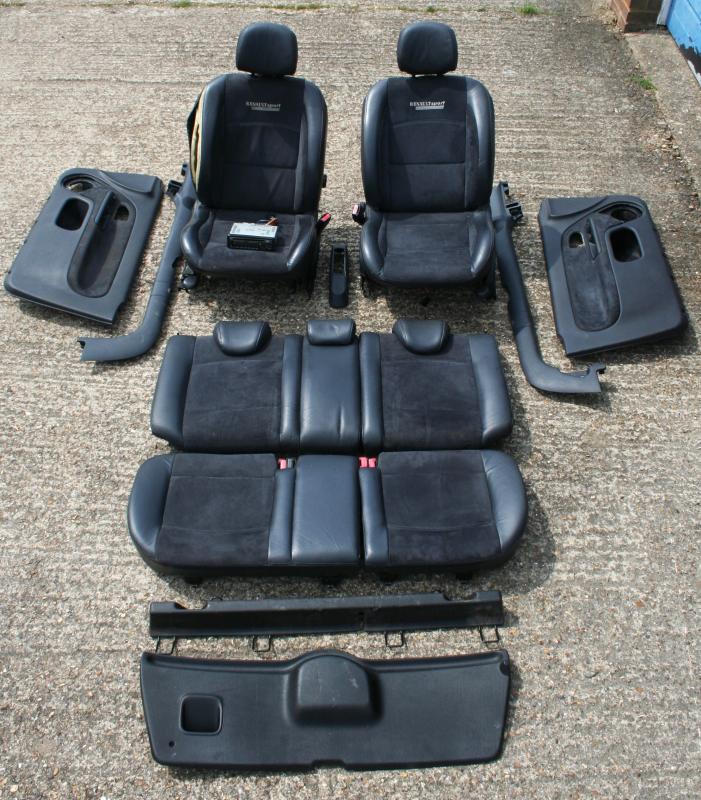

Picked the interior up from ph-reebone who also has a dci rep. Managed to squeeze all the interior in and get home and then the rain started!
Managed to get the rear seats in first which took a while because of the famous bolt that no one can undo lol. Then started doing the passenger seat and realised my connectors weren't the same as the ones on the sport seat so instead of waiting to get another connector. I tore the old seat apart and took the airbag and wiring out.
Now I'm just left with drivers seat which I'm currently sewing back together, all that is left to purchase is the rear door cards and some new mats.

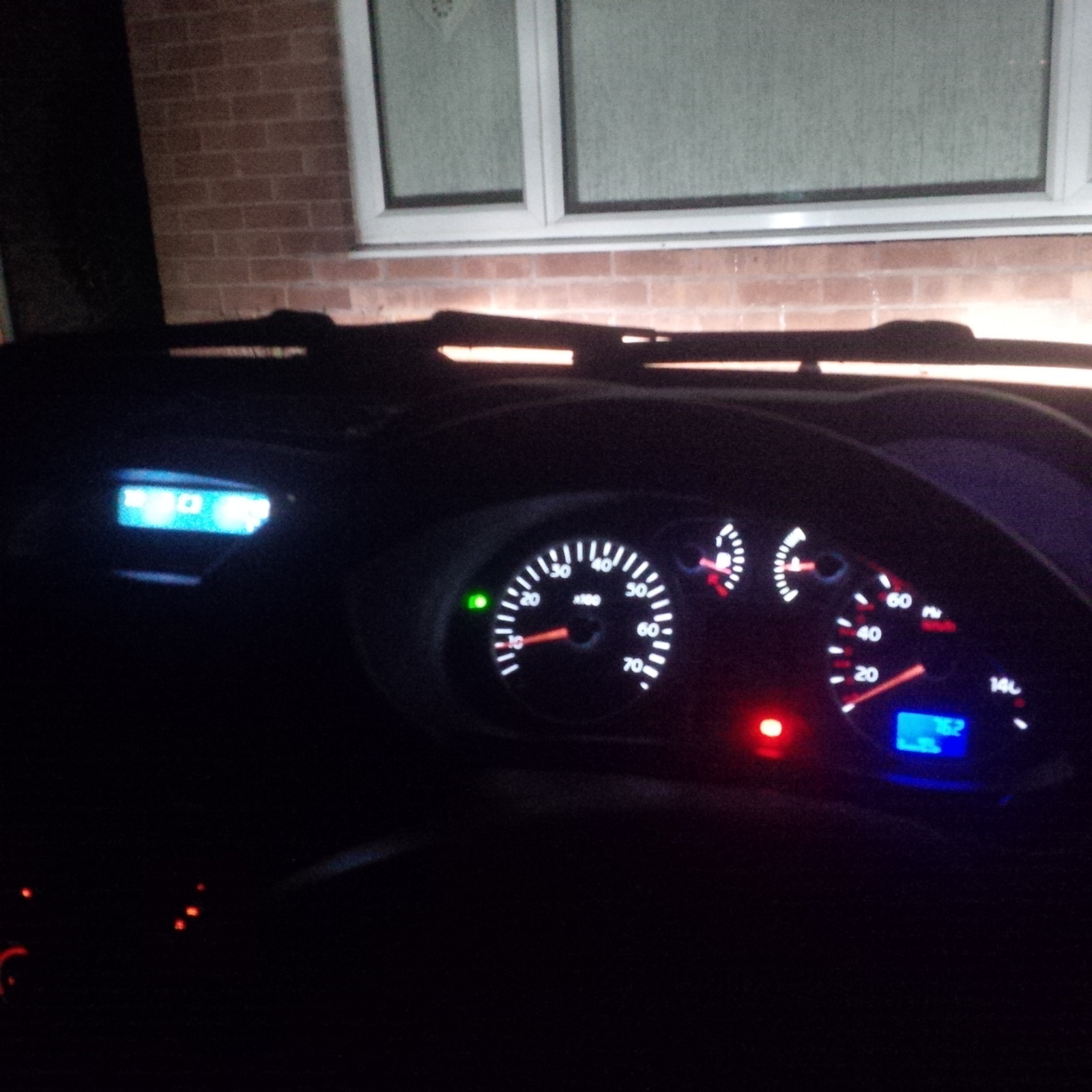

Almost finished my led dash conversion just got the cd player and heater control left, what bulbs do I need for the heater control panel?

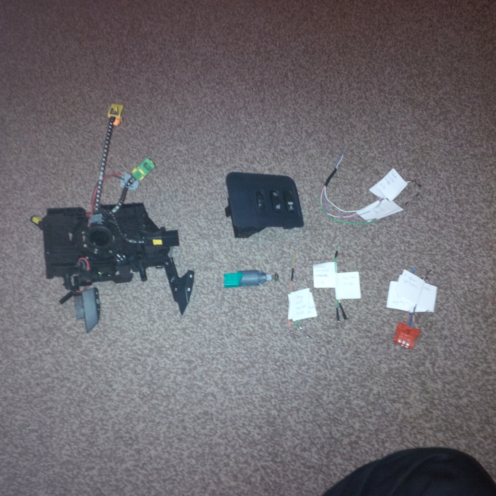

Been talking to GrahamS about cruise control and he kindly sorted me out some of connection and plugs out of his old loom, thanks again. Just waiting on the rest of the parts before I can start cracking on with it.

Dash looks good mate. Need to finish mine off still.

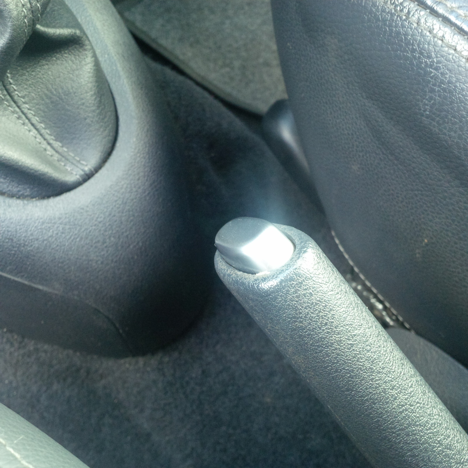

Also converted my CD player from orange to white and blue (pictures to follow when it's dark) and found a handbrake button at the scrapyard to match my door handles. It's the little things that count ;)
Should hopefully have cruise control fitted within a week or two and spacers for the rear
  Renault Clio DCi 65
Well I cut part of the handbrake just before it attaches of the one in the scrapyard. Then with my old I just used some grips and some cloth and it just pulls off then the new pushes on

PS I'm sitting in front of a load of cruise control wiring ready for tomorrow! my first ph3 conversion :S

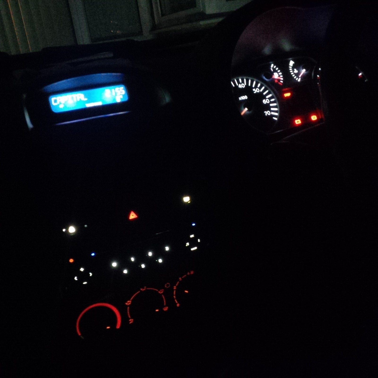

Finally got a picture of my cd player lights just heater control left which i'll do whilst I'm installing cruise control :)
GrahamS
  335d, GT4
ohhh that's cool. Really need to do mine. Are they all plcc-2?
Had a look at the window switches the other day and they seem to be a small bulb on 2 long wires.
  Renault Clio DCi 65
I think so, the guide on here tells you which. They have to go in backwards unlike the dash clock ones.
