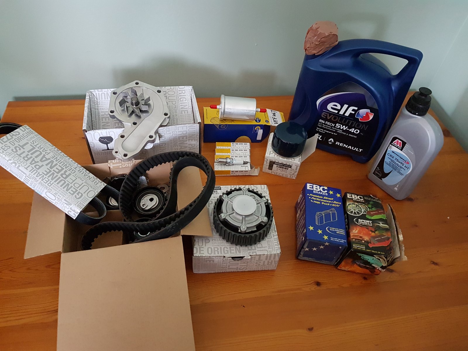

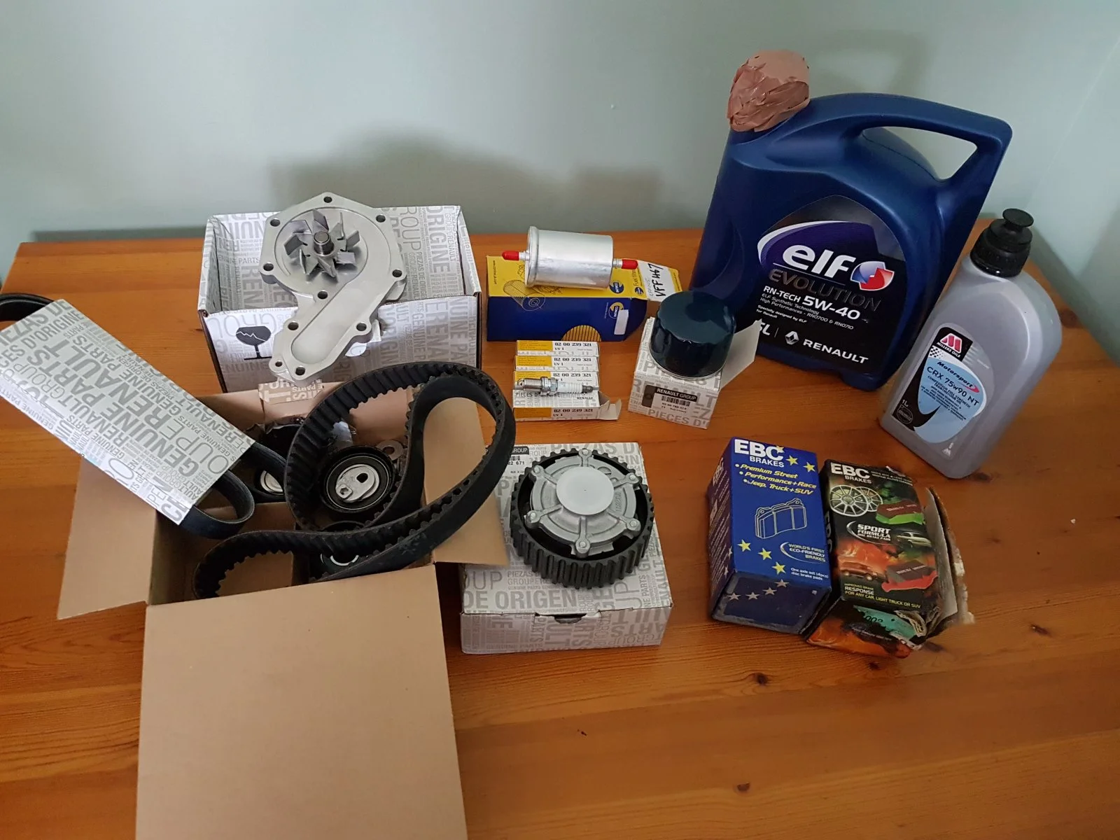

So the parts are now sitting in the parcel depot awaiting collection tomorrow and some time in the next week or two its going to Renault to get them fitted which will include-
Full cambelt kit, water pump, dephaser, aux belt, spark plugs, fuel filter, oil filter inc oil(elf fully synthetic), gear box oil and coolant.

Loads of gear going into the motor tomorrow at Renault.

Kano that's the first mistake taken the car to Renaut
Why not a specialist on here and also you supplied the parts which if anything happens to the car lwhat warranty will you get it bet none

As Mcdriftin mentioned, most reccomend you avoid renault dealerships for the belt changes, they also tend to charge too much.
At very least when you take it in ask them what locking tool they have and see what there response is.

Well the service manager runs a Renaultsport owners club over here and seems a lot of people use his dealership. As far as other specialists not exactly thick on the ground over here.
Buying the parts myself saved me over 150 on what they were charging.
Guess we will see what happens. Apparently they know the car too.

Well picked the car up and all good.
Got a full service and fluid refresh along with the belts, they also fitted a new pulley, to replace one that had a flat spot probably from a previous belt change, and a new map sensor.
The mechanic said the car is in great shape which is nice to hear.
Regarding concerns over warranty service manager said I have a full year on the parts as they were genuine Renault and if there are any issues bring it back and they will sort it.
Price wise I'm as happy as I can be considering, all in just shy of £700.

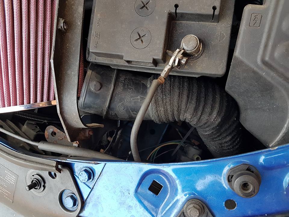

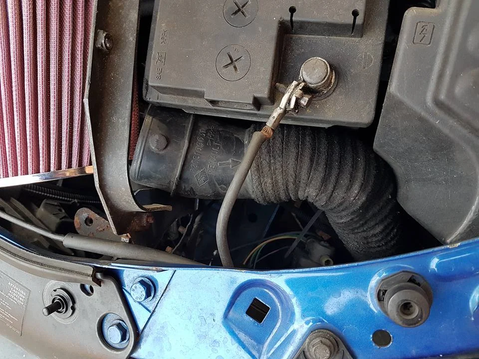

Quick question I have looked about and can't seem to get it straight in my head from any of the answers i have read.(duh)
The car came with a cone filter which i have replaced with one that i had new lying about the garage however everyone has told me to get a standard box back in. So i managed to get one at a reasonable price however it seems to be missing a hose, he one underneath towards the cabin.
There is a hose on the car that runs down behind the light(see pic) that fits the port on the front right of the box but my confusion is which hose is that? is it the cold air intake or the resonator?
I have read that the resonator isn't necessary, so if this is the case can i just seal up the port and install the box?
Do I have the wrong hose is that the resonator fitted to the car and i need the cold air feed hose?
If that's the case where does the cold air hose go once fitted?
