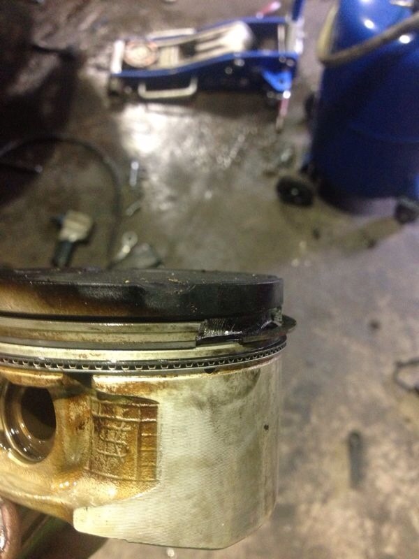

So minor update. The new engine I put in sadly was no better than the last, my own fault for not testing it before hand. So with less than 100 miles on it it came apart and I found this:

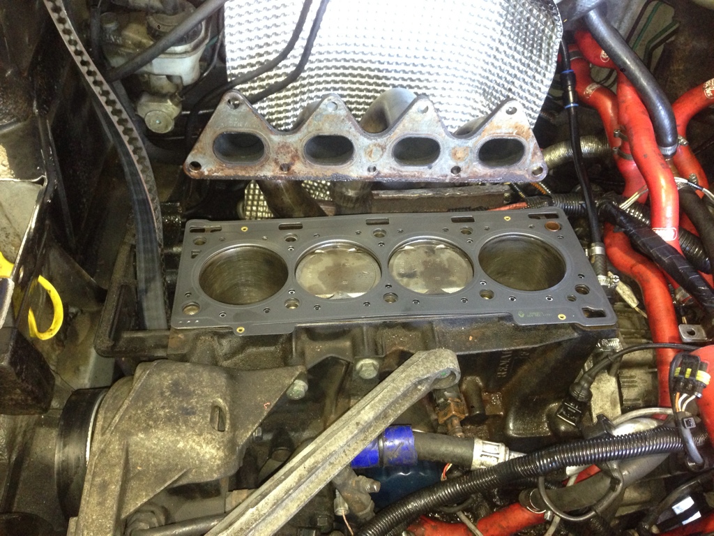

Ouch. That'll do it. So taken this opportunity to lower the compression slightly as it really didnt want to have any more than 15 degrees advance on ignition. I've done this by fitting a Megane 225 head gasket, and taken the opportunity to fit the ARP's from the old engine.

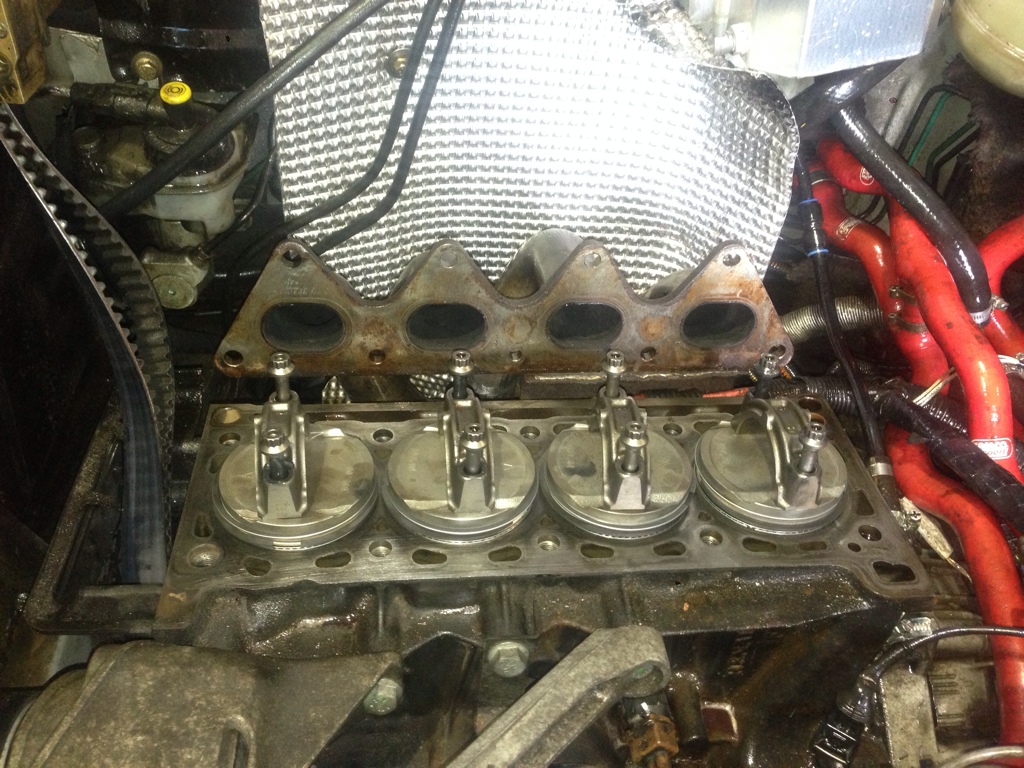

New rings, and pistons in the bores.

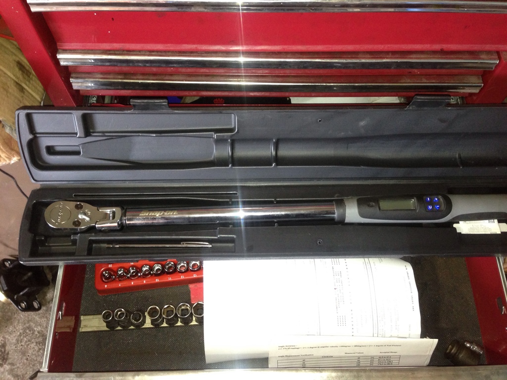

Got to try out my new toy too :)

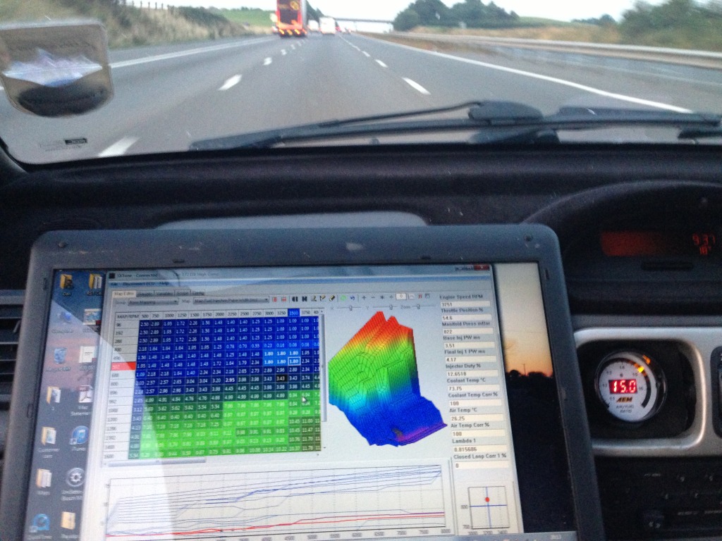

Don't know power wise, was pulling well, but hopefully with pistons in 1 piece it should go a lot better. As the rings(I thought at the time) were shot, I just used it as an opportunity to get the map pretty close. Got the AFR's pretty much 10.8-11.2 all the way through, and circa 14.7 on cruise. Just need to hire a rolling road to be able to get playing with IGN timing. Must say, in the passenger seat while I was mapping with my mate driving, it felt pretty brutal.

Well, covered 300 miles since the rebuild now. Feels awesome, went and did the mapping last night, had a mate driving it and he was loving how well it drove.
Have aired on the side of caution on the ignition side until I can have a set of det cans to use. I'm only seeing 15 degrees at WOT.
