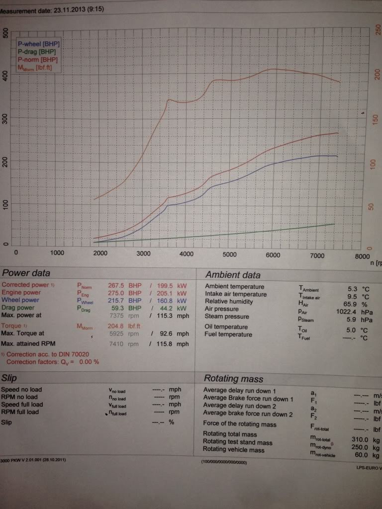

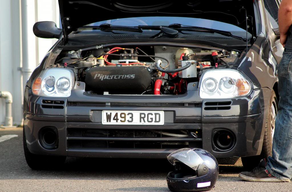

So, did Bedford a few weeks ago. Trailered the car up there for 2 reasons. My back, and my hearing. Car performed faultlessly,'only issue being the lack of grip. It's now back up to standard compression, to do destructive testing to see how much a standard bottom end can take for my turbo conversions. At the moment it's running 10psi at 7400rpm.
A few pictures and videos.

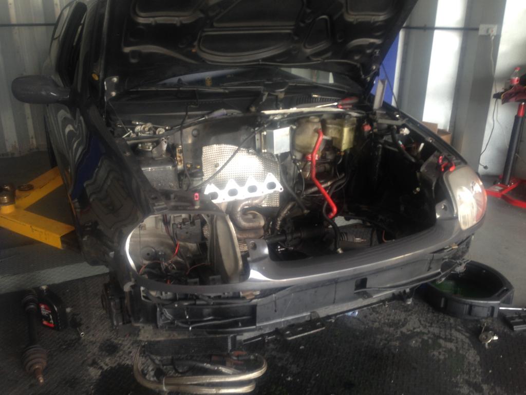

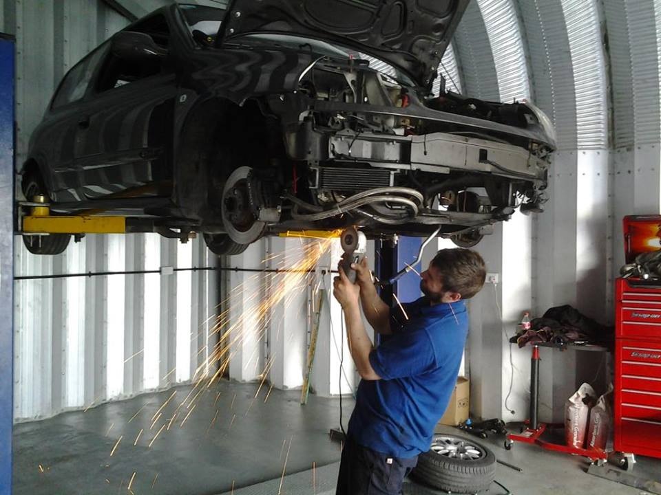

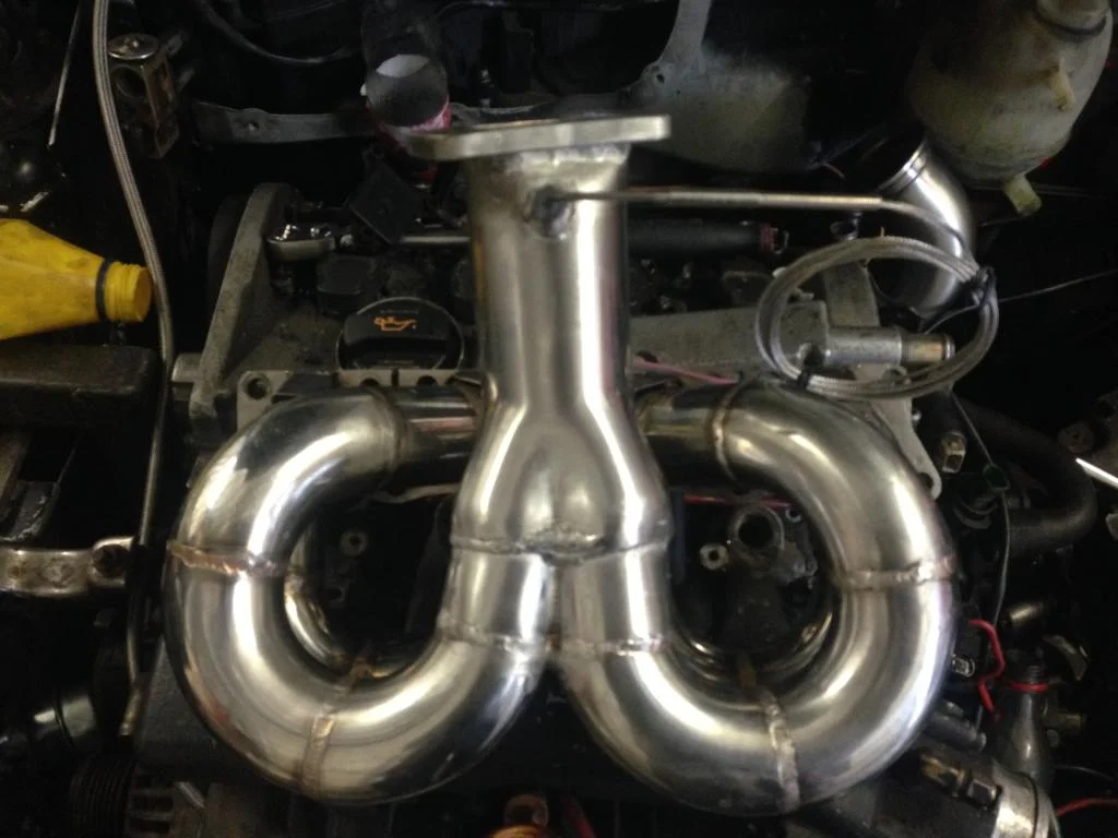

So with the rotrex deciding to s**t itself at the weekend, I decided more power was to ensue.
And a bit more.

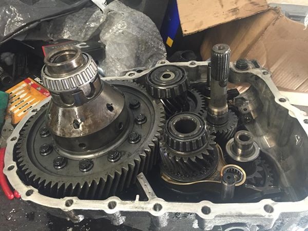

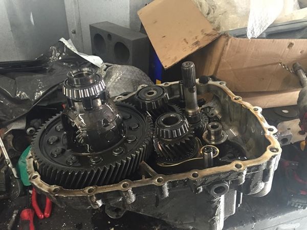

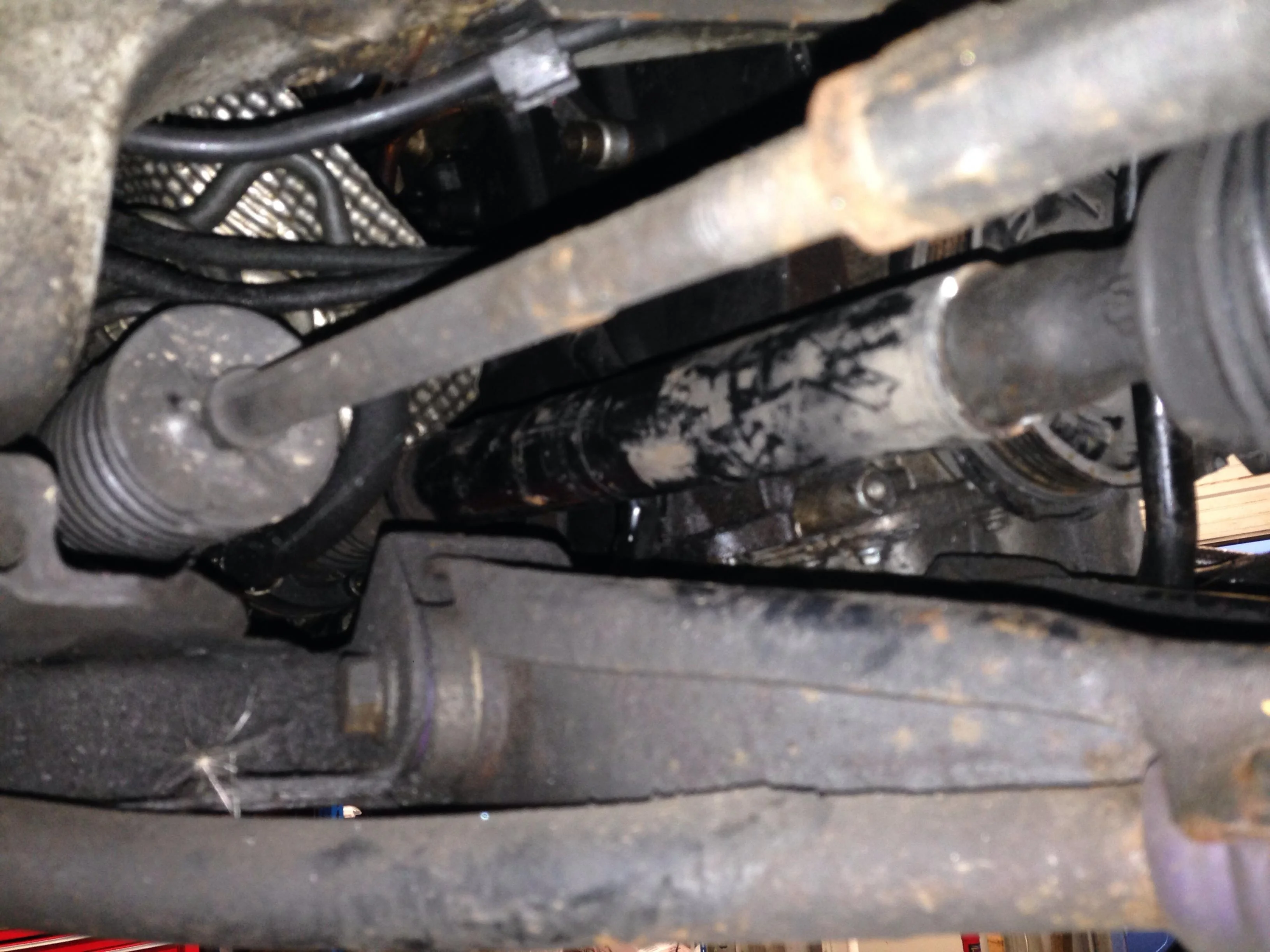

Left me with this:
Which was then filled with this:
Just need to finalise the mounts and the shafts. Then decide on what turbo.

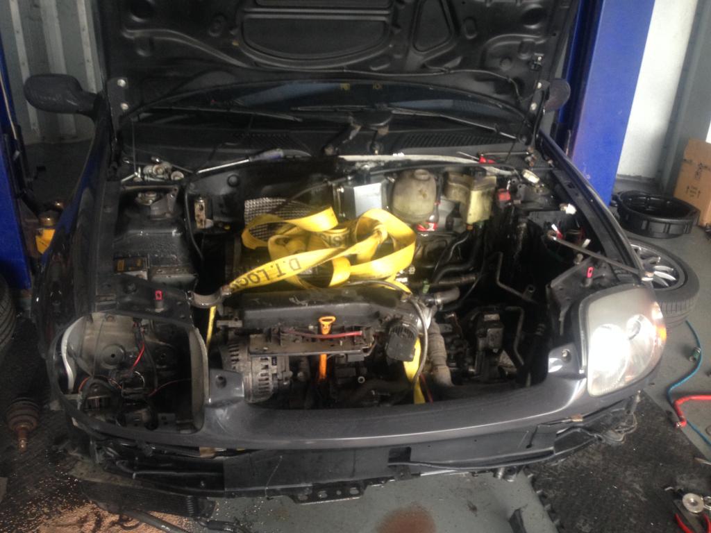

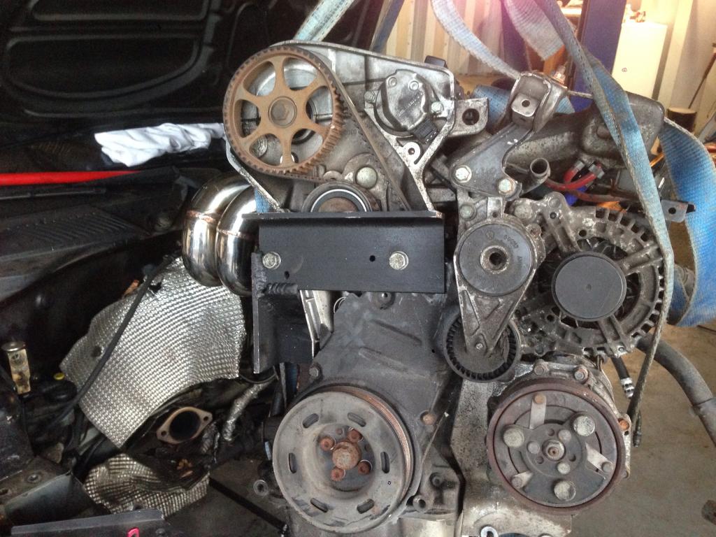

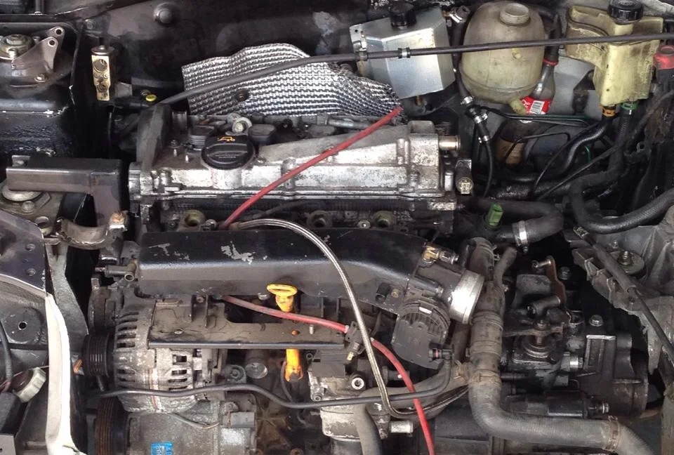

Well little bit to update..

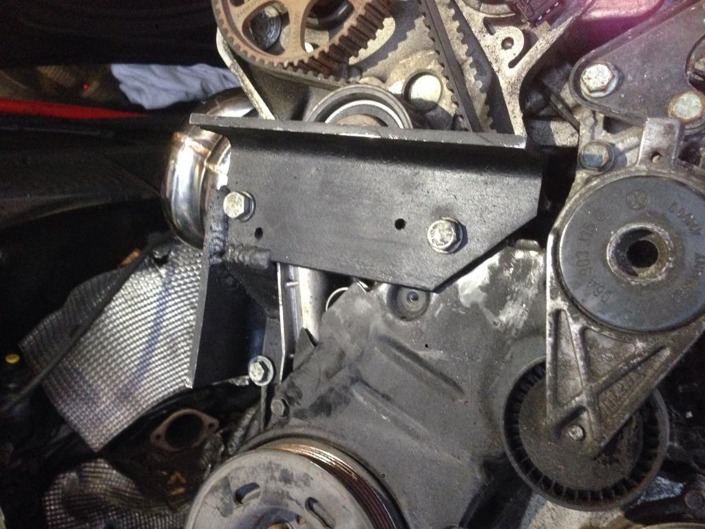

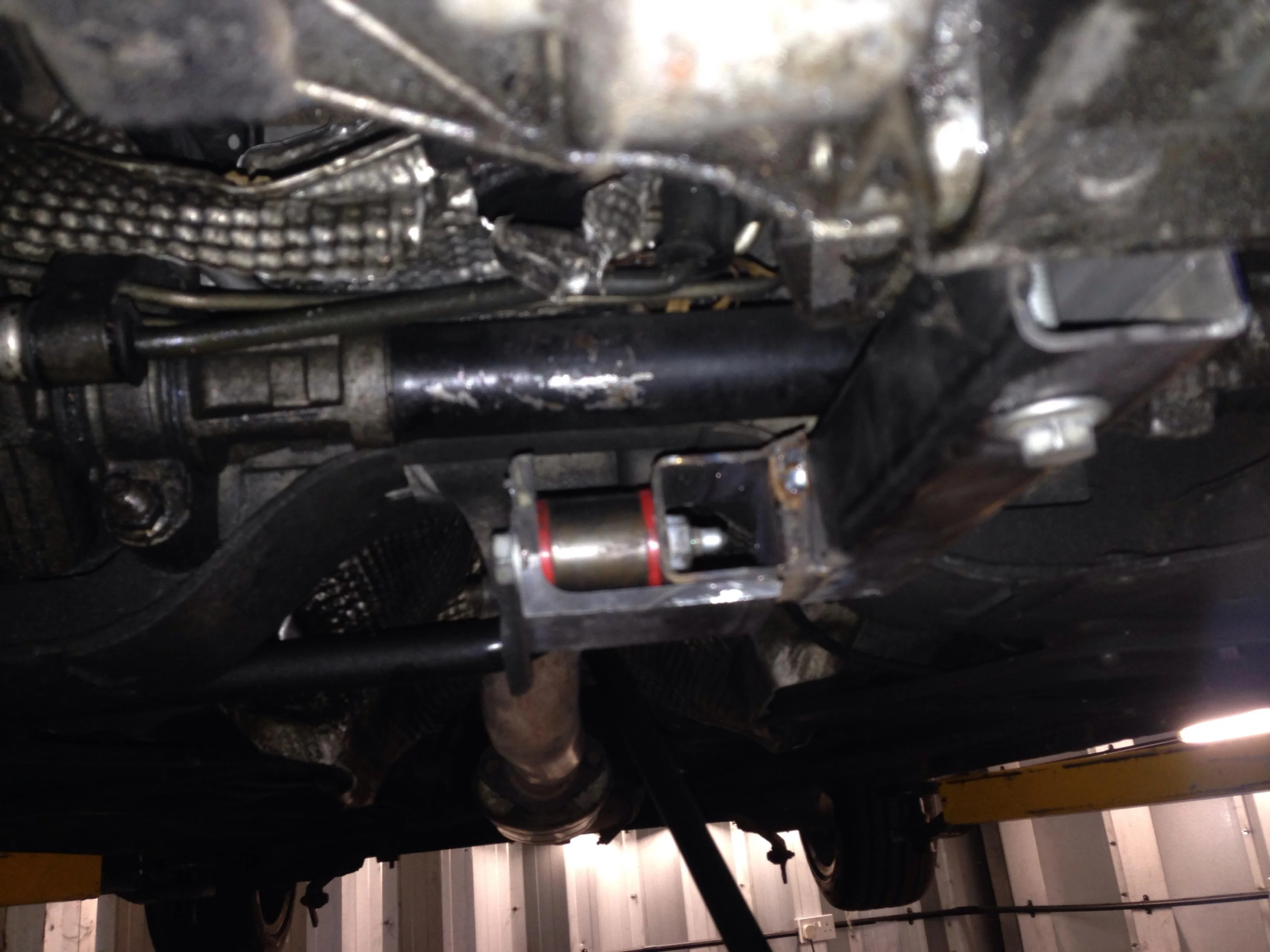

It's in and mounted.

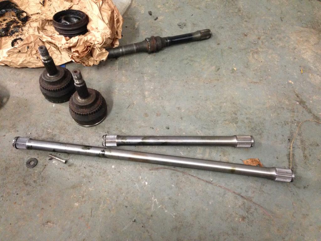

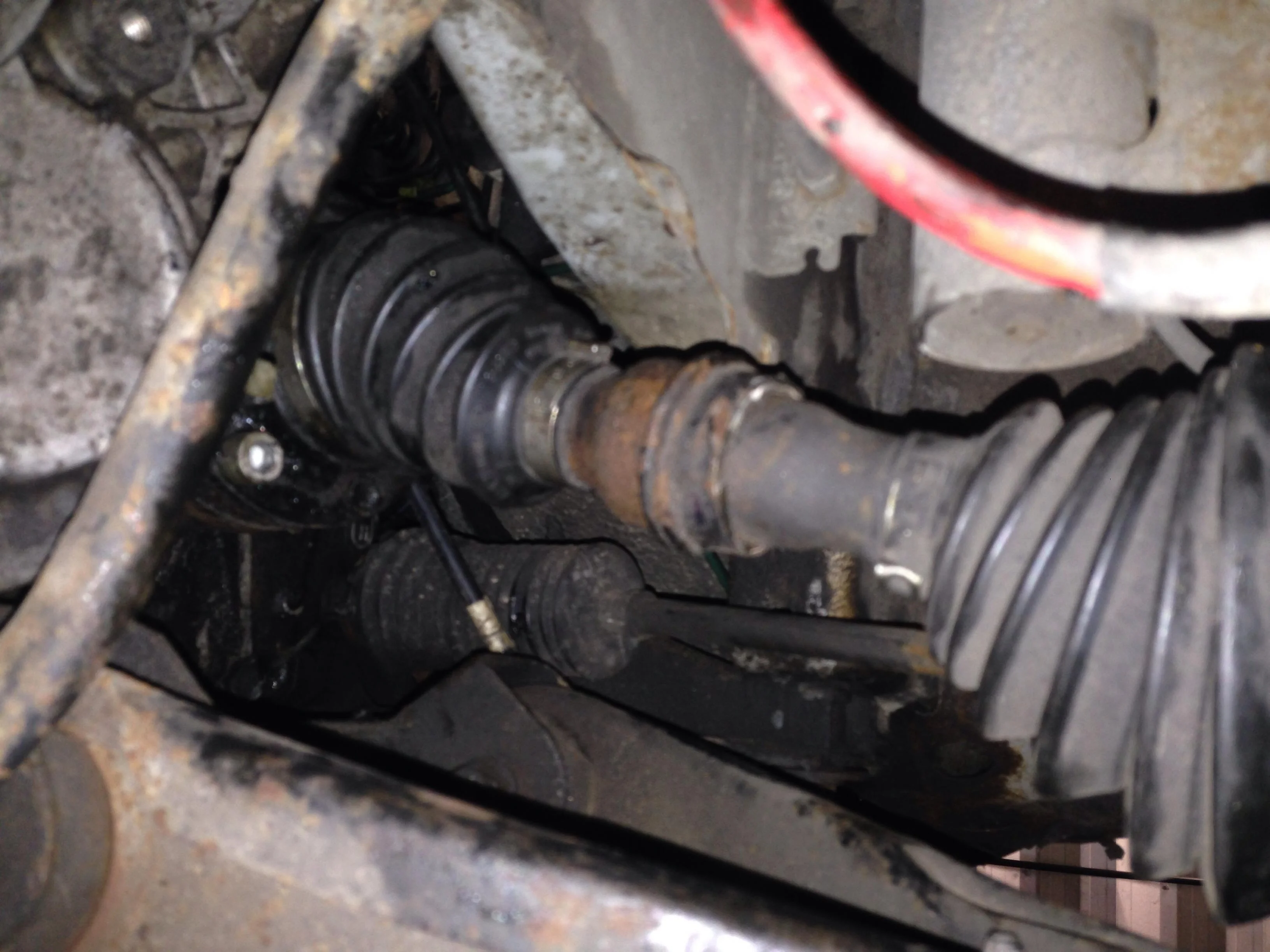

And driveshafts mocked up.

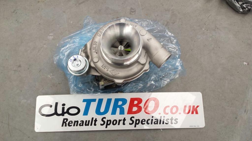

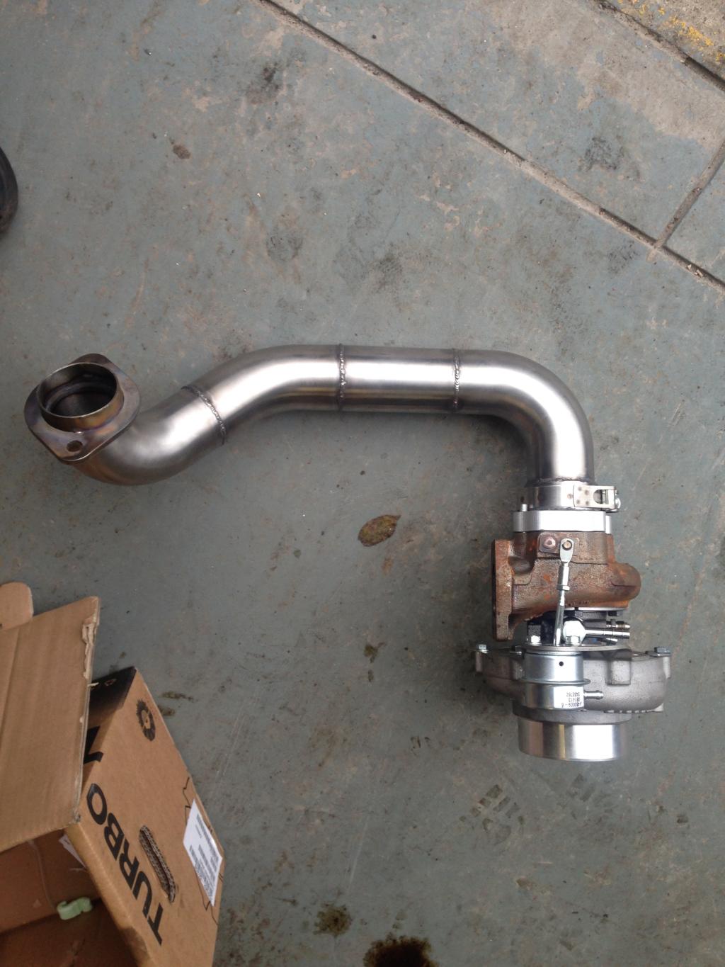

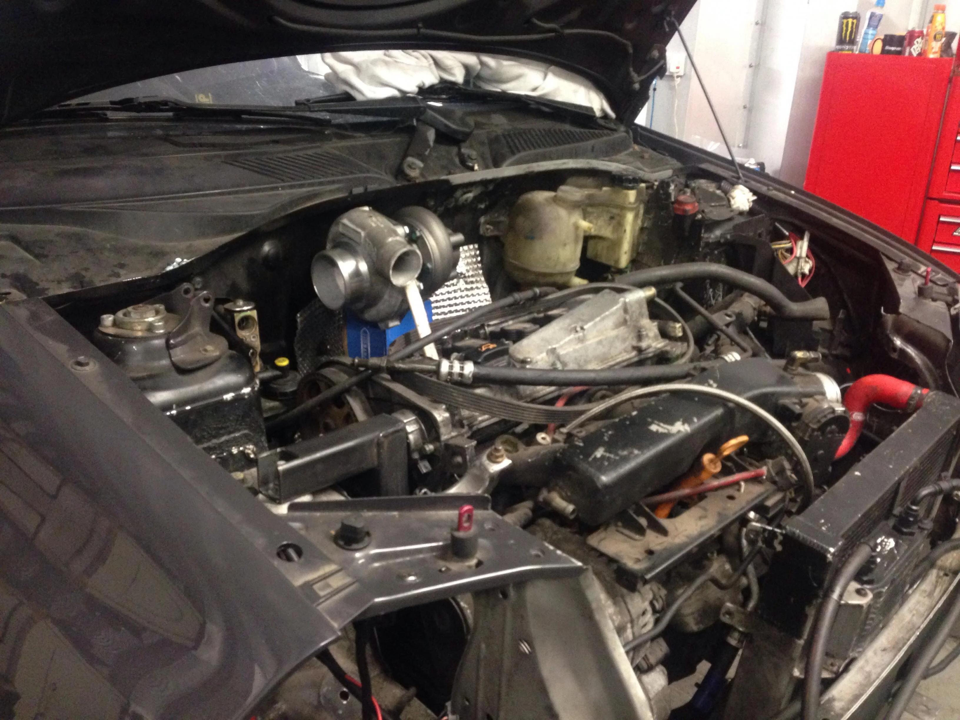

And had a look at getting the turbo position worked out. Will be a GT2860r I think, as pictures here. I may go 3071 if I'm feeling adventurous.

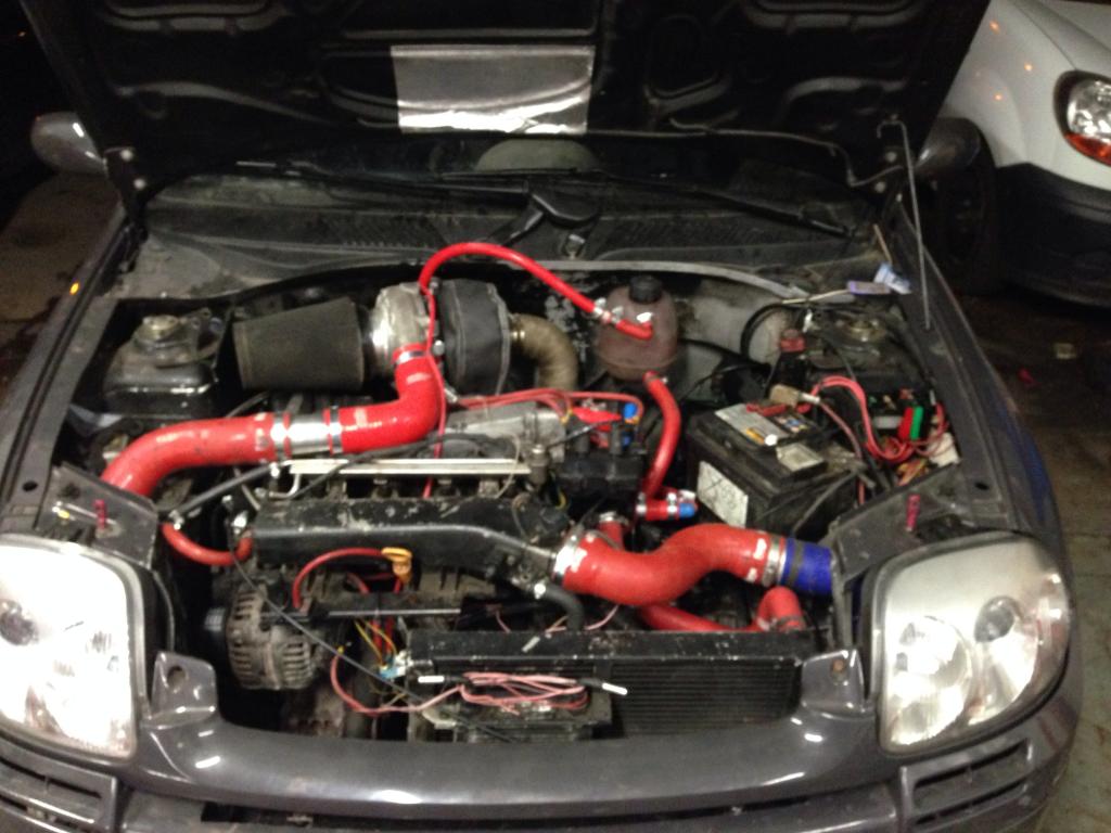

Did a bit of wiring, and this was the result:
Doesn't sound too bad for an engine that hasn't turned a degree for 3 years.
Nice To hear it crank and see that it's registering crank signal.

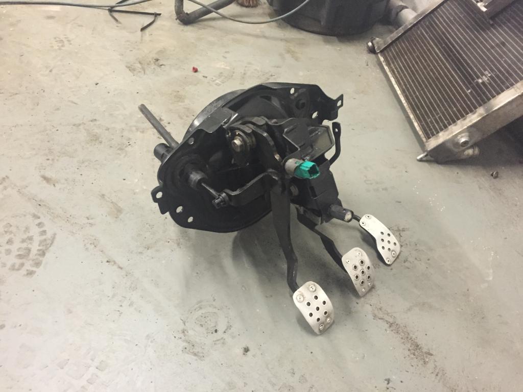

DCI 100 pedal box
Blower ordered from clioturbo, GT3071r with a 4" inlet.
