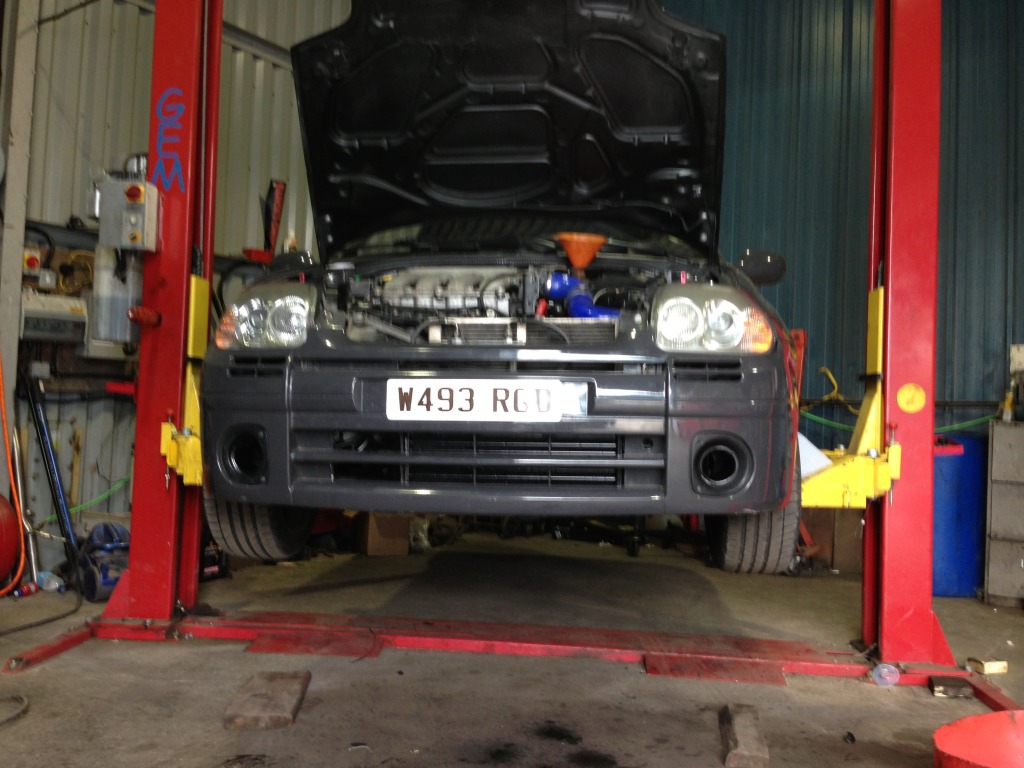

Leaking radiator tigged, and intercooler and piping has gone back to black.

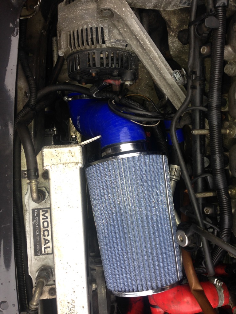

So, after chasing an issue that it wouldn't supply any more than 8psi, I was out doing some ign mapping and found that I started to loose even more, at one point it couldn't give any more than 4psi. Quick look under the bonnet had found the air filter was collapsing on itself just revving it, letalone at full chat.
New setup made, but it's only temporary until I relocate the battery to move the filter to a more temperature friendly place. Since fitting it I'm now seeing 10psi, and I've had to at 7.5% more fuel to the higher load sites so it's certainly getting more air, so hopefully more power!!
