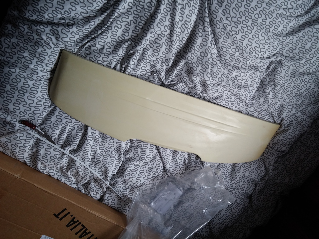

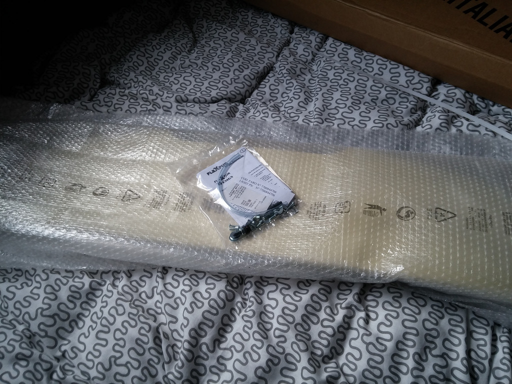

The V6 rep spoiler from Italy arrived.
Looks like a great addition to my bed lol
20141122_121137 by dann2707, on Flickr

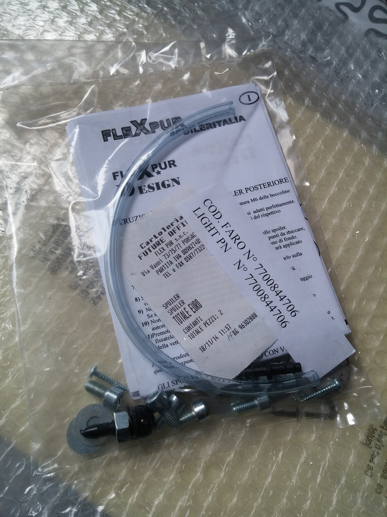

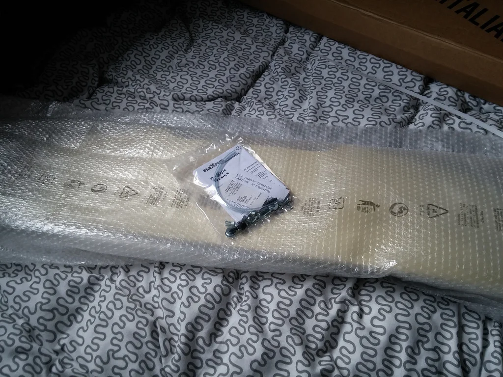

To my surprise it came with bolts and the new rear screen washer and pipe and also fitting instructions!

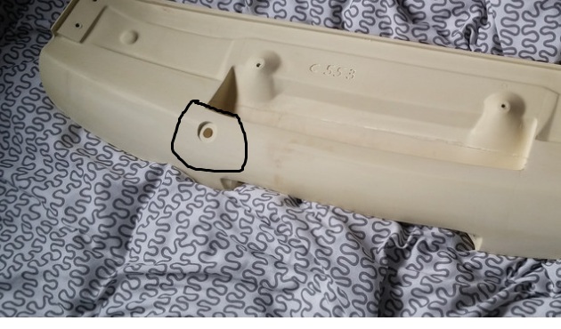

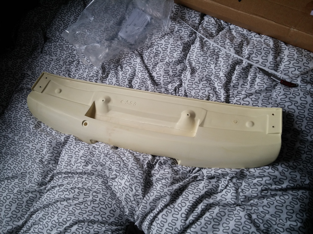

The underside
20141122_121337 by dann2707, on Flickr
The topside
20141122_121348 by dann2707, on Flickr

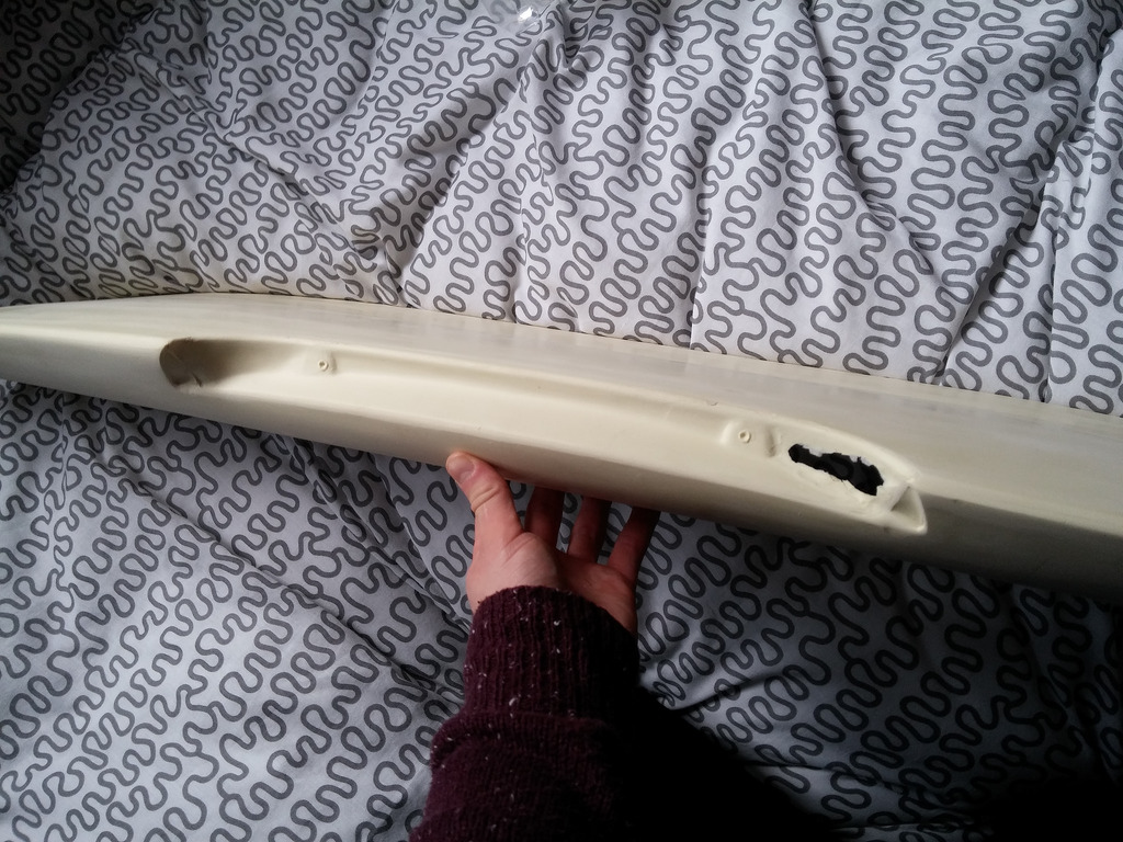

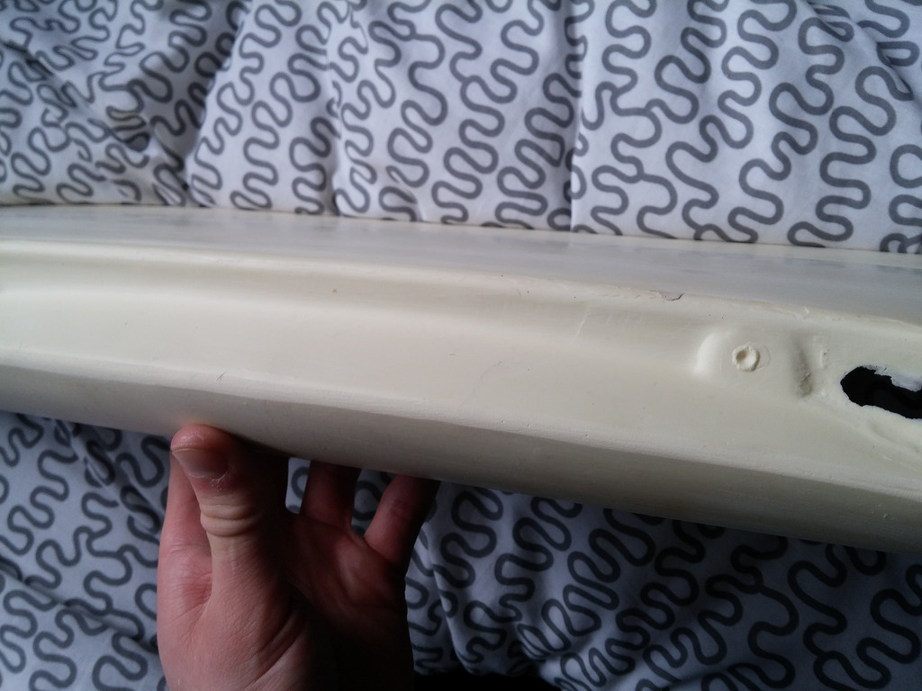

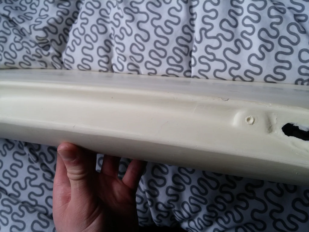

This is where the brake light goes, the little dimple to the right (might even call it an inverted nipple for the lols) is the location of where you are to drill a pilot hole for the brake light. It's there for a reason.
20141122_121419 by dann2707, on Flickr
And the bigger cavity is for the brake light connector to fit through, this was filed down so that my brake light fit through.
20141122_121422 by dann2707, on Flickr

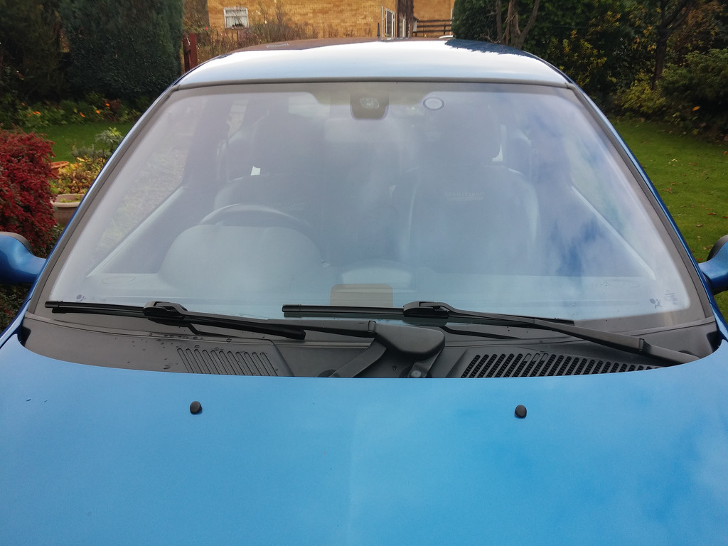

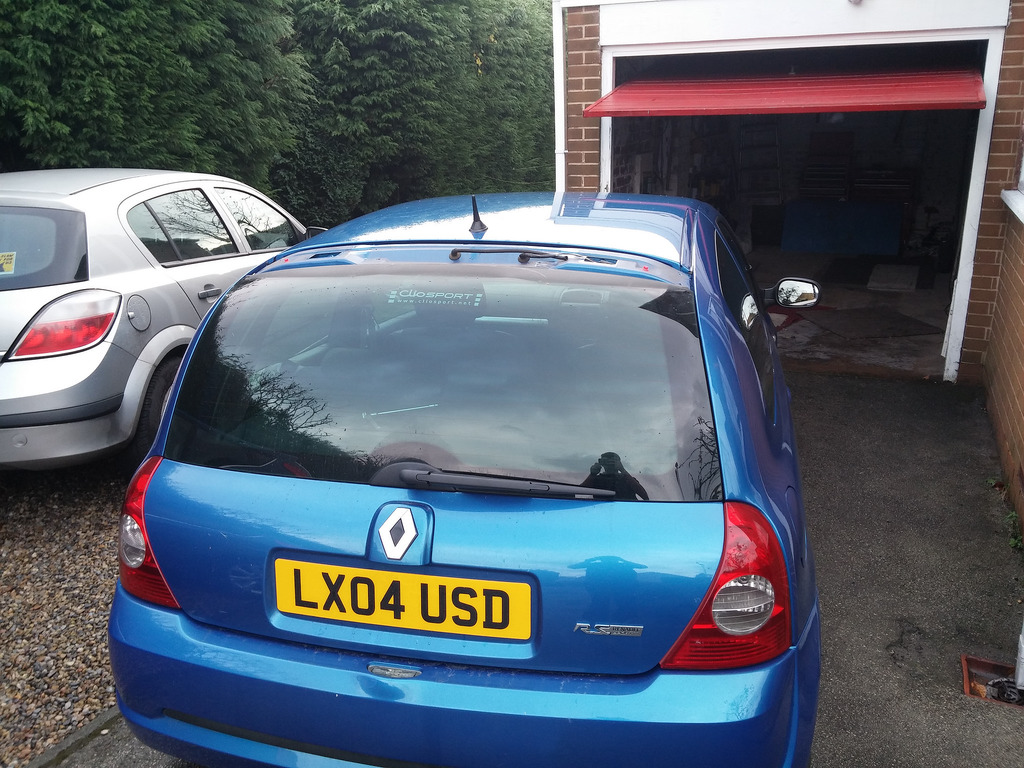

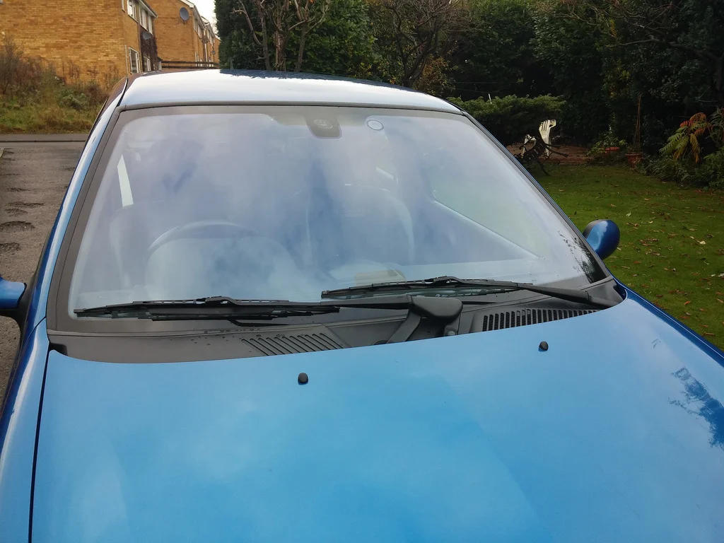

My new windscreen wipers came. They're genuine Bosch flat ones which I got from the bay
Before:
20141122_122220 by dann2707, on Flickr
After:
20141122_122433 by dann2707, on Flickr

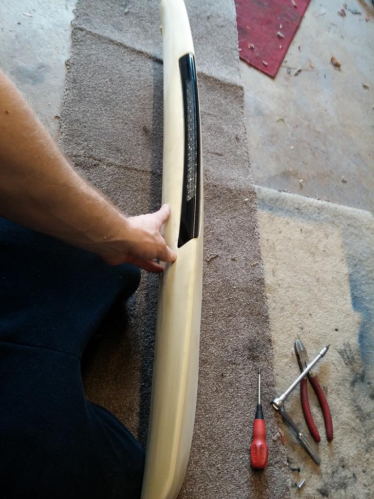

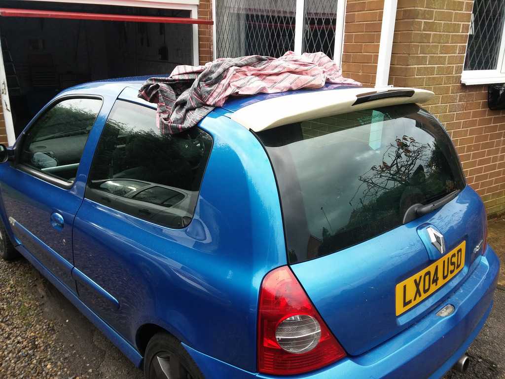

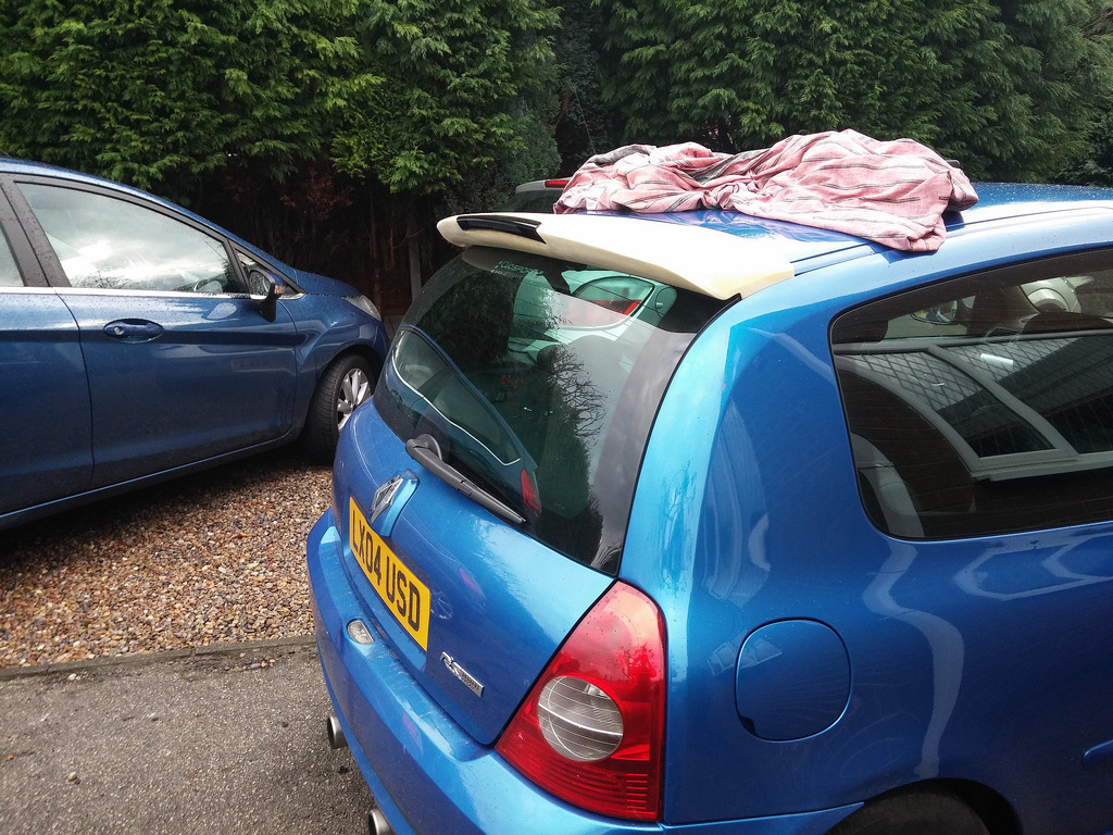

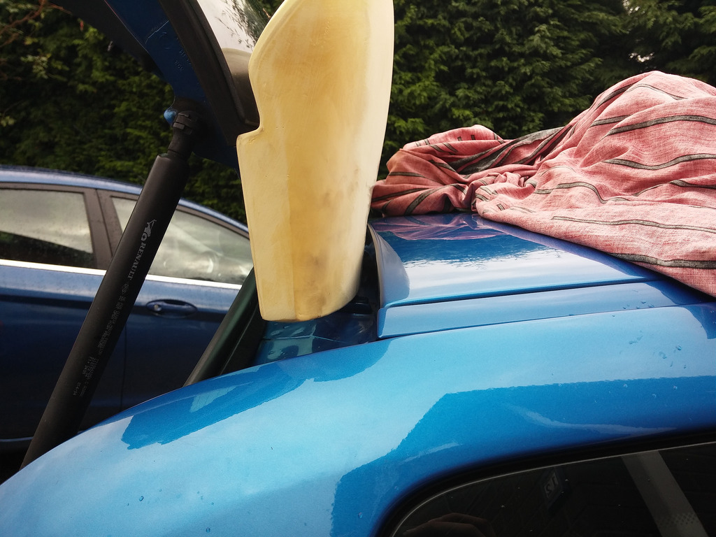

I then started removing the old spoiler to test fit the new one before painting. Spoiler off!
20141122_123444 by dann2707, on Flickr
Fitted my original brake light.
20141122_125631 by dann2707, on Flickr

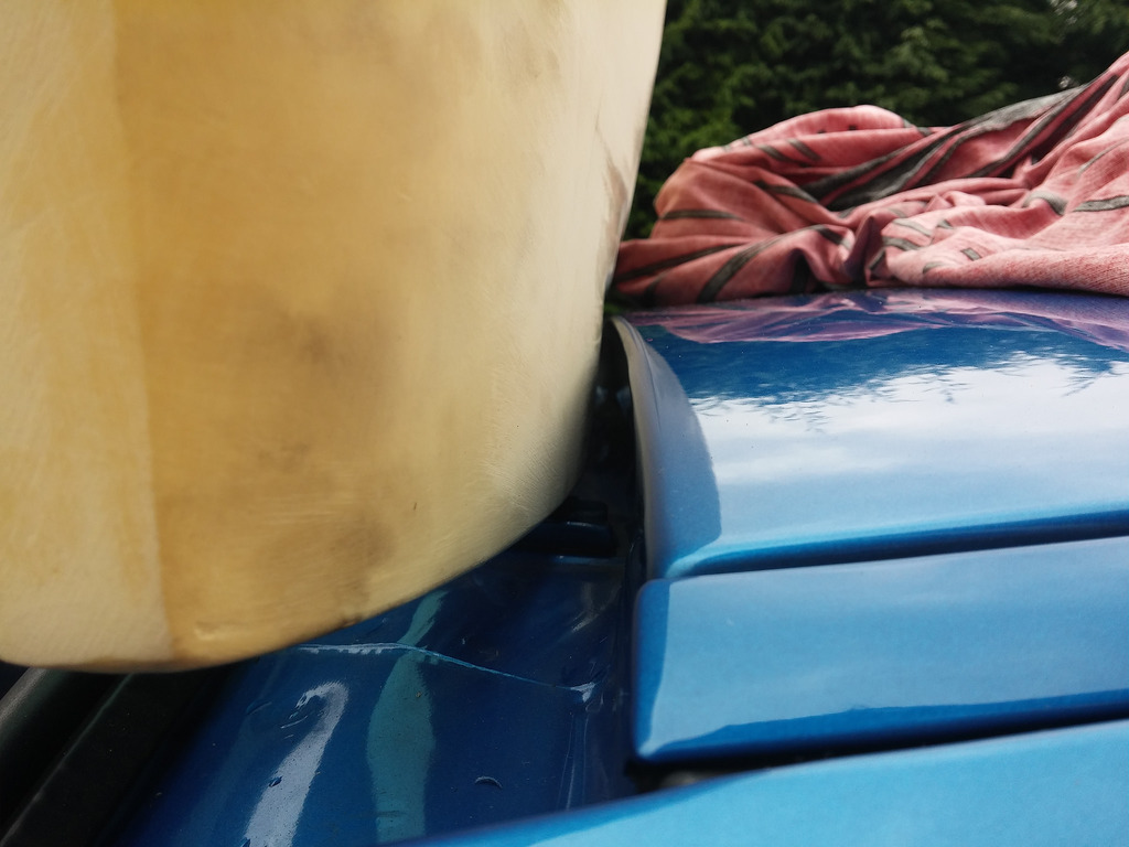

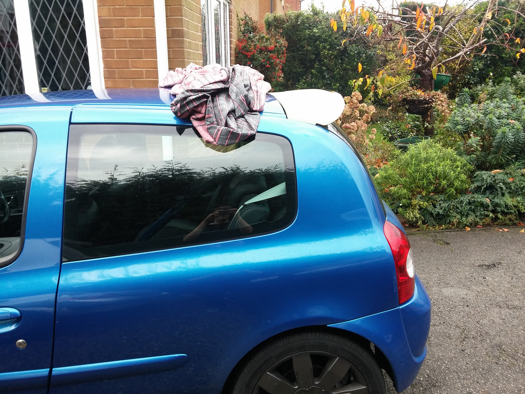

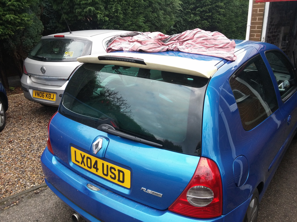

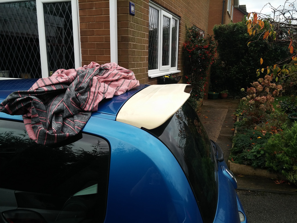

And on the car. I didn't do it up tight so it looks like it doesn't fit flush but the bolts are on baby tight. Reason for doing this is just to make sure everything lines up correctly as i'm not going to want to faff around marking and drilling new holes once it's been painted. Good job I did this.. later pics will show.
20141122_131014 by dann2707, on Flickr
20141122_131021 by dann2707, on Flickr
20141122_131033 by dann2707, on Flickr
20141122_131037 by dann2707, on Flickr
20141122_131044 by dann2707, on Flickr
The best thing about it is that it doesn't catch the roof like the proper renault V6 spoiler does which requires shorter boot struts, the final price of the renault spoiler and boot struts comes to £515!! :O
20141122_131100 by dann2707, on Flickr
20141122_131103 by dann2707, on Flickr
And my biggest complaint with the spoiler is that the middle two bolt holes do not line up with the cars original holes. Not an issue as i'll just mark and drill new holes there but still, you'd think they'd line up.
20141122_131130 by dann2707, on Flickr
20141122_131134 by dann2707, on Flickr
Overall i'm impressed with the spoiler for the price I paid £73. The quality of it isn't fantastic due to it being fibreglass and having a few manufacturing marks but i'm sure once i've sanded it down, keying it for paint it will look great.
Really happy with it and I think it's going to transform the rear end completely. Thanks for reading

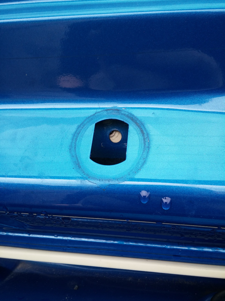

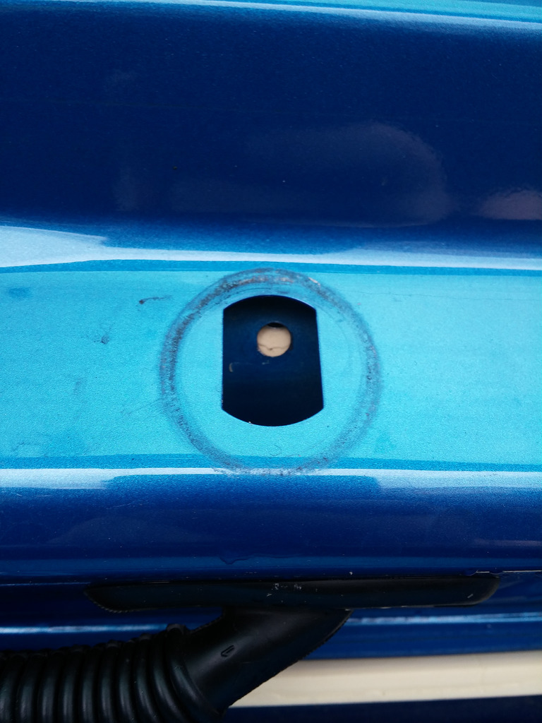

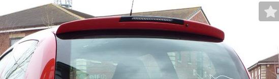

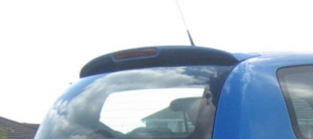

Two things I noticed that Im going to change :
The pre cut water nozzle hole is in the wrong place, its here on a trophy:
And Im not 100% sure on the two lines along the top of the spoiler - I guess they have to be there to stop it catching when you open the boot. I cant find any pics of trophy spoilers so perhaps they are like that on the original spoiler.

That's actually a really good point, where the f**k is the hole for the washer jet on this spoiler?! hahahaa
Haven't noticed a hole!!
Yeah I mean, the two lines are apparently to stop it from catching and it sure is close when lined up! Was thinking what would happen if I smoothed it but it will most likely catch.

Oh... whilst i remember when you test fitted it the little red plastic clip things that are on your car (to help align the spoiler) might need to be removed as I saw in the image above that there is no alignment hole that they fit into. On the pic i posted above look at the left where the two mounting screw holes are - to the right of that is the raised spot where the little red clips are meant to slide into but there is no hole.
  CLIO 182
Doesn't look too shabby mate!!! Yeah first thing I noticed was the lines on top and was wandering if you knew about the gas struts as you hadn't mentioned it! Now that I've seen it mocked up I genuinely think I prefer the slightly smaller cup one, as that looks hauuuuuge lol I think it will look a lot more tasteful when its painted!
