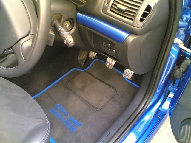

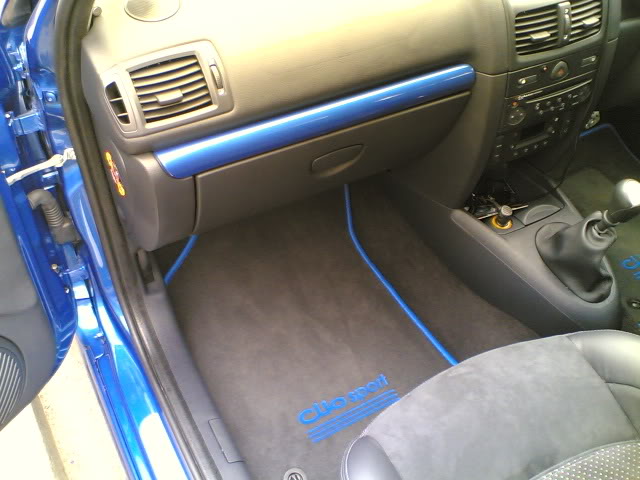

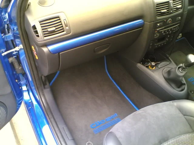

I did mine about 12 months ago .I sanded them down with some 1500 grit wet n dry . Plastic primer , sanded that smooth , 3 coats of colour and about 3 coats of lacquer applied quite thick .
