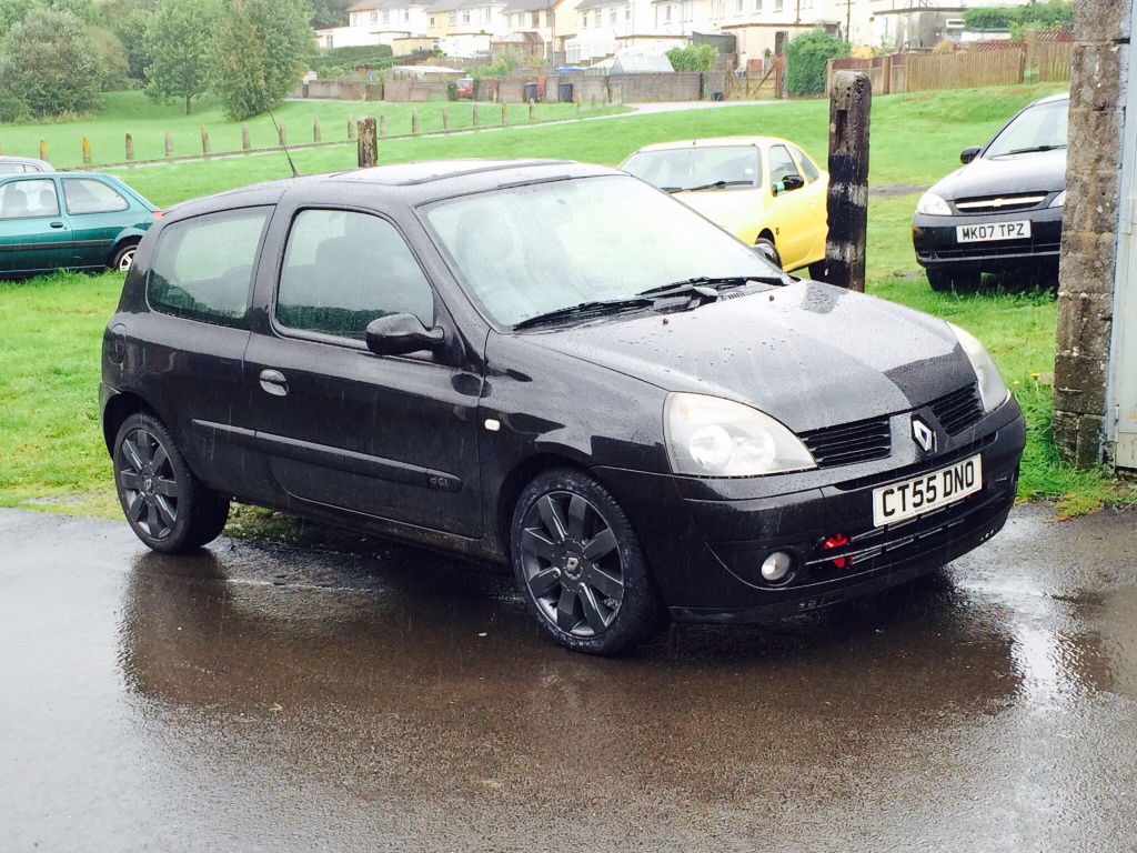

-should it have a sunroof? (It's a 55 plate campus sport)

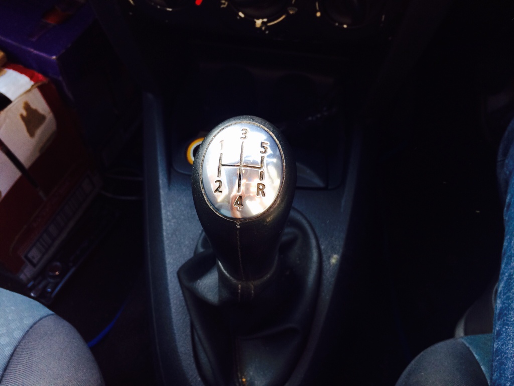

-it has an intercooler from the 100bhp model, does it have a gearbox from one also? (Pic below)
-if it does have the gearbox, doesn't that mean it will have the engine also?

The engine code will tell you what is in it and also gearbox code will tell you likewise.
Pretty sure it's on one of the ones in the door shut. I may be wrong though. Engine code will be K9K followed by 3 numbers. If the gearbox is the same as the dci100 it'll be a JR5 box
68's had the Jr5 box the same as the dci 100
later ones didn't have sunroofs (thankfully!) less to rattle and leak.

If your rear number plate is on the tailgate it 'should' have a sunroof.
Being brutally honest though, Campus clio's were basically parts bin specials to use up remaining ph2 shells before the mk3 came out. Some came colour coded, some didn't, some had sunroofs some didn't, some had new shape front grills some didn't. We used to have no end of problems! lol
(I used to sell them back when they were brand new)
Do you have some pics of the car from the outside? Front and back?
Going by that, you should have your rear number plate on the tailgate not on the bumper?
As such, that year/model of car only came from factory as a 68bhp, but with the 100bhp gearbox. Can't answer the question about the intercooler though.
Yes they do have the 100 bhp style intercooler as does the 80bhp kangoo but it is different in fixings and size
