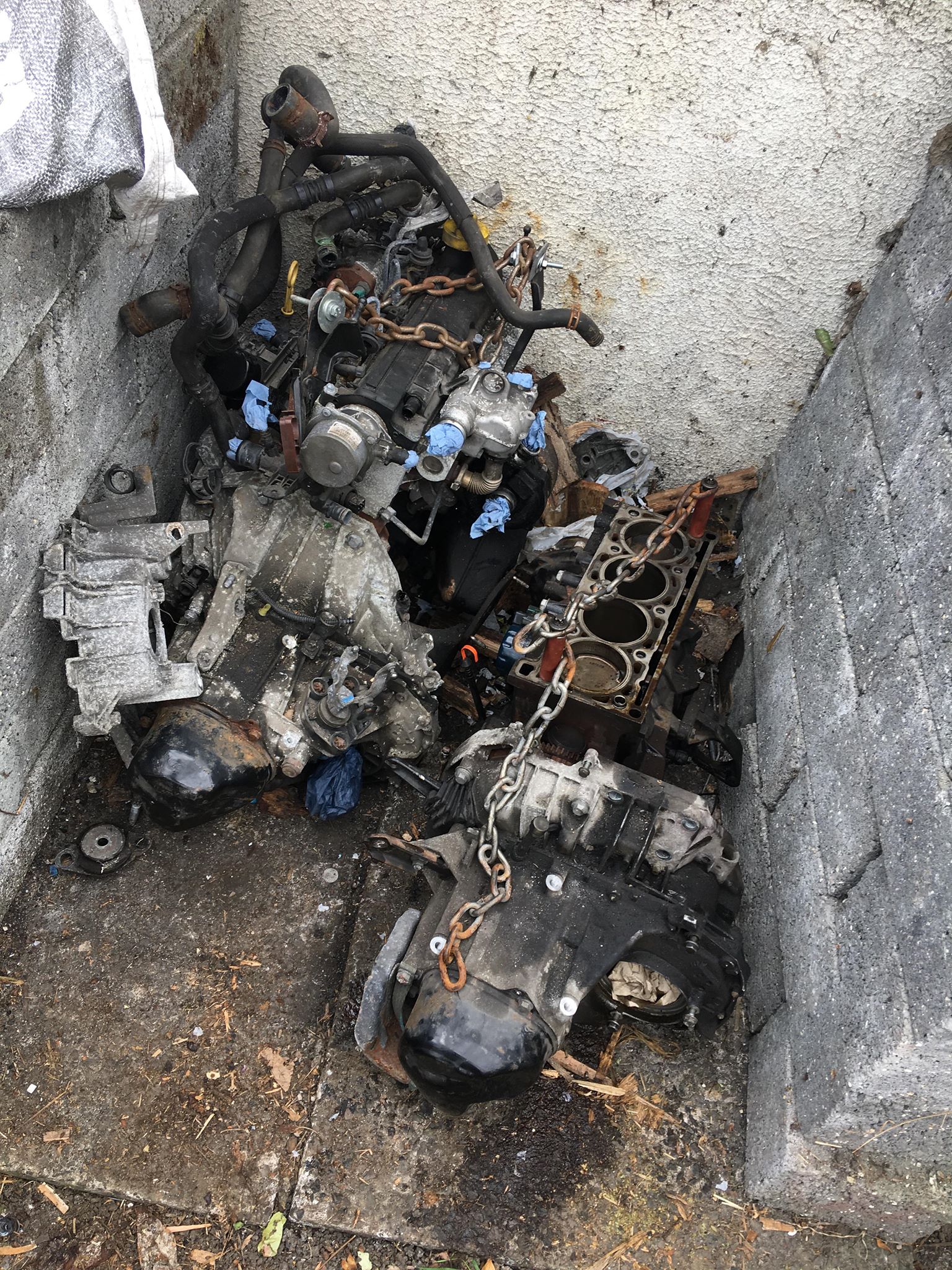

I know all about putting engines away "saving them for later" lmao
These are just the buggered ones I keep outside?
